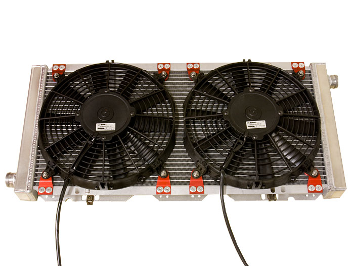

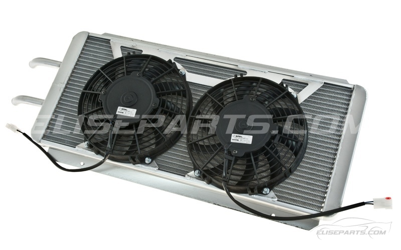

Thanks for the replies both, sorry I should have elaborated, I mean having twin pull fans instead of blow. I’ve seen the eliseparts frame with twin spal fans, anyone used that setup?
Posted

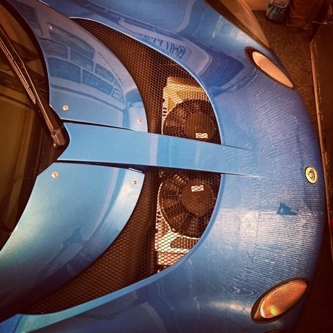

I used the proalloy single pass rad with twin spal top mount fans... Awesome bit of kit... Fans are slightly smaller than the originals and therefore don't cover as much of the core but the mounting frame does... That was my only observation
On my new elise I'm fitting the same rad but with the ep fan upgrade mounting on the underside of the condenser as original.
