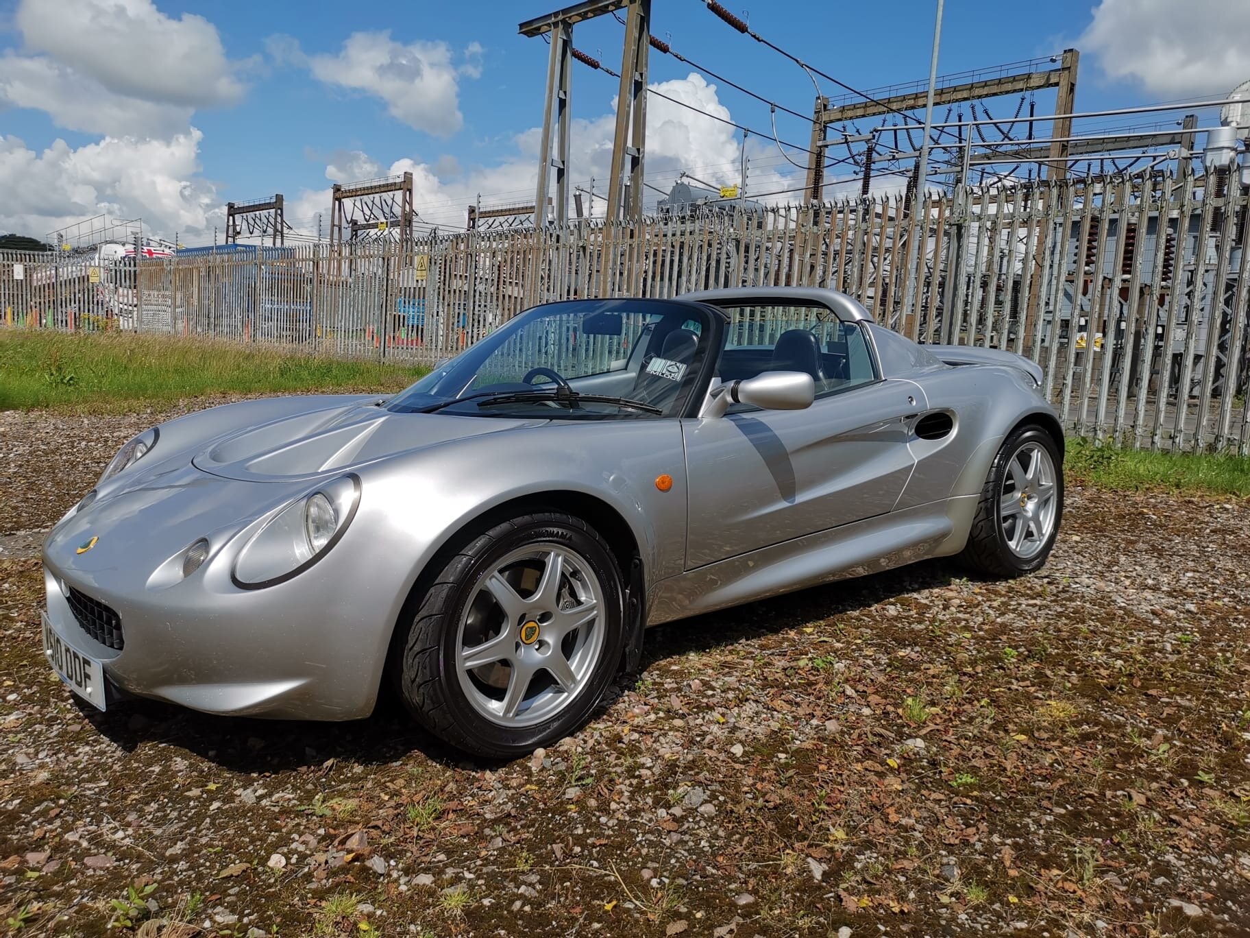

Geek Posted October 26, 2024 Posted October 26, 2024 I purchase my Elise s1 111s last October with a relatively low mileage (around 27000). If I am being honest, I really wanted an Exige s1, but far too expensive for my budget, next choice was an Elise s1 160, but again a bit more than I could justify. Therefore, the quandary: should I keep the s1 standard or upgrade? I have been down the modifying route many (many) years ago with motorbikes, and with hindsight I should have just kept the bike standard, it can soon become a money pit with diminishing returns. Thoughts, what have you done with your Elise (s1, s2 and s3)/Exige (s1, s2)?

Dave-hp Posted October 28, 2024 Posted October 28, 2024 23 hours ago, Geek said: Looks nice. Enjoy as is....
LRS7 Posted October 28, 2024 Posted October 28, 2024 On 27/10/2024 at 19:19, Geek said: Looks very tidy 👌🏻
