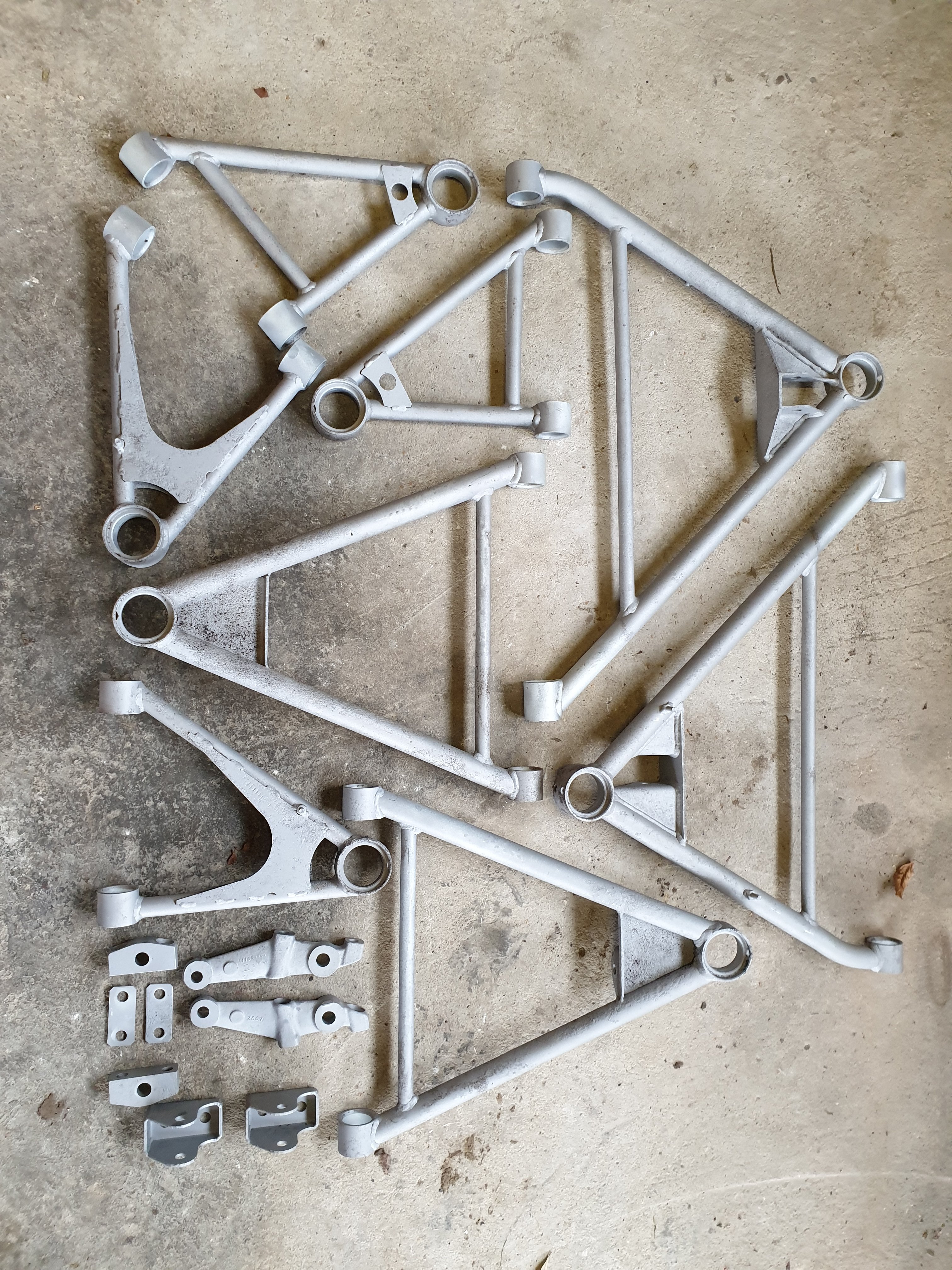

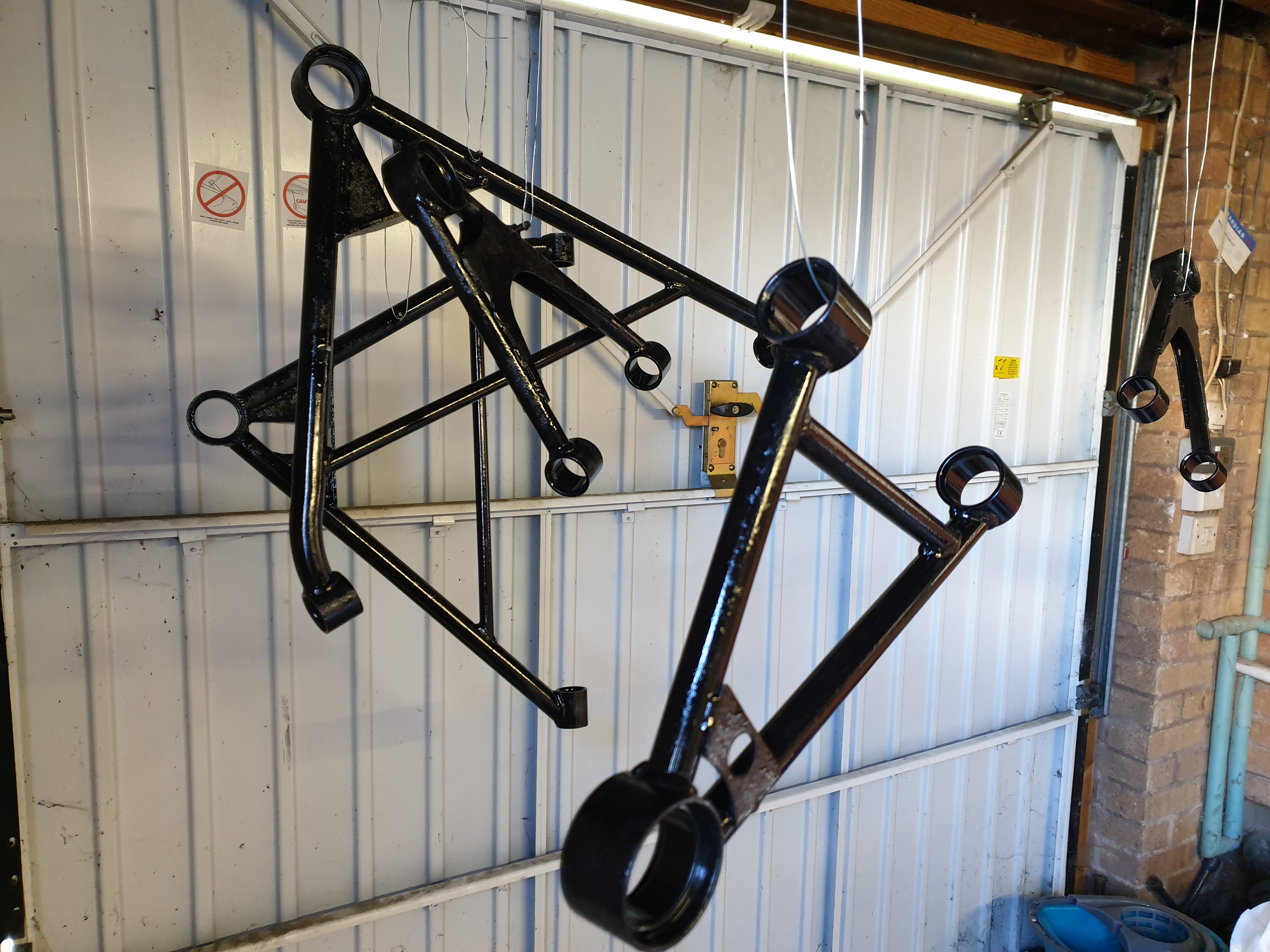

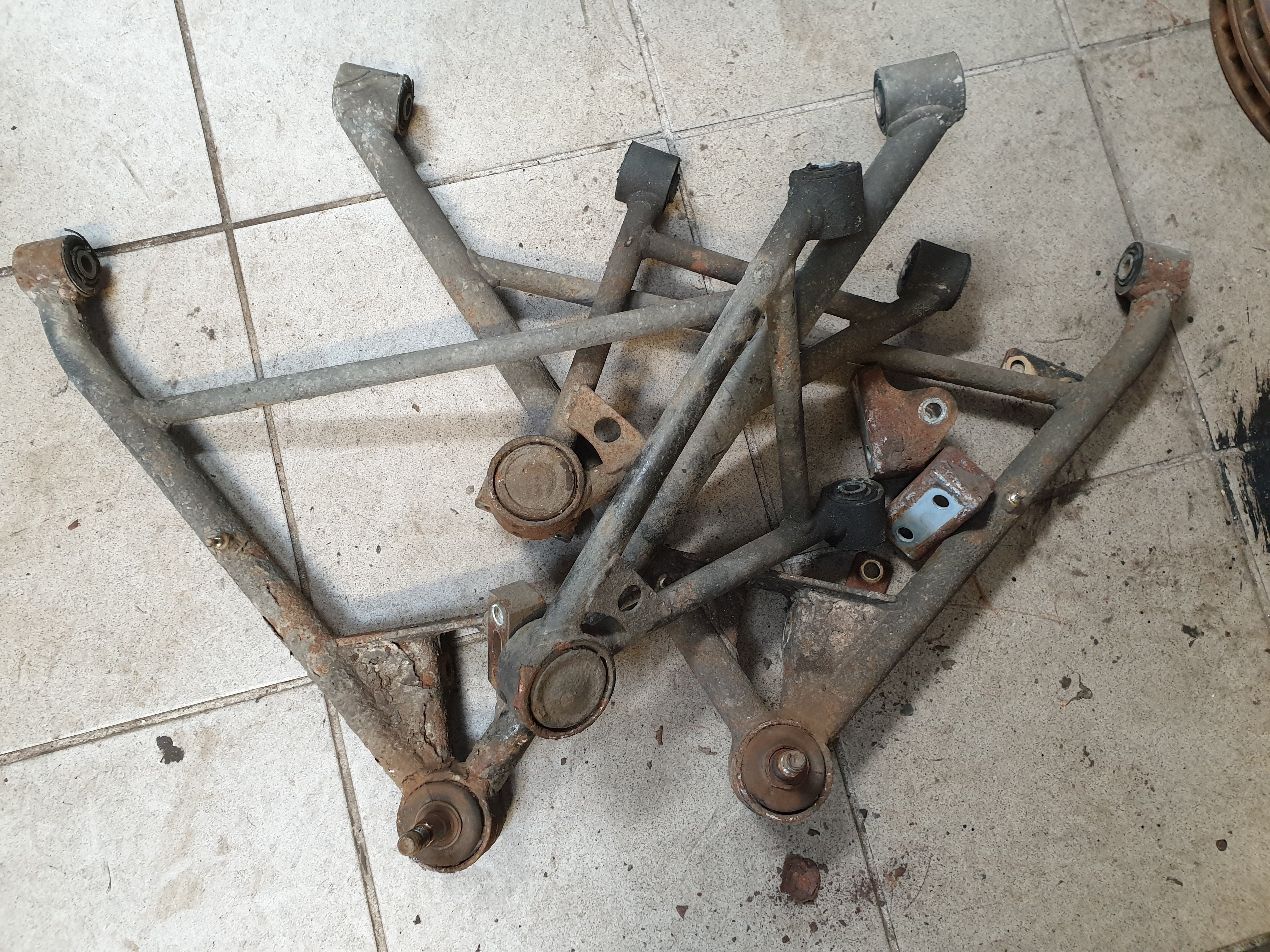

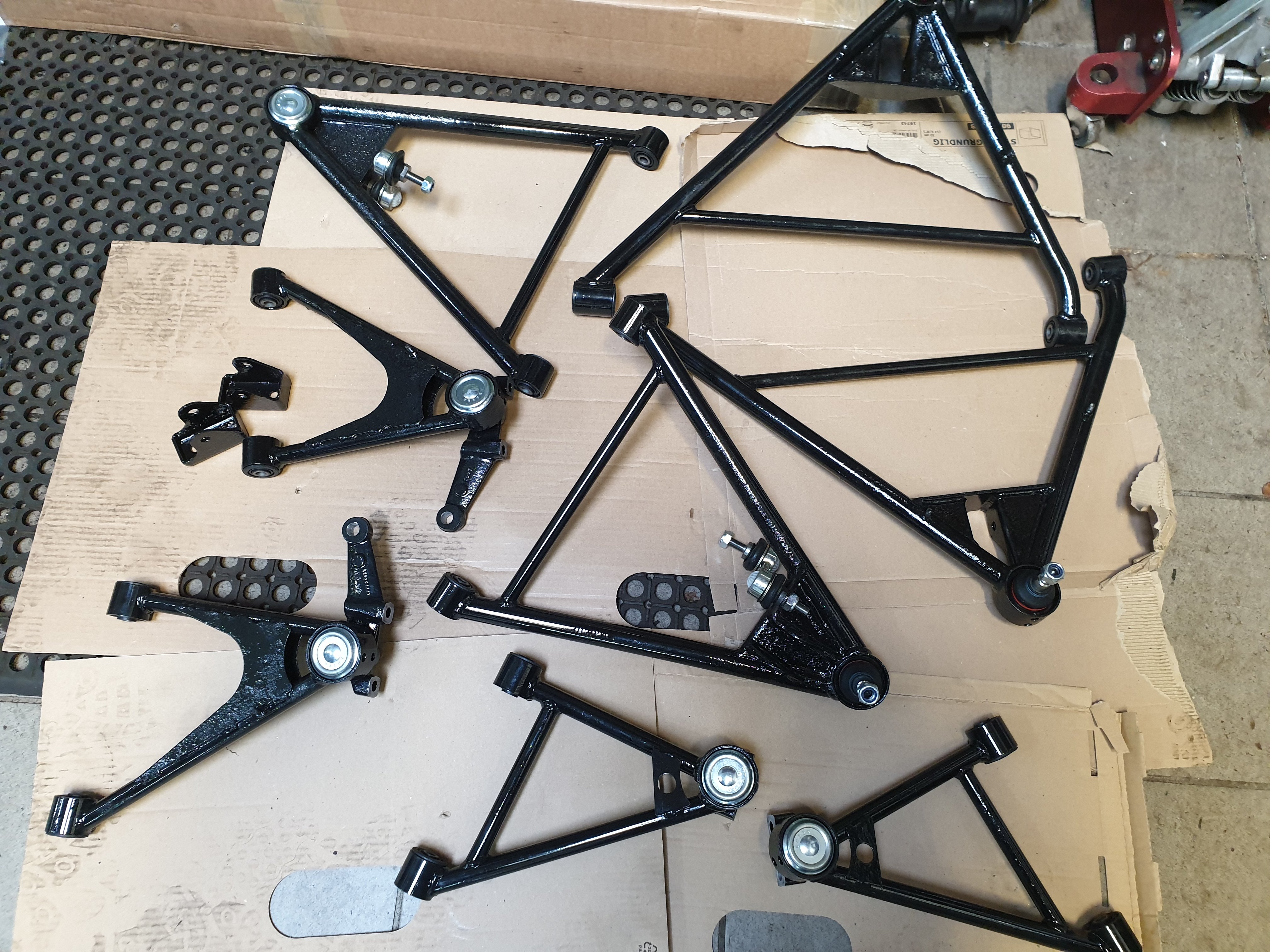

DeanB Posted February 13, 2022 Share Posted February 13, 2022 This is the before, during and after sequence for my wishbones. As you can see, even finished you can still see some pitting but my main purpose was to arrest the corrosion and protect the metal. I didn't re-passivate the wishbones, just painted them. I suppose re-passivating and painting is better because it's belt and braces, but we'll see how mine get on. If you are taking them off and re-bushing I would definitely have them blasted before paint, especially if Graham will let your lad have a go with his cabinet. Link to comment Share on other sites More sharing options...
richbk Posted February 13, 2022 Author Share Posted February 13, 2022 Many thanks all for the info and offers of help . phil , you are spot on , 7 bolts out no problem , the 8th , passenger side bottom of hinge is a nightmare , spinning . Have had to grind off the head carefully and hopefully we can retrieve from inside following your tips . Graham I have dropped you a message , very kind offer, my son is very excited to maybe learn a new skill . dean . Thanks for the images , I would say the wishbones are similar if maybe a little better than yours looked , but definitely in need of TLC And preventative measures for long term . Who did the bushes in /out for you ? tganks again folks , as I mentioned in another thread MLOC really is a great place richard and Ethan Link to comment Share on other sites More sharing options...
