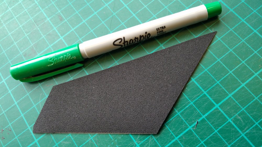

Whilst aftermarket pairs of these can be readily bought on line I thought I’d save some money and cut some myself so ordered a small piece of protective vinyl to try. With us not being able to get out very much I’m not entirely sure what the texture of the genuine Lotus vinyl is like so can’t be sure how similar my piece of vinyl might be but I thought it was worth a try anyhow. The texture is very much like that of a small-scale piece of Scalextric track.

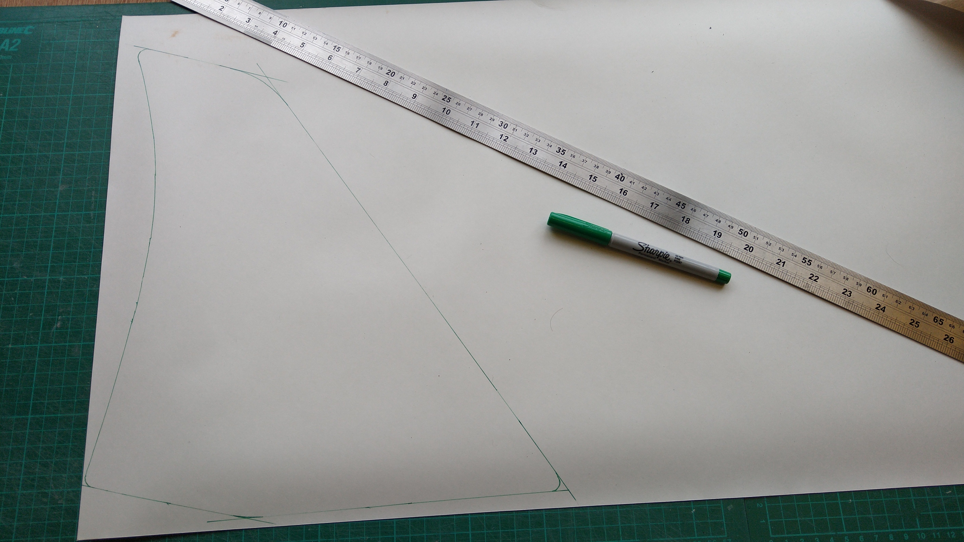

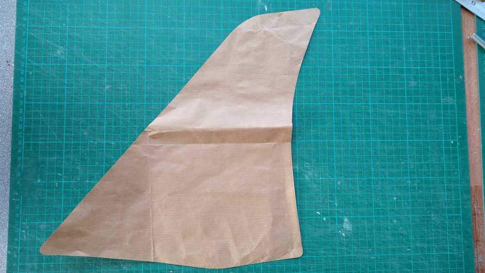

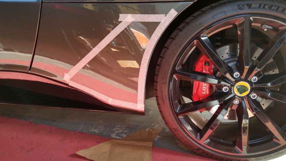

I looked at a few photos of GT410s/430s and taped the approximate shape onto the side of my car in order to make a paper template.
I marked the template out on the vinyl and cut a pair out. By good fortune it turns out I ordered just enough to actually make two pairs B)

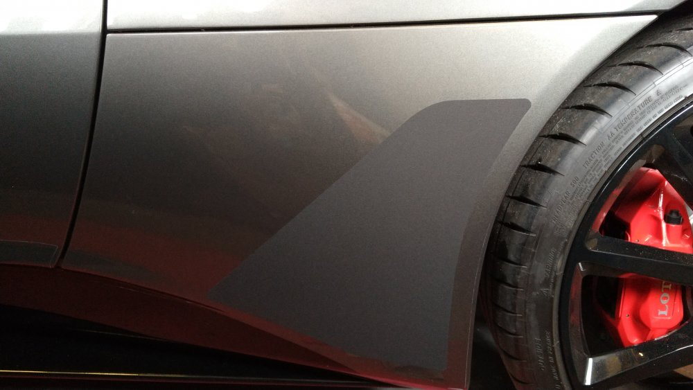

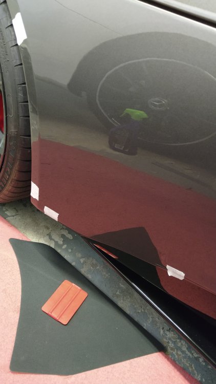

I applied a few pieces of tape to the car again to act as guides and then floated the vinyl into position using a spray of soapy water and once happy with the position squeegeed out the excess.
Remarkably easy to do all in all and as it turned out £20 gets you enough vinyl to make two pairs so no great loss if I decide to remove them at a later date.

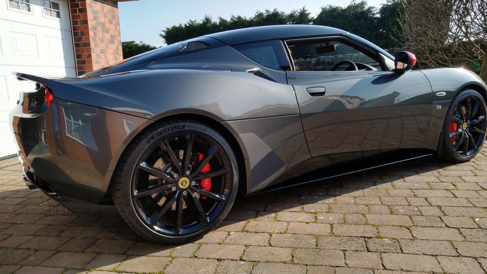

Posted

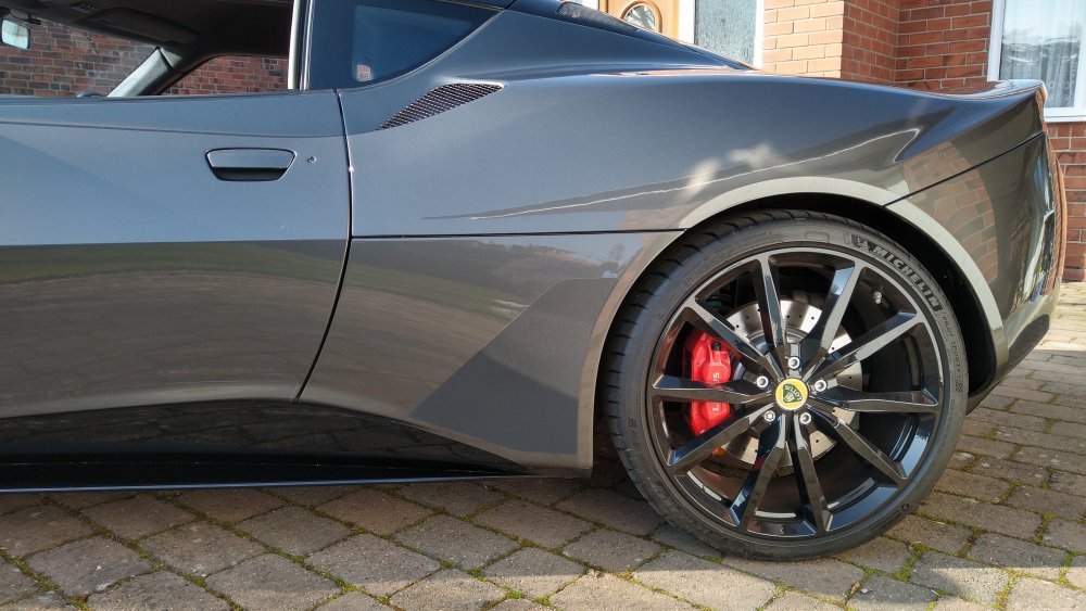

Just for you then Dave, here's a couple in daylight, now that I've done polishing and waxing the bodywork 😁 IMG_20210307_101818696_HDR.thumb.jpg.b7485dc08b3ff66359d347f782add9ff.jpgIMG_20210307_101738361_HDR.thumb.jpg.cc7fee4b15654b8b093bd9914c2687dc.jpgIMG_20210307_105332413_HDR.thumb.jpg.fa173e971db688bc7dcd35add7f43d28.jpg
