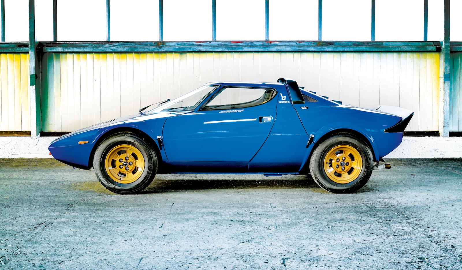

Posted
Strange but that blue makes it look tiny - which I guess it is tbh!

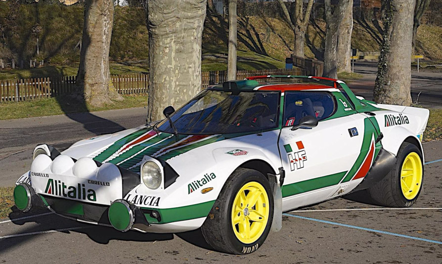

Don't want to do a rally rep. But if I did it would be either Alitalia or Aseptogyl - I mean what other chance would you ever get to paint a car pink, red and white? I have seen a replica currently being built in this colour and it looks awesome in the flesh.
