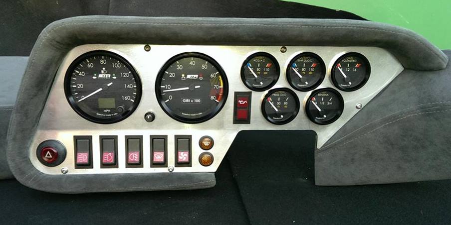

Dr H Posted May 5, 2017 Author Share Posted May 5, 2017 No great progress to report. Finished the heater controls Driveshaft paint wasn't great n the inner CVs so dismantled them and had them powder coated. Now reassembled Header tank powder coated black and a Stant radiator cap added Ordered the dash gauges that will look like this: But mine will have the speedo and tacho on the RHS in front of the steering wheel. The original cars had them to the side of the dash with the gauges in front of the steering wheel. Also ordered the whole interior today. Will be like this with their new 'Stradale' seats. Grey alcantara dash and door cards, black carpets (probably) and tan seats - as per the original road cars. Head lining and roll cage trim will also be alcantara on mine - they are usually vinyl. Oh and even though I haven't built it yet the upgrades have already started . LB now offer a full alloy rad with a 50mm core. So I've ordered one of them! Quotes for paint incomming. Had one already, looks like it's going to be £4-5k including trimming body, gapping and cutting holes for handles lights etc. Link to comment Share on other sites More sharing options...
