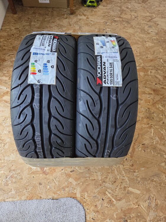

DeanB Posted May 25, 2025 Posted May 25, 2025 How much is a full set of the AD08s Will? I thought the AD08s weren't available in 195 section for the fronts, maybe I got that wrong or they have recently introduced that size. Does anyone know?
MrWill Posted May 25, 2025 Author Posted May 25, 2025 They are really hard to get hold of Dean. I was buying nagkang ns2r until I went to buy that brake switch from Elise parts. They have fronts available in 195 now. https://www.eliseparts.com/shop/wheels-and-tyres/s2-s3-yokohama-ad08rs-195-front-tyres/ £360 after vat. The rears I got off Ebay. for £334 from a company called rarerims Hope that helps Will
Trebor_UK Posted May 25, 2025 Posted May 25, 2025 3 minutes ago, MrWill said: They are really hard to get hold of Dean. I was buying nagkang ns2r until I went to buy that brake switch from Elise parts. They have fronts available in 195 now. https://www.eliseparts.com/shop/wheels-and-tyres/s2-s3-yokohama-ad08rs-195-front-tyres/ £360 after vat. The rears I got off Ebay. for £334 from a company called rarerims Hope that helps Will Same places I just bought a set from too the week before last. Only place I could find rears was rarerims on eBay. Only had 1 proper drive on them but can feel the increase in grip over the V105s. Had AD07/AD08 on previous cars and always found them great, much better dry grip than more std road tyres but you can use them in the wet too.

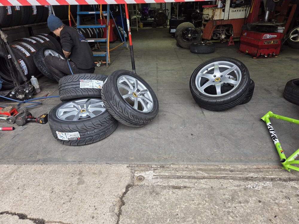

MrWill Posted May 28, 2025 Author Posted May 28, 2025 Thank you both (Dave and Dean) Standard S2 suspension and geo here. I did try 340r road settings as per seloc settings chart and it was awful. But I learnt that wjat appear to be small changes make a big difference. Im hopeful having read your shared experiences the 195 fronts on ad08rs will make all difference without touching the geometry. But if not then I'm probably going to make the very slightest increase in toe out 0.1 to 0.12deg. I.e. Just change one thing at a time. Tyre pressures wise I'd tend to go 22f/24r. And worknup from there. Any advice on that much appreciated. Lastly. When I got the tyres and wheels home last week I found a wheel weight in the boot of the car. No idea which wheel it is from so back to the tyre shop on sat morning to get them all back on the balancing machine. 🤣

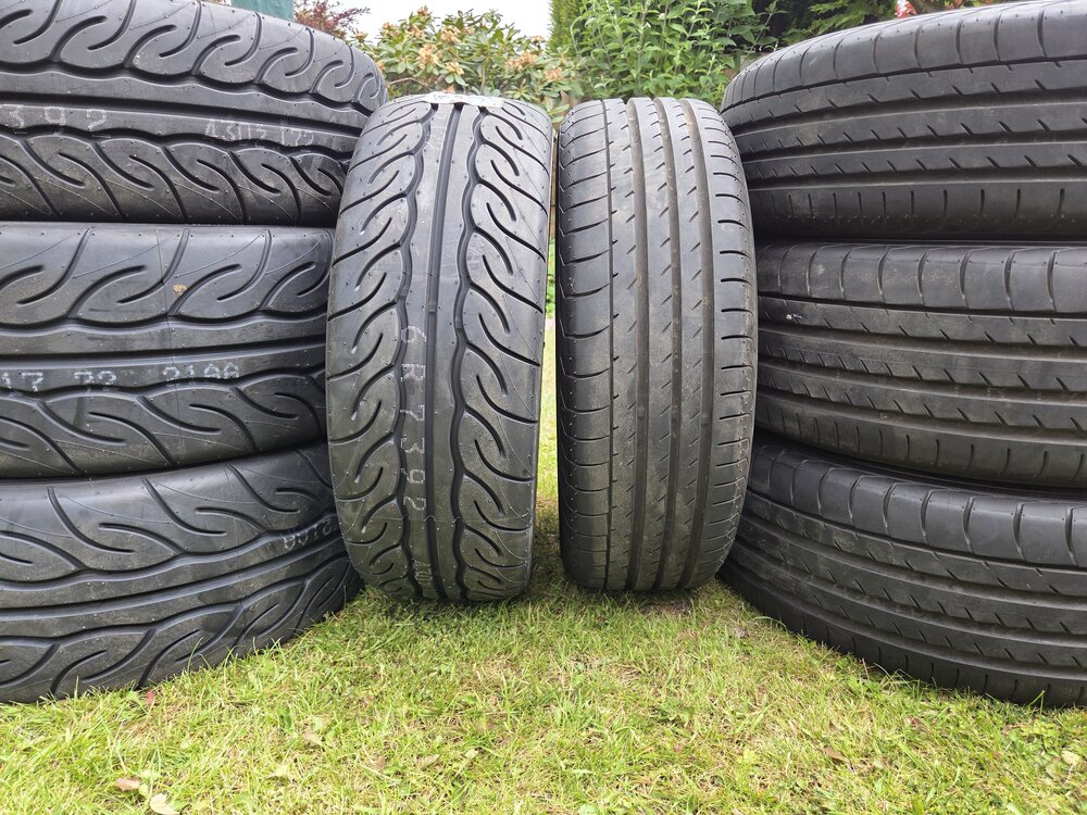

MrWill Posted June 19, 2025 Author Posted June 19, 2025 Quick Epilogue on the AD08RS Tyres Ran the AD08RS tyres for the first time on Dunc's epic 70-miler last Sunday (still grinning from that one). 22f and 24r (per Deans advice) For me, night-and-day better than the v105s. Much improved (quicker) initial reaction on turn in, felt much more planted everywhere and, with standard Geo, never ran out of upfront grip on the run. Couple of provisos: There's pleanty of fellow MLOCrs running v105 with no issues with grip or turn in or general a to b performance and with whom I would not be able to keep pace with. No amount of fancy rubber is going to make up for my hamfisted driving. Having run old AD09s previously it was getting back the instant reaction, the bags of grip and confidence I'd lost. For me in my early light Elise it felt just the ticket and I have no intention to do anything with the Geo, just keep it, and the lovely steering feel standard. The V105s have been switched over to my spare wheels and are currently back in the man cave serving duty as very expensive but lovely coffee tables. If anyone finds themselves in a pickle and needs an emergency set of Rover S2 wheels on new rubber one day, I have the coffee tables you need. 👍 Cheers MrWill
