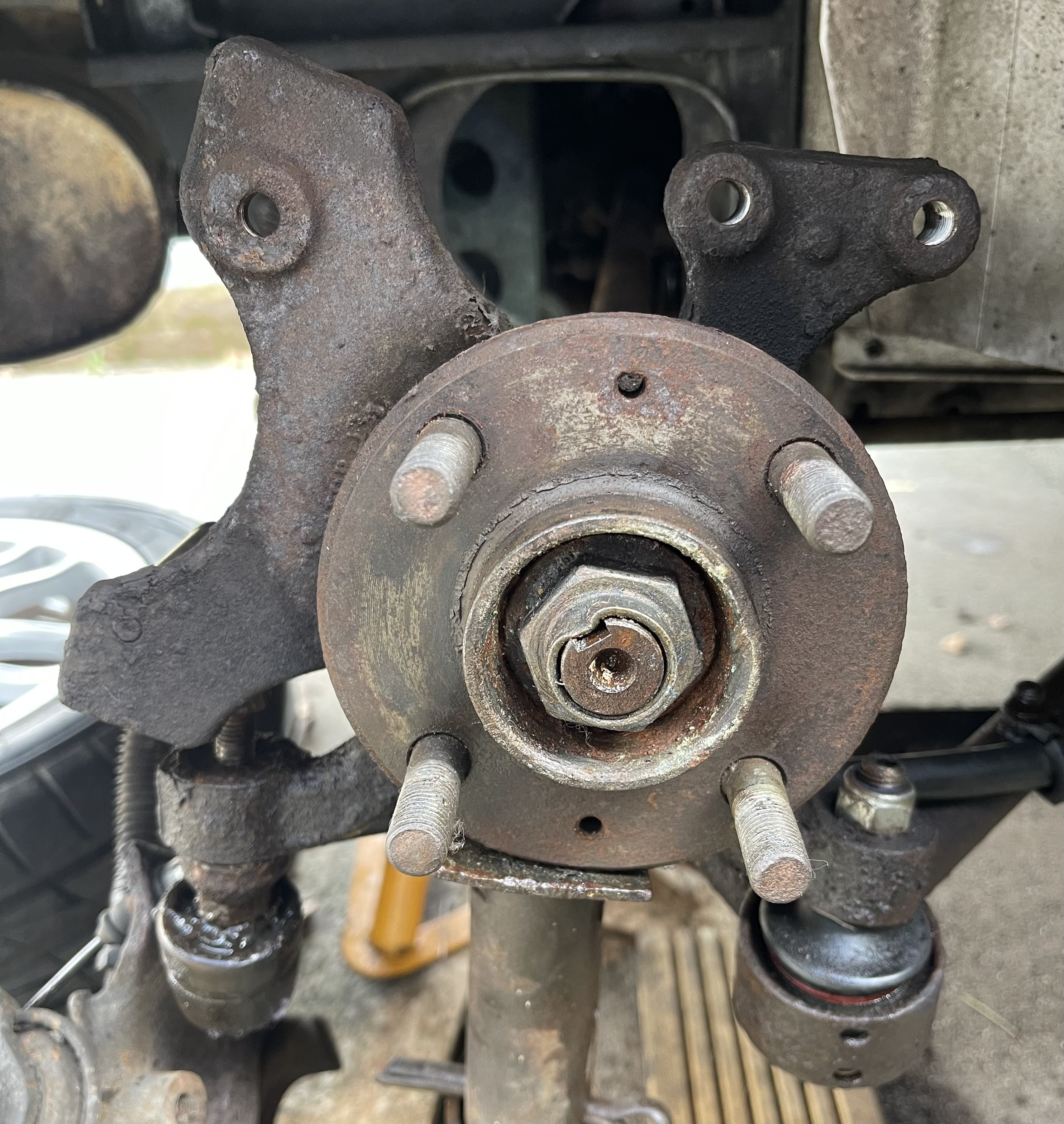

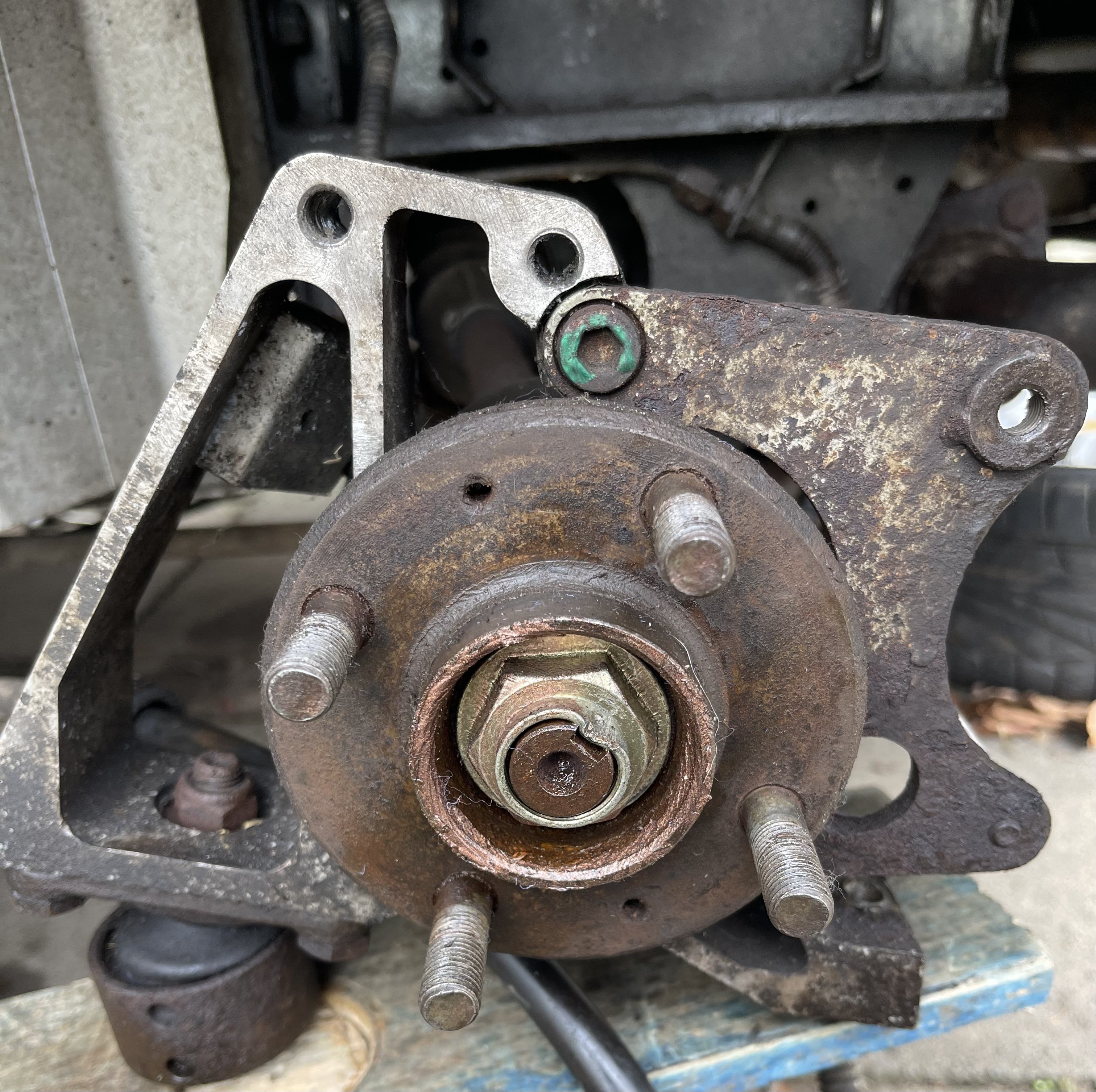

We had a couple of dry , warming hours spare today and finally managed to remove the brakes, rear wishbones etc , was surprised to see the hub surround ( sure it has a more technical term ) is different on each side , seems odd . I know the wheel sensor is on the rear passenger side but didn’t think it would affect set up , any thoughts , knowledge on this.

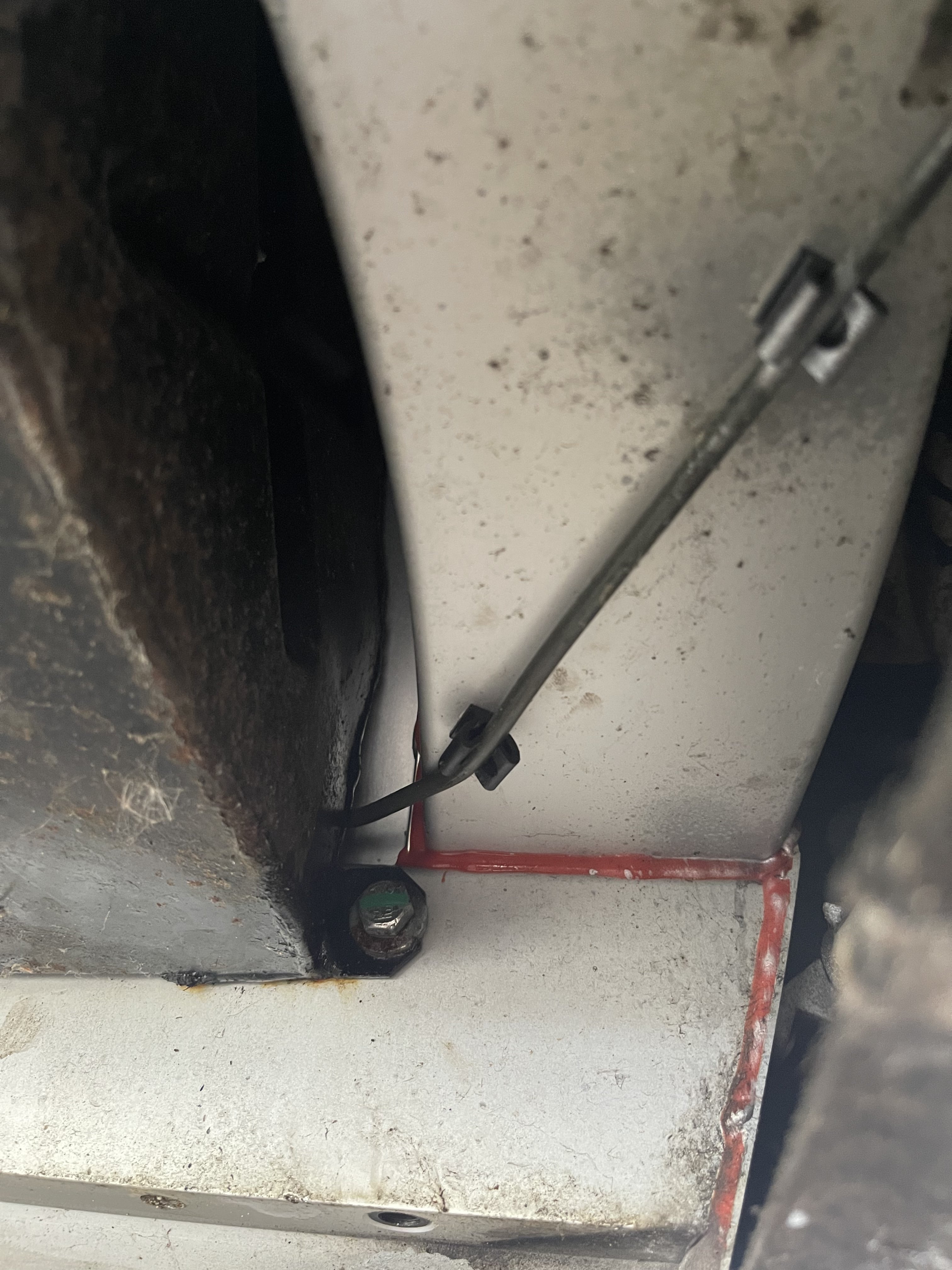

7DED96EA-AB53-4529-A410-8F4750B73360.thumb.jpeg.2f731ce9bfe2b501e540550693ca5ead.jpegE6ABDFDF-4D0E-4C87-A2C8-82F22C9F1755.thumb.jpeg.7f8b583c6ddd5c17e8d2f563001b974f.jpegalso removed the tray under the fuel tank to have a nosey . Found a line unclipped and tapping , so maybe fixed one of the 20 or so rattles ( along with removing the £1.73 in loose change from under the seat !) the tank seems quiet rusty on one corner so will treat to a bit of Krust and hammerite. BAA73586-429F-4C11-9F09-1B2A78035145.thumb.jpeg.a45df3e9bd6ce555266309fb3dfcddef.jpeg

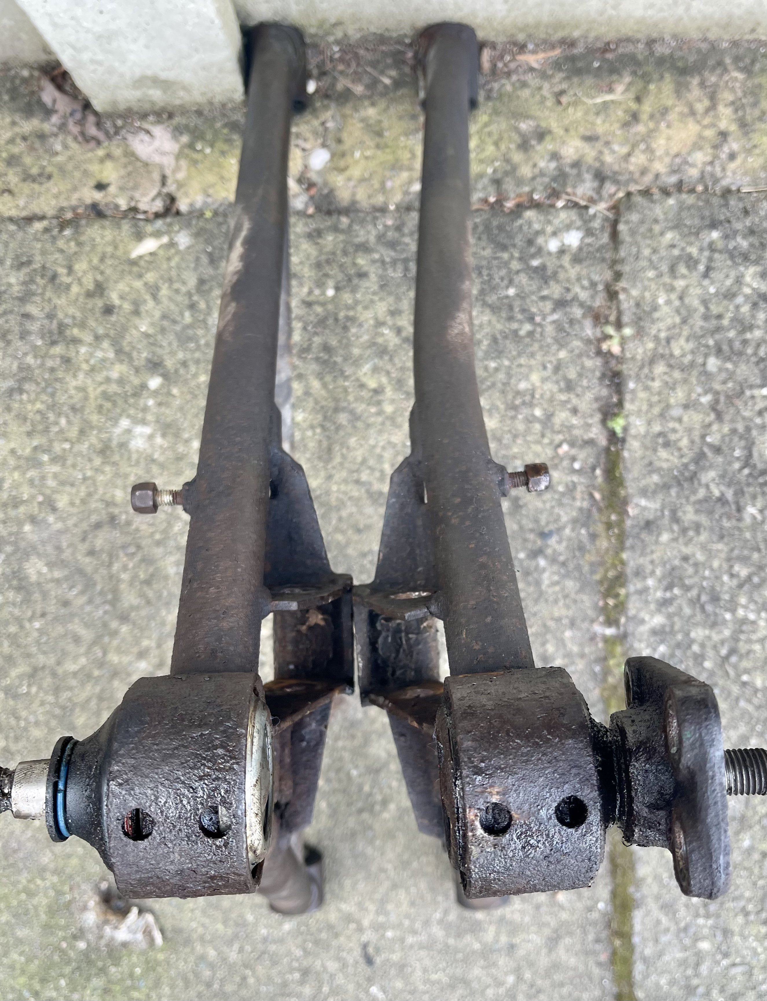

on inspection of the wishbones , bottom rear drivers side appears to have a slight bend in it ? As per photo . Only slight , but wondering if I should replace or possibly get it warmed and reshaped ? Is this a reasonable thing to attempt or is it scrap ?  Oddly the other side seems to have had new ball joint recently , but not this one ?

Do you mean the uprights Rich?
One side is the extruded ally version that the early s1s had, the other is the more durable (but heavier) iron ones Lotus fitted to later s1s.
If it were me I would try and find a straight wishbone rather than try and bend that one back.
Posted
A single new balljoint is not that unusual, they don't necessarily wear out at the same rate - it may have had one due to an MOT failure.  I would guess though that a bent wishbone doesn't help this sort of thing...
