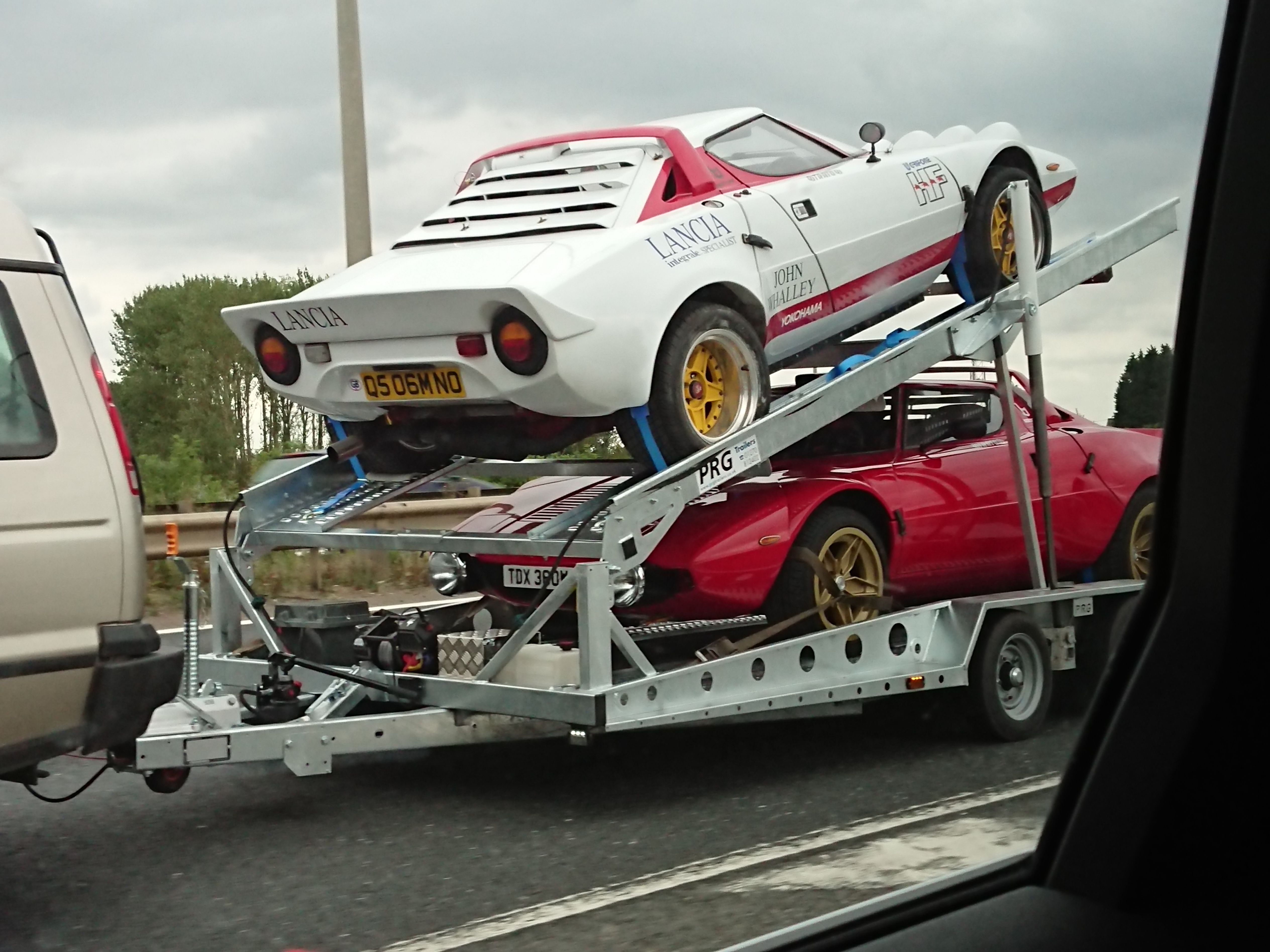

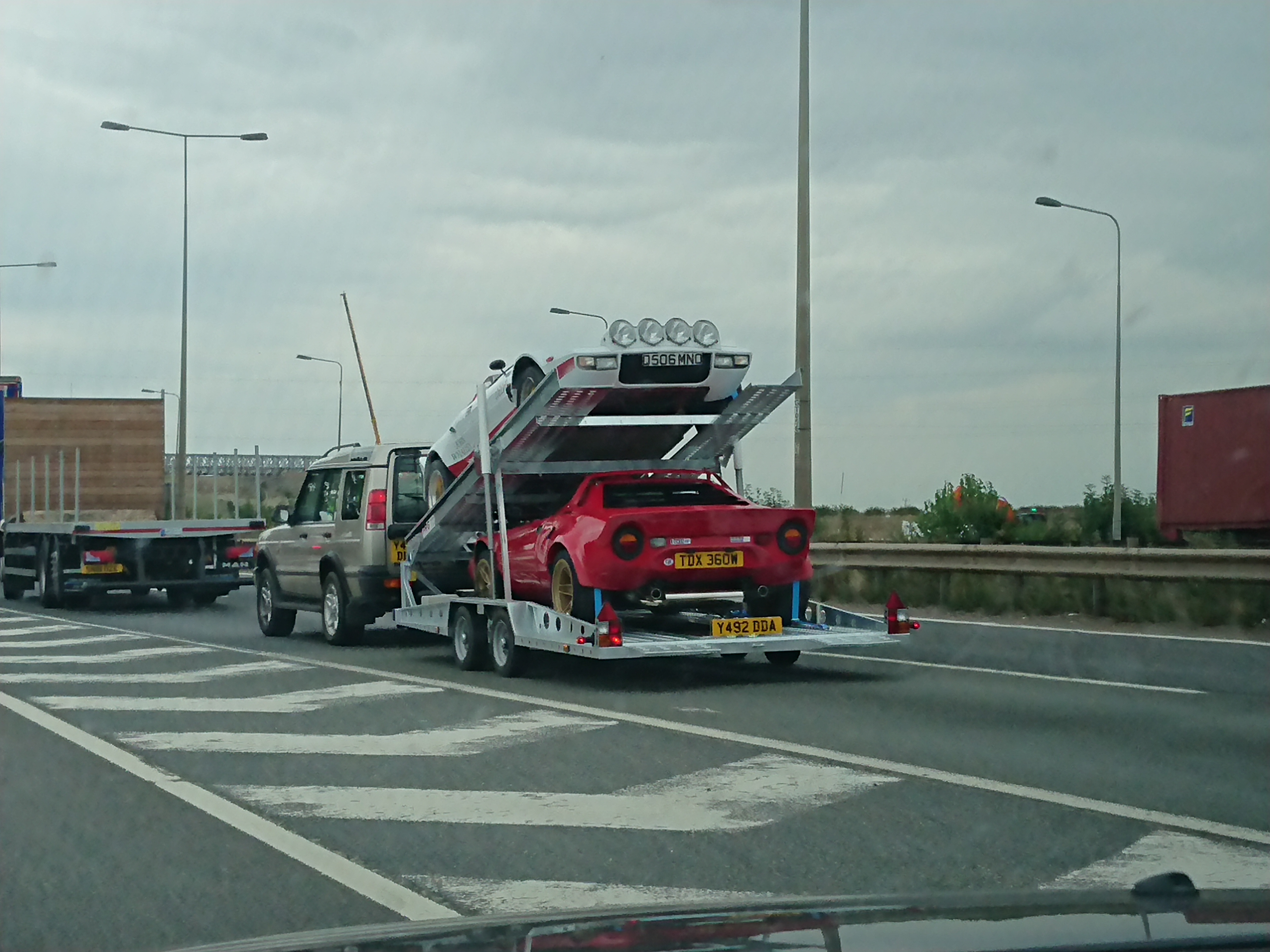

Dr H Posted August 20, 2018 Author Posted August 20, 2018 Nice. Wonder what replicas they are? Could Be Hawks, or Alloras or LBs. Having 2 is just greedy
Reg Posted August 21, 2018 Posted August 21, 2018 Red one is a Hawk, white one is a Transformer cars... 😉
timbo Posted August 21, 2018 Posted August 21, 2018 Does the white one turn into some sort of robot superhero then? (Sorry)
Dr H Posted August 22, 2018 Author Posted August 22, 2018 Wish mine would transform in to a working completed car! Apparently they were on their way to an event in Norway.
Brian Birtwhistle Posted August 22, 2018 Posted August 22, 2018 Those double deck trailers always scare me, the centre of gravity must be higher than is ideal. And a Discovery isn't the most stable of towing platforms, with all the 4x4 features like long travel suspension actually working against you. I've been told that the lightweight double deck 7.5 tonners are scary things to drive when fully laden, but that must be worse.
