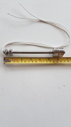

Dr H Posted September 3, 2018 Author Share Posted September 3, 2018 Bugger all the report really. So as I've been a bit bored I've been dreaming up stuff to add... Latest 'lightbulb' moment was a coolant level float switch. Header tank is aluminium and has no sight glass so you have no way of telling what the coolant level is without taking the cap of and looking inside. So I bought a stainless steel float switch: Turns out to be exactly the right length to detect when the coolant level with the bottom 'crease' in the tank, which is about as low as you'd want to go. The float is normally closed and breaks the circuit when the level raises about a certain point. The idea is to have a warning light on the dash - light this but yellow rather than red When the coolant drops below the level set, it makes the circuit and lights the light. As the coolant system is still drained I simply took the tank off, drilled a hole in it and fitted the float switch. Luckily The float just fitted through the neck - and I mean Just! Dowty seal on the underside and it simply bolts on from the top. Tested it with a muti-meter on continuity setting and a jug of water. Works really well. Just need to run wires to the dash now. Still planning for wiring loom fit and first start next Monday. Link to comment Share on other sites More sharing options...
