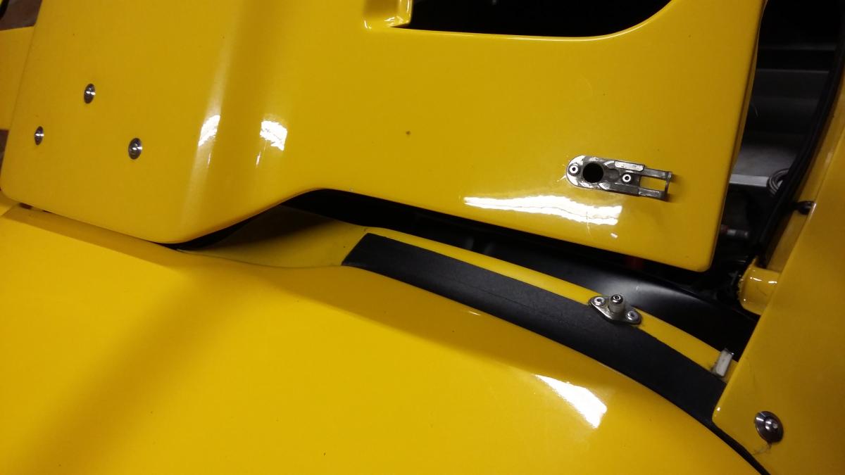

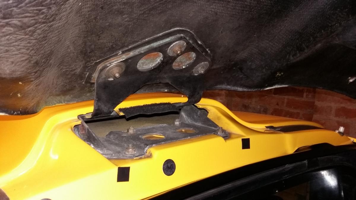

I am getting there I promise :-)
I had the windscreen removed yesterday. The dash paint job is running at 90%, it needs to be a cool 100% so it makes life easier removing that. There were quite a few nicks and scratches on it so I'm having a brand new windscreen fitted in a few weeks.
I'm just waiting to get the engine on the dyno to run that in. I'm a bit lazy like that but it's still using the OE ECU, I'm not chasing power obviously. Not long once the engine is fitted although I'm having work done at home so that may delay matters a little. That said I have the engine specs albeit a few things missing (pipework etc) which I'll update later with a job lot of images. So here we are....
