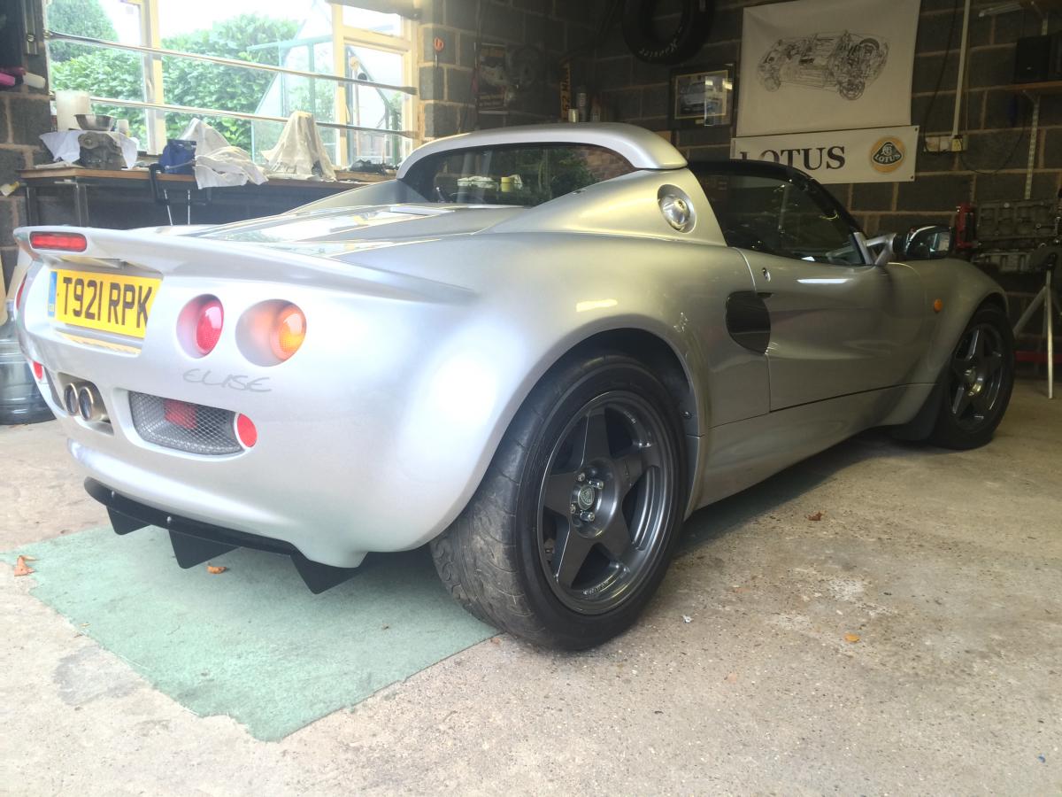

Wheels off for shot blasting and powder coating next week.
Dan's making headway with the gearbox!
