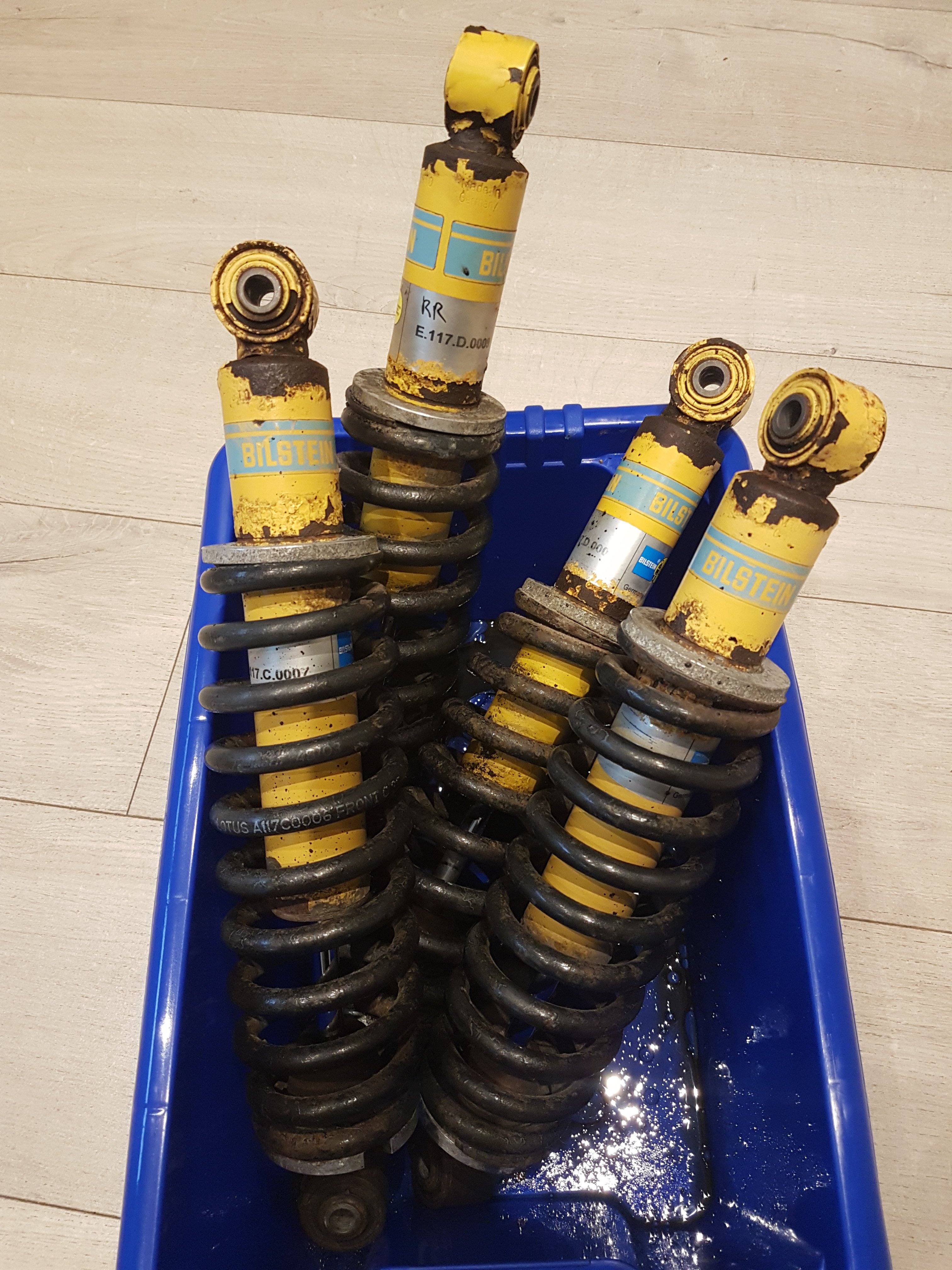

Rygar Posted November 21, 2019 Author Posted November 21, 2019 Finally got around to removing the old shocks and springs. They are a bit tatty looking but hopefully it's just surface corrosion where the paint has lifted. They are being shipped off to Bilstein in Leicester for a rebuild. Will see how it goes.
DeanB Posted November 21, 2019 Posted November 21, 2019 Just seen this thread. Good advice from Martin and the guys. I have Street Series and they are rubbish on the road. Oem Billies are great.
winthattt Posted December 3, 2019 Posted December 3, 2019 Ferrous springs should never wear out if they don’t go beyond their yield point, if you take them past the yield point they will wear out very quickly. If they do fail it will be from corrosion or damage. They don’t sag either, bushes and the like may wear and people blame the springs. They can look horrid with corrosion, but new ones look the same pretty quickly, at least eibach and Nitron ones on my cars did.
