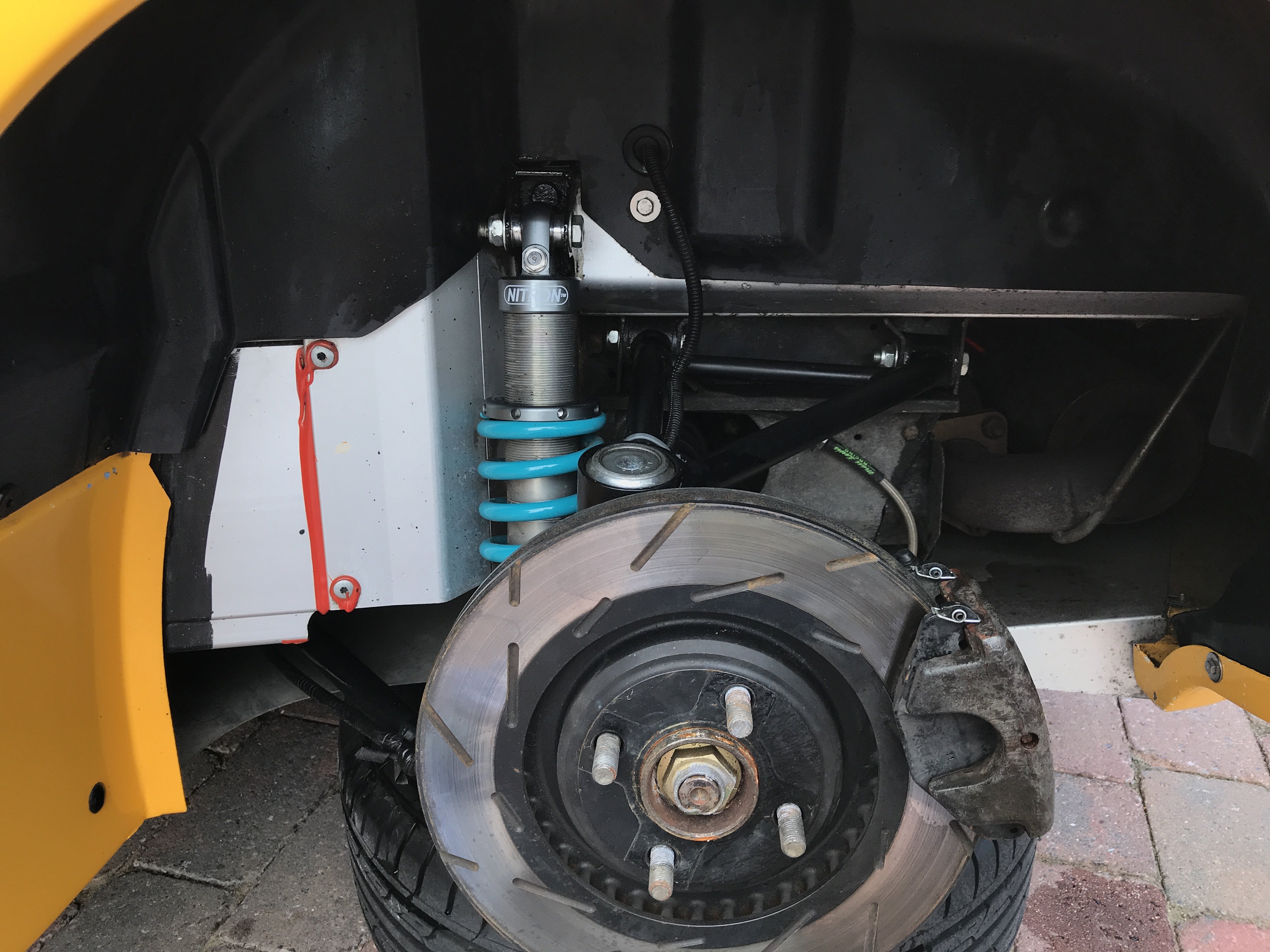

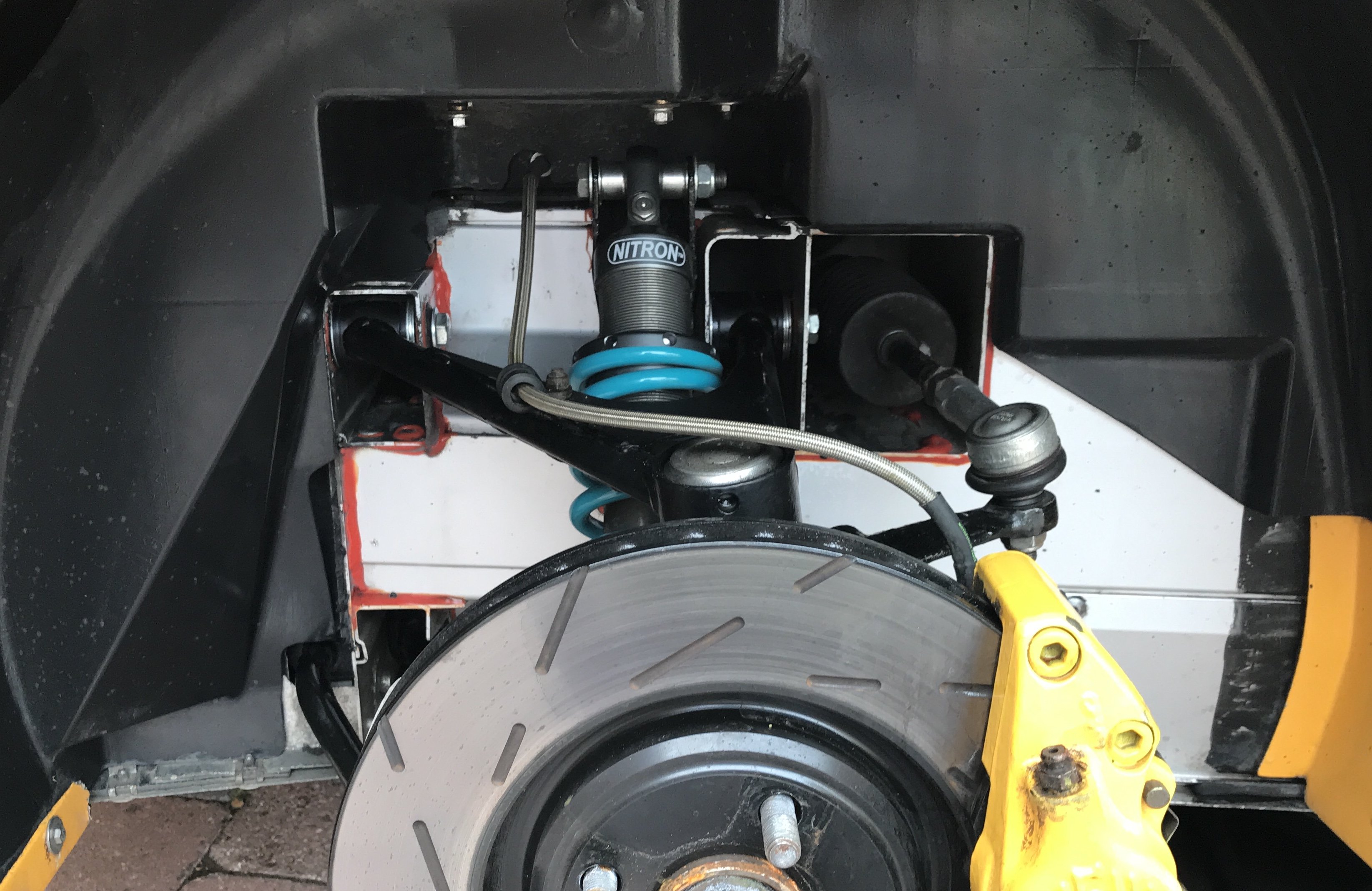

kieranexige Posted October 2, 2019 Posted October 2, 2019 5 hours ago, Daveb99 said: Cheers buddy - yep Gav is a top man. He gave it the full treatment and also found a couple of bolts that were loose (suspension no less....) so ended up checking everything. He reckons it was a total no brainer at the price I paid (let's just say I could have had four of these for the price I sold my V6 for!!!) which is good enough for me. Have to say with the cams and hurricane it really sounds like it's running carbs from 4k to 7k - absolutely love it. The best bit is that with 114k on it I couldn't give a monkeys how many miles I put on it, which is a bit different to the S160 of course. Looking forward to getting the new tyres and freshly refurbed AWIs on it - should be Sunday. Funny you should mention door hinges - Gav has sorted mine as both were working very loose. They are perfect now - no surprise there. Couple of pics attached from when I had the wheels off. Can't see it staying quite this clean for long! I've also fitted a decal that was kindly sent to me by the buyer of my black S160 - in France. He's a lovely bloke and thought I'd like one so here it is. I trust the Exige is keeping you smiling - seems like an absolute beauty, I'm looking forward to seeing it.. 114,000 miles and the wheels have been off for detailing 😂😂 Top work though, sounds like Gav did the buisness again. Yeah mines OK, new battery and a few bits. Got a few interior bits on the go at the minute too.
