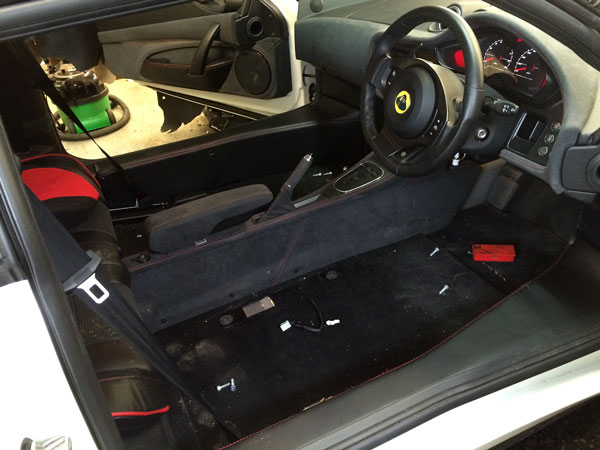

So it started out with removing the seats from the car.   These were surprisingly heavy and if in the future if my car becomes more track than road, then is definitely an area where considerable weight could be saved.  (click on the pictures to make them bigger although they are only from my phone)
Amazing how big the interior seems without the front seats fitted. (As the car is only a few months old I unfortunately only found 5p under them!)

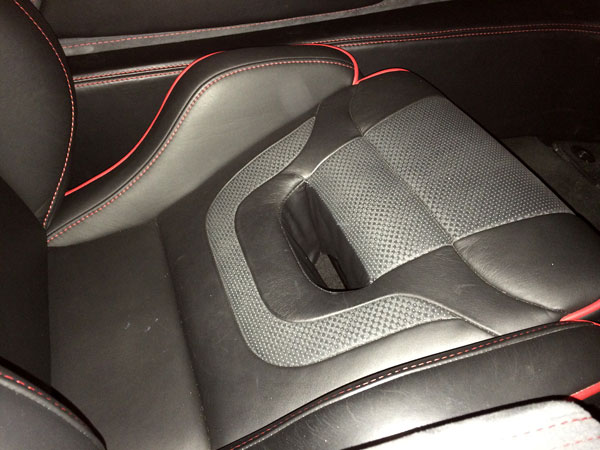

So this is how the seats look as standard.  I've always though the pattern led itself for fitting the third hole in the seat base as it is in the perfect place.

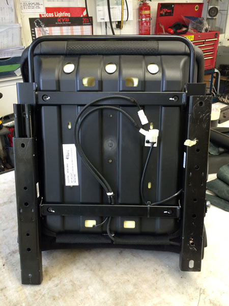

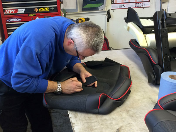

So it started by removing the seat base from the frame (4 allen bolts) and taking the leather off the base (it hooks into a grove all the way around)
It was no going back time as the scalpel came out!  (He did this really carefully as you'll see later we used the removed bit to create a wedge that fills the hole when the harnesses aren't being used)

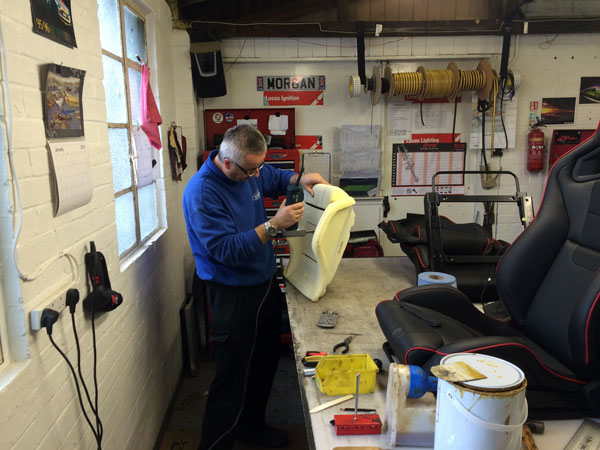

Next the foam was cut (with what looked like an electric carving knife)
Shaun them sewed a new piece of matching leather on to the seat, creating a tube that goes from top through the seatbase.

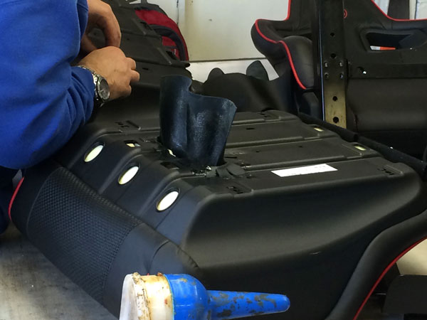

The seat base was then cut with a drill and jigsaw to create a hole.  The seat was then put back together and the tube pulled tight and then cut and stuck around the edge to create a smooth edge.

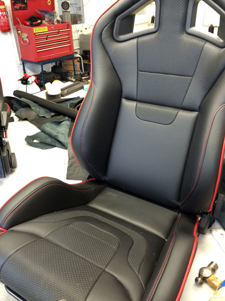

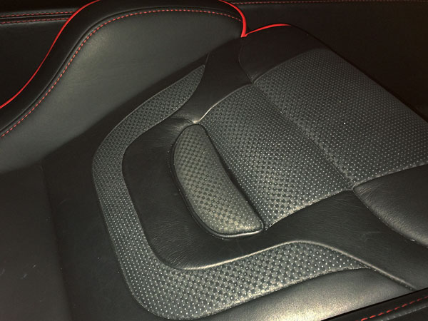

The seat was then fitted back into the car, really happy with the final finish.

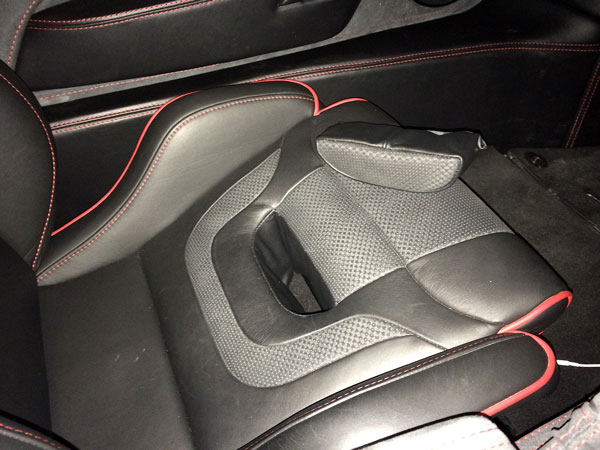

He then repeated the process on the second seat and then made the wedges that will be fitted when not using the harness.  I'm really happy with these and most people wouldn't notice the seat has been modified.
Amazingly it only took Shaun 3 hours to do both seats including stripping and refitting them back into the car.  It was really enjoyable watching and having a laugh with Shaun and his colleague Rocco who are really skilled craftsmen.
