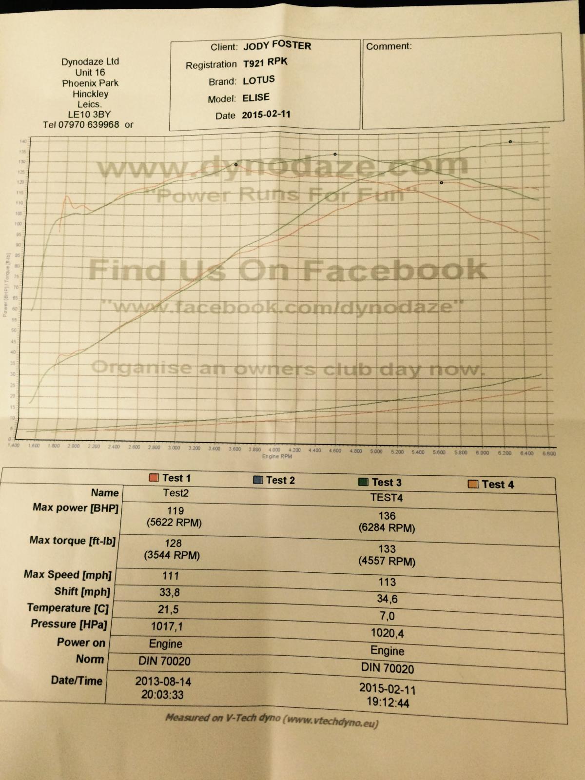

jody391 Posted February 11, 2015 Author Posted February 11, 2015 Ok so having the cams in now for a little while tonight myself and Marcus decided to get the cars on the Dyno, (We have just put Marcus a set of 135 cams in too) so here are the results (red line is my std cams from a 2013 run and green line the new run: So all in all its a great little mod for the money ????
un1eash Posted February 11, 2015 Posted February 11, 2015 Very good gains for the money. You should of said you were going dynodaze and I would of popped along. Been meaning to see how the Elise is running, it hasn't moved since its service in October.
Martin R Posted February 12, 2015 Posted February 12, 2015 17 BHP and 5 lb/ft of torque are good gains for the money
DeanB Posted February 12, 2015 Posted February 12, 2015 17 BHP and 5 lb/ft of torque are good gains for the money This! Well done Jode :-)
