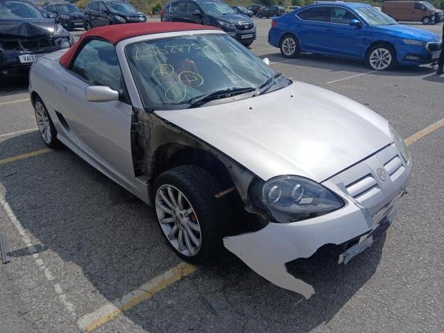

Step 1 compleated. Purchased a MGTF 160.  48K miles front end damage.
All Being well then next photo will be on my drive. Between now and then I need to learn how to extract a motor from an MGTF.
It looks like its in good nick, and I have a forend who is intersted in some of the bits.
image.jpeg.ba07597515d262d346b7905e87fd97a7.jpegA
Door mirrors are the same as Elise, Exige and Europa S.

Were Rover still tenuously BL at that time - if so leave it outside over the remainder of this winter, it will have totally rusted away by April ! 😉
What a great find. Good for at least another 50k miles. Are you going to put a new head gasket on it when it's on the bench and easy to do?
