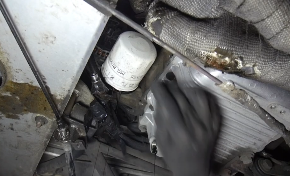

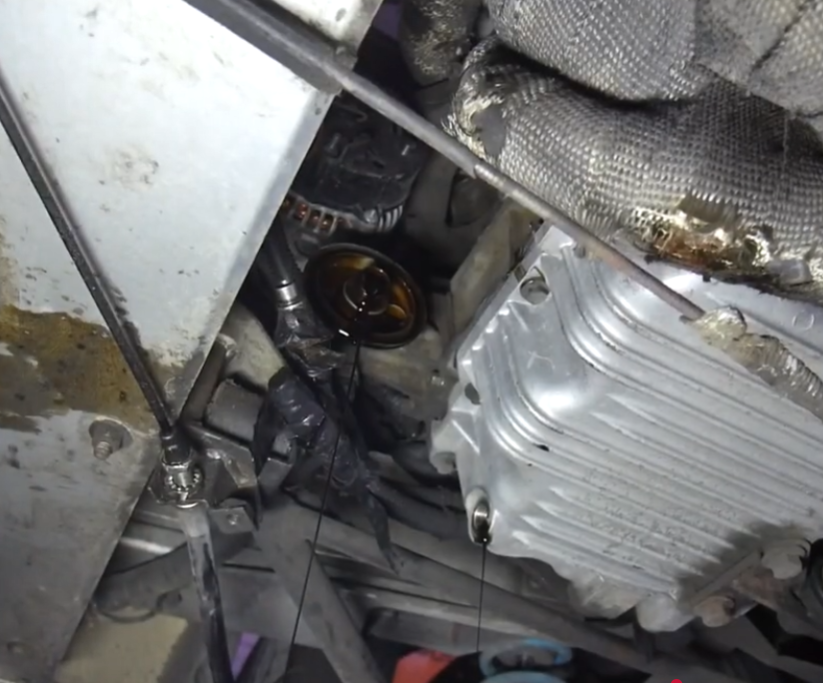

Is the oil filter really different?  Or did we decide your original engine is from a 111S which has an oil cooler, that would have a different oil filter housing.
Posted
It has got an oil cooler. But not sure if the setup of the MGTF 160 and 111S has the same config.
Any pictures off 111S setup welcome :)
Ill go google.
Posted
Just got this of a Video of a S1 111S oild change
image.png.4d0201642b77a3eb9908051226c96529.pngIt Does look very similar to what i on the MGTF
Dont know if I am having a perspective issue.
I know the motor from below from doing oil changes, and from above. But it can look a bit different when its on the garrage floor...

The oil filter looks to be in the same position as the one I have with an oil cooler.
