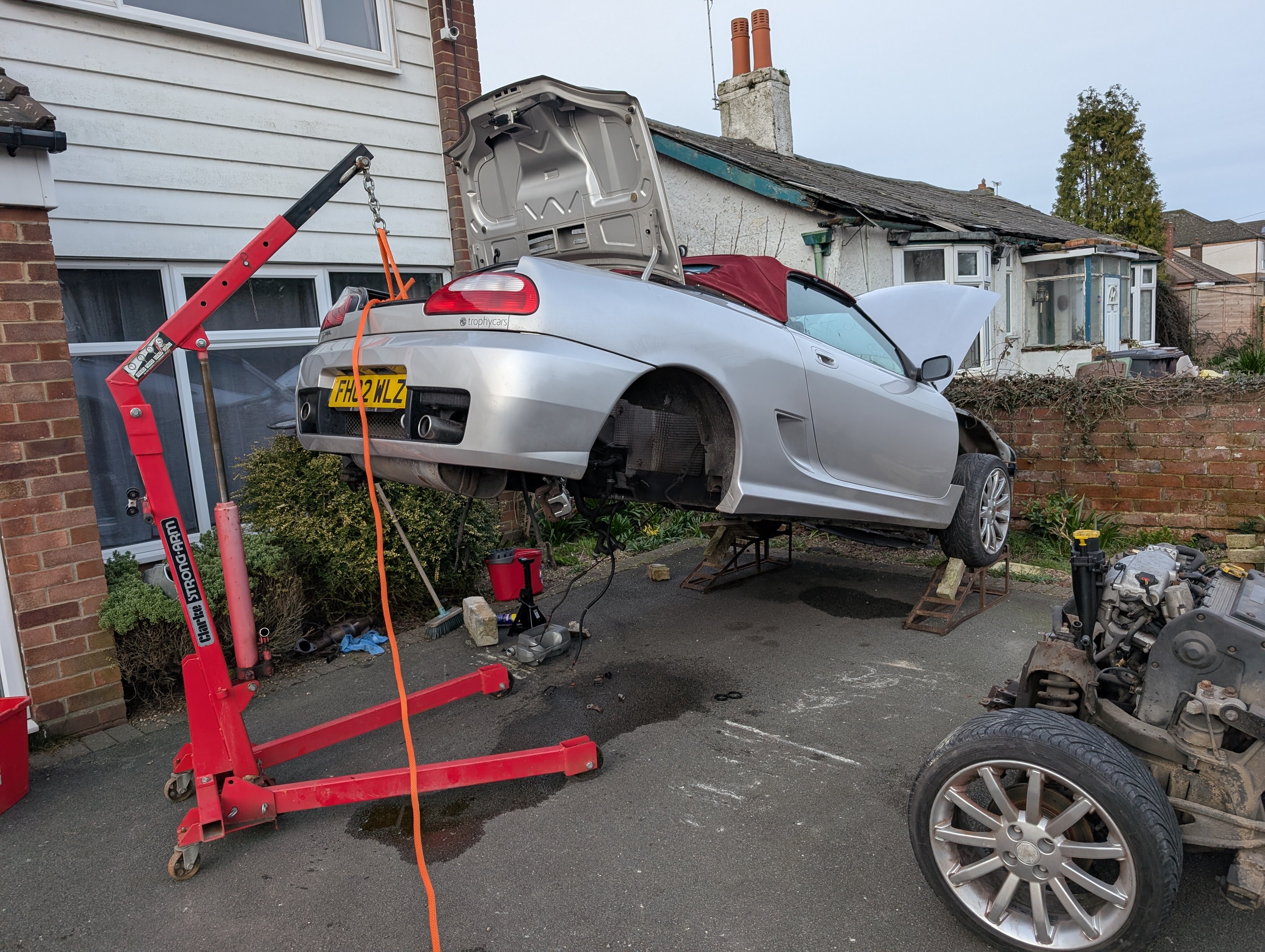

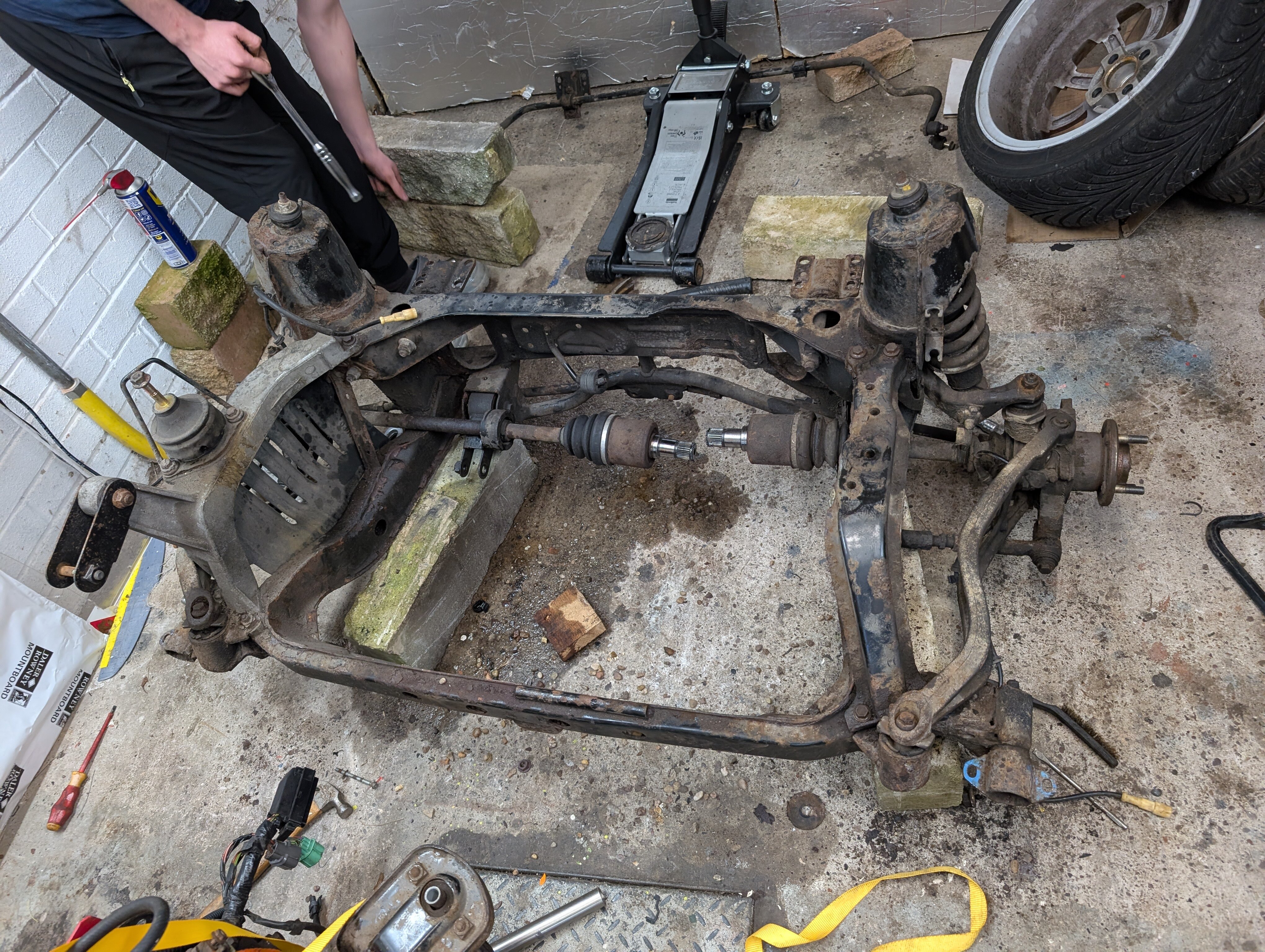

Hello Guys

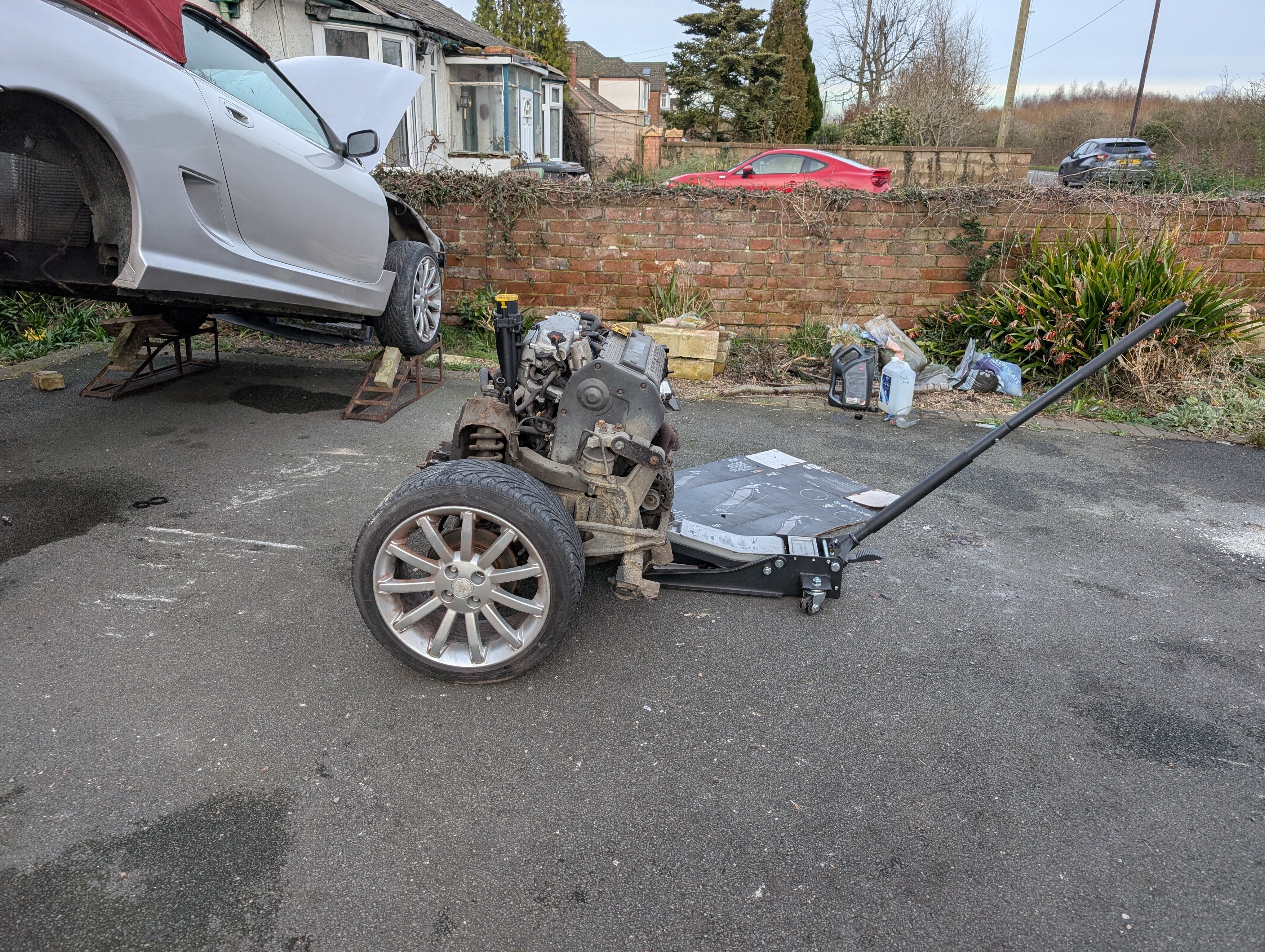

Some good progress yesterday.
The motor has been dropped out the MGTF and is still sitting on the subframe on my drive.
Hope to get my Elise in a friends Garage so I can get the subframe in my garage to strip it down further.

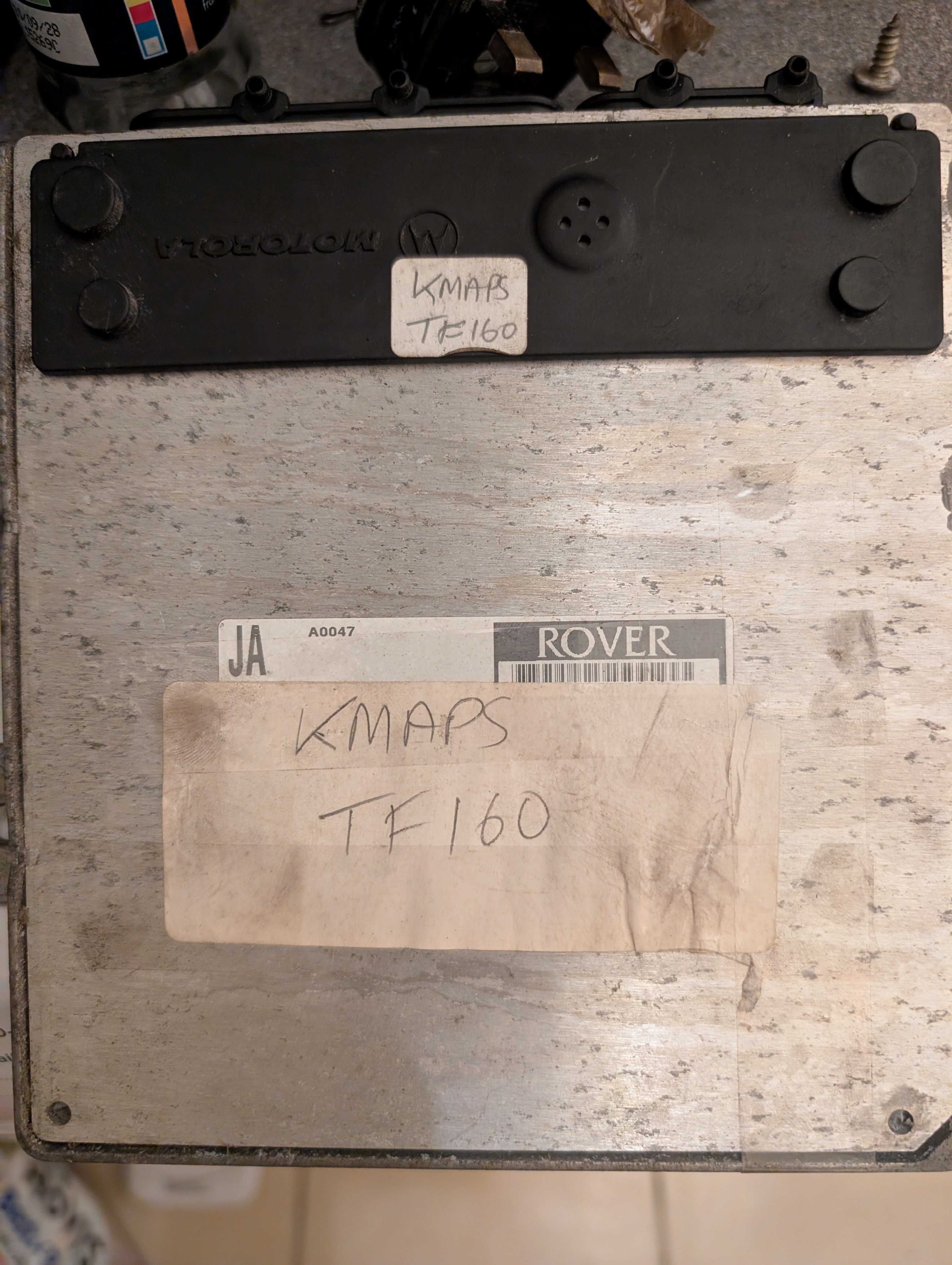

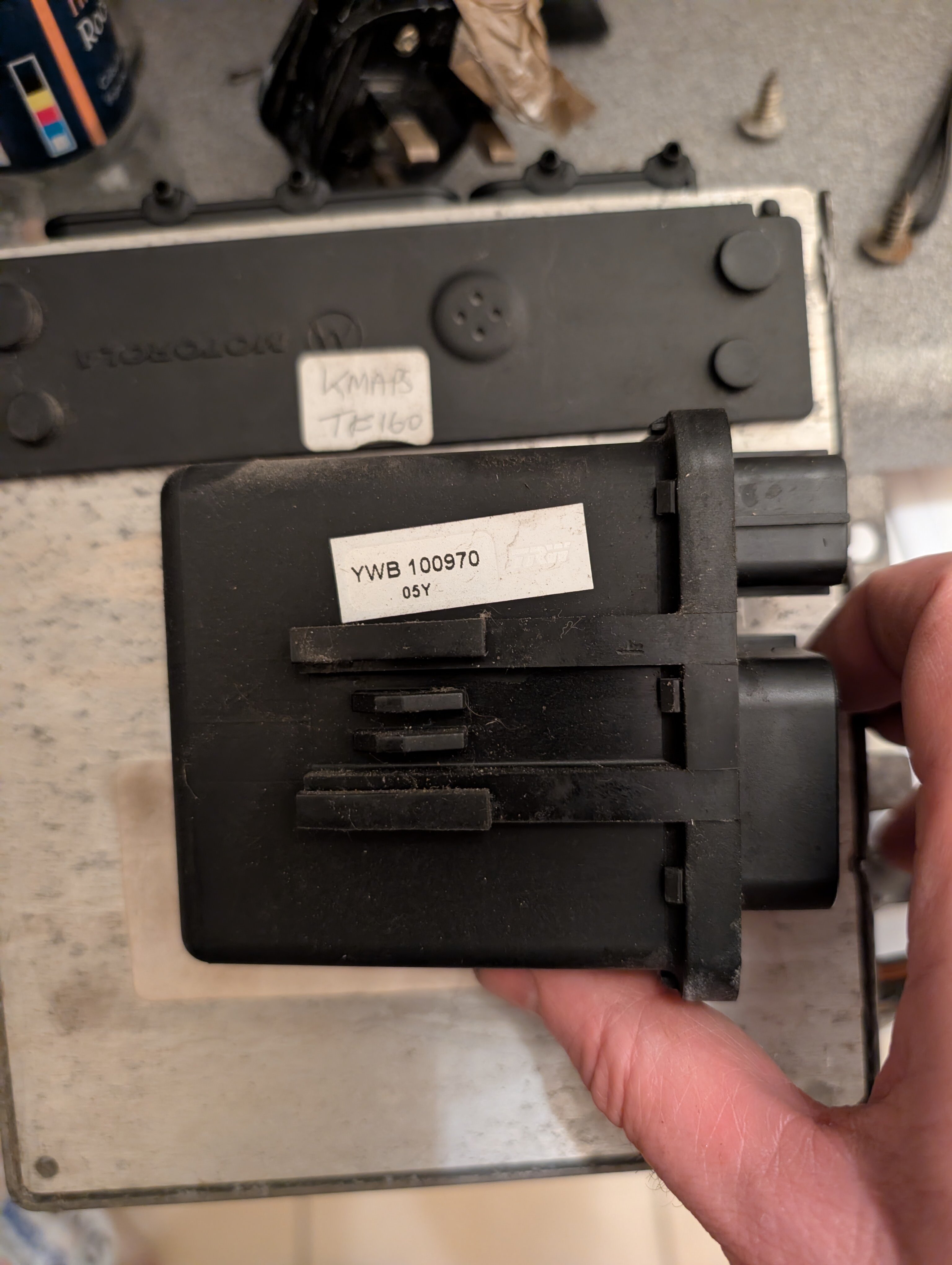

I though it interesting to see the ECU had been to KMAPS.
So now to see what can be used on the Elise and get rid of the rest.
Posted (edited)
The process to Drop it wasnt too hard.
I have watched some Videos on youtube and took want I could.
Rear Brake caliper removed from and Cable tied to the body.
Hydrolic Clutch, 4 x larger diamiter water pipes disconnected.
The ECU was removed which helped to seporate the engin look and body loome.
Hand Brake,Earth, Throttle Cable, Vaccume lines, disconnected
Airbox removed .
Probably more...
Then we started to remove the bolts to the subframe.
The car was on Axle stands and Ramps at the front.
We put a piece of wood spanning the sump and geabox,  and jacked to touch.
the forward bolts all sheared. one started to turn, but then just sheared.
The rear were a bit of a pain. there was one covered byt the anti Role bar.
AS it came loose we dropped the car down onto its wheels.
Engine crane was attached to the body that the Boot latch is on. (Boot latch is way to week).
We Slowley ligted the back with the engine crane. until it was clear.
The plan was to pull it all sideways. That didnt work.
So we lifted higher until we could rotate the subfraim around the right rear wheel.
Edited by William D8on

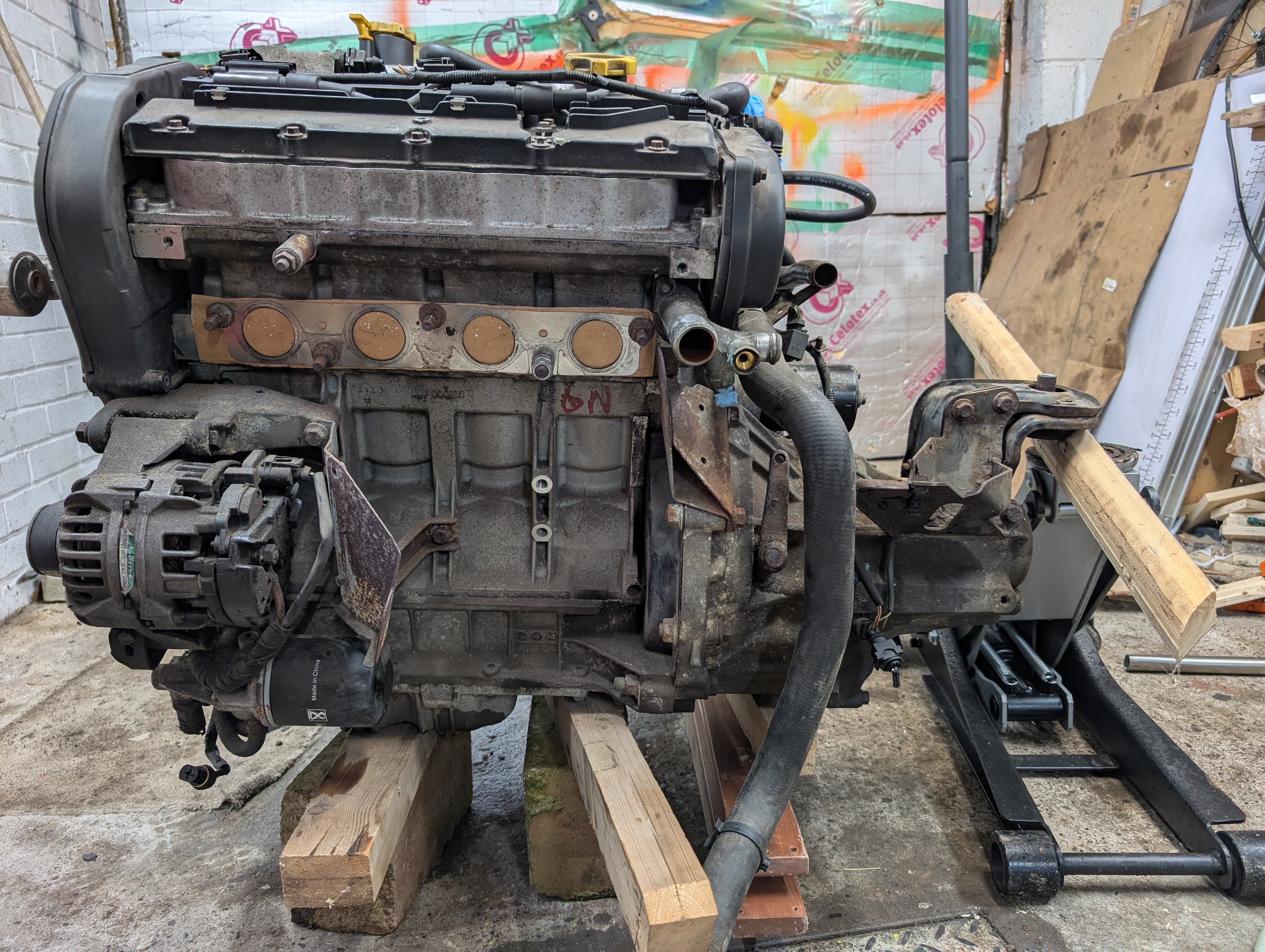

Posted

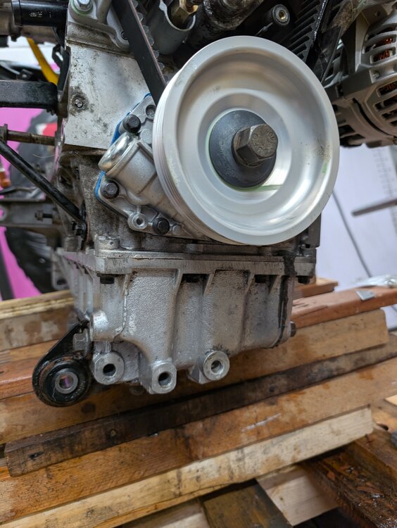

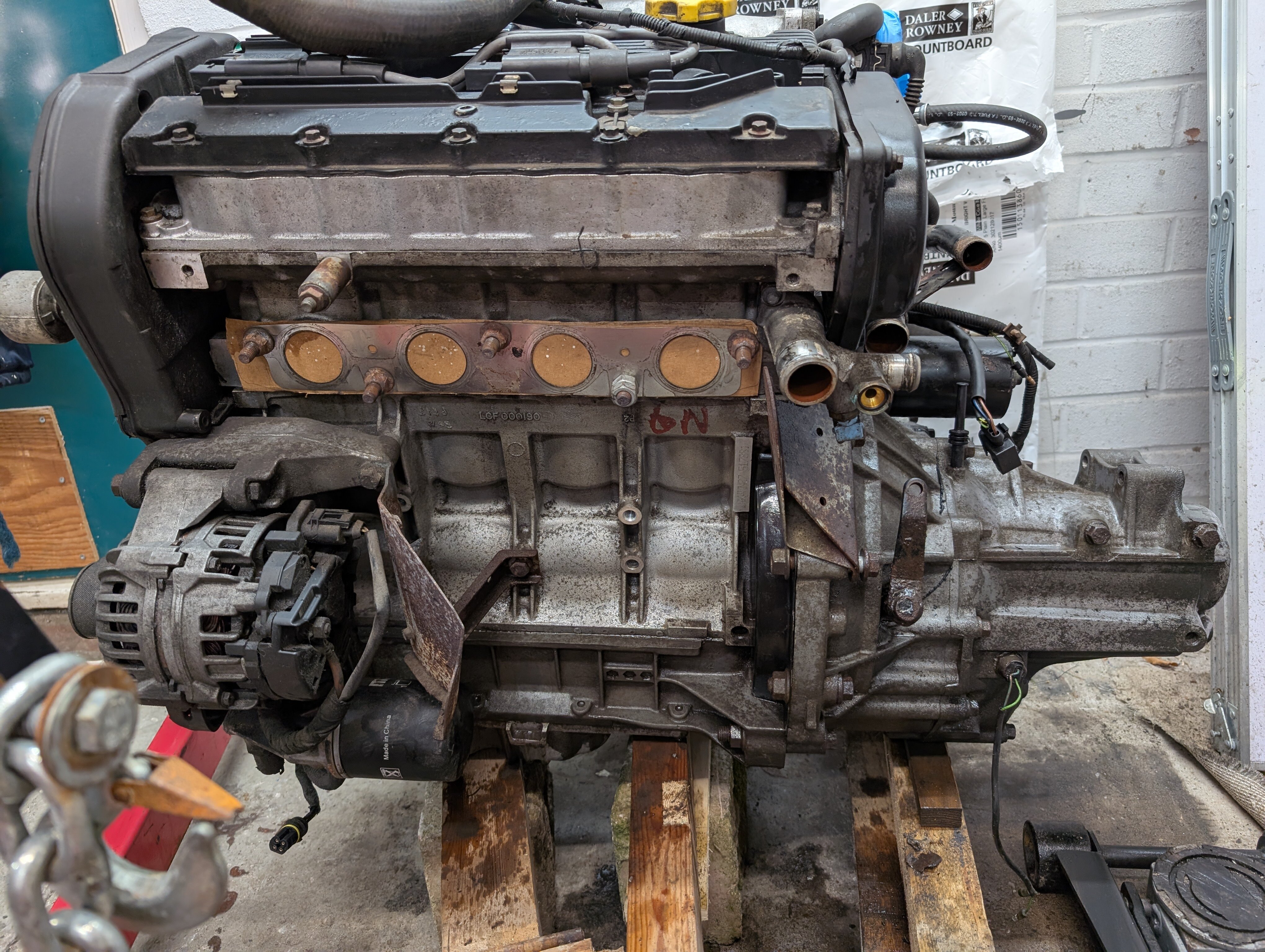

Some weekend Progress,
Not Much but the motor is off the subframe.
Now I scratch my head and consider what else do I replace before I put it in the lotus.

Posted
Definitely do the belts while you have the engine out.  Water pump just because it is cheap and easy to do now, harder to do later, and you don't know how old it is.  Or do you?  Do you know the current head gasket is OK?  Or definitely not OK?  I'd probably change it if I knew it was the original one, they just weren't good enough and if it hasn't already let go, it will soon.  You know you want a sneaky look ;)  I wouldn't do the rest; IMO there were a lot of things tried to stop the head gaskets going, but mostly it just needed better head gaskets.
I wouldn't mess with the alternator unless it looks really bad.  So hard to get a replacement that will be any better than an old original one.  The regulators can get fried in Elises which have more powerful engines, and particularly with modified exhaust manifolds and not enough care to heat shielding, but the alternators themselves last a long time.  Think about switching round the big mounting bolt so you can get it off the car easily if necessary.
Does the MG have the C4BP gearbox?  Lots of people put those in the Elise to get shorter ratios, good for acceleration, not so great for the motorway.  It might have seen a lot more shifts and be even more worn than the one have now.  The other question is which gearbox do you have now in the Elise?  Is it the B4BP (close ratio) box?  Considered desirable, but possibly annoying if you're not doing a hill climb.  I'd pick the long box for a fairly powerful car on the road (maybe not for track) except you don't have one (yet!).  Perhaps best to drive the car for a bit and then take it apart again when you know what you really need to change (there'll be no end to it!).

I still need to get the 5AS out of the MG TF... Or do I.. The MG TF never seemed to have a imobilisor, well not the same as the Lotus.
I need to understand what I need to get to combine the 2...

A Lucas 5AS is paired with each K-series engine.  The easiest thing is to keep the two together, paired units just plug together and work.  Without a paired unit the engine won't run.  It is possible to pair a new unit or to have the ECU flashed to a different unit or even to not need a Lucas 5AS, but money and effort.  When secondary alarm systems were fitted, as on most Elises, the Lucas unit was configured into a permanently-disarmed state and the fobs were taken away.  It has still been known for them to wake up and immobilise the engine, but quite rare.  A poor earth from the Lucas 5AS can leave you immobilised, though.

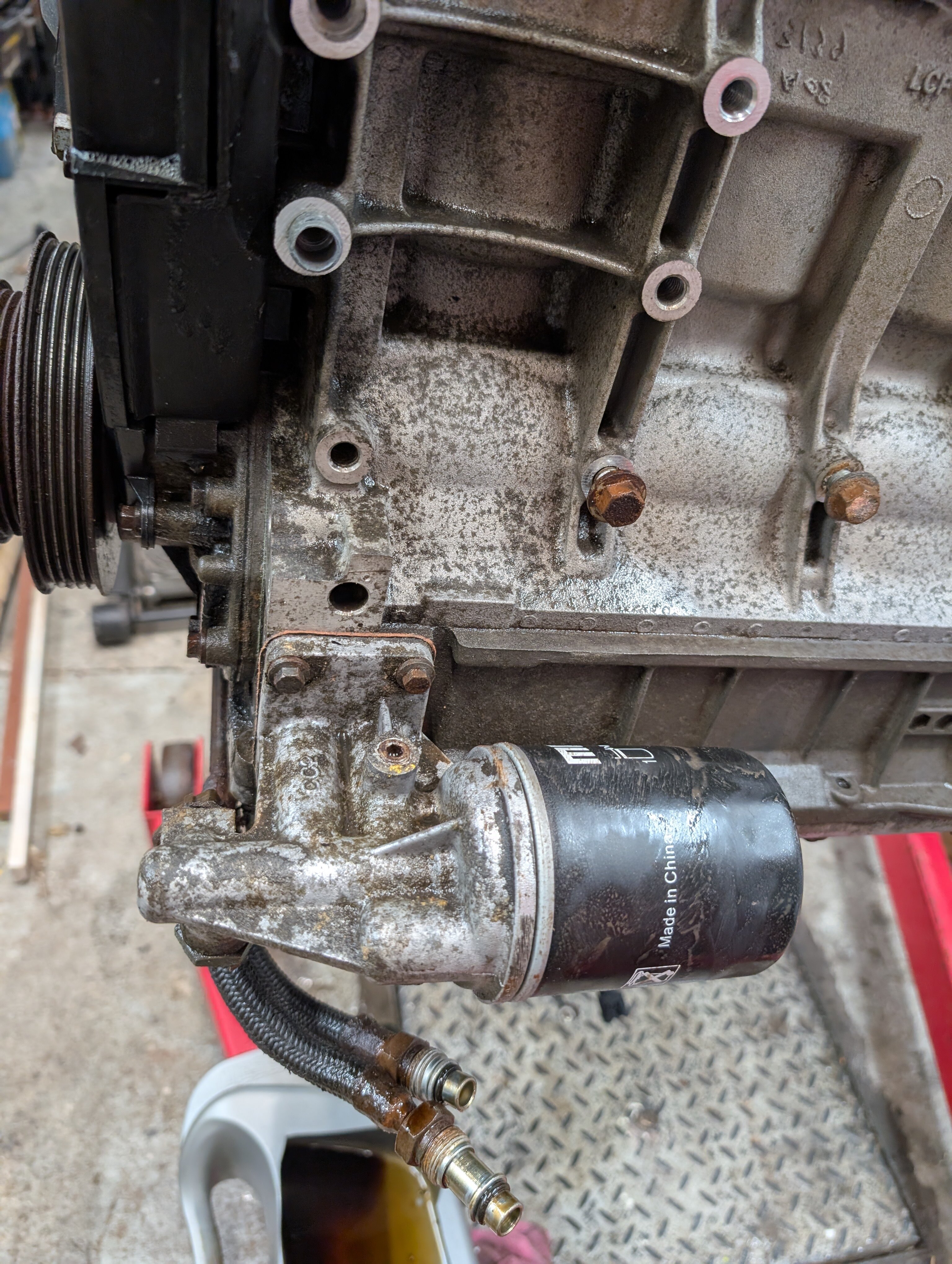

Spent time cleaning the motor. Using the Gunk first, wasnt great, so got some Trafic Film remover as advised by a machanic.
It getting there..
Removed the altinator today, if I am keeping it I think it could do with a good clean.
I have ordered a set of S2 silicon water pipes from Roosemotorsport and I have bought the timing belts and water pump.
Everytime I look at the motor I think of more things to replace.
Need to get an alternator belt! (Well thats what on my mind right now.
I need to look at getting the lotus oil filter kit. The MG has the filter in a different place, so need to purchase the lotus version, and understand if there is somthing else needed for compatibility.
