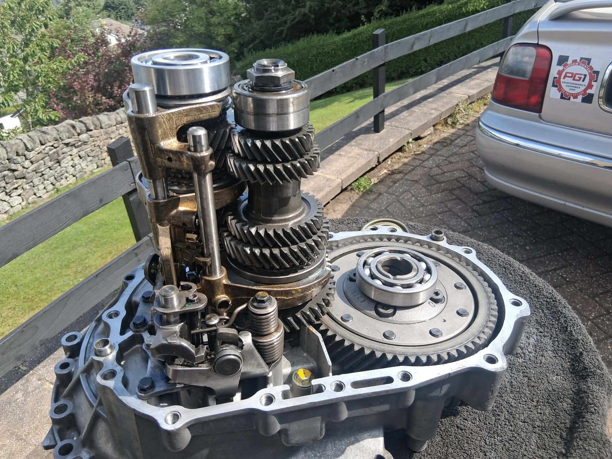

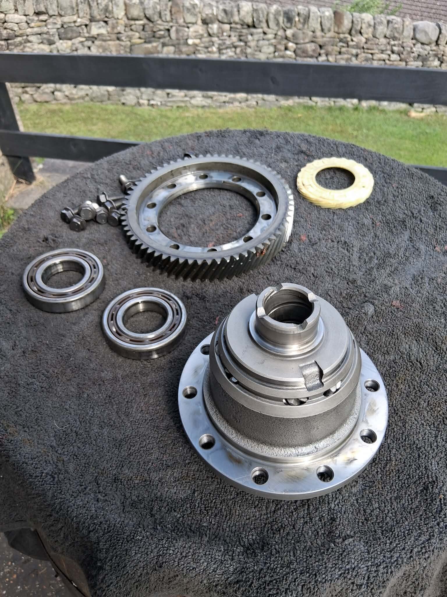

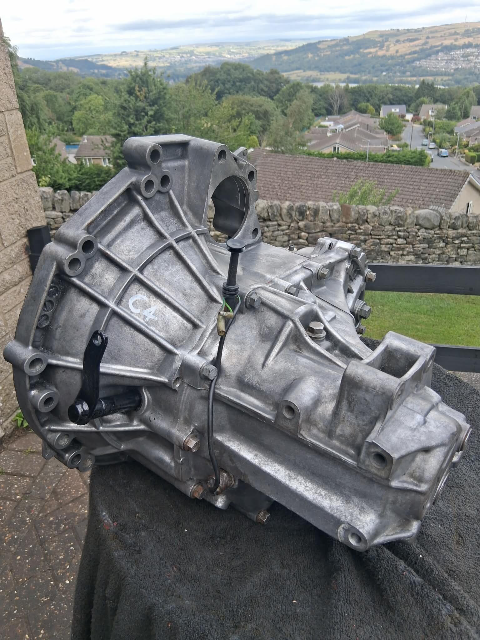

William D8on Posted June 29 Author Posted June 29 Small Piece of progress. The Gearbox has gone to the Soda blasters... lets see if we can get this moving again. Even if little Bits. Things I need to consider and apreciate input. 1. Nitron yes or no. curently on the stock bilstines. 2. ECU. Stock or Emerald or Other if stock who can I take it to to reprogram so I can keep my lotus 5AS? and maybe yweak as required. if Emeral, how does the imobiloser even work? is it much better, or do you need to upgrade to the better Lamda sensors before it really comes in. If Emeral can you have swappable maps on a button? If Other What. 3. Then there is the steel work. Who can I drop brackets and fastners off to get them re coated? or just invest in my own chemicals? Quote

William D8on Posted July 13 Author Posted July 13 Gear box has now gone to be rebuilt. Big conversations about gear ratios. What Ratios would you guys think is good for Track and motorway. I am thinking Close ration 1 to 4 for track and a long 5 or the motorway. Quote
DeanB Posted July 13 Posted July 13 2 hours ago, William D8on said: Gear box has now gone to be rebuilt. Big conversations about gear ratios. What Ratios would you guys think is good for Track and motorway. I am thinking Close ration 1 to 4 for track and a long 5 or the motorway. Sounds good to me. Quote
Lithopsian Posted July 14 Posted July 14 Do you know what gearset is in the box right now? Or is it entirely up to you what you put in there? Quote
