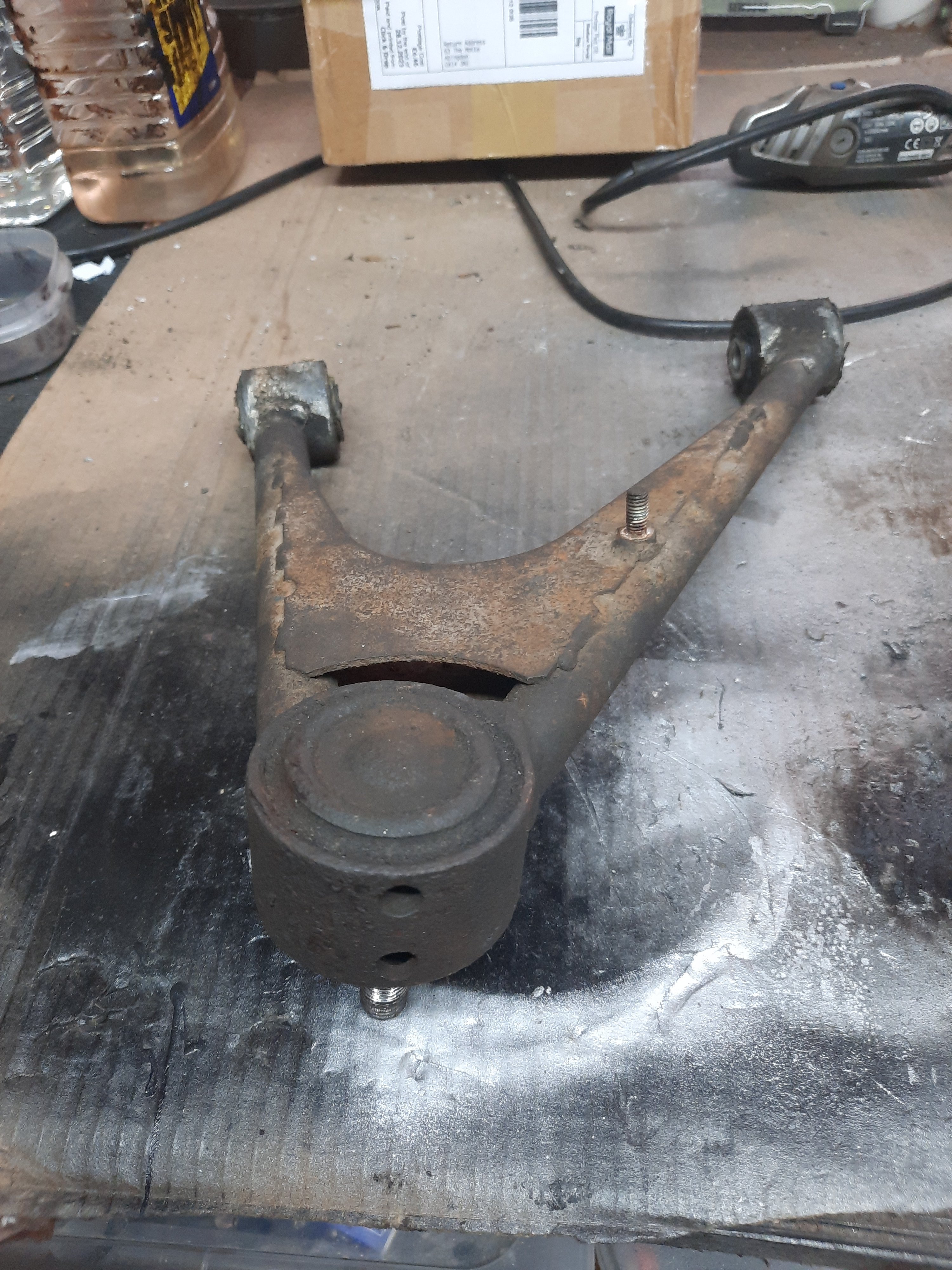

Badger02 Posted December 29, 2023 Author Posted December 29, 2023 Now I have to make my mind up, do I: Shotblast or Deox C to remove the dirt/rust, then Kurust/hammerite or get them plated. Zinc plating seems to be the best long term solution according to my petrolhead friends, though I've no experience with it, so unsure at the moment. Have been told to avoid powdercoating as not very resilient to stonechips

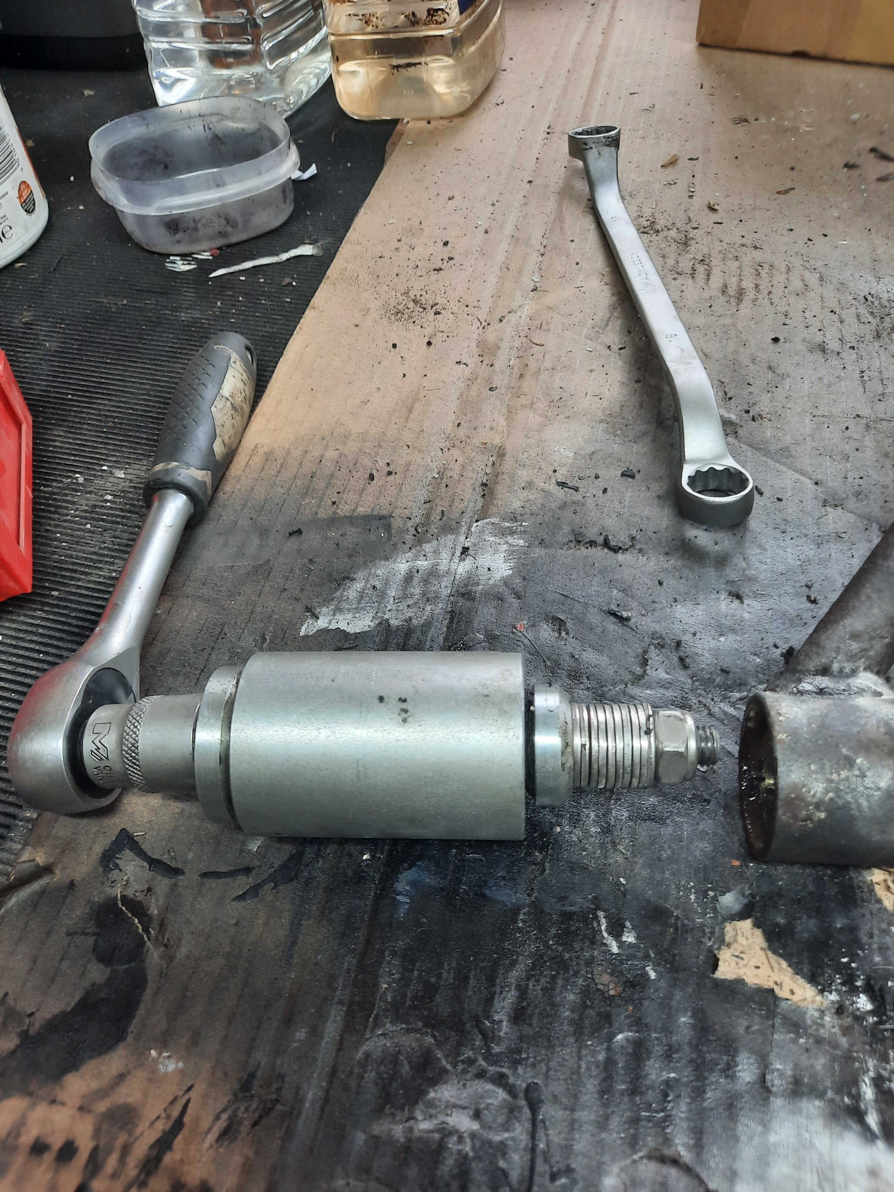

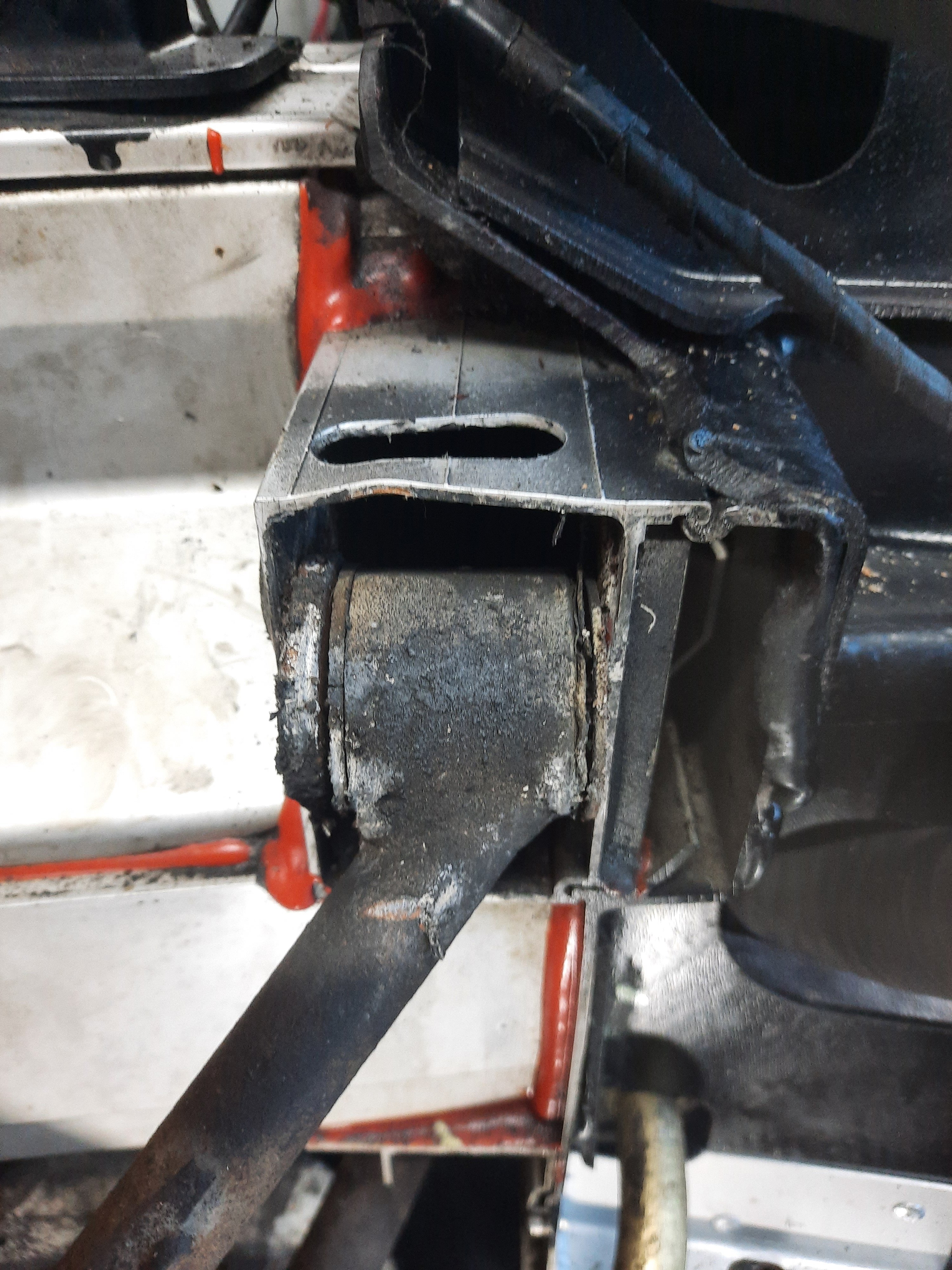

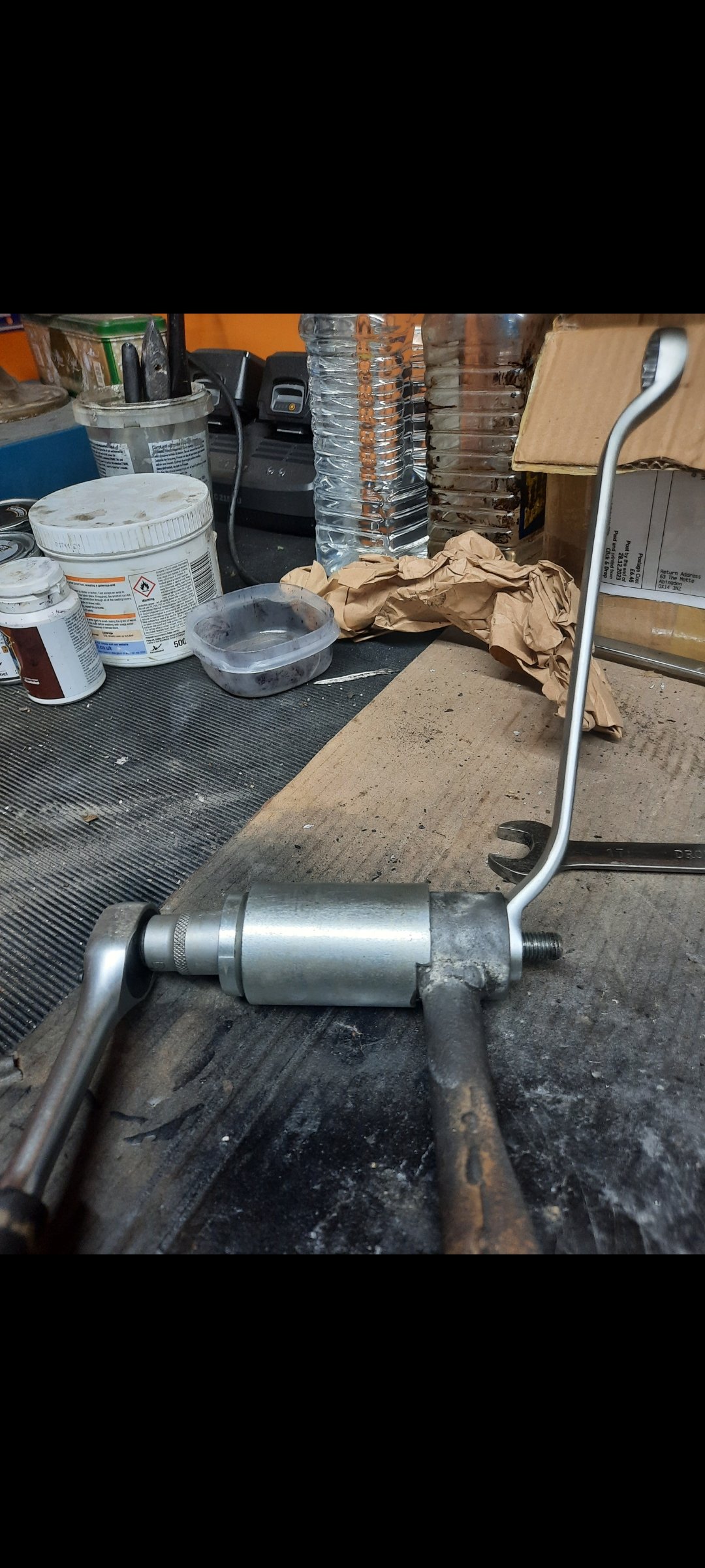

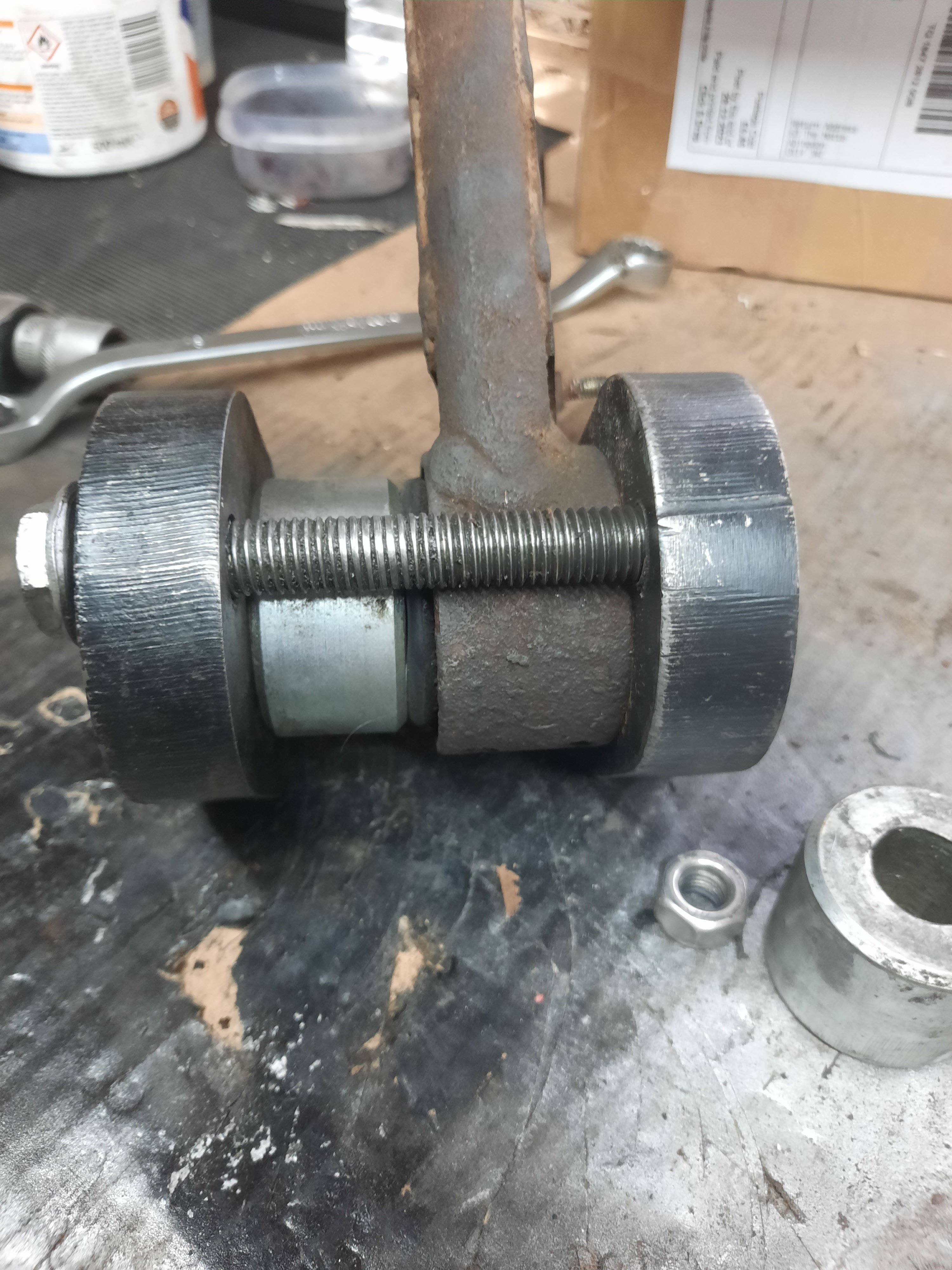

Badger02 Posted December 31, 2023 Author Posted December 31, 2023 Removing the wishbone bushes The bush will then be in the sleeve, the sleeve has a hole in top, put a screwdriver through the hole to push the bush out of the sleeve

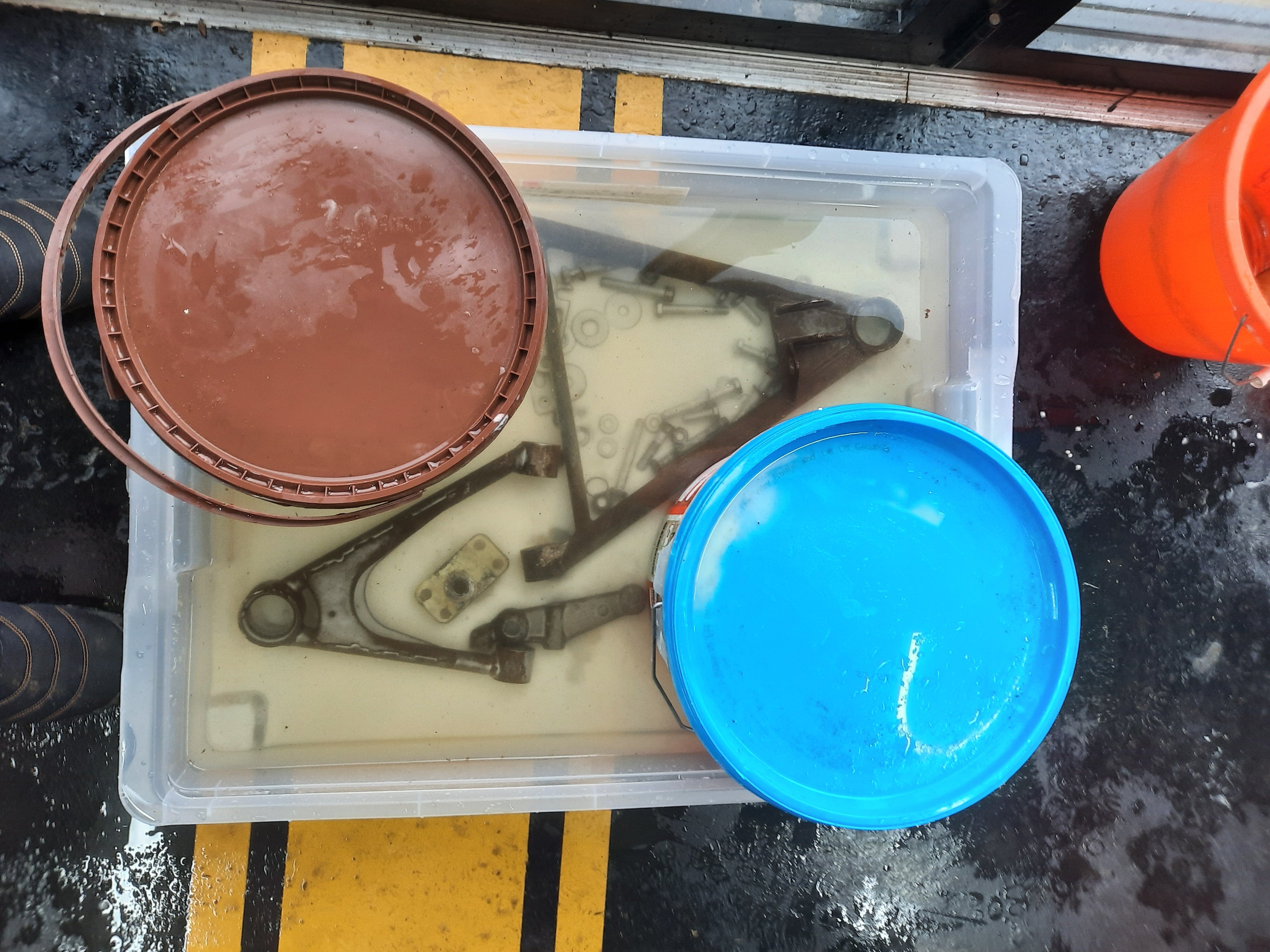

Badger02 Posted December 31, 2023 Author Posted December 31, 2023 Wishbone set now in a mix of Deox C and water with a ratio of 1:8. Will see result in a couple of days. If no good then I might shotblast them
Lithopsian Posted December 31, 2023 Posted December 31, 2023 I can see signs of the original galvanizing on those wishbones! Must have been living inside a low-humidity cocoon

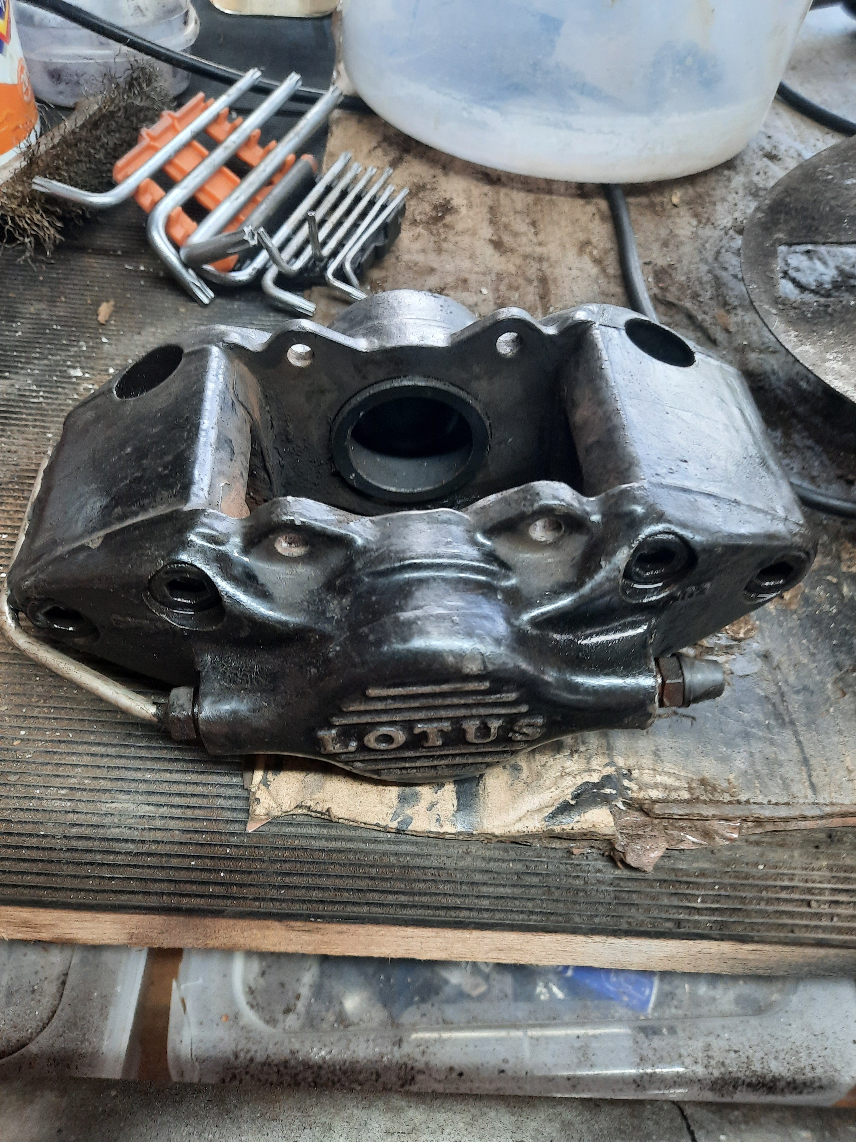

Badger02 Posted January 1, 2024 Author Posted January 1, 2024 Decided to repaint the brake calipers as well as they look dull. This was the condition when i removed it, have applied some paint stripper but boy that paint is tough, going to take some scrubbing with a wire brush before it's ready for a fresh coat

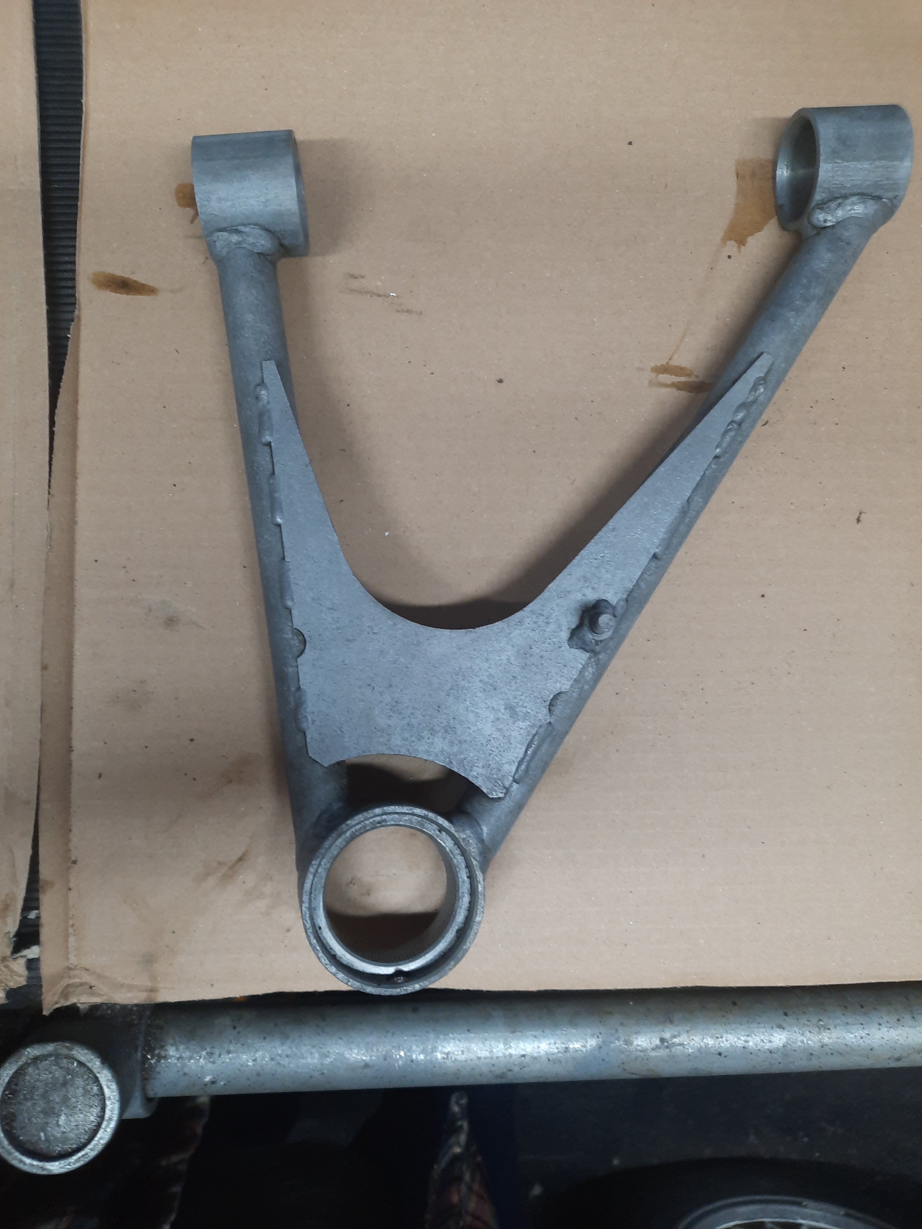

Badger02 Posted January 2, 2024 Author Posted January 2, 2024 Deox C has worked its magic on the wishbones. Amazing product which I only recently found
Mutley00 Posted January 2, 2024 Posted January 2, 2024 Looking good! I wouldn't Hammerite them though as it chips off just like powder coating. We've just got a thin layer of waxoyl on ours, but we don't run them in the wet.
