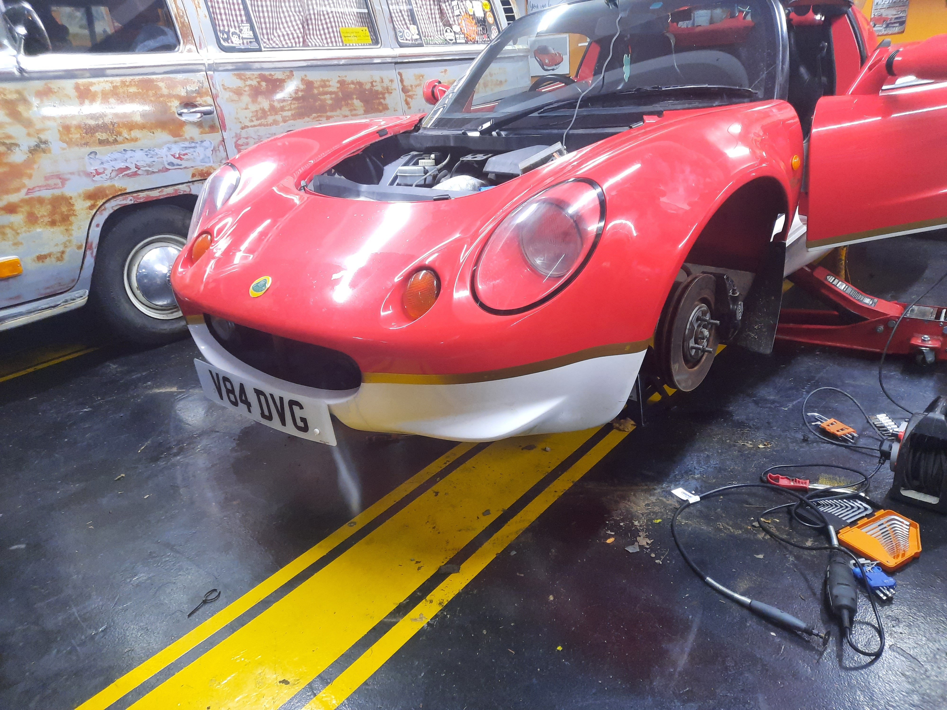

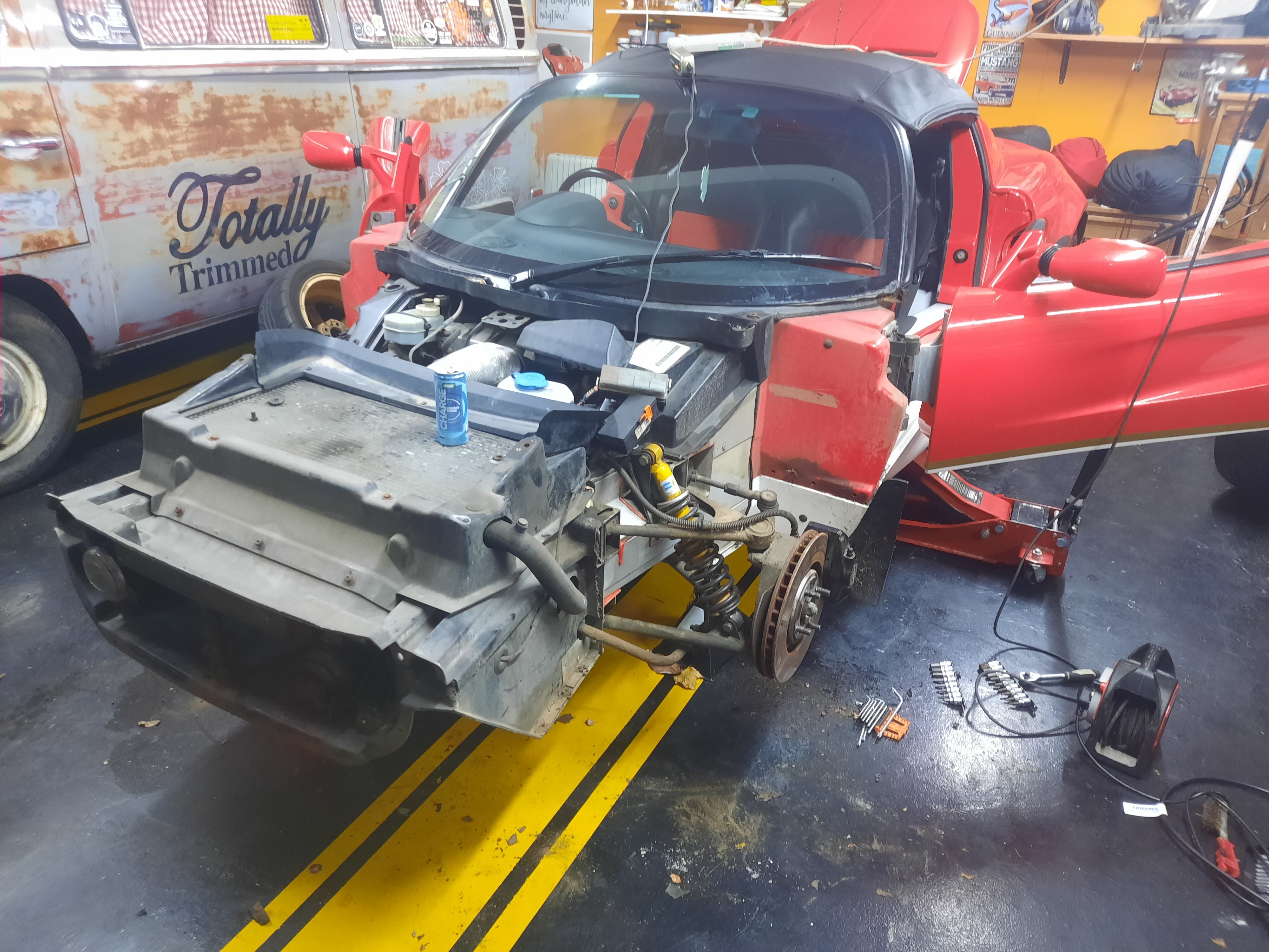

Badger02 Posted November 19, 2023 Posted November 19, 2023 And so the winter refresh of my S1 Elise started today. Hoping to take front clam of tomorrow. However of the 4 lower bolts that hold the lower rear to the chassis, 2 are spinning and 2 won't budge despite copious amounts of penetrative oil over the last few months. The Eagle eyed will spot my Dremel tool which I'm not looking forward to using to remove 4 bolt heads that have limited access. Currently on my list are replacing the driving lights brackets, shot blast and paint the tow post, new front badge, replace all fluids, replacing leaking drivers side transmission seal, shotblast and paint the wishbones Probably change the radiator to, and fix/replace whatever nasties I find with the clam of.

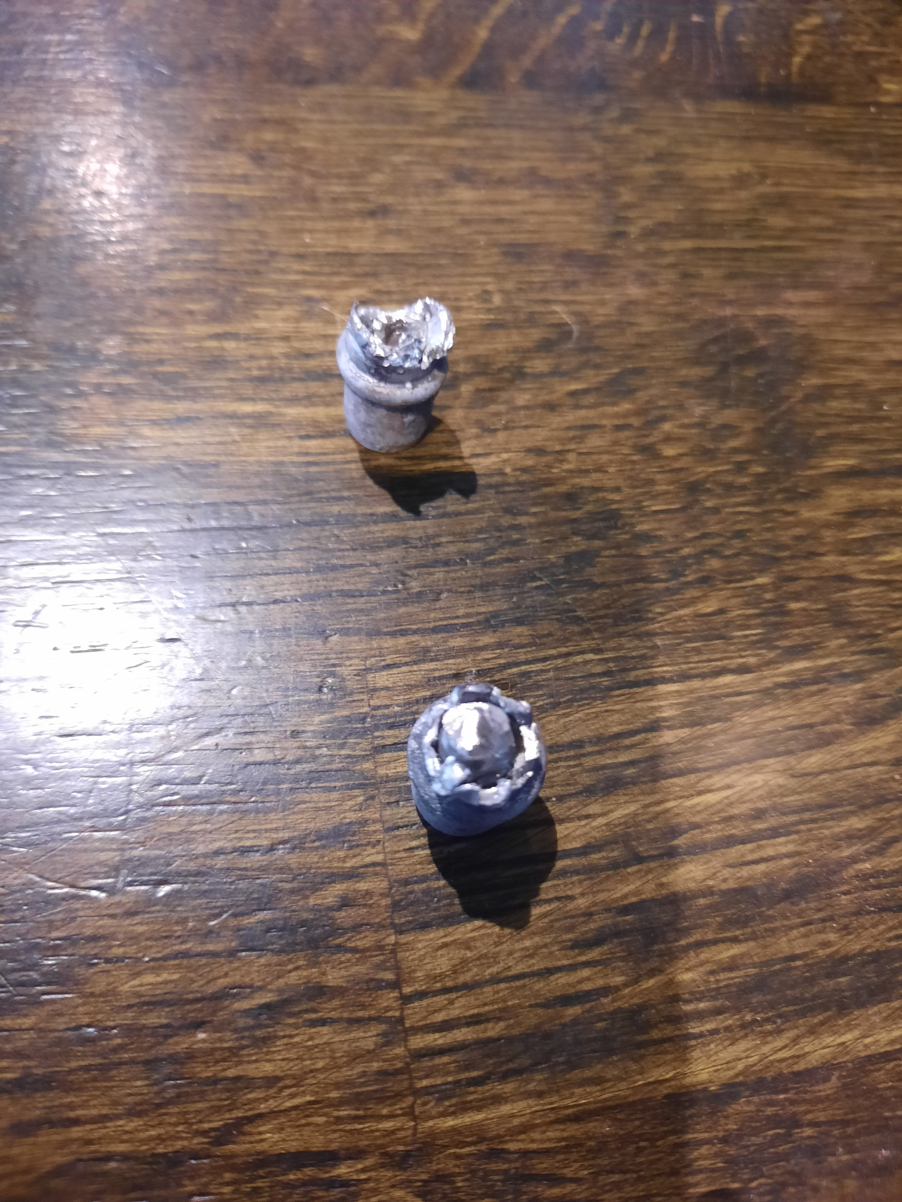

Badger02 Posted November 22, 2023 Author Posted November 22, 2023 3 hours ago, Lithopsian said: Dremel? Not for the clam. Managed to remove the shims which gave enough wriggle room to move the clam lower parts sideways and then lift the clam of. However all 4 bolts are spinning so I need to mull over what to do about them but at least I have easy access to them now. It's a different story with the rad shroud. Of the 8 or so bolts that connect it to the rad/crash structure not one of them is playing ball, so that's dremel time

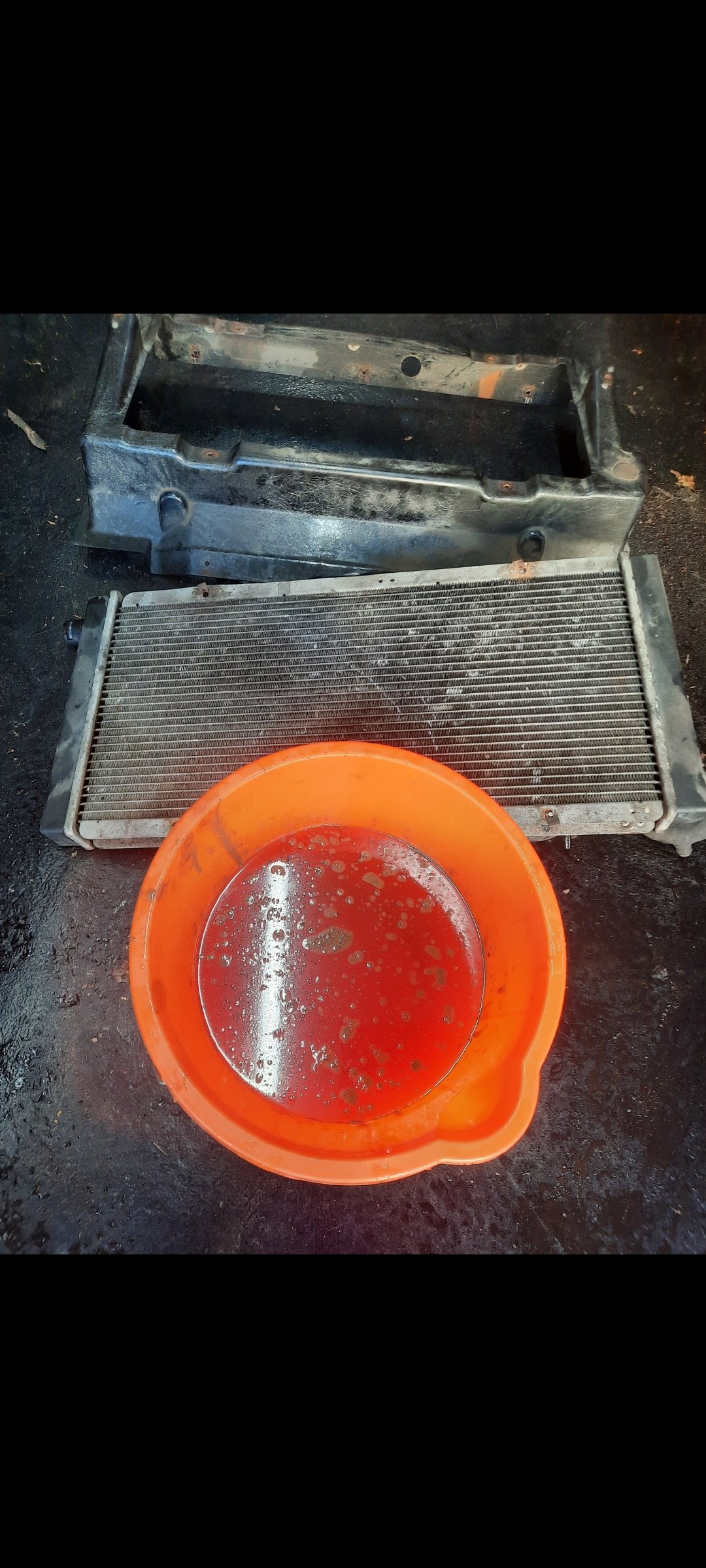

Badger02 Posted November 24, 2023 Author Posted November 24, 2023 Finally the radiator and shroud is of. Every single fastener on that bloody car is made of mild steel and rusted to hell. My dremel mini grinder has been working over time. The not good news is some oil in the coolant. When I fit the new rad, I'll do a few flushes and then keep an eye on it I think

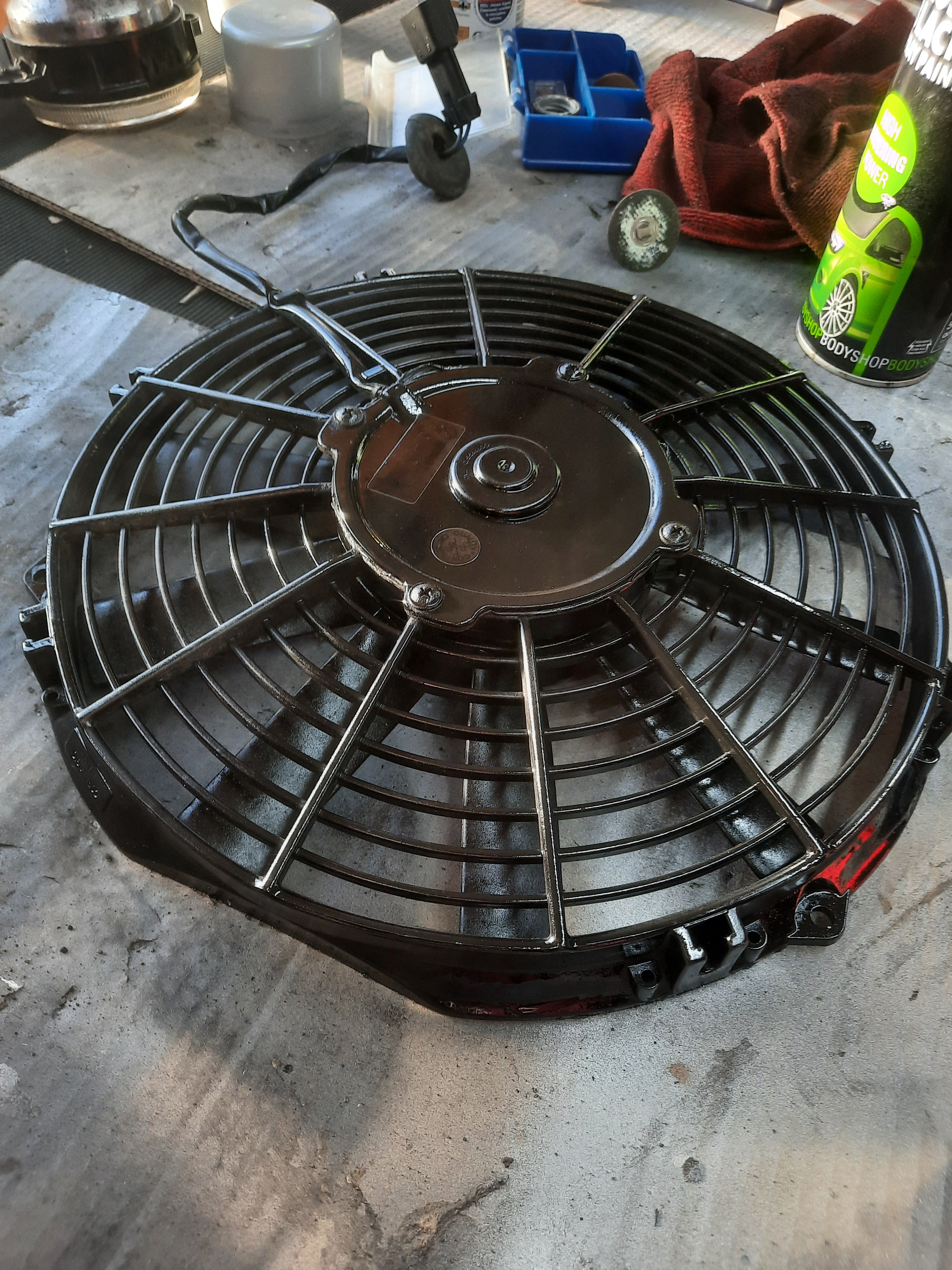

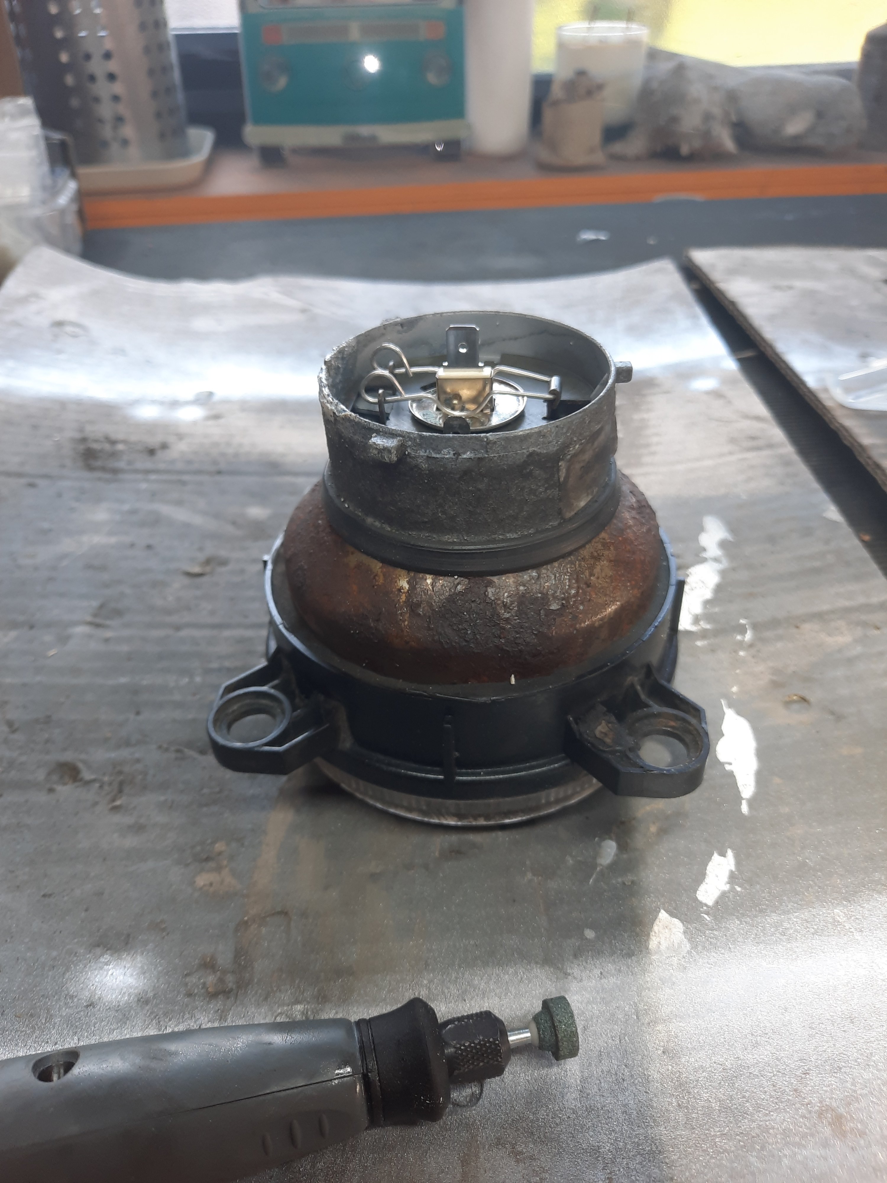

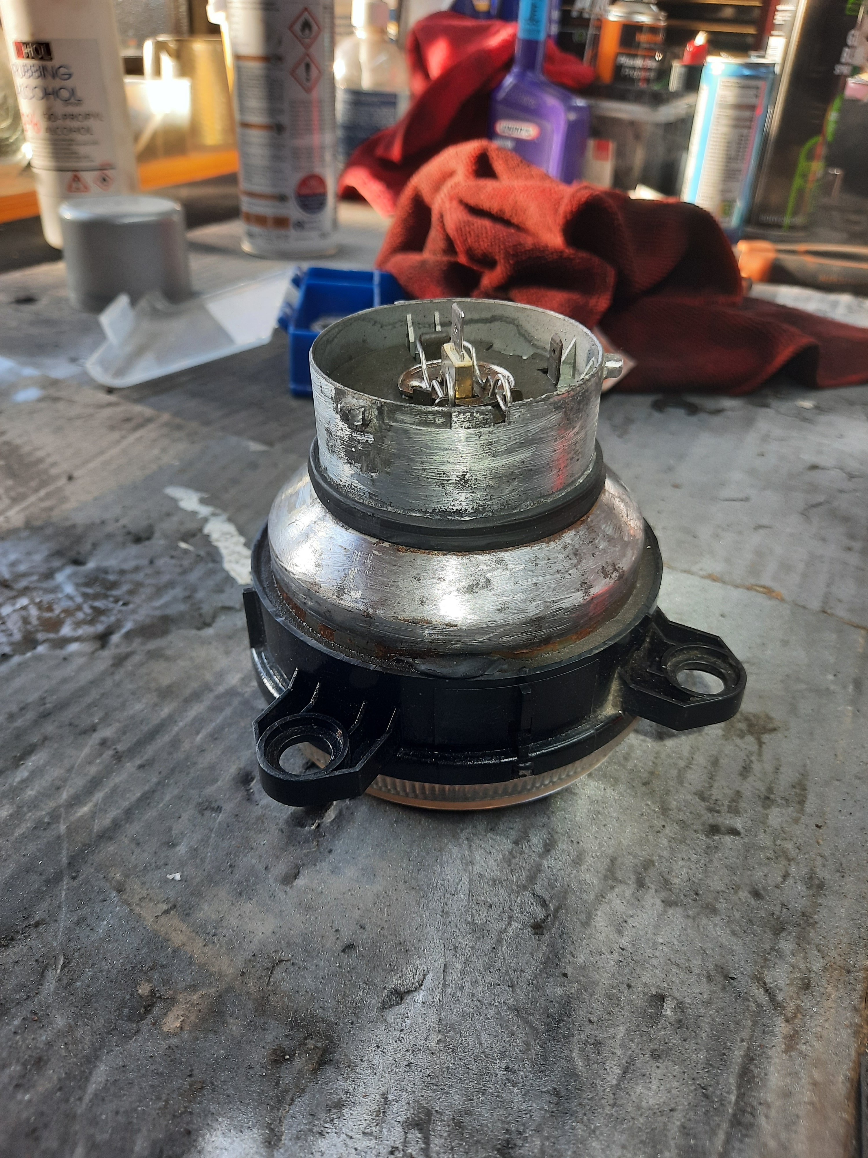

Badger02 Posted November 25, 2023 Author Posted November 25, 2023 Step by step progress today. One 24 Yr old fan came up good with a fresh lick of paint. Driving lamps benefitting from a derust, but bolt on underside spinning in riv nut defeated me today

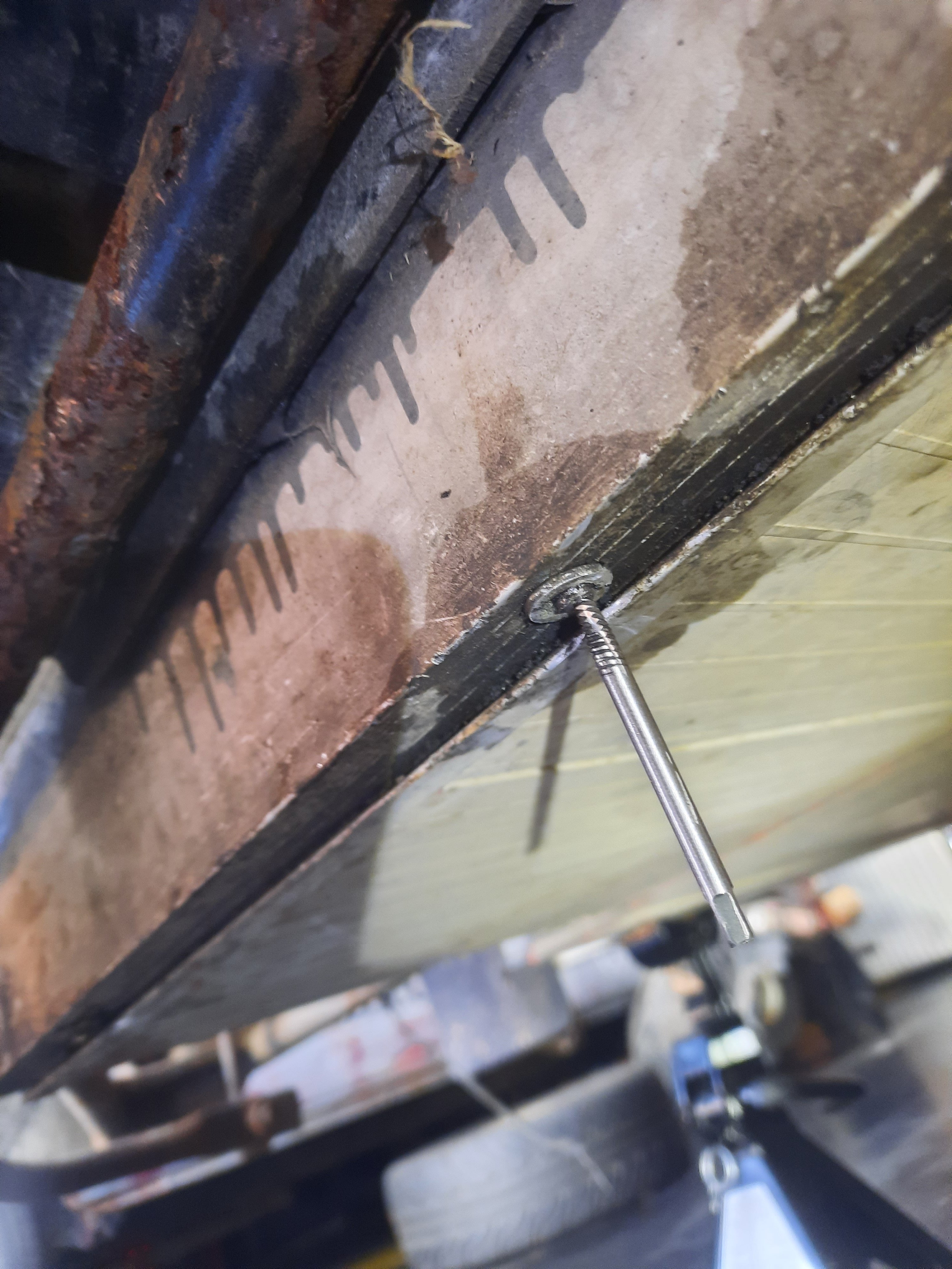

Badger02 Posted November 26, 2023 Author Posted November 26, 2023 Rivnuts for front undertray are out !

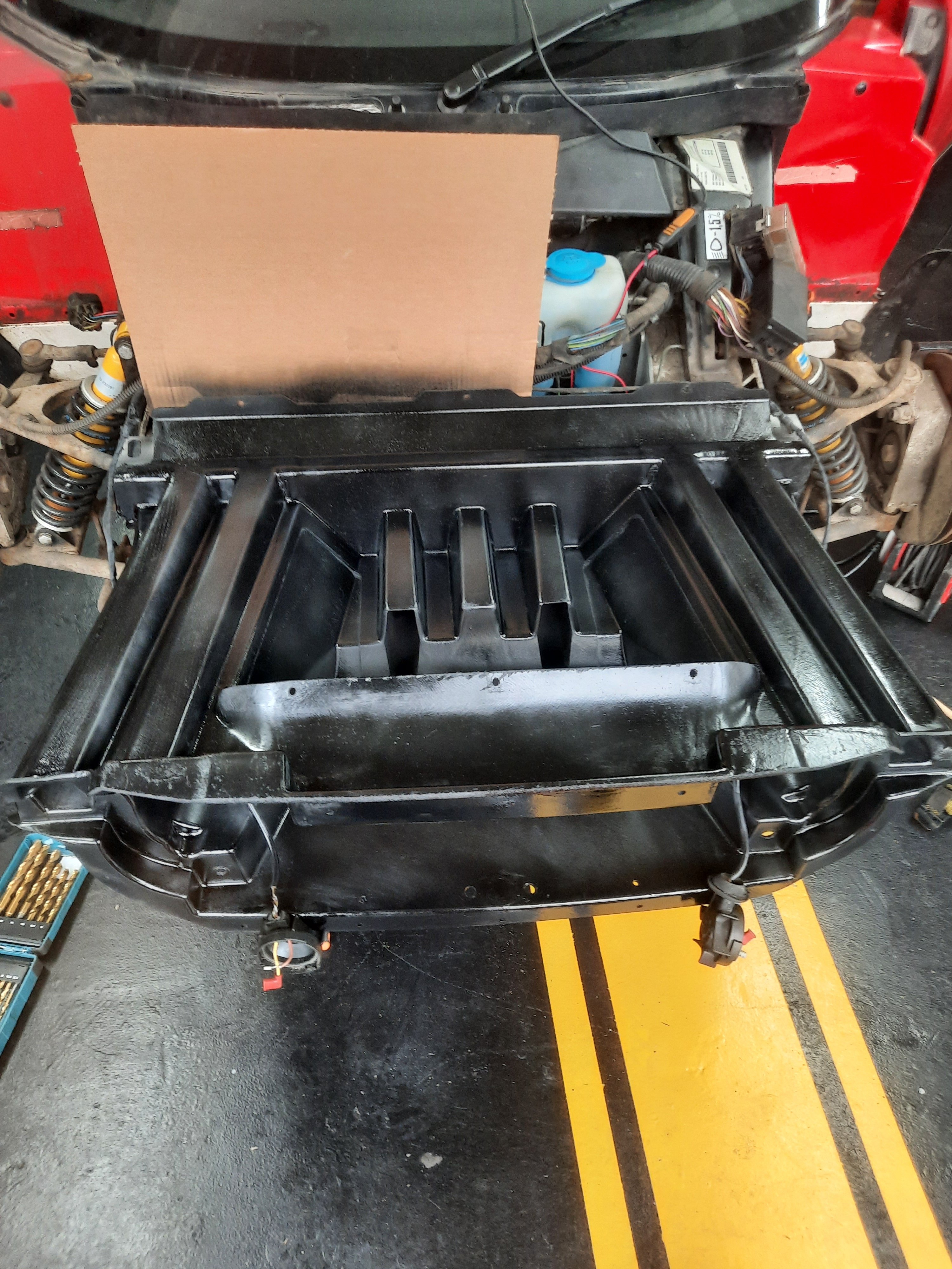

Badger02 Posted November 26, 2023 Author Posted November 26, 2023 Front crash structure painted. Hope to get the driving lights with new brackets installed later today, but now of food shopping as have 6 friends coming for Sunday lunch and I'm making the dessert !!!
Lithopsian Posted November 28, 2023 Posted November 28, 2023 If those clam bolts are spinning the captive nut inside the sill has come loose. You'll probably have to cut your way to some access, both to retrieve the existing nut, and maybe a but bolt, and to provide for some new fixings. Probably bonding in a new bighead nut. Somehow I don't think a bug scrivet is the answer! At least you can make the nut and the bolt both stainless steel and not worry about them ever again.
Badger02 Posted November 28, 2023 Author Posted November 28, 2023 2 hours ago, Lithopsian said: If those clam bolts are spinning the captive nut inside the sill has come loose. You'll probably have to cut your way to some access, both to retrieve the existing nut, and maybe a but bolt, and to provide for some new fixings. Probably bonding in a new bighead nut. Somehow I don't think a bug scrivet is the answer! At least you can make the nut and the bolt both stainless steel and not worry about them ever again. To get access into the sill to retrieve the loose captive nut you can remove the coin trays which reveal a hole and stick a bendy magnetic to fish out. And it seems most people replace with a rivnut
