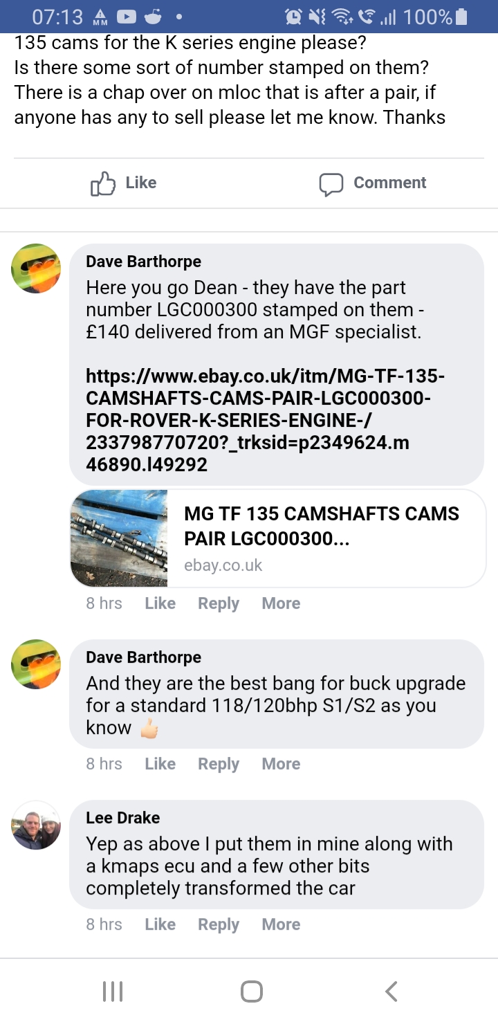

DeanB Posted February 2, 2021 Posted February 2, 2021 I have asked a question on faceboast for you Al. If I get a reply I'll post it on here.

Al32 Posted February 4, 2021 Author Posted February 4, 2021 Hi all, Sorry for just replying now, but it's been a bit busy at work this week so I've only had a bit of time to get back to this thread today. Thank you for all the replies, I do appreciate it! Dean, thanks for going out of your way and try to get some extra info on fb about these cams. Those are the cams I saw on ebay the other day with the 300 designation and made me ask about extra info on here, but I guess it must be right since both you and MrWill say its the 300 designation that I should go after. AlexB - Noted, I might be interested in them, might send you a pm MrWill - Thanks for the info - how much of a difference should I expect with adidng verniers? I've spoken to my mechanic colleague and he says that if verniers are added that he'll need the exact "settings" to put them in - anyone know where I can find those? Jody, whats the condition on the LGC 300 cams you know of? Marcus - sent you a pm. Cheers everyone, can't wait to get these cams in my Elise!
