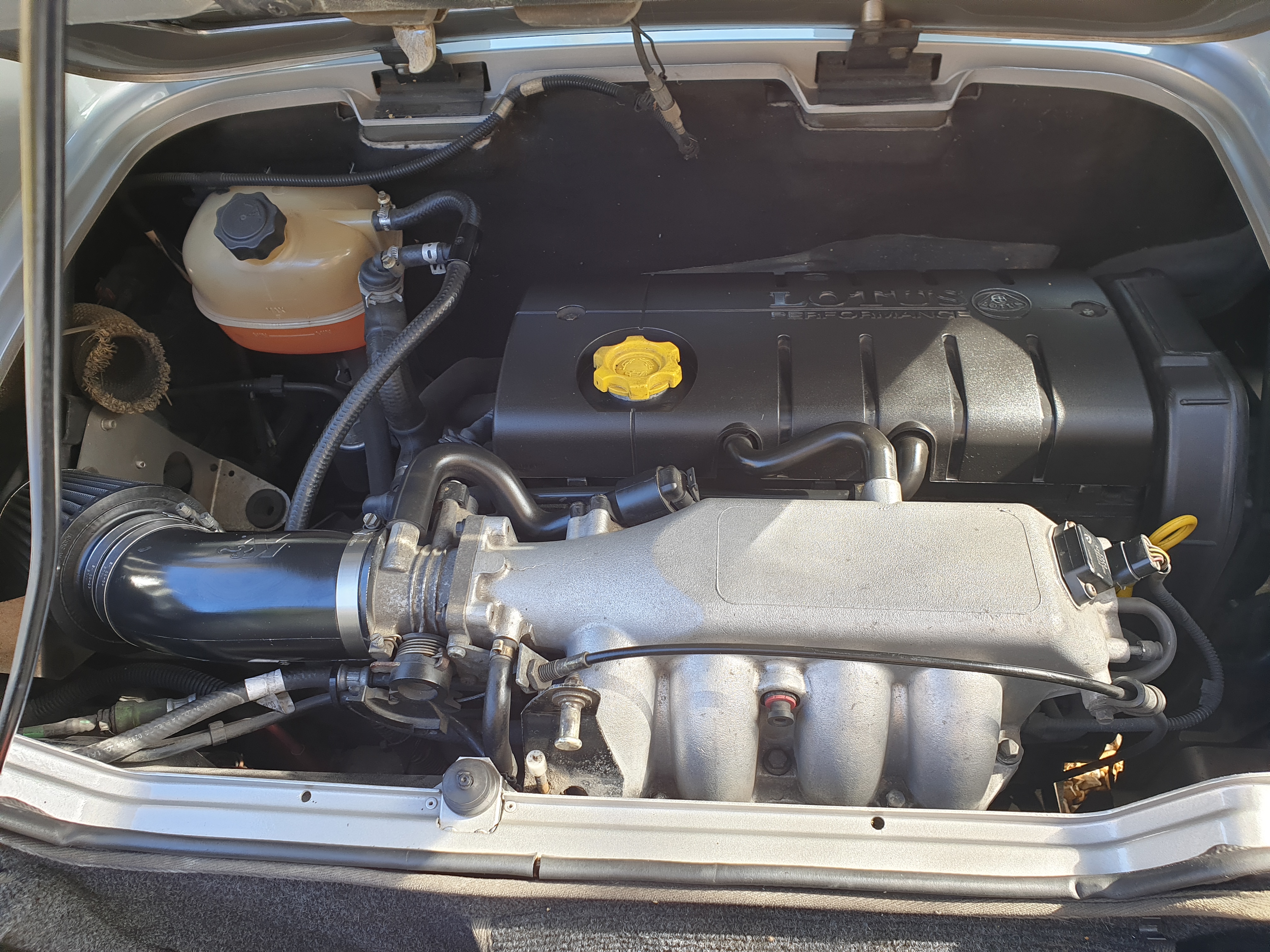

DeanB Posted January 19, 2021 Posted January 19, 2021 This shows the air filter, although ignore the vvc plenum, my old engine with the 135 cams started blowing big clouds of oil smoke (rings I think, but it had done 106,000 miles, many of which were quite hard miles) so I swapped it with this one which had the ally plenum, much lairier cams, a ported head and Sport 135 ecu. I wouldn't advise putting a vvc plenum on to your car because, again, they cost a lot of low down torque apparently.

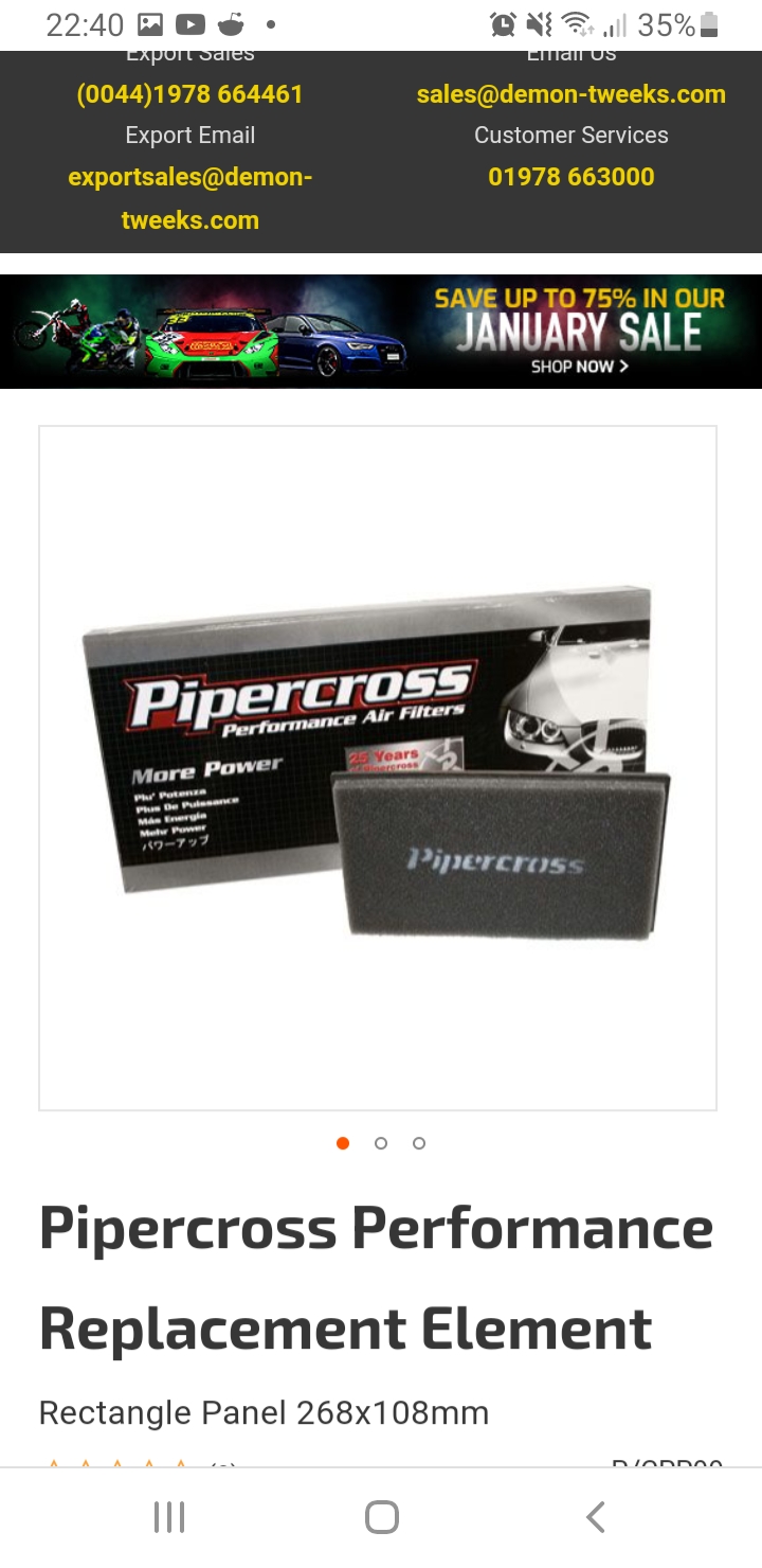

DeanB Posted January 24, 2021 Posted January 24, 2021 You could try one of these, from Demon Tweeks - might be a little louder but not too intrusive
