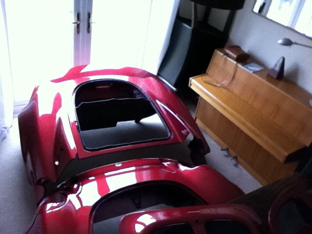

The doors have been moved up to the spare bedroom as the dining room is now taken up with my front and rear clams. I picked them up saturday morning. They look just fantastic!!! So good to not be faced with the flakey/acne ridden front and the scratched rear end. No trace of the cracks and chips from the accident.
