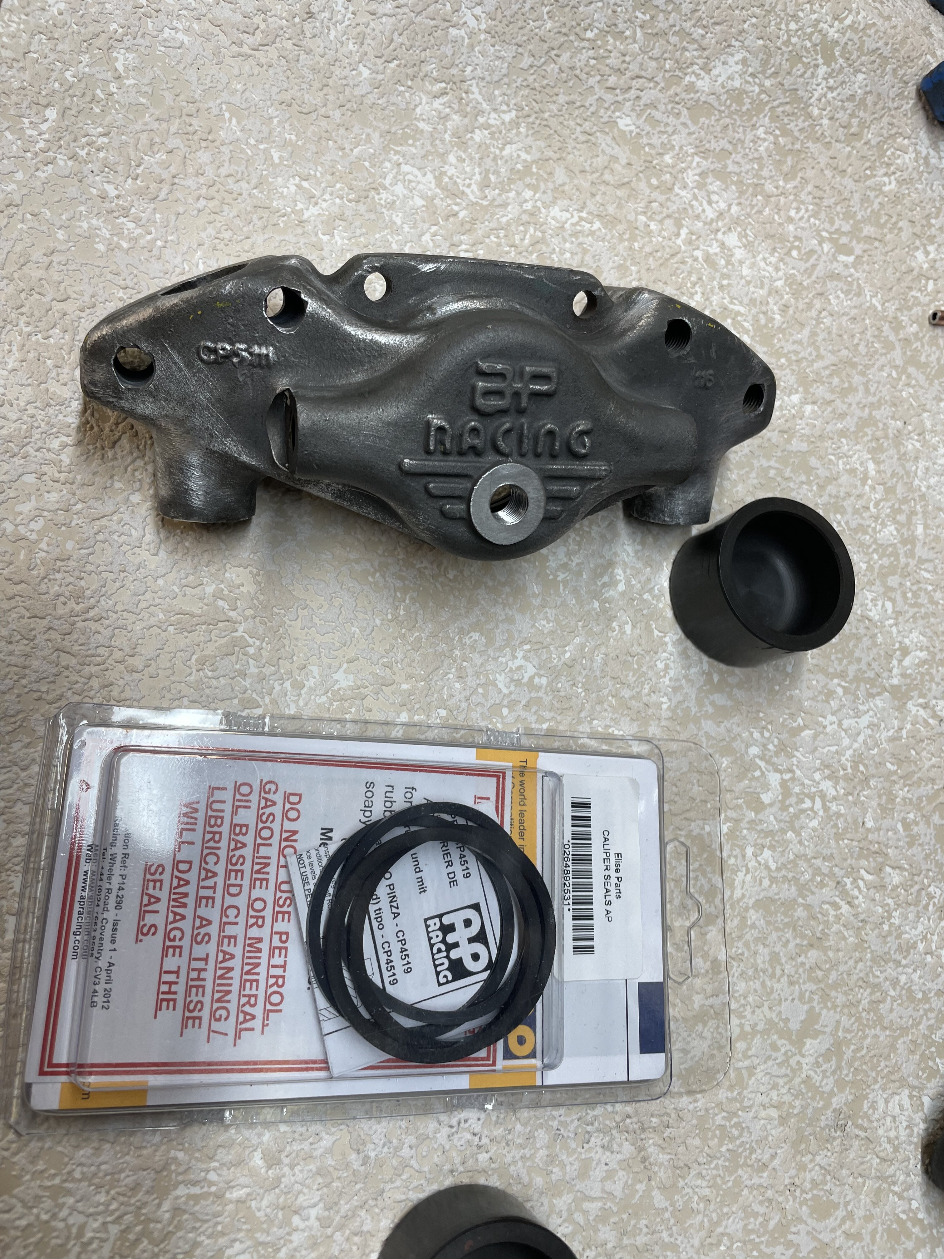

Andy wright Posted December 19, 2025 Author Posted December 19, 2025 Latest plans for Lotus improvements. Brakes. Nothing too radical . Set of four two piece rotors from Seriously Lotus, complete with RCL5+ front pads and some Mintex 1144 at the rear. All that lot still in boxes. Next step are the front Calipers . I rebuilt the set that came with the car last winter. Nothing wrong with them except that they are an absolute pain in the bottle to bleed. Why AP decided to top feed them is beyond me , especially as the sister Calipers CP5316 and Cp5317 which are indelicate except for piston sizes are side fed. So, I found a spare set of front on Facebook marketplace , stripped them and converted to side feed. As soon as I have them painted they can replace the ones already on the car along with the discs. The other change is to the master cylinder. I have splashed out on a larger bore one. Any why? Because on the S2 with the Toyota power unit, the brakes are servo assisted . Any they are over - servoed with a bit too much travel . So I am hoping that a move to a MC with a 20% increase in piston area will help with both a reduction in pedal travel and an increase in pedal effort, particularly when slowing from 20 or 30mph to a stop . At the moment , it’s quite difficult to do that smoothly . The plan is to use a banjo fitting for the hose. Ideally I would have made the m10x1.00mm bolt hole blind and just left a 3mm hole into the cylinder but even with the very conveniently placed raised boss that just needed milling flat ,I would have been short of thread depth on the bolt. Quote

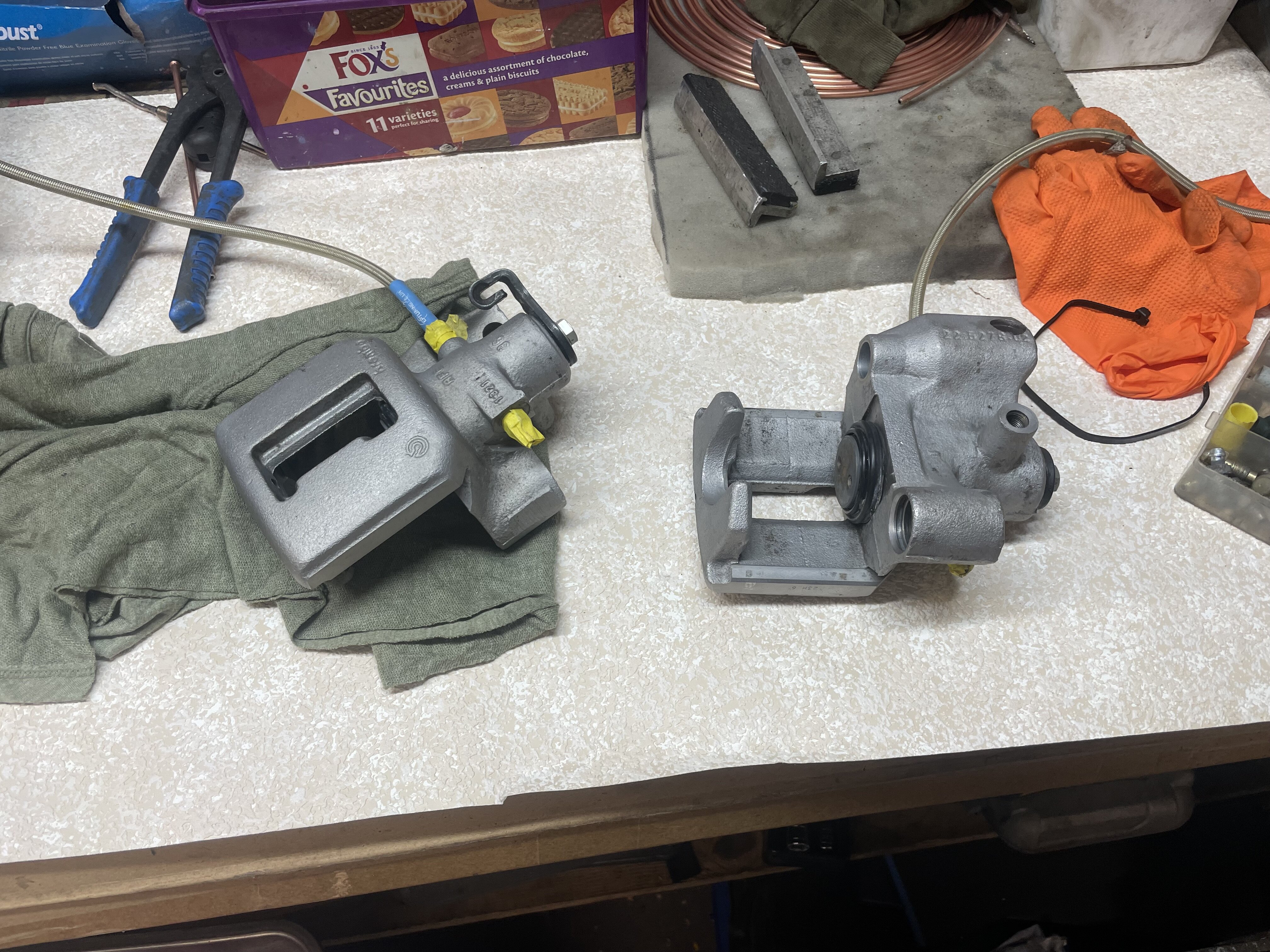

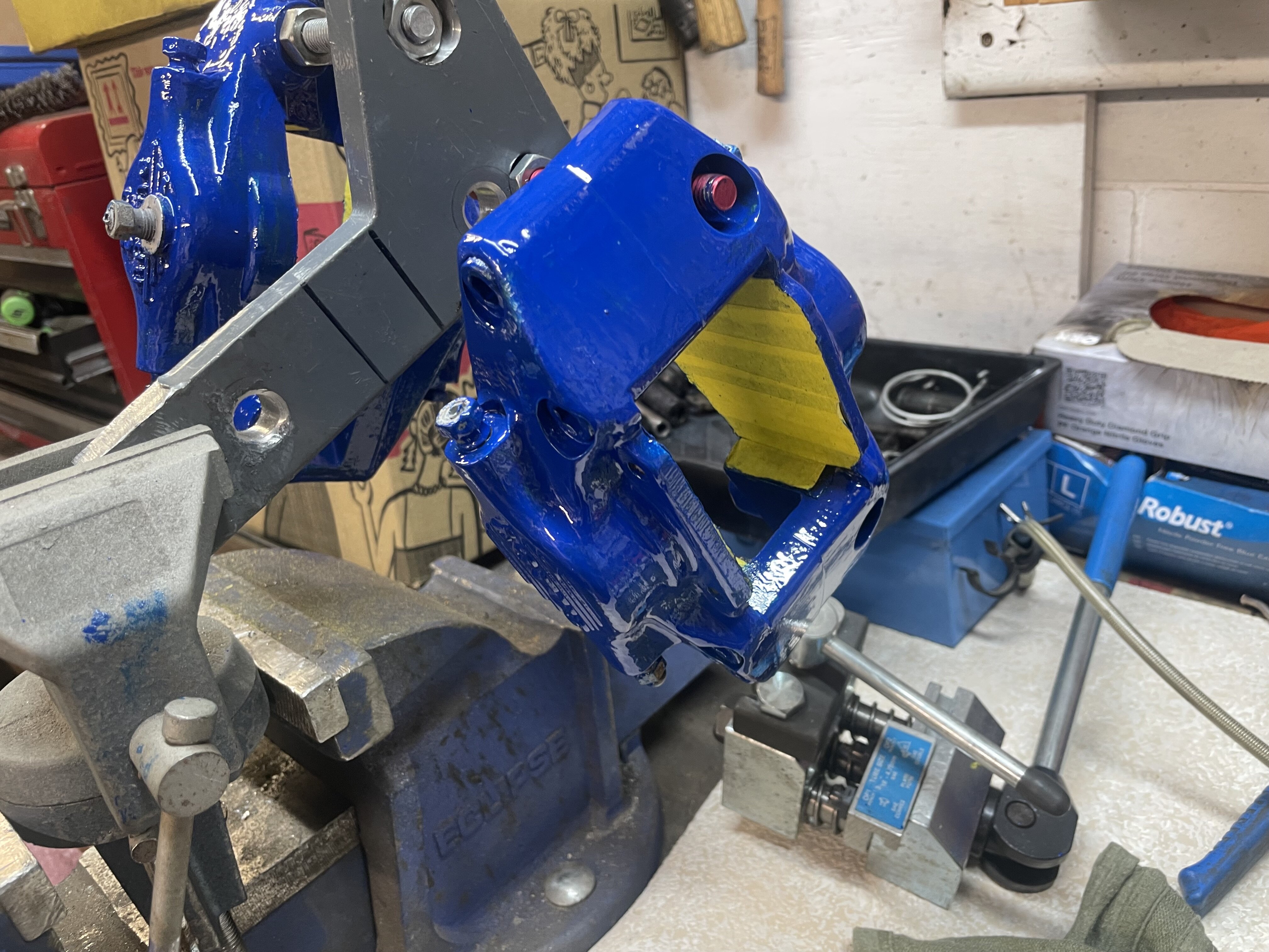

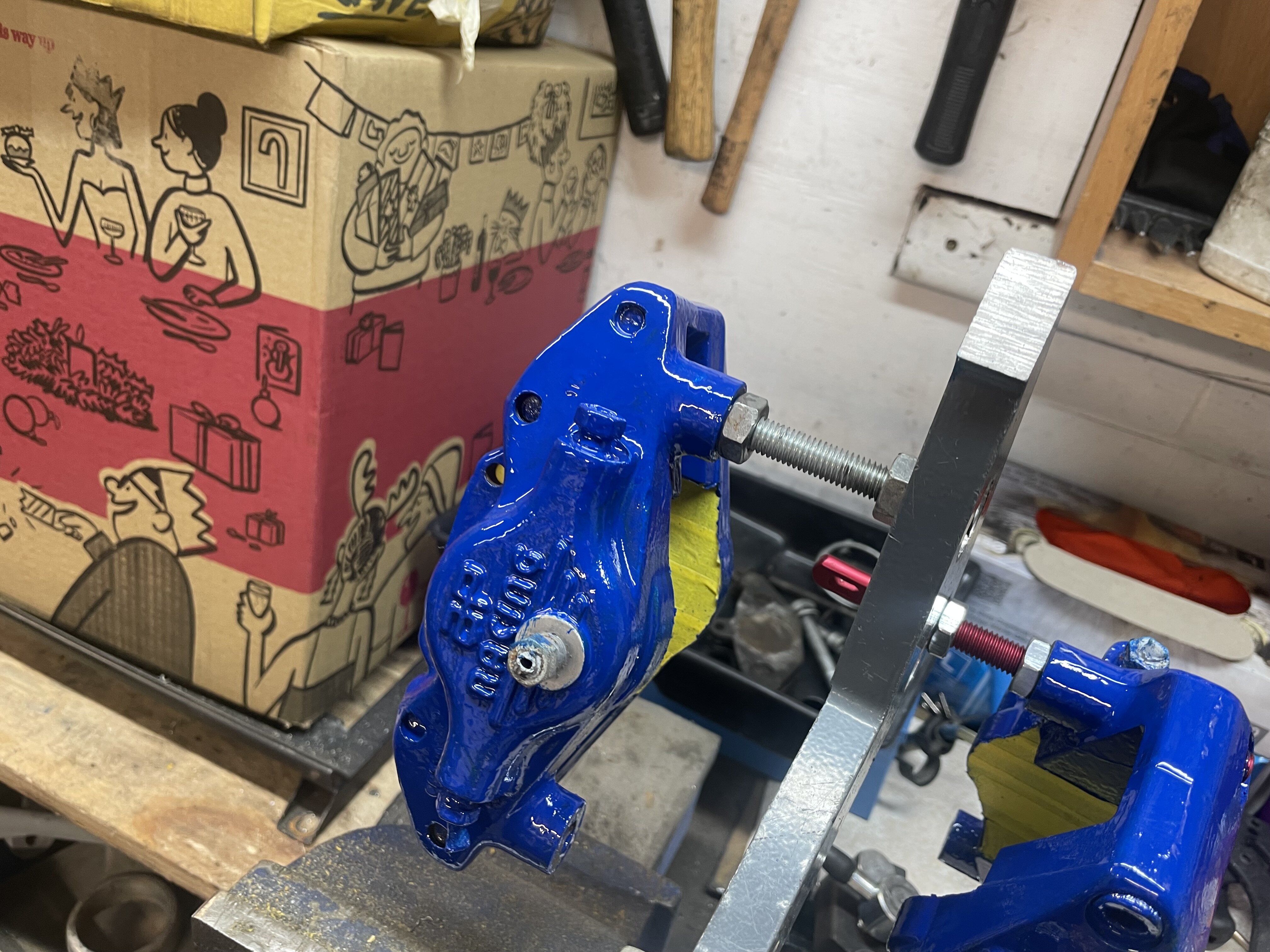

Andy wright Posted December 21, 2025 Author Posted December 21, 2025 Bit of progress this afternoon. Front calipers duly tarted up and rears about to suffer the same fate. Master cylinder removed along with the fluid reservoir . Quote
Lithopsian Posted December 22, 2025 Posted December 22, 2025 Those Brembos look pretty spotless. Have they been de-rusted? Coated with something? Fully refurbished even? The piston boot looks a bit dodgy in that photo though. Or has it been painted as well? Quote
Andy wright Posted December 22, 2025 Author Posted December 22, 2025 Boots are ok but that one I moved slightly to check all was ok. They are not old Calipers. Been on the car about a year , so a thorough clean and they look pretty good. Now bling blue of course, to match the fronts.. As an aside , trying to decide whether to ‘ delete’ the ABS whilst I have the hydraulics disrupted. Only the Toyota S2 Elise’s got the system , and getting rid of it would massively simplify the pipework and make brake bleeding easier ( and shed a bit of weight too ) I will sleep,on it . Quote
