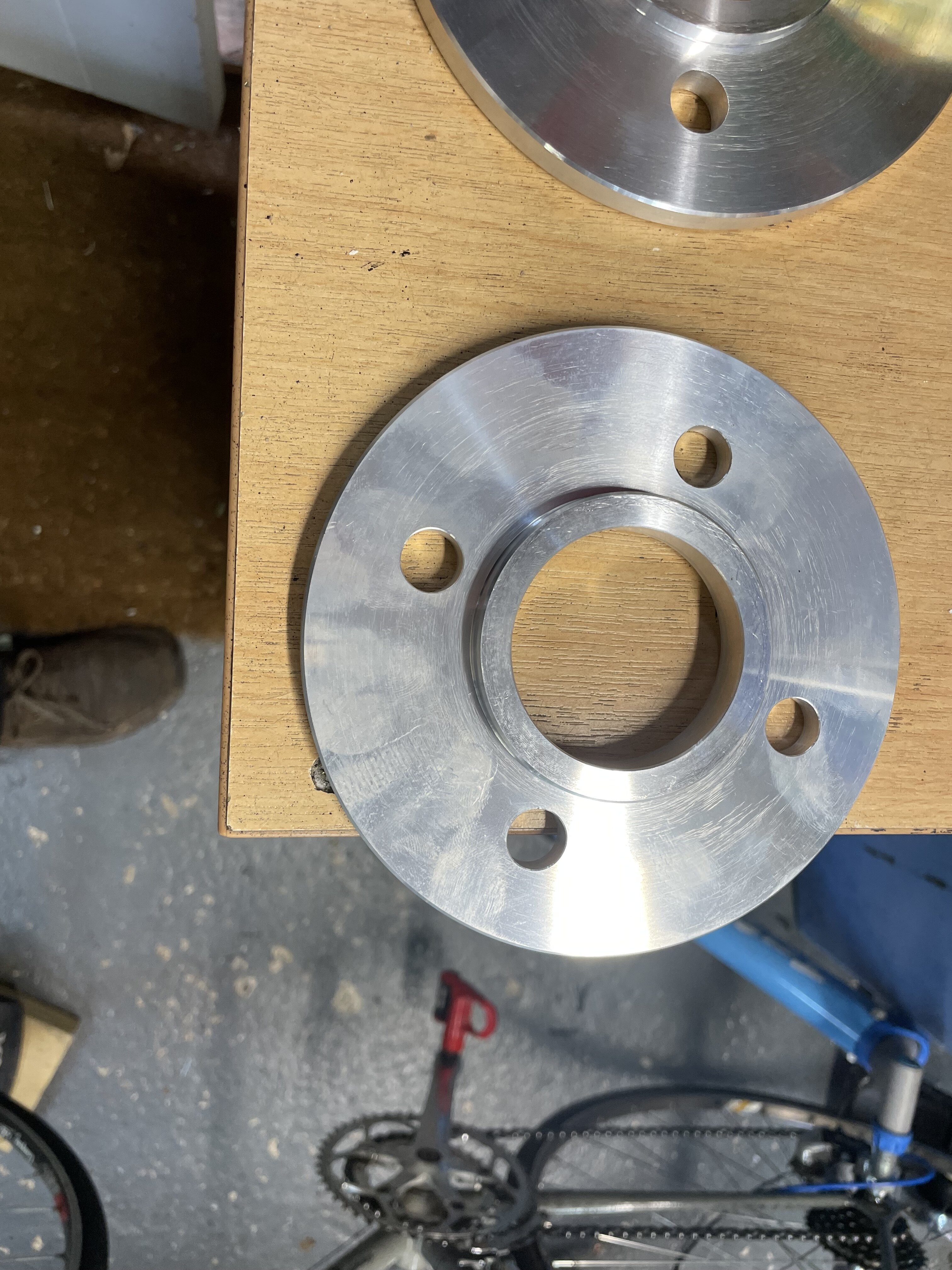

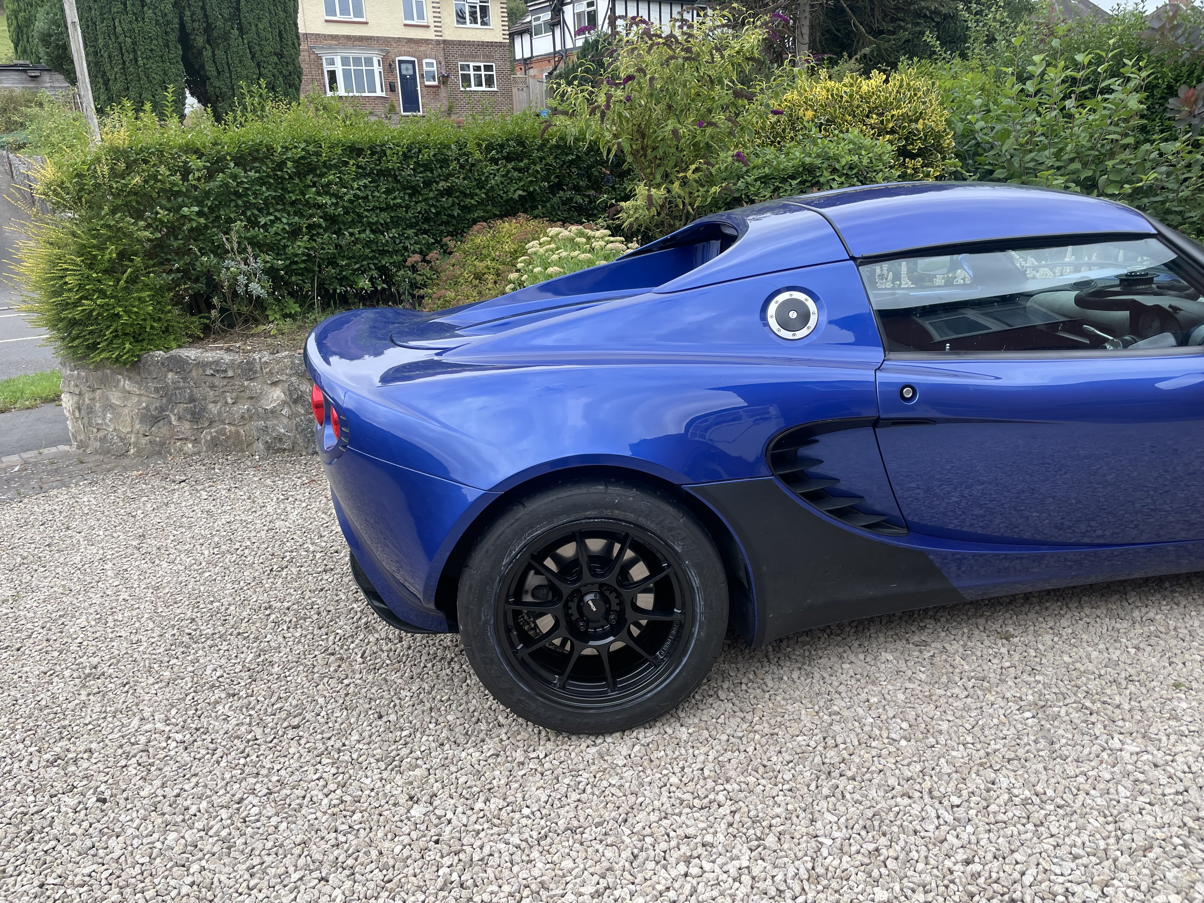

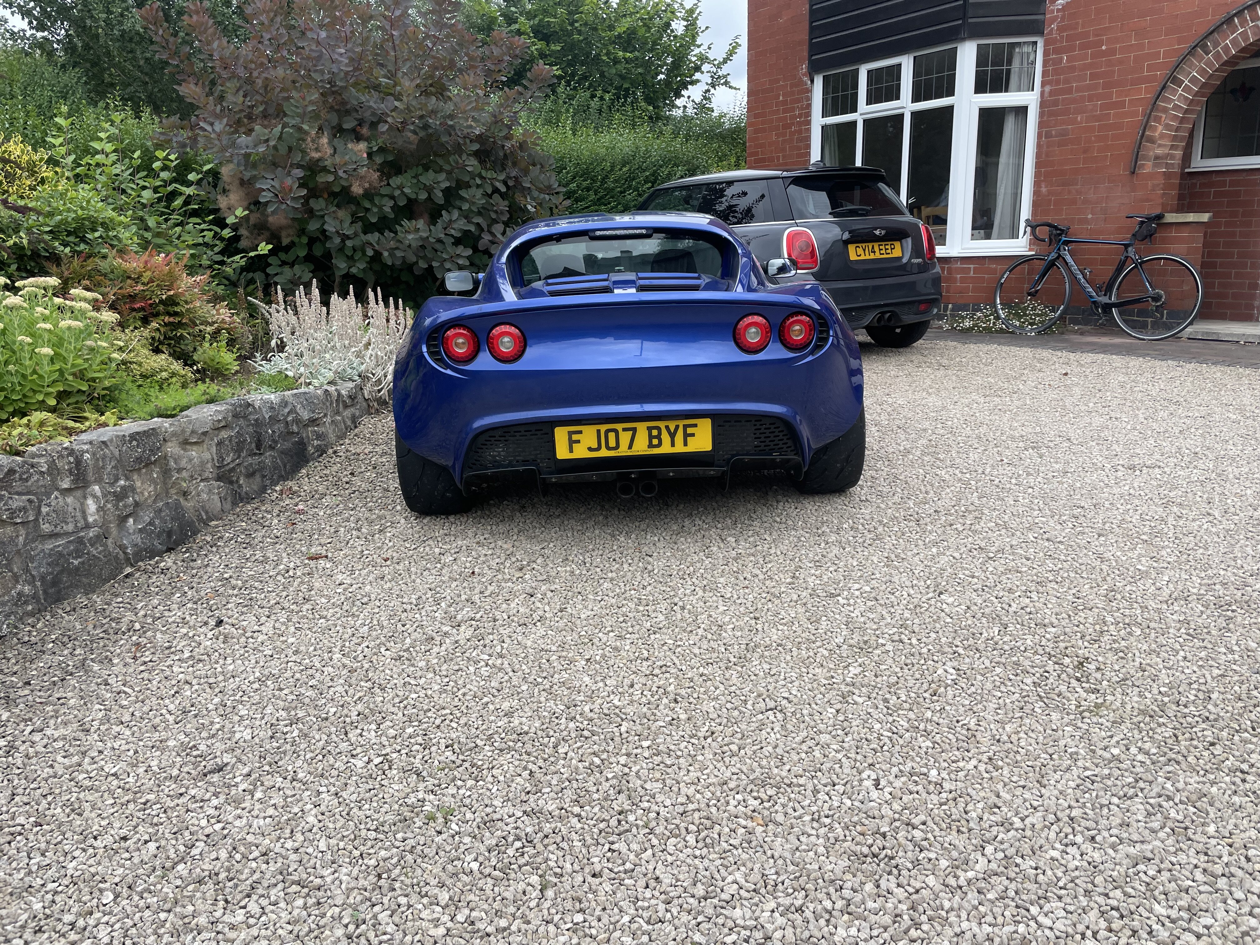

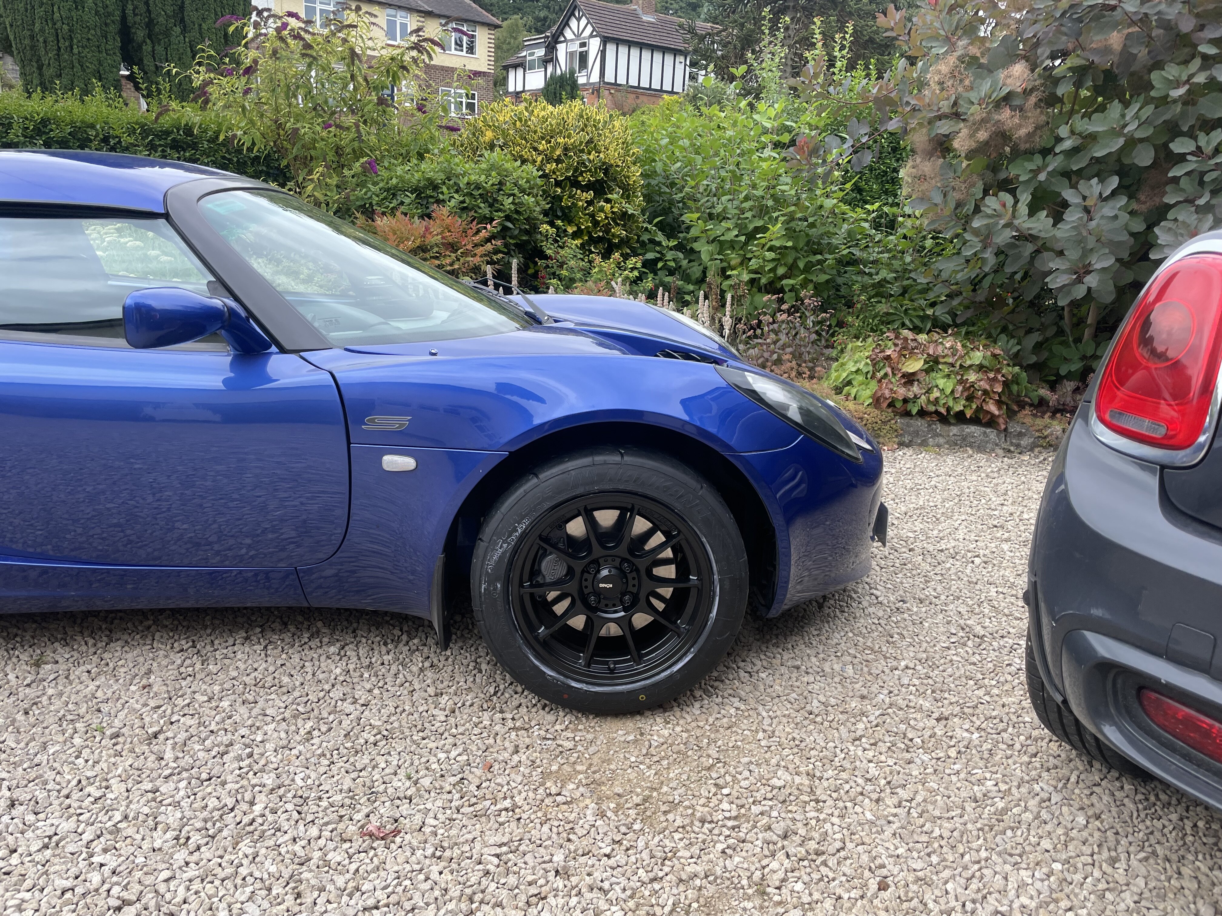

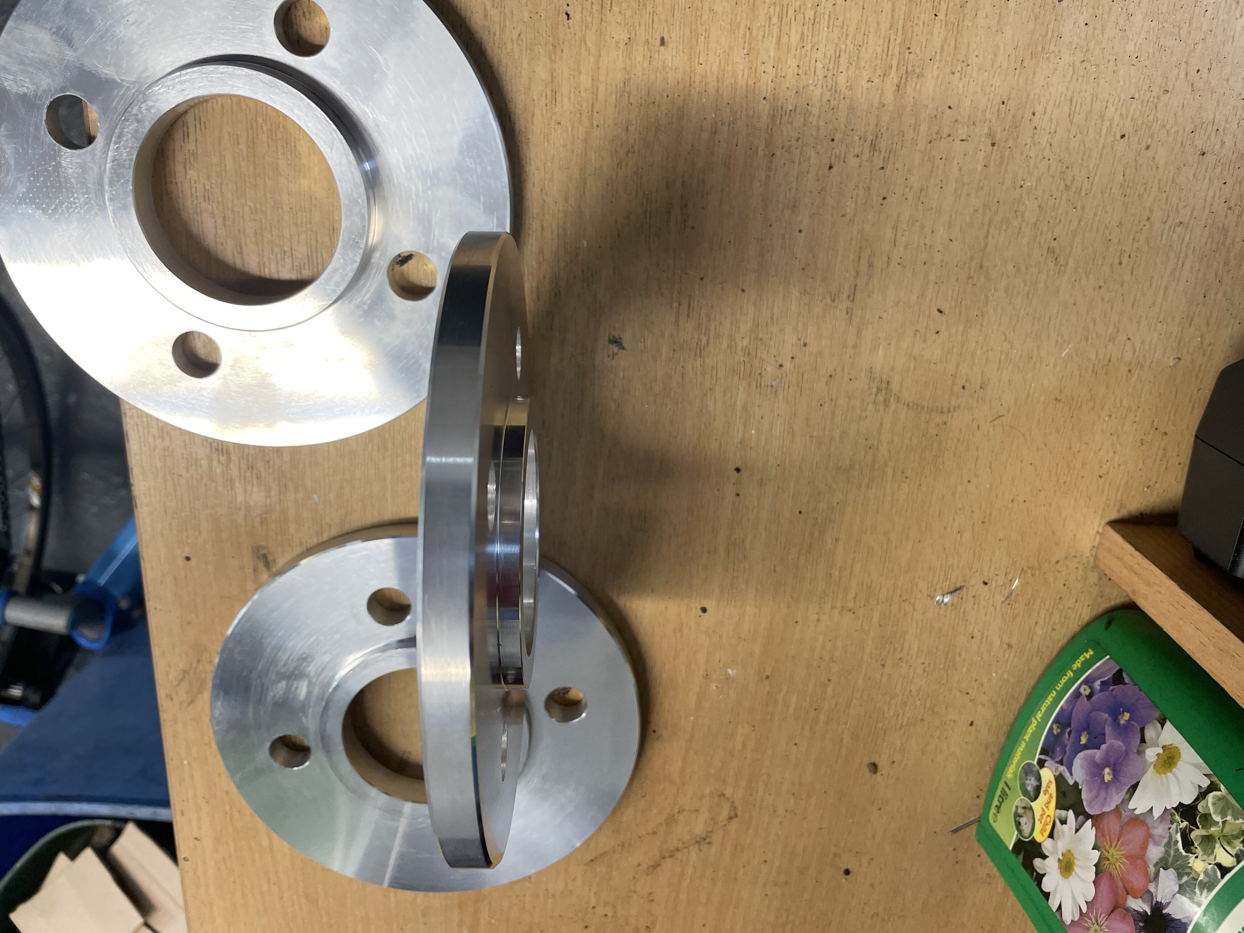

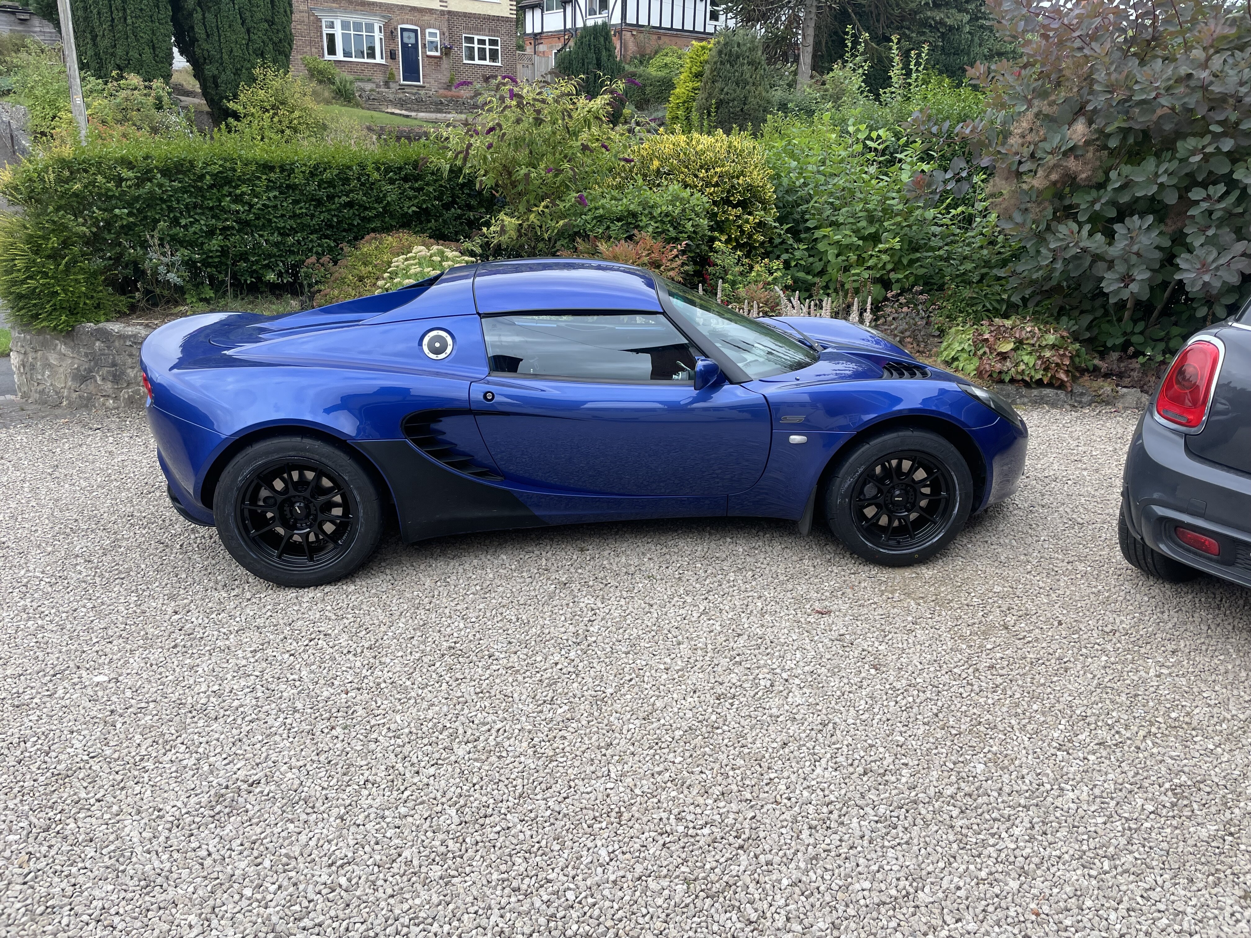

Andy wright Posted August 1, 2025 Author Posted August 1, 2025 And here they are. Konig Decagram, bespoke hubcentric spacers with Lotus 56.5mm to Konig 73.1 , 10mm up front and 8mm at the rear. Tyres are Nankangs finest ( well, AR1 ‘s but it amazing how good they feel when that have cost nothing. ) If anything, front could be 5mm lower as at the moment the car now sits at 125mm all round and it needs a bit of rake. Anyway, first drive up the road and impressions; the suspension is a little less ‘ jittery ‘ over poor road surfaces. Tyres are no more noisy than the AD08Rs ( but then how can we Elise drivers tell? ) and the turn -in and grip are phenomenal . Downside, is that the front end tramlines more readily , but that I think is exclusively down to tyres. Quote
DeanB Posted August 1, 2025 Posted August 1, 2025 You're probably right that the tramlining is caused by the tyres - do they have stiff sidewalls? I previously had Toyo 888s - which have stiff sidewalls - and with Nitron springs and dampers it tramlined horrifically. As soon as I changed the tyres to V105s it cured it. Night and day different. Quote
Andy wright Posted August 1, 2025 Author Posted August 1, 2025 Yup. Brick walls for sidewalls . That’s the price of great turn-in . Quote
