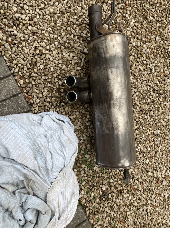

Well, I waited for the week and no sign of the back box.(sob😂😂) and no reply from Jim so something is wrong as he normally answers very promptly. . Anyway, I need the car on Monday so , rather reluctantly the old back box went back on this afternoon ( and it is a heavy thing too) . Diffuser still to fit but apart from that , job done. When the 2ubular back box arrives I guess it will be ‘ back in the air, diffuser off and this time I hope that I can leave the CAT in place .

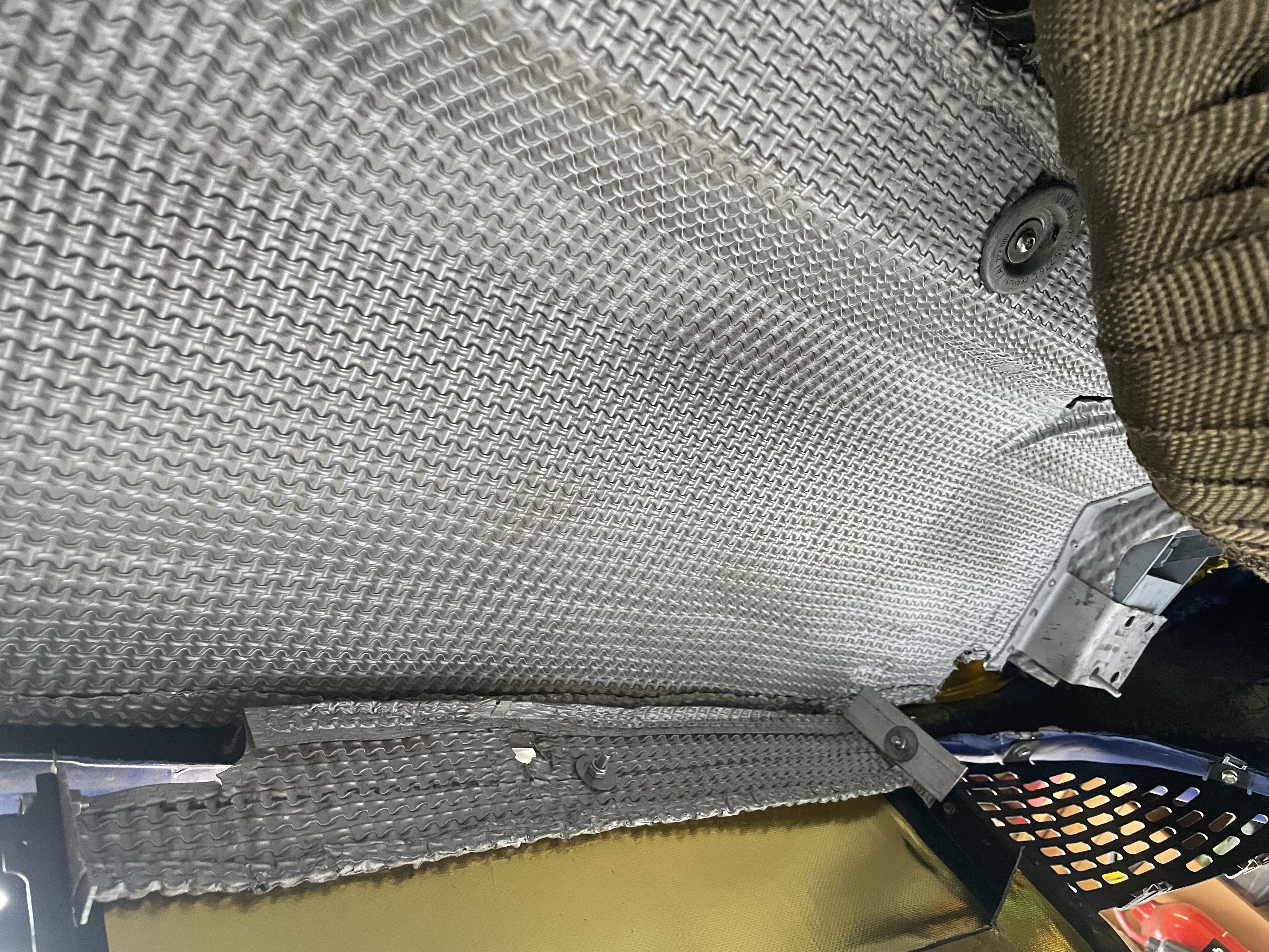

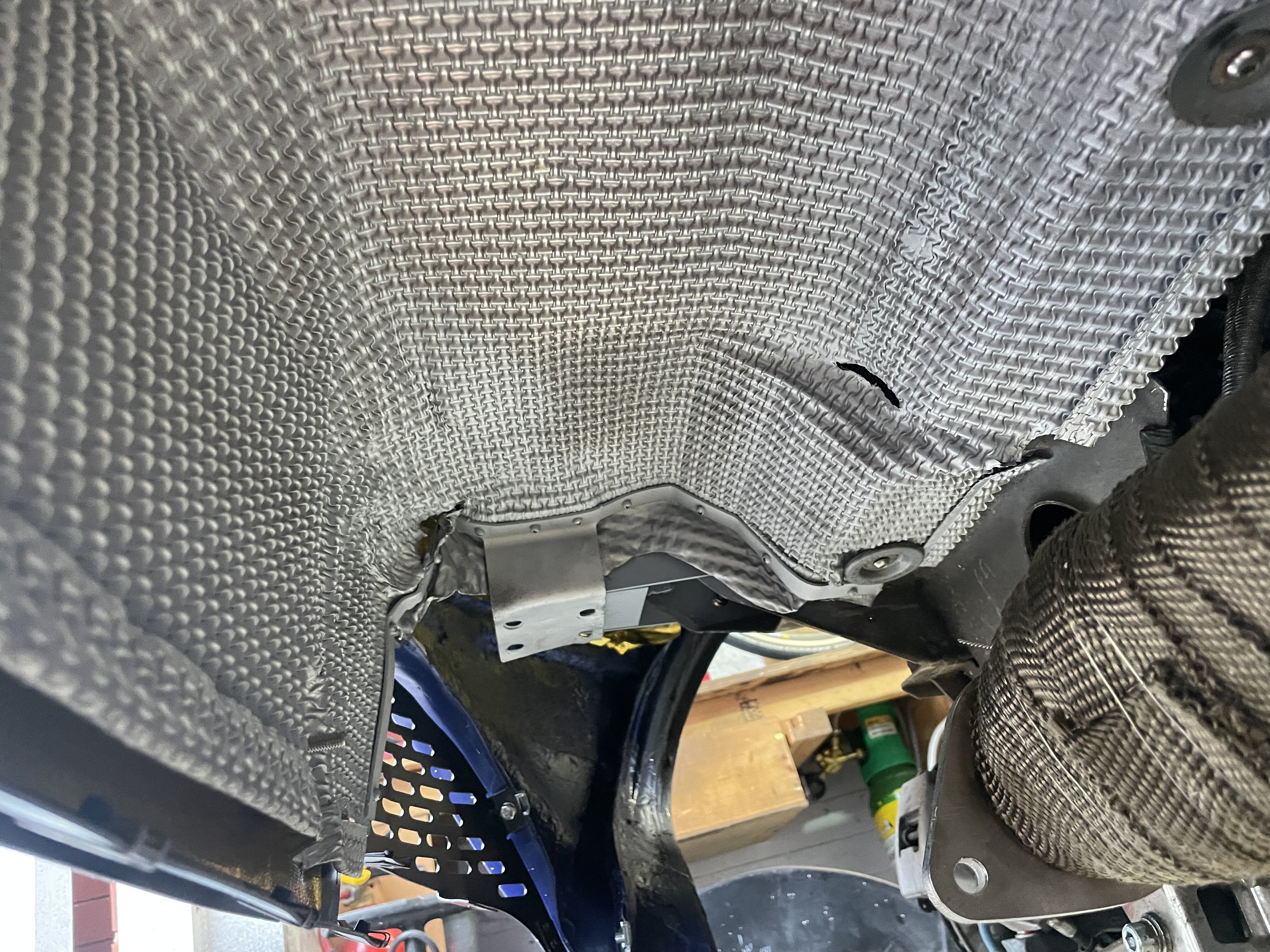

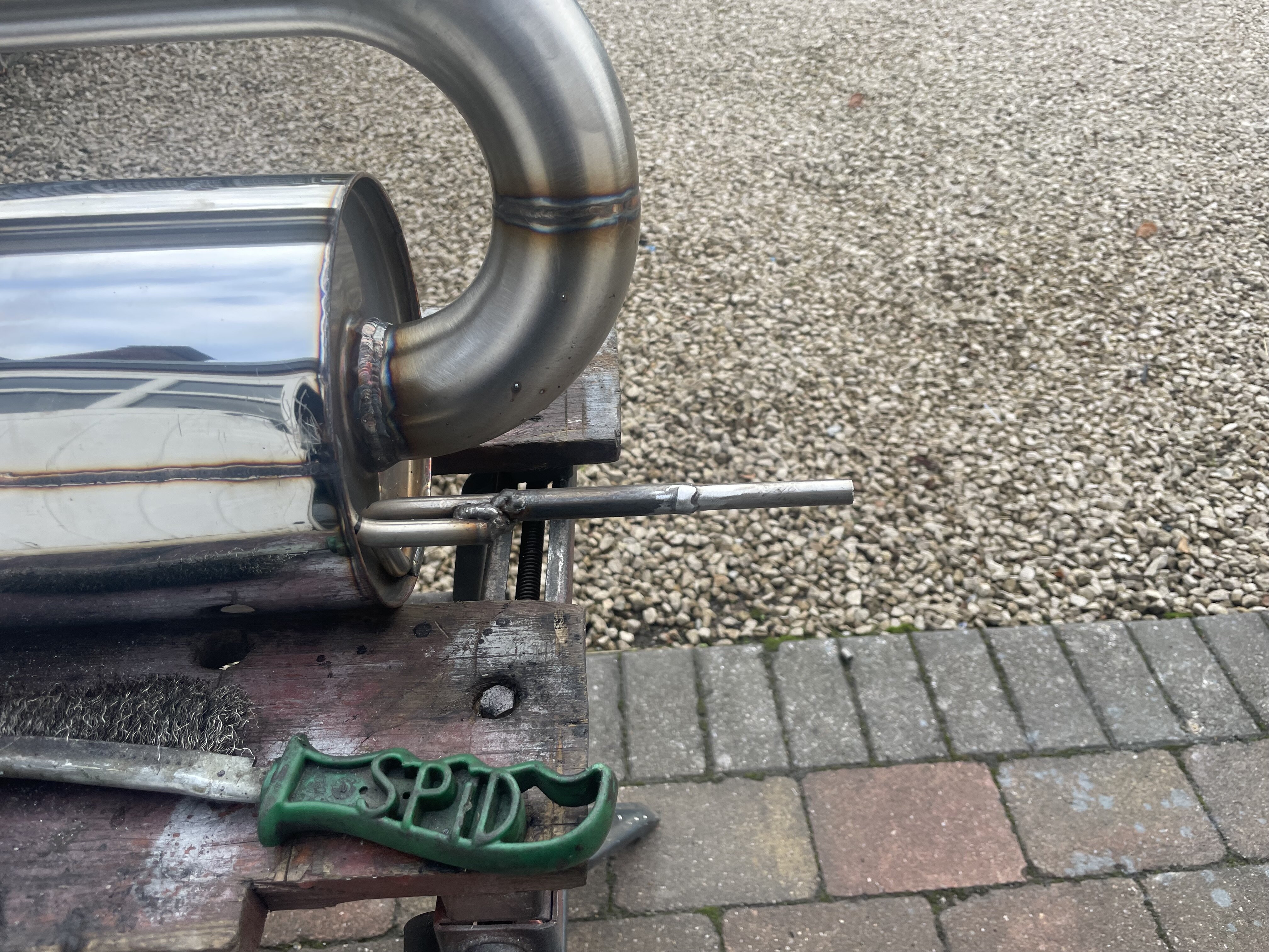

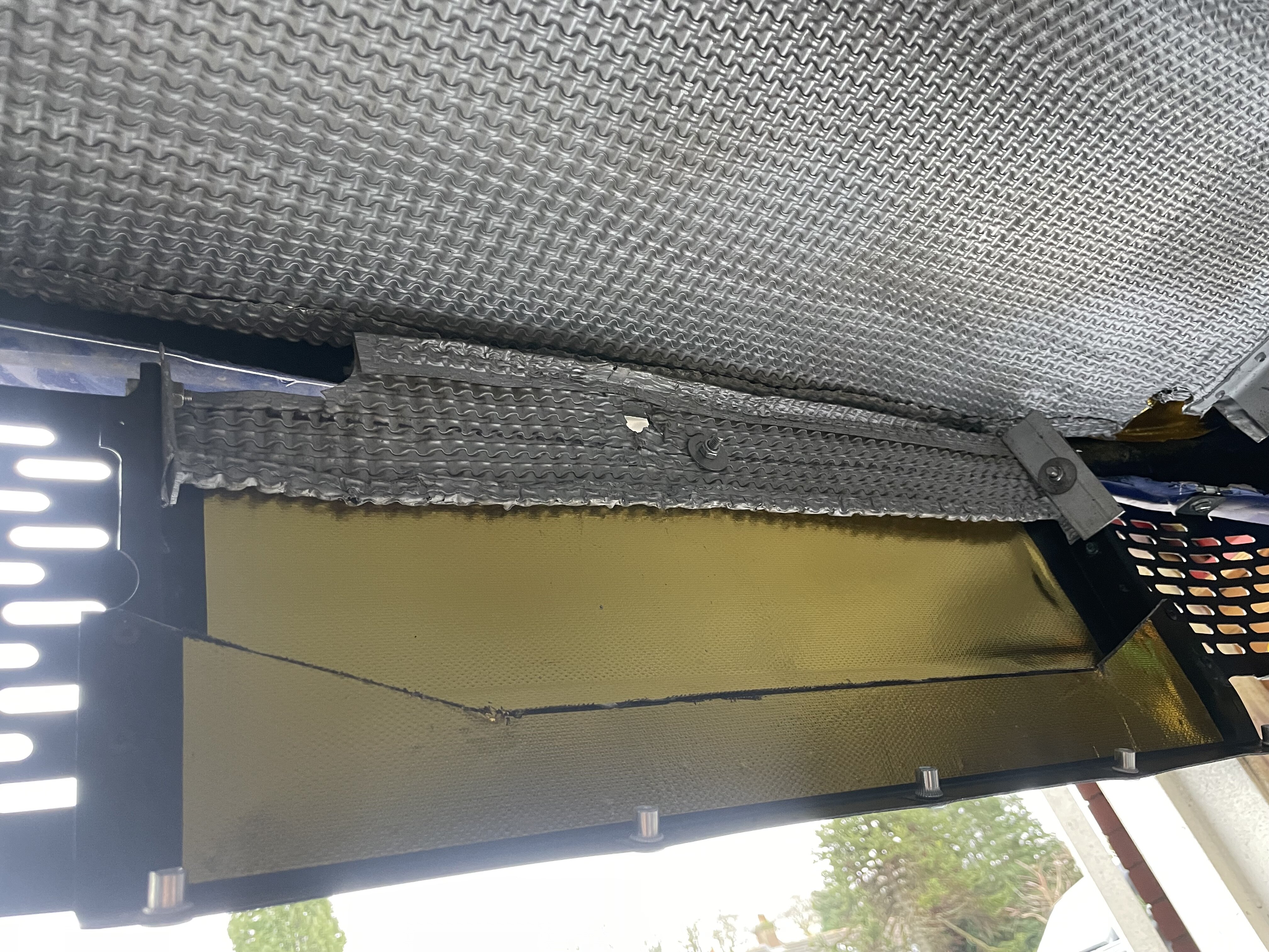

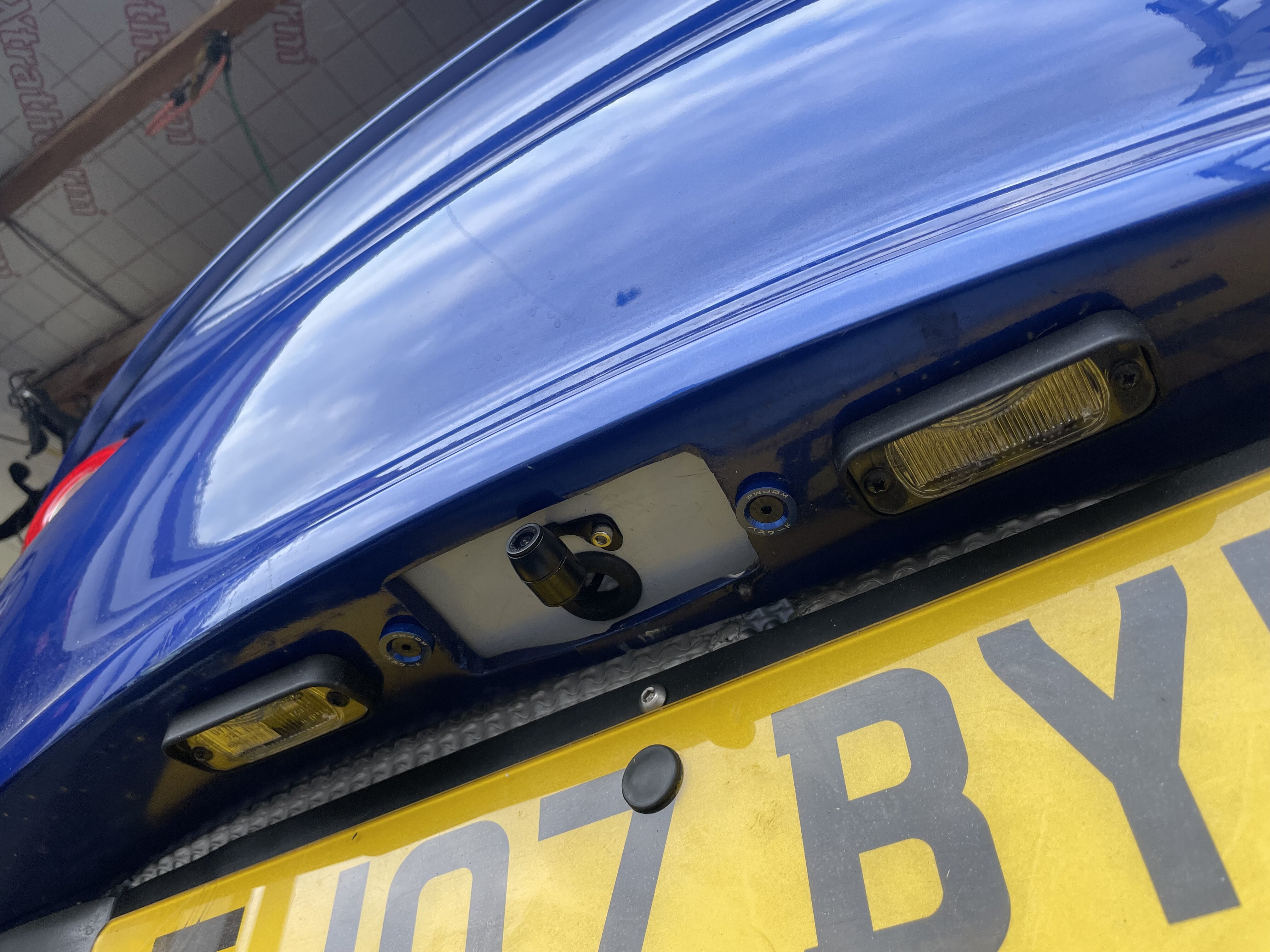

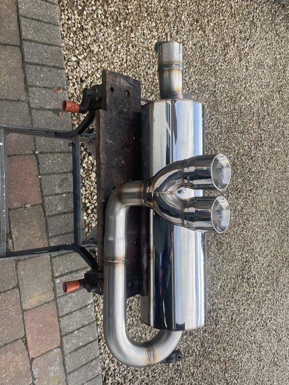

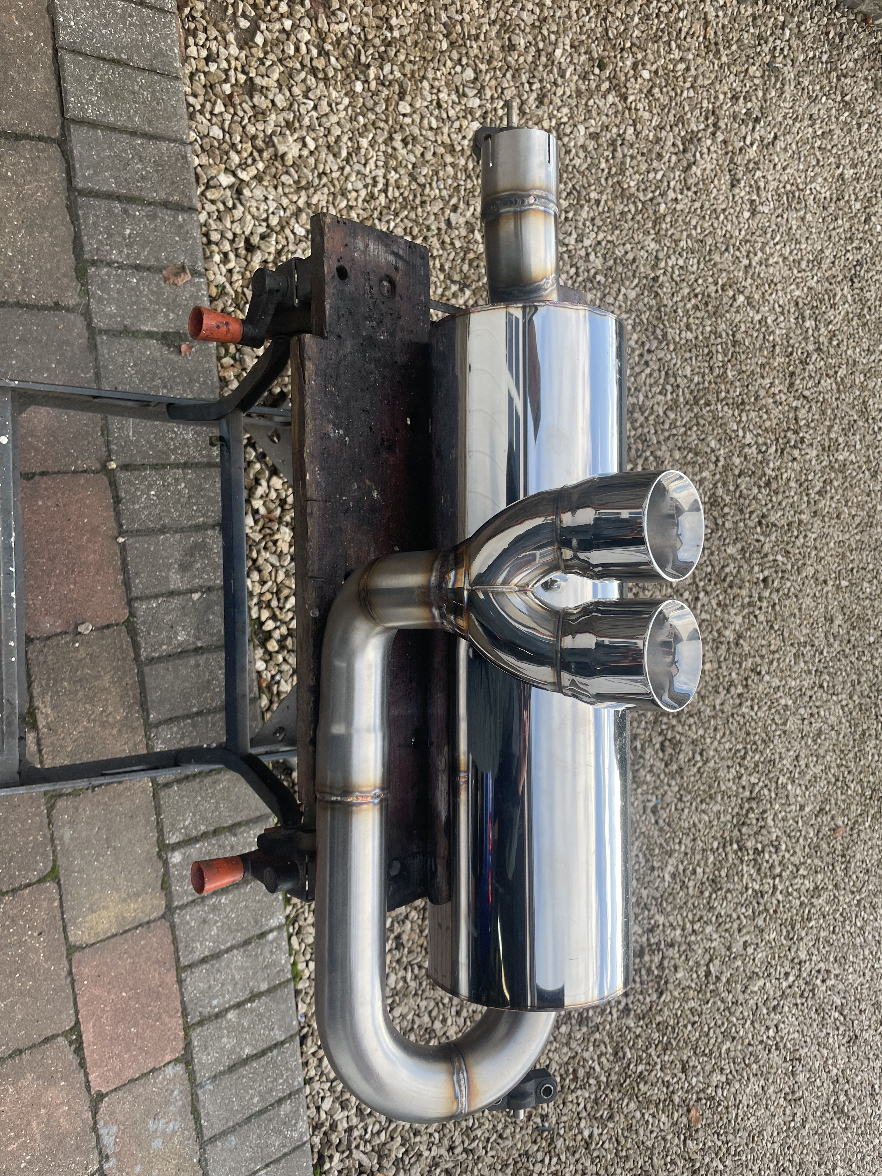

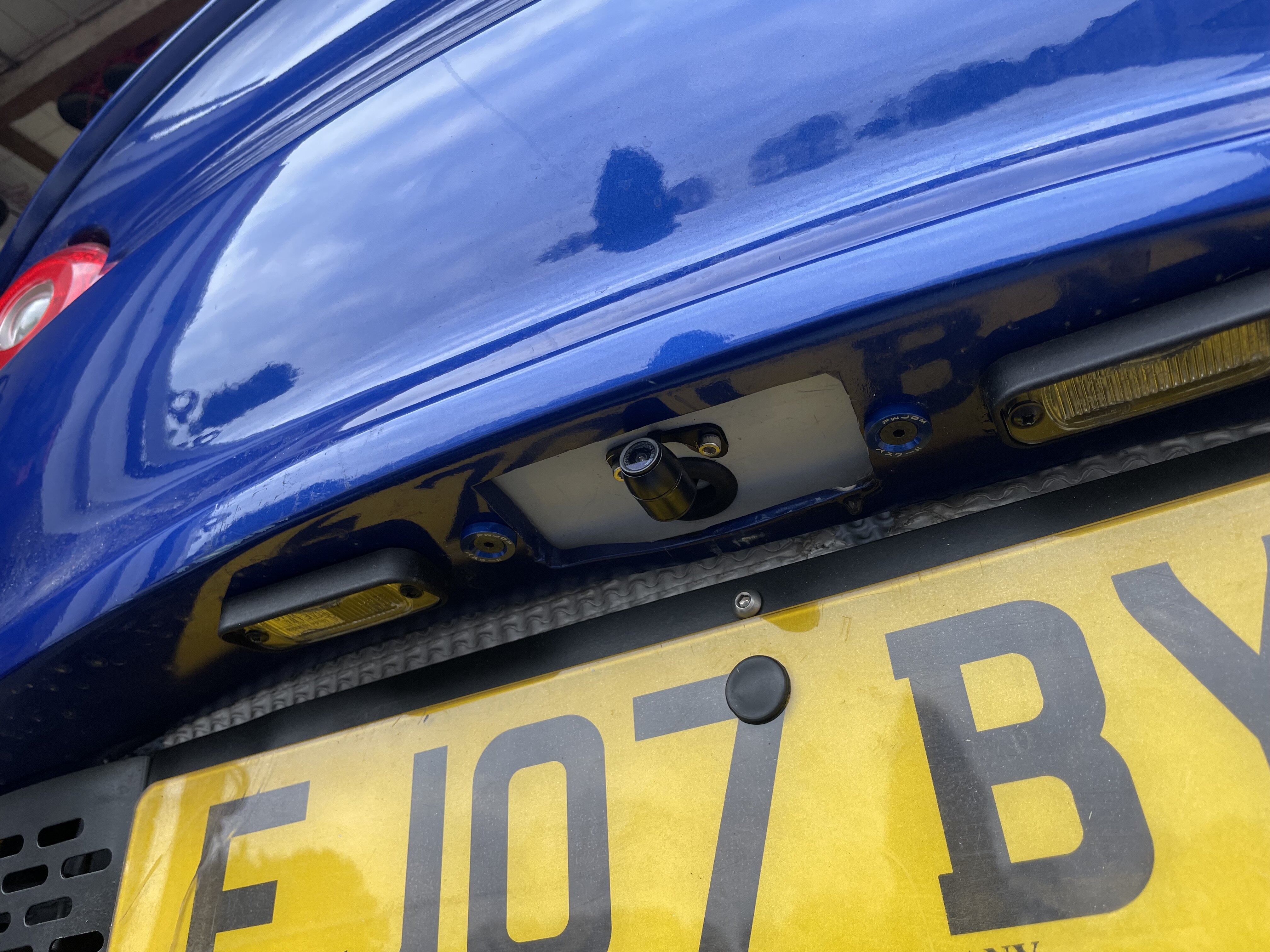

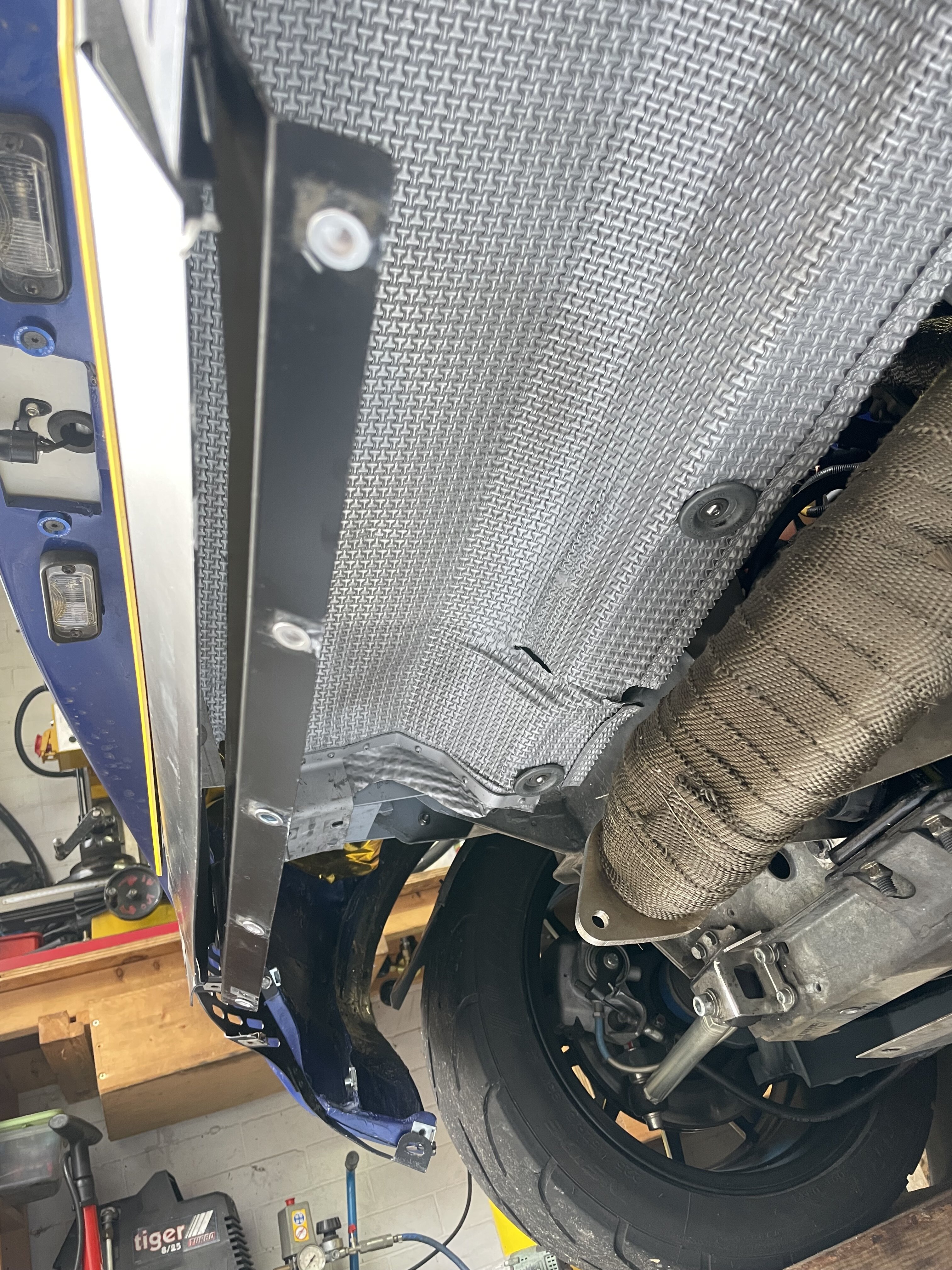

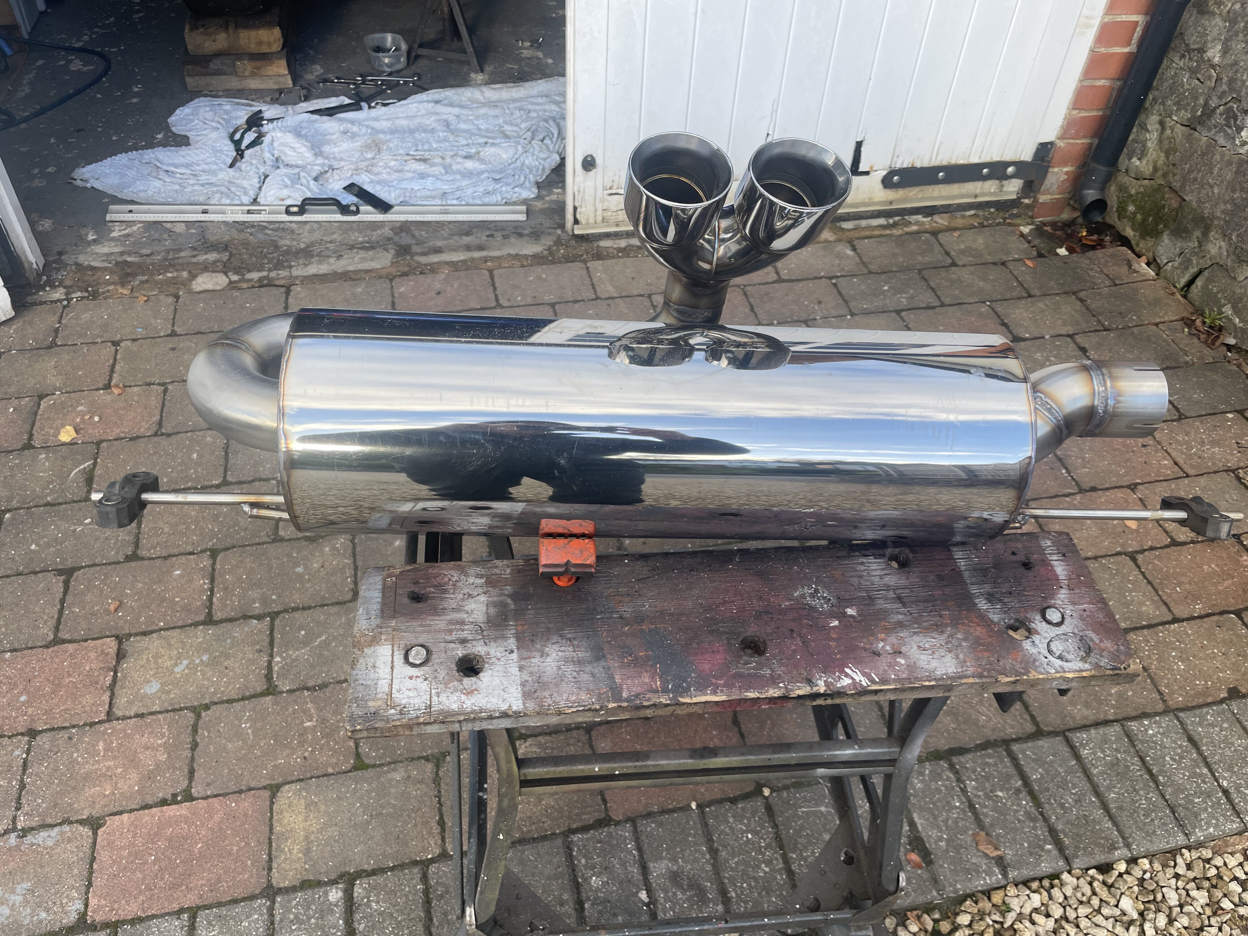

Jim was poorly. Anyway, back box arrived on Thursday . So Friday was ‘ car back in the air’ afternoon and remove cat and back box. Trial fit shiny new back box. And, err, slight problem ( well, two) The first was that the silencer fouled the heat shielding in front of the number plate . The second was that the mounting bars were a bit too short, particularly the one on the RHS . Bugger.
Anyway, heatshielding modified, rear camera relocated, number plate panel modified and re mounted in a very reduced form. Welder out and mounting bar extended by 25mm and now ready to put in tomorrow. Not quite the way I had expected it to go …..IMG_8937.thumb.jpeg.cd5c9b44c99126dba8b271155ddf1cbe.jpegIMG_8936.thumb.jpeg.b76b174a975d3bc0816f1b1be9294a3f.jpegIMG_8938.thumb.jpeg.4a24cd89b9c7f6b66b1f765e3818cf1b.jpegIMG_8940.thumb.jpeg.e24b814855b3a7ab5ea1b2ca3d0a95e6.jpegIMG_8939.thumb.jpeg.75c4afe3cc4d6108a420b2a3ba85cf45.jpegIMG_8943.thumb.jpeg.9ad55b3b98a46426bd07c57f51f21f4a.jpegIMG_8942.thumb.jpeg.b1a04373267fd1752b1abda5e0cfd05b.jpegIMG_8941.thumb.jpeg.5e13753441237ab7a75e4b35247a3393.jpeg

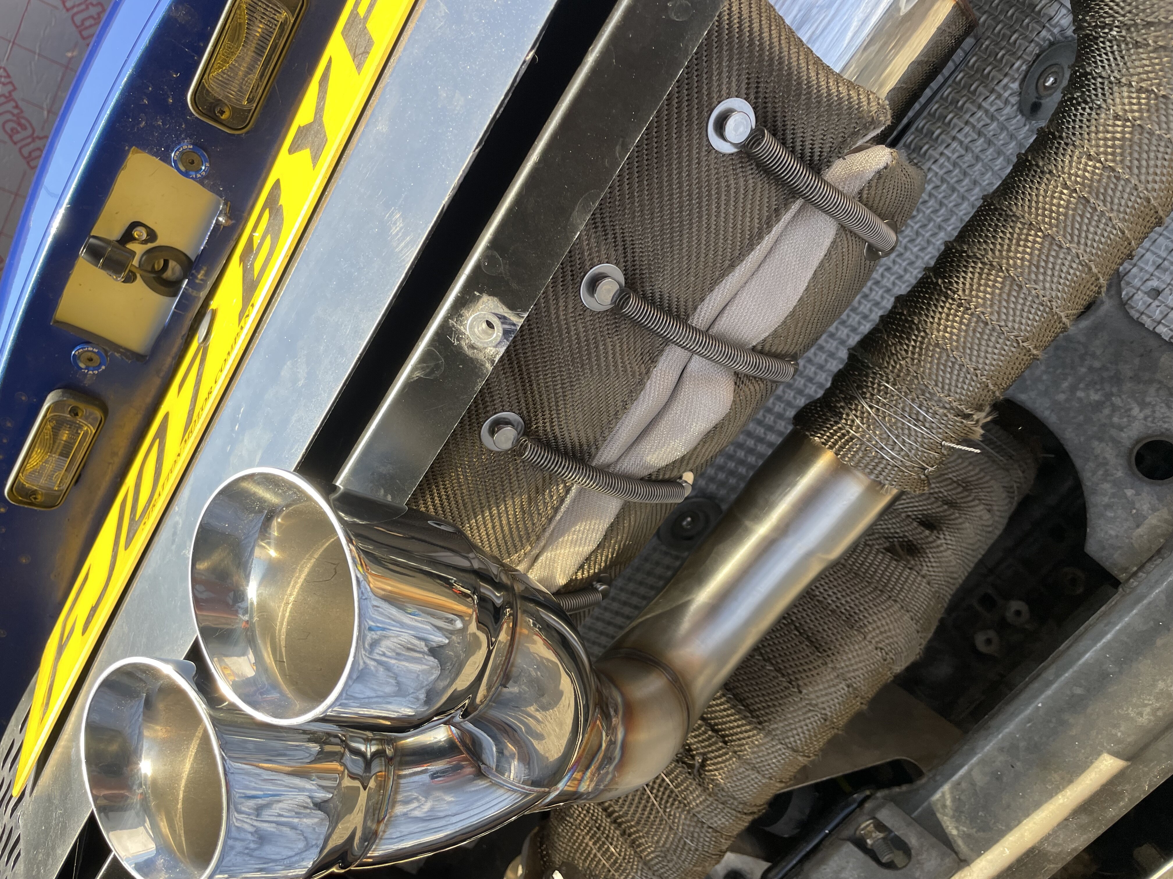

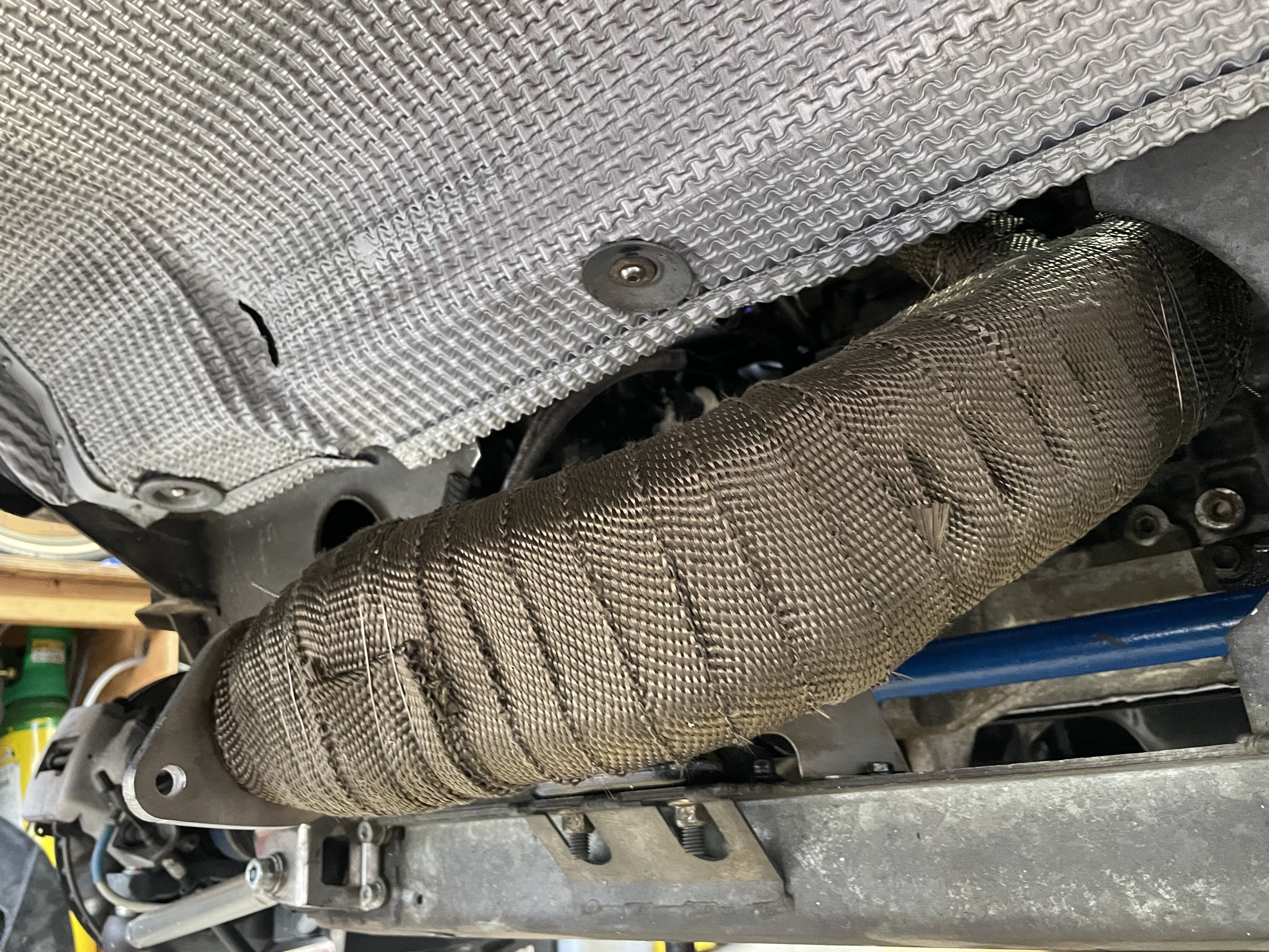

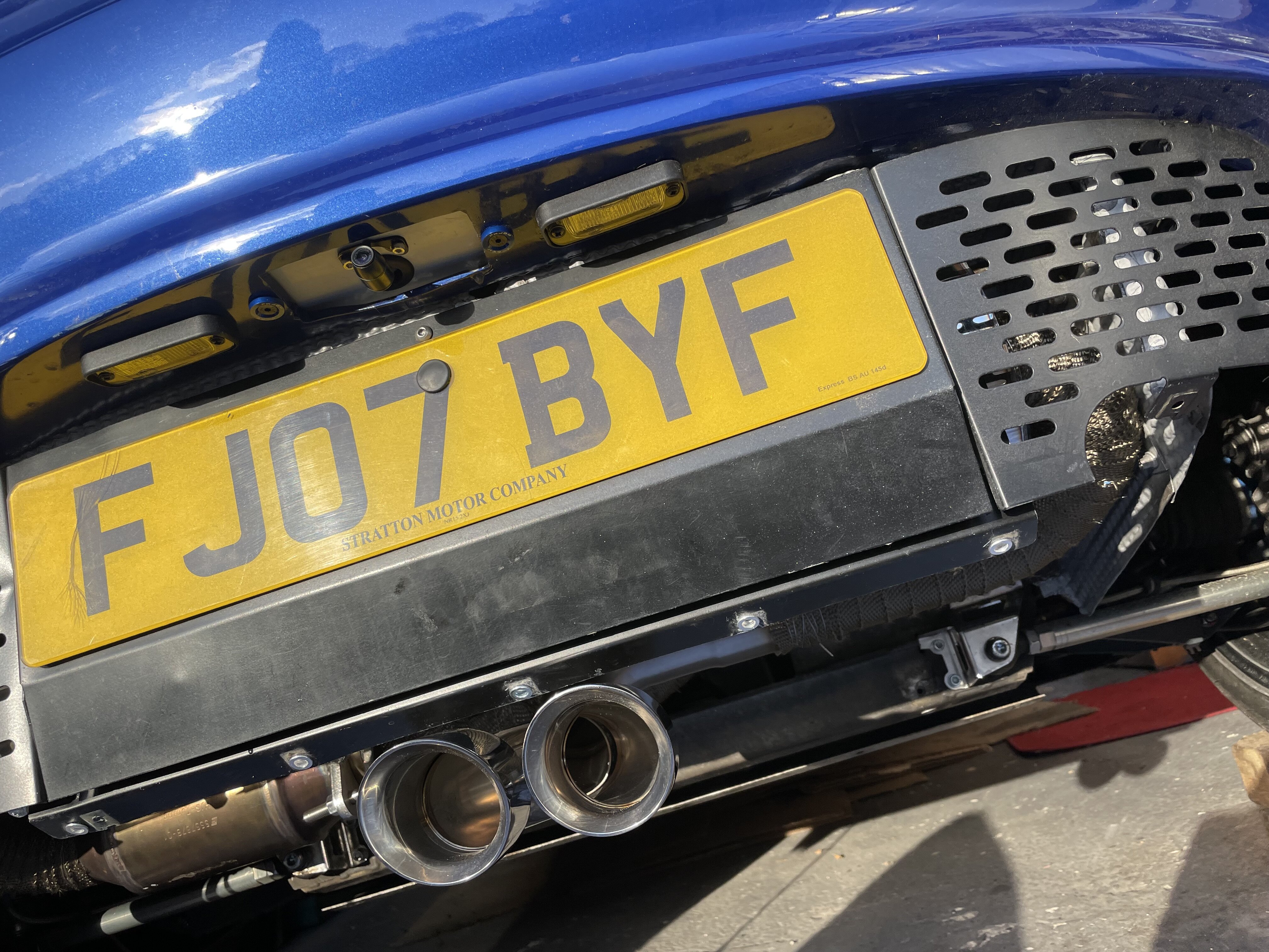

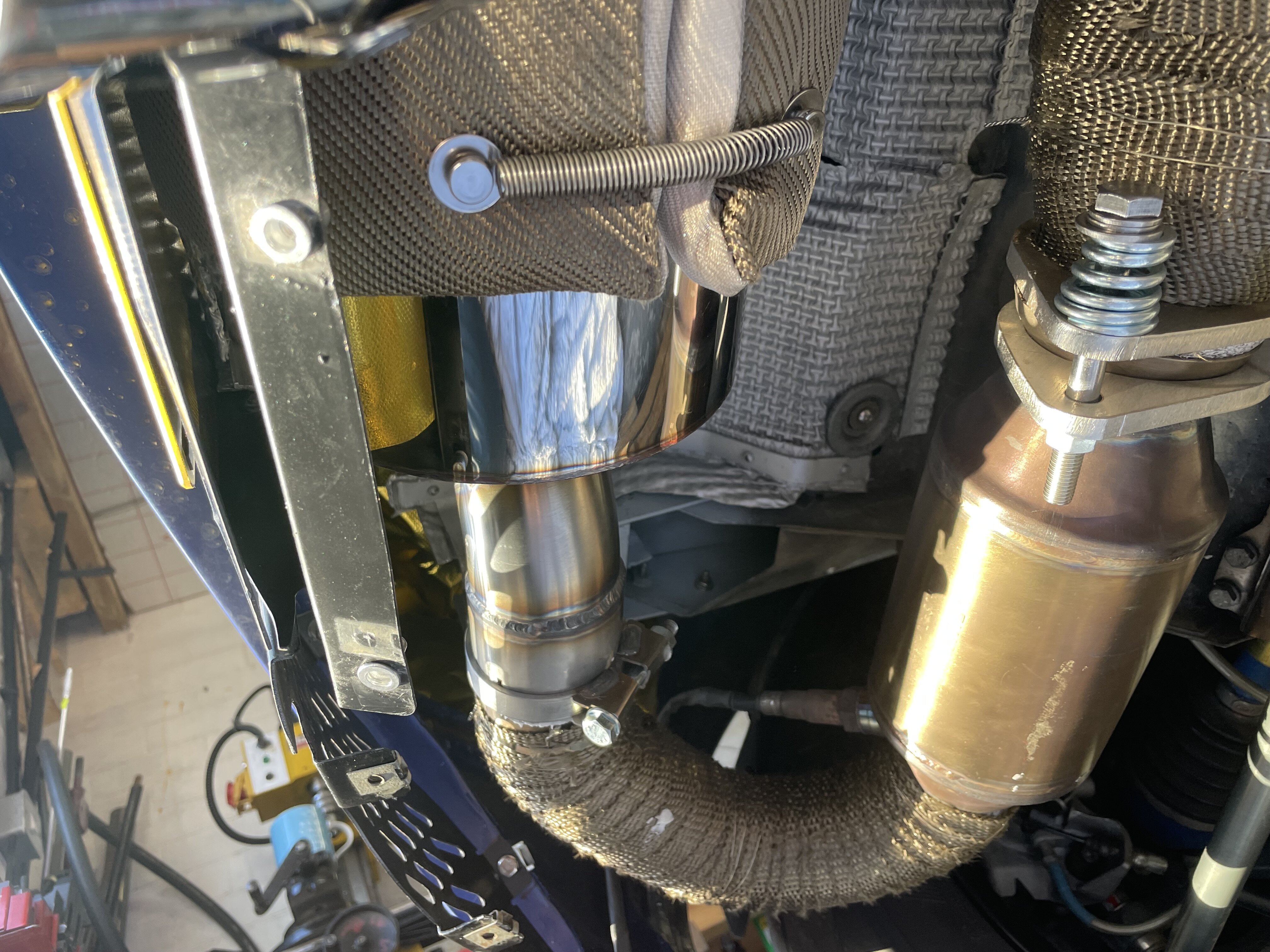

Posted
Yep. 7” box and now finally fitted and up and running. Lovely exhaust note and not too noisy. Getting all the bits of lotus to fit around the exhaust has been a bit of a fight. However, it’s done, as per the last couple of photographs. Oh, Funk motorsport  do a great product. Expensive but very effective and neat . Had it been an ‘ordinary’ car ( that is, not made of fibreglass , glue and double sided tape ) I would not have gone nuts on the exhaust wrapping and silencer jacket. However, the latter is very close to the number plate and not far from the boot floor, and in the engine bay, without some kind of heat shield , the manifold would have ensured the engine  bay got pretty hot. Even with the old system, I was surprised just how warm and cosy the boot got after a 30 plus minute trip. How effective this new system is I will find out when I use the car tomorrow .

Posted
Evening. Tickover is muted. Almost oe. Light throttle is still very restrained and likewise steady cruise is drone free. Give it some right foot and the soundtrack wakes  up . Sounds really purposeful without being outrageous. These 7” boxes are track friendly so no more than 96db at 4000rpm

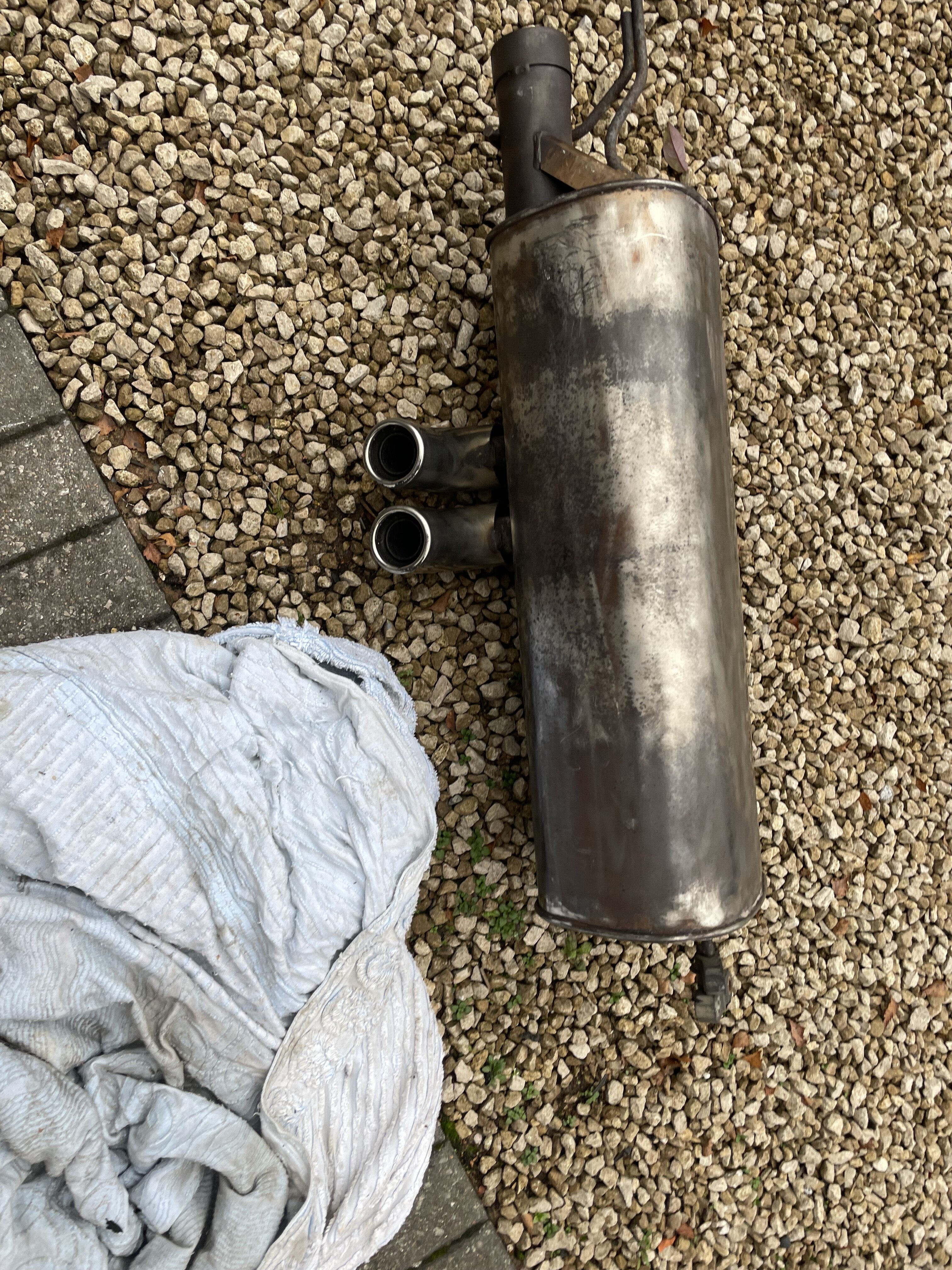

1 hour ago, DeanB said:
Did you do a weight comparison of old vs new Andy?
Certainly did. The combined new system is 8.9kk lighter than the old. Manifolds were about the same, the sports cat is 2kg lighter and the rest is in the back box. The o.e back box is a hefty piece of kit . As an aside, my boit is now much cooler than it was with the o.e system, so the exhaust wrapping and the blankets have done something useful.
