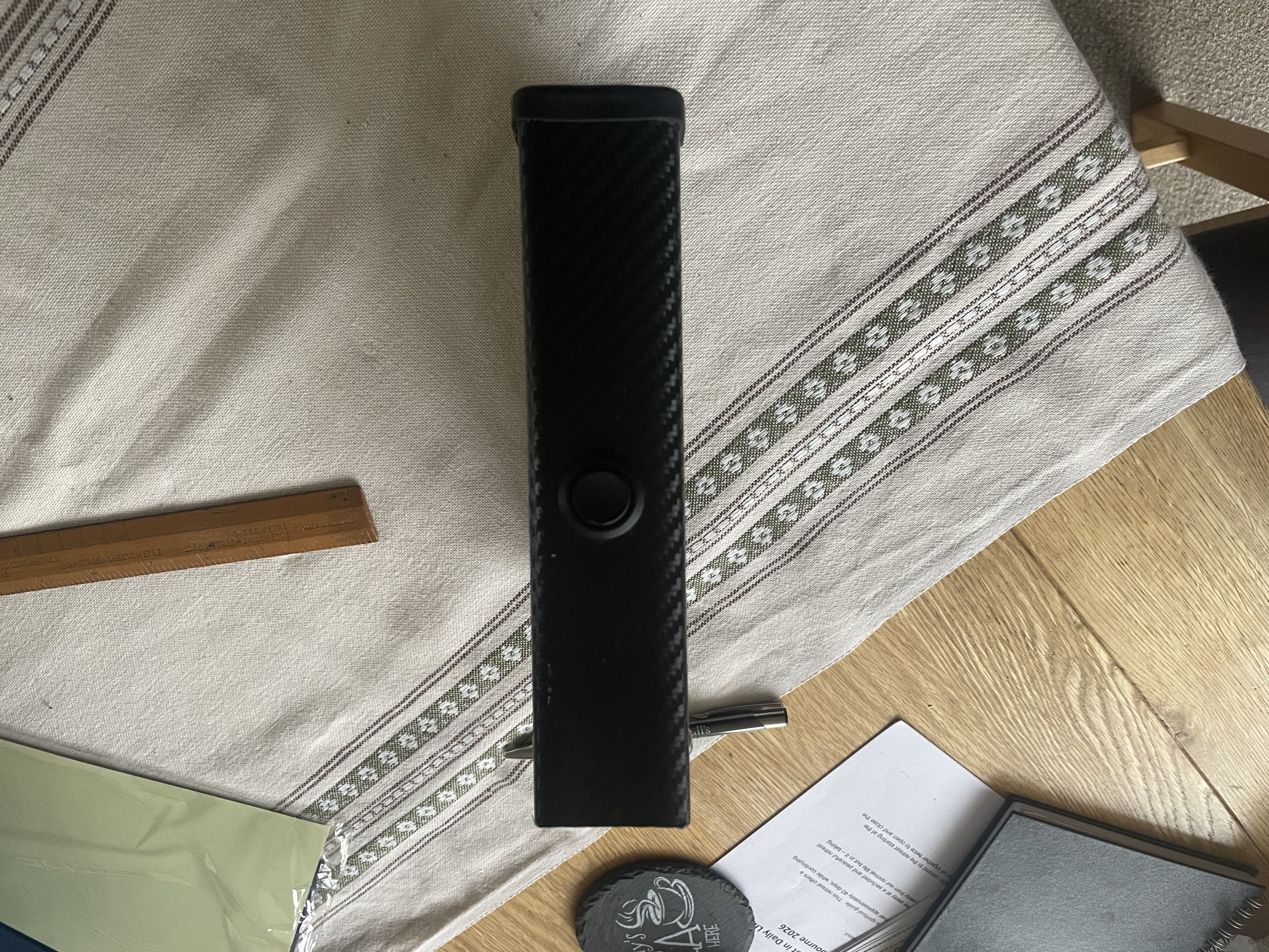

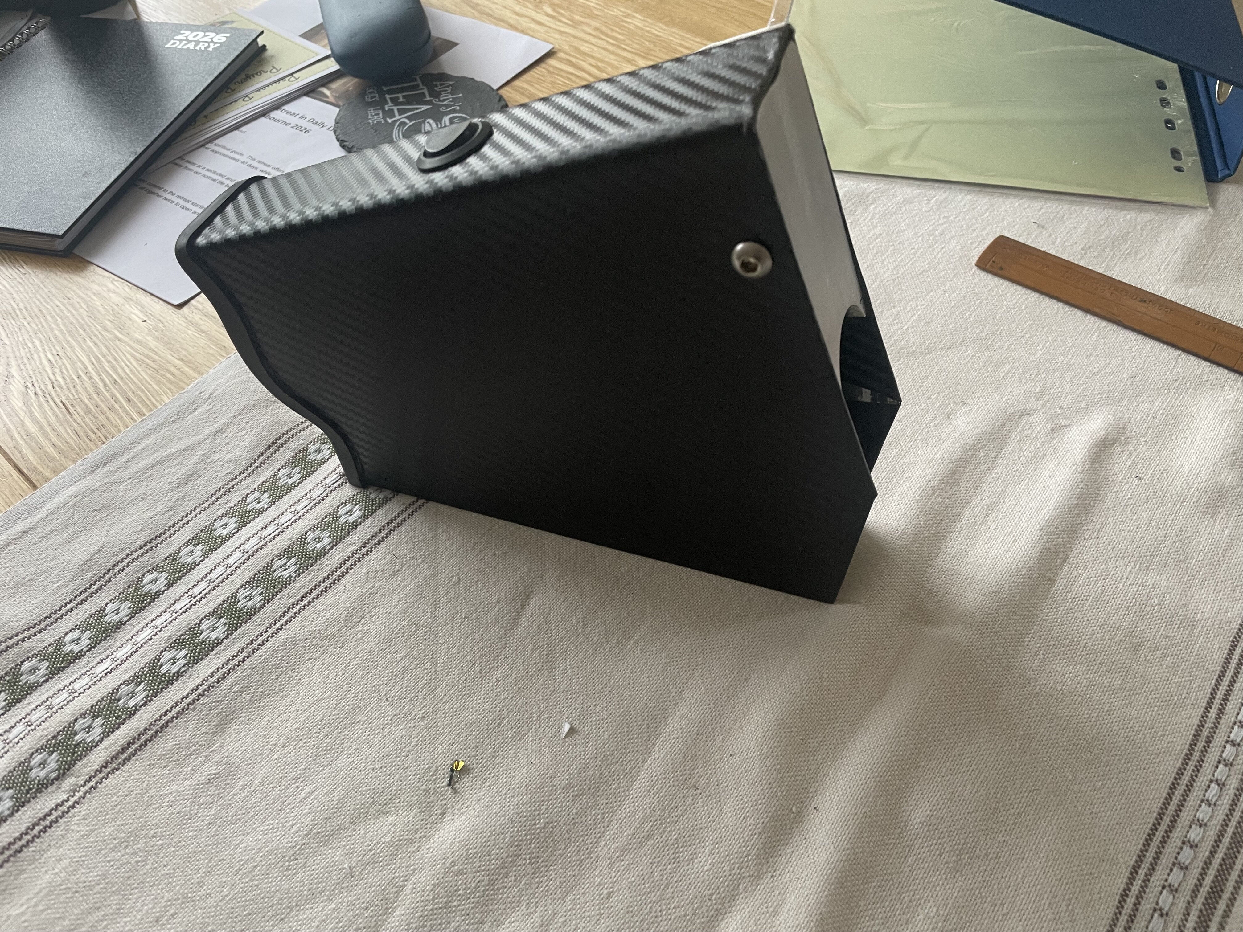

Andy wright Posted January 16 Author Posted January 16 Switch panel,completed with central locking switch and CF wrap ( eBay style ) Quote

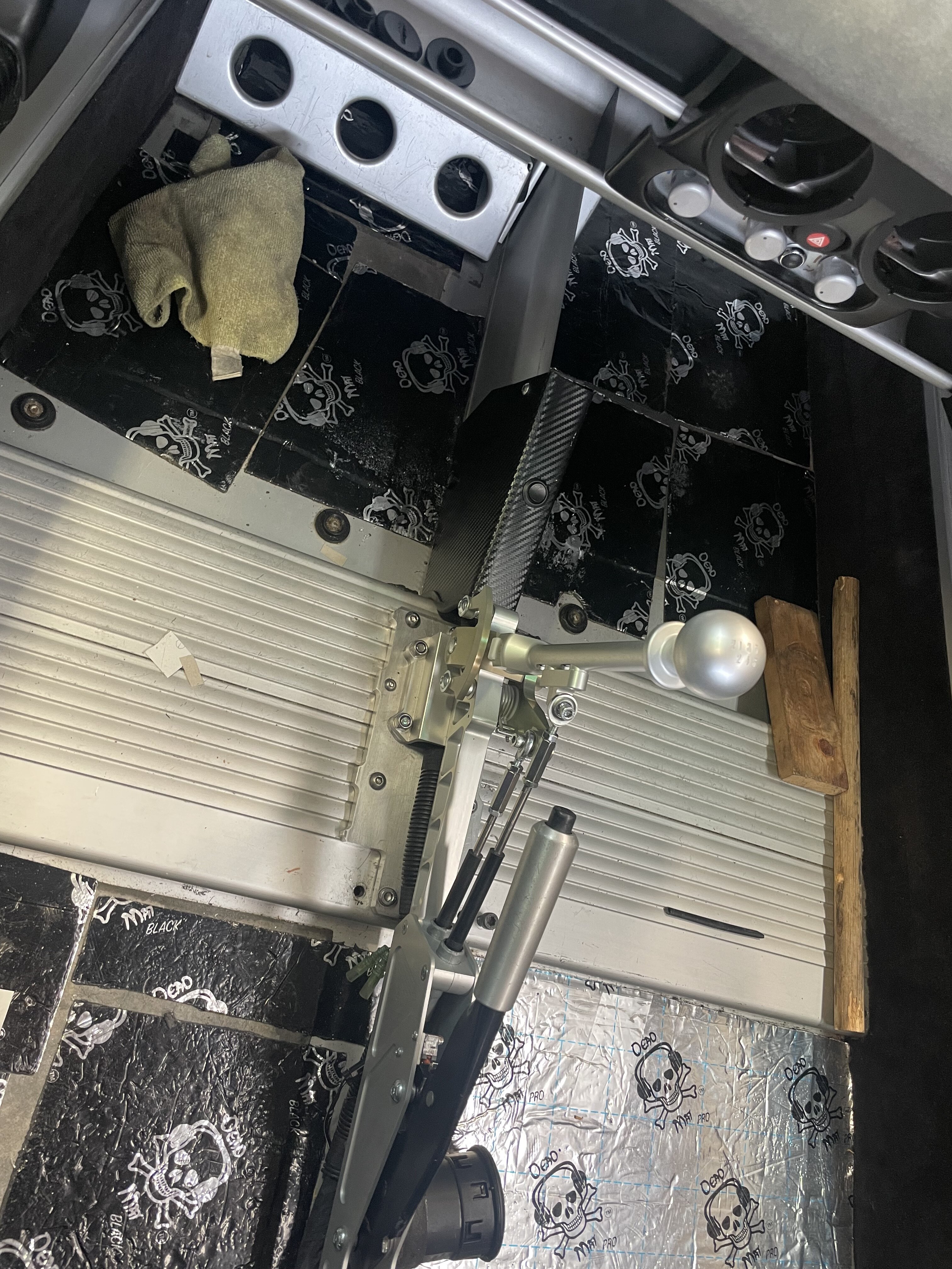

Popular Post Andy wright Posted January 17 Author Popular Post Posted January 17 And all installed . 1 1 Quote

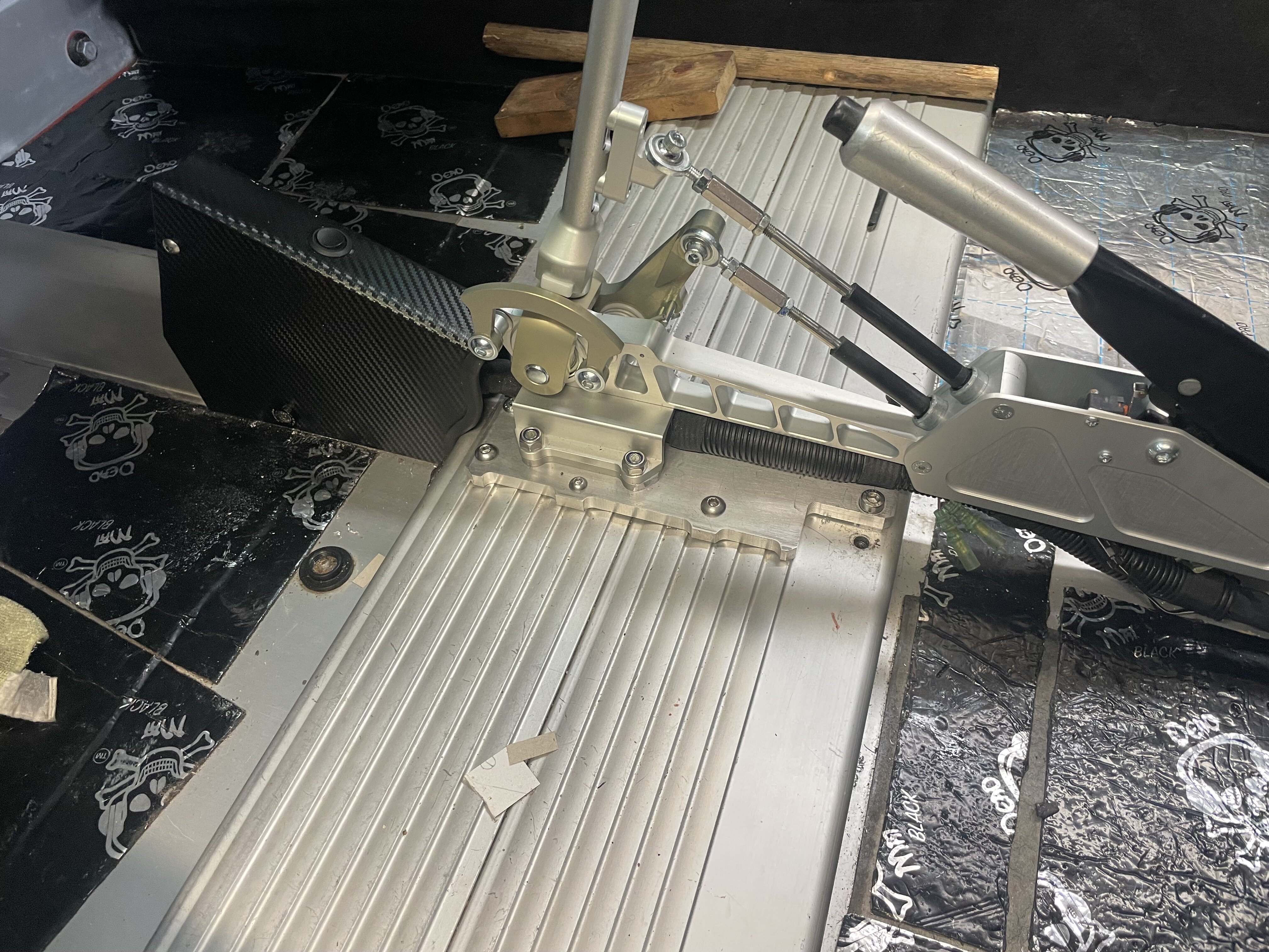

Dave-hp Posted January 29 Posted January 29 On 17/01/2026 at 09:52, Andy wright said: And all installed . Got the seats and carpet back in yet Andy? Hows the stick look then? Quote
Andy wright Posted January 29 Author Posted January 29 21 minutes ago, Dave-hp said: Got the seats and carpet back in yet Andy? Hows the stick look then? Carpets in but no seats. Delay caused by a bit of brake installation, a fall which has resulted in a fractured kneecap that is keeping me out of the garage and temptation to fit a brake bias cage 1 Quote

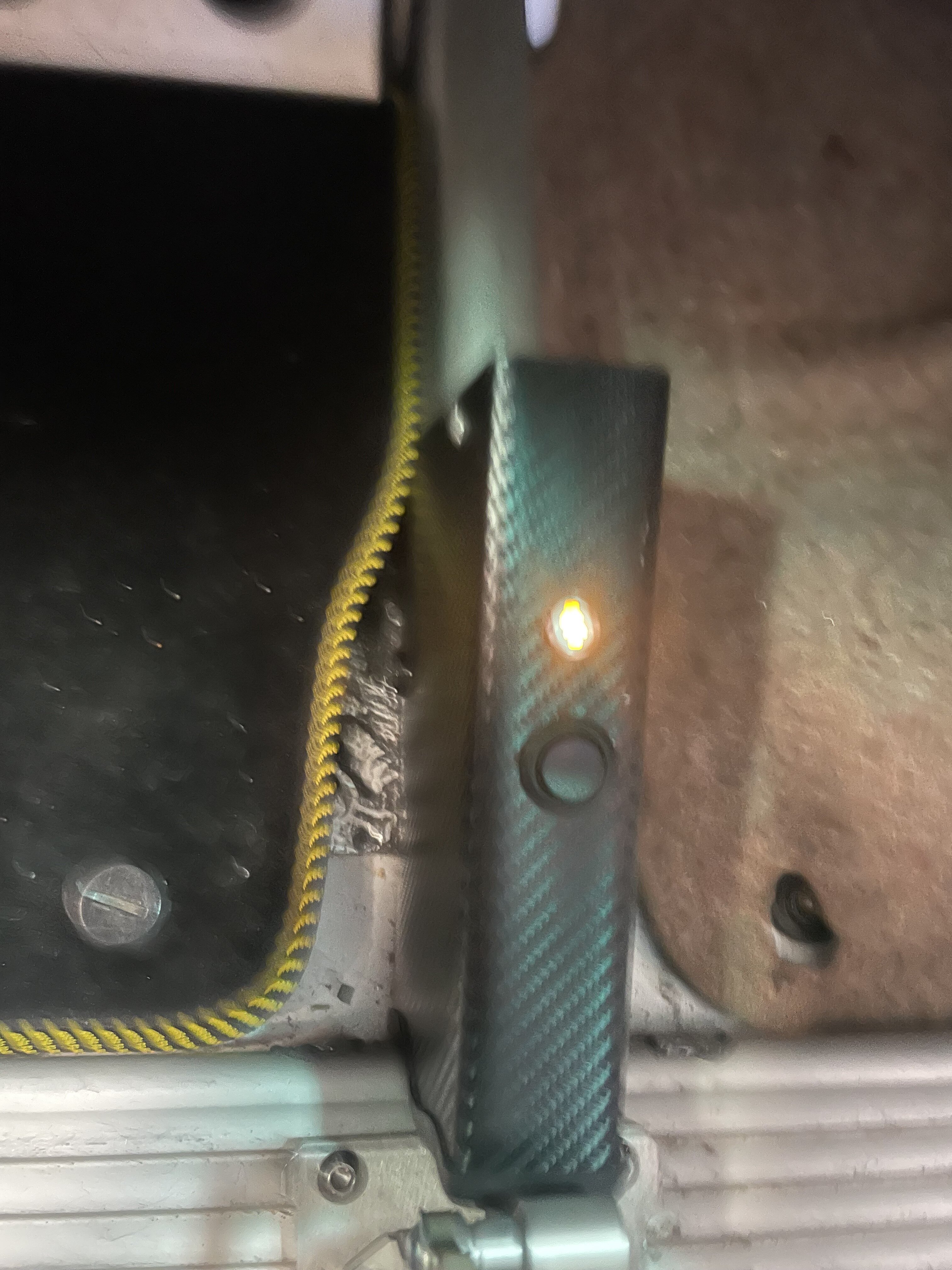

Andy wright Posted February 1 Author Posted February 1 So,the summary. Brake callipers refurbished and fronts converted to side feed. Tick. Two piece rotors fitted front and rear. Tick. New pads. Tick. New handbrake cable. Tick. Bigger bore Eliseparts master cylinder fitted . Tick. Brakes bled. Tick. HPE shifter fitted. Tick. Penske dampers fitted. Tick . All these trivia may just have a minor impact on the overall feeling and general performance of the car but will pale into insignificance when compared to the latest addition, Yes, an led lamp next to the central locking switch ( I have an Elise that has electricity that goes all the way into the doors ) ) This one is the game changer . Don’t you think ? Quote
Lithopsian Posted February 3 Posted February 3 Electricity in the doors 🤩 How did you know when the doors were locked before? Just have to remember? Quote

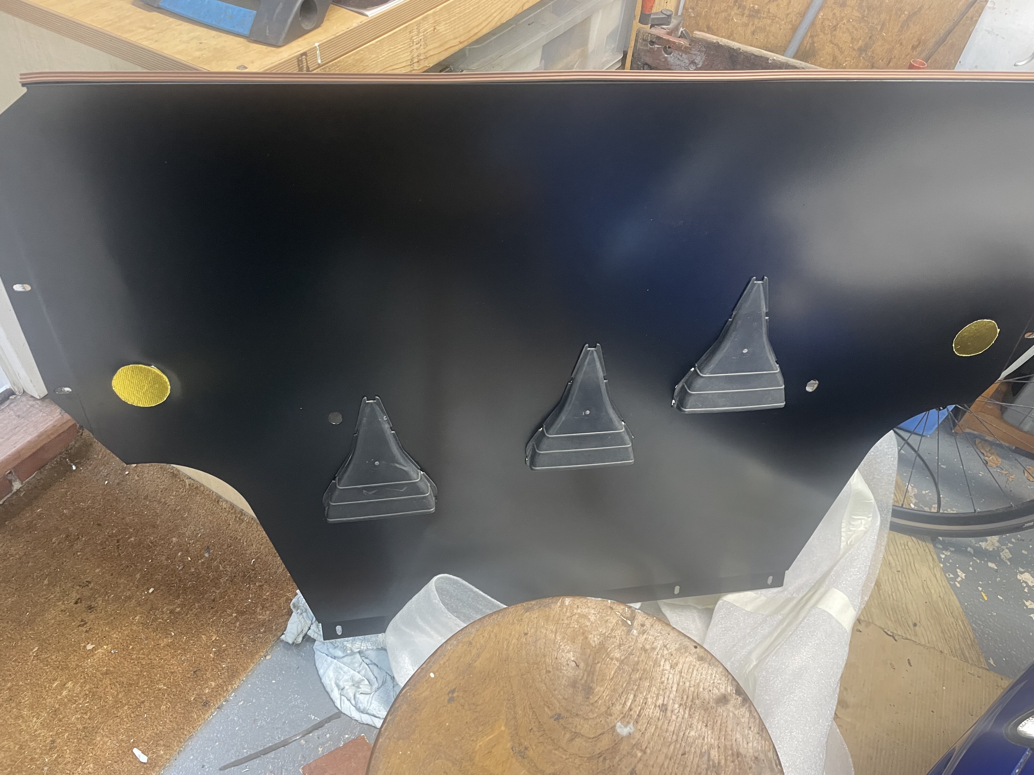

Andy wright Posted February 4 Author Posted February 4 And is there no end to the level of bling this idiot is prepared to go to? Undertray and diffuser powder coated . Picture of diffuser to follow . ( the above was a rhetorical question ) Quote
Dave-hp Posted February 4 Posted February 4 9 hours ago, Andy wright said: And is there no end to the level of bling this idiot is prepared to go to? Undertray and diffuser powder coated . Picture of diffuser to follow . ( the above was a rhetorical question ) Bling indeed! Quote

Andy wright Posted February 28 Author Posted February 28 Well. I managed to get into the car, drive it around Ashbourne, come home and get out of it again. First impressions. Gearchange. Very solid and precise . An improvement over the standard Lotus offering, but this is in part because the whole system is more rigidly mounted to the floor. I suspect that if I had re engineered the Lotus one, the residual difference would have been reduced. Brakes. Still more pedal travel than I would like and now the servo is operating, the pedal feels less firm and sold than it did when I was bleeding the system. Howver, the pads do need to bed in, so I will use the car a bit and then perhaps bleed again and maybe find a Lotus specialist who can cycle the ABS Penske 1 way damping. Transformational. After a few minutes I was no longer dodging the holes and bumps in the road. The ride is much more composed . No crashes or bangs. It’s much more able to soak up bumps. Yes, it’s still firm but feels less stiff than the Bilsteins it has replaced despite having higher spring rates . The benefit of really good damping I guess. So,an expensive upgrade but absolutely worth it . Quote
