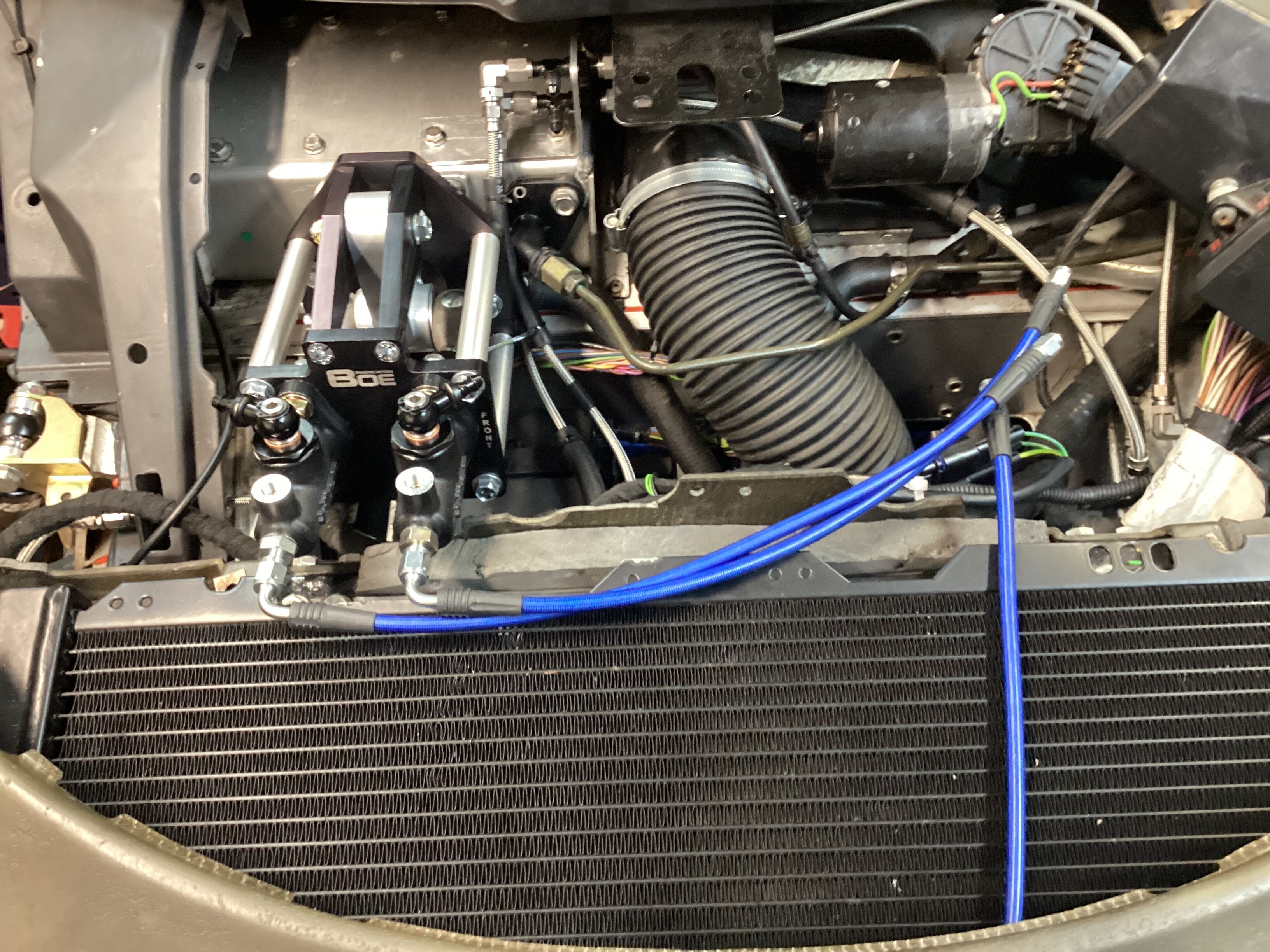

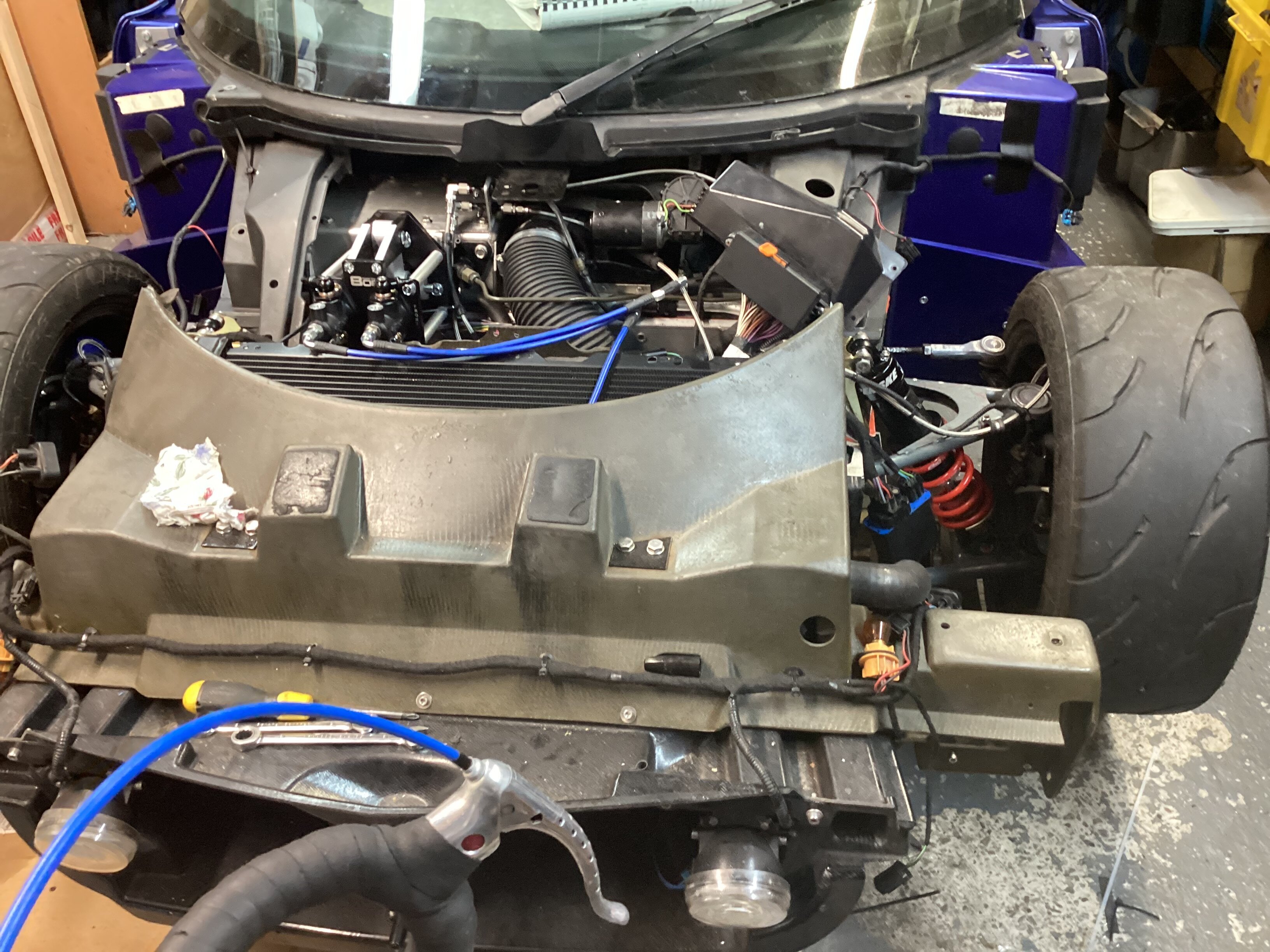

Andy wright Posted March 30 Author Posted March 30 The BOE cage eventually tempted me . Now on the car . But first job was to remove the brake pedal, re drill and bush the pushrod hole to give me a pedal ratio close to 6:1 ( 5.8) . Next job was to replace the brand new 0.7” bore master cylinders with 0.625” ones and then plumb the whole lot in . First road test this afternoon. . Upsides. The brakes are wonderfully progressive. The harder one presses, the more rapidly the car slows down. . Next, at speeds of 30 mph and under in traffic, the brakes are no longer either on if off . So tick number two. . Much less pedal travel . Also nice. And the downside ? More pedal effort . I calculated that I would need about 55lb of pedal effort for a 1G stop. And I think that is about how it feels . Initially the brakes feel dead and unresponsive until one adapts to just pressing harder.Do that and the car stops . Quickly. Quote
Lithopsian Posted March 30 Posted March 30 Not much space for that cage 😲 Did you know for sure it was going to fit? Quote
Andy wright Posted March 30 Author Posted March 30 2 hours ago, Lithopsian said: Not much space for that cage 😲 Did you know for sure it was going to fit? BOE ( USA) designed it specifically for the S2 Elise so I was pretty confident it would fit onto the existing bell and pedal box. Clearance was always going to be an issue and with hindsight, given that I had to buy two new master cylinders, I should have bought the short body AP ones as that would have cleared the radiator more readily . However, fluid feed and transfer was always going to be tricky as they are all top feed or end feed. The o.e one has side exit which helps with the packaging . Quote

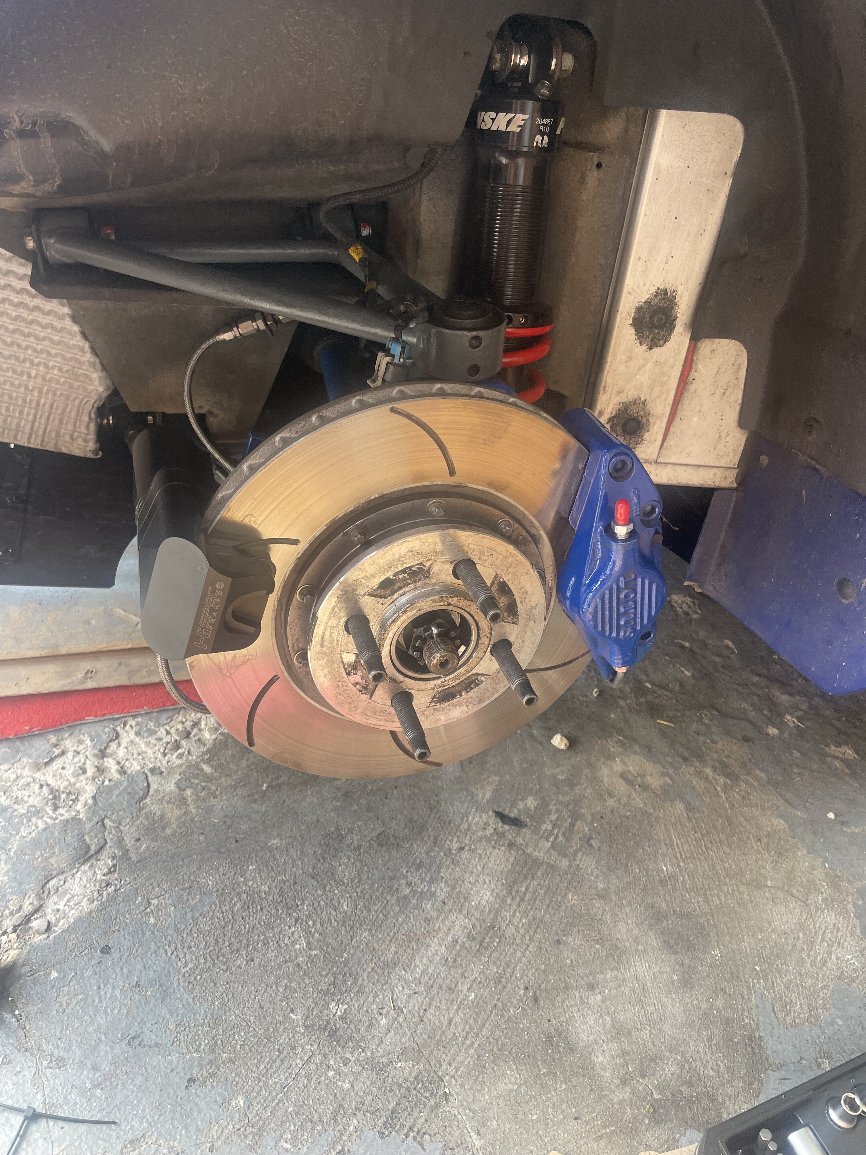

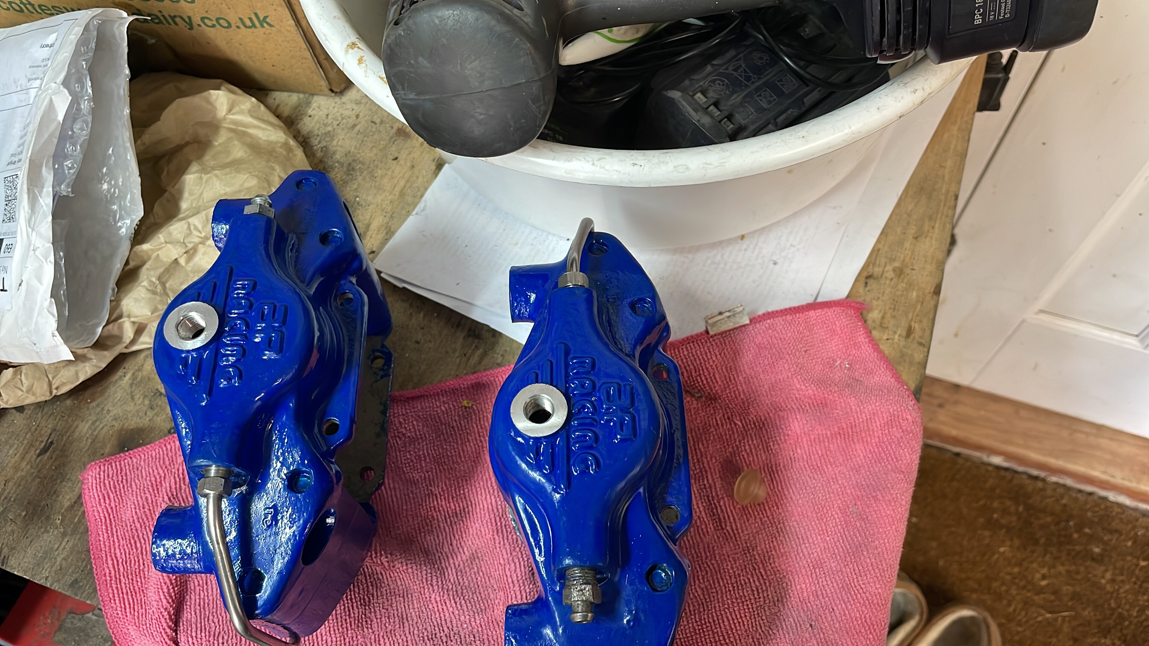

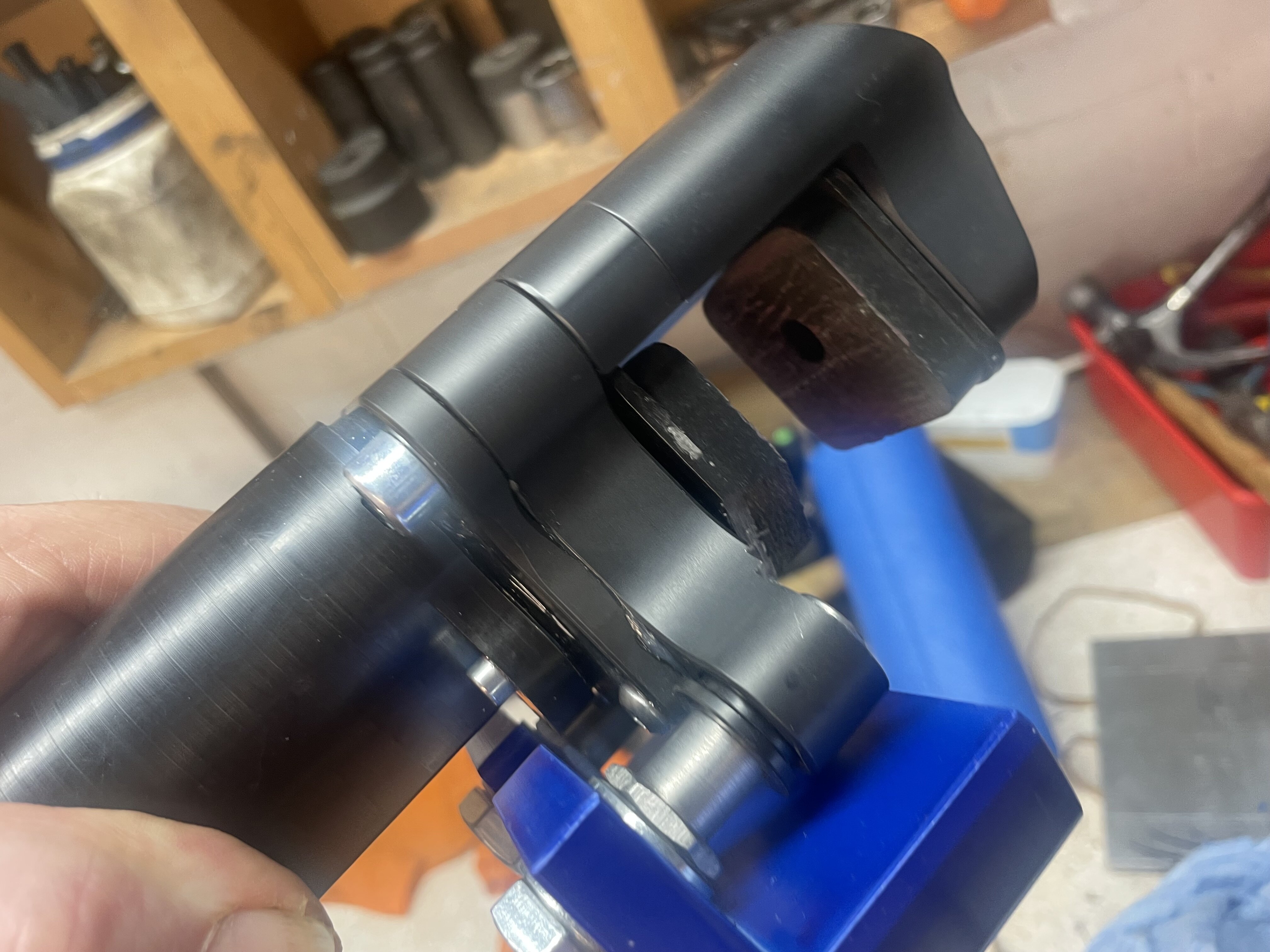

Andy wright Posted April 7 Author Posted April 7 And another pair of Calipers that I have adapted to side feed. Plan to put these on the rear . Eliseparts radial caliper adaptors fitted ( they fit well ) and with a pedal box and bias bar, it would be rune it to upgrade the rear brakes. The handbrake is an issue as the Brembo Calipers are very heavy. Wilwood make a neat handbrake caliper but getting hold of a pair with the correct 1.1” dies width clearance is a bit more difficult. Plenty of the 0.81” ones available in places like Demon Tweeks . Quote

Andy wright Posted April 8 Author Posted April 8 I managed to have a useful chat with someone at Hispec this afternoon. First point is that all items are made to order . The parts to make are in stock but because they offer bespoke colours and fittings, they make to order. Lead time is approx 28 days . Next. The Calipers. The V3 is light and inexpensive. However, there is , in my view, a slight snag. It’s to do with the cable. The lotus handbrake cable, like most manufacturers who still use a mechanical handbrake, has the outer cable anchored at each end and the handbrake lever on the caliper operated by pulling the inner wire against a fixed outer . On the V3 caliper, the arrangement is more like a bike brake caliper, where both the inner and outer part of the cable pull against each other and each each moves one half of the operating lever arm. I think this will make the rigging of said cable not an easy job. Doable, but not easy. The other option is the Spot electric caliper. Like the V3, it will need a bespoke mounting bracket, but the wiring would , in my view, be an easier thing to do than rigging the cable. The downside is the cost. The electric solution is £700 . My plan is to install the two pot rears and then decide how I want to proceed with the handbrake. I definitely don’t want to keep the heavy Brembo. Quote

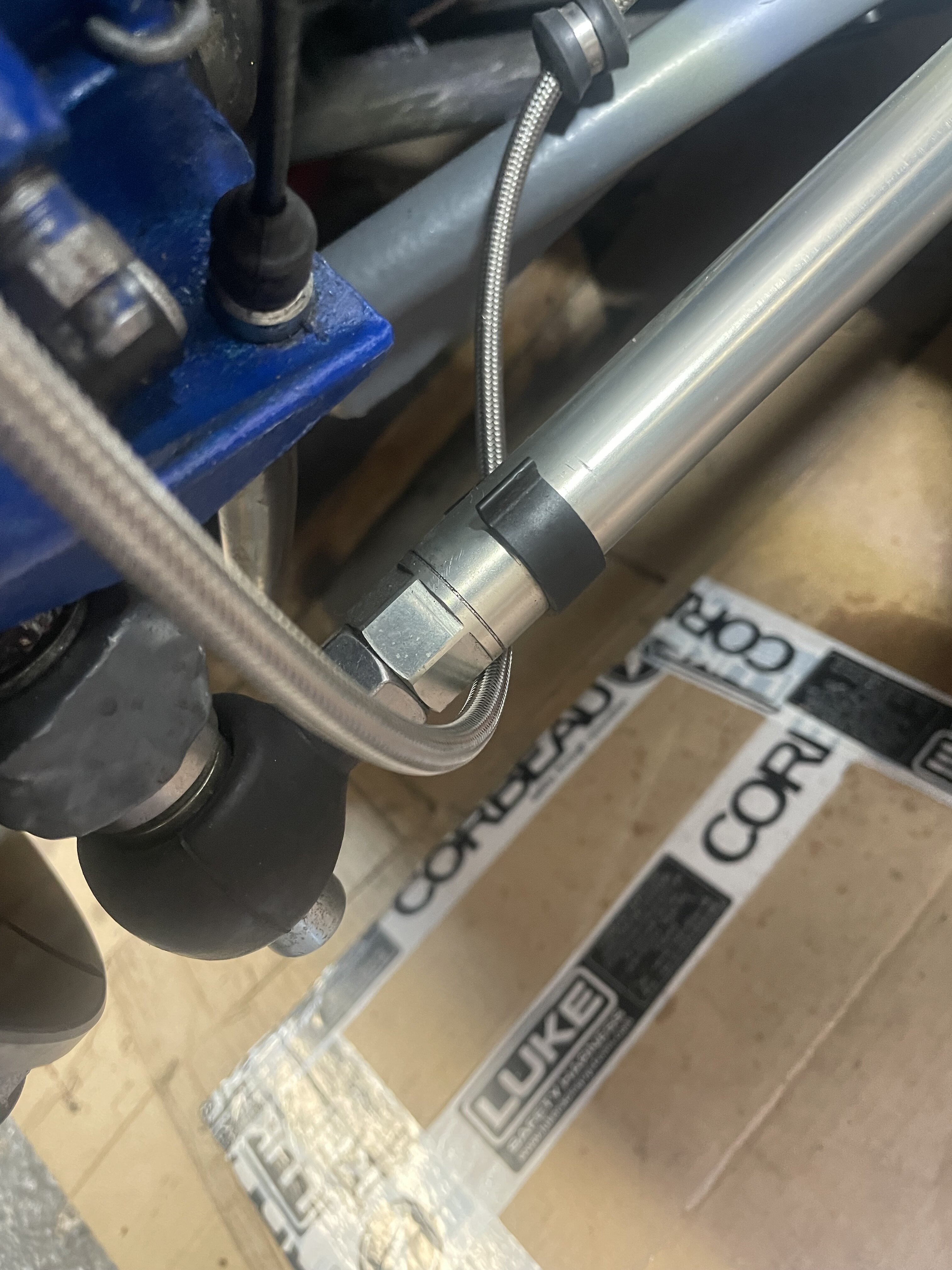

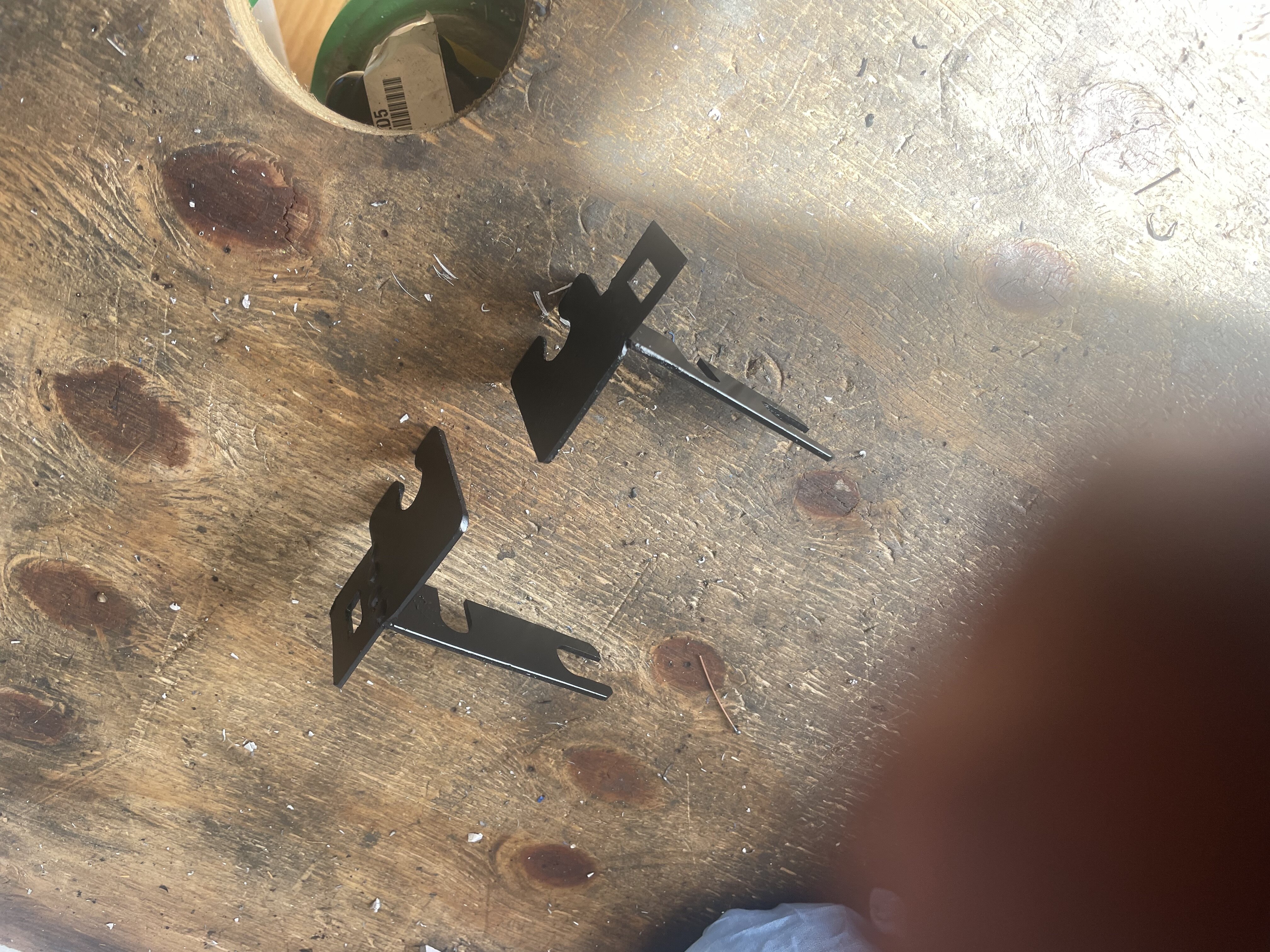

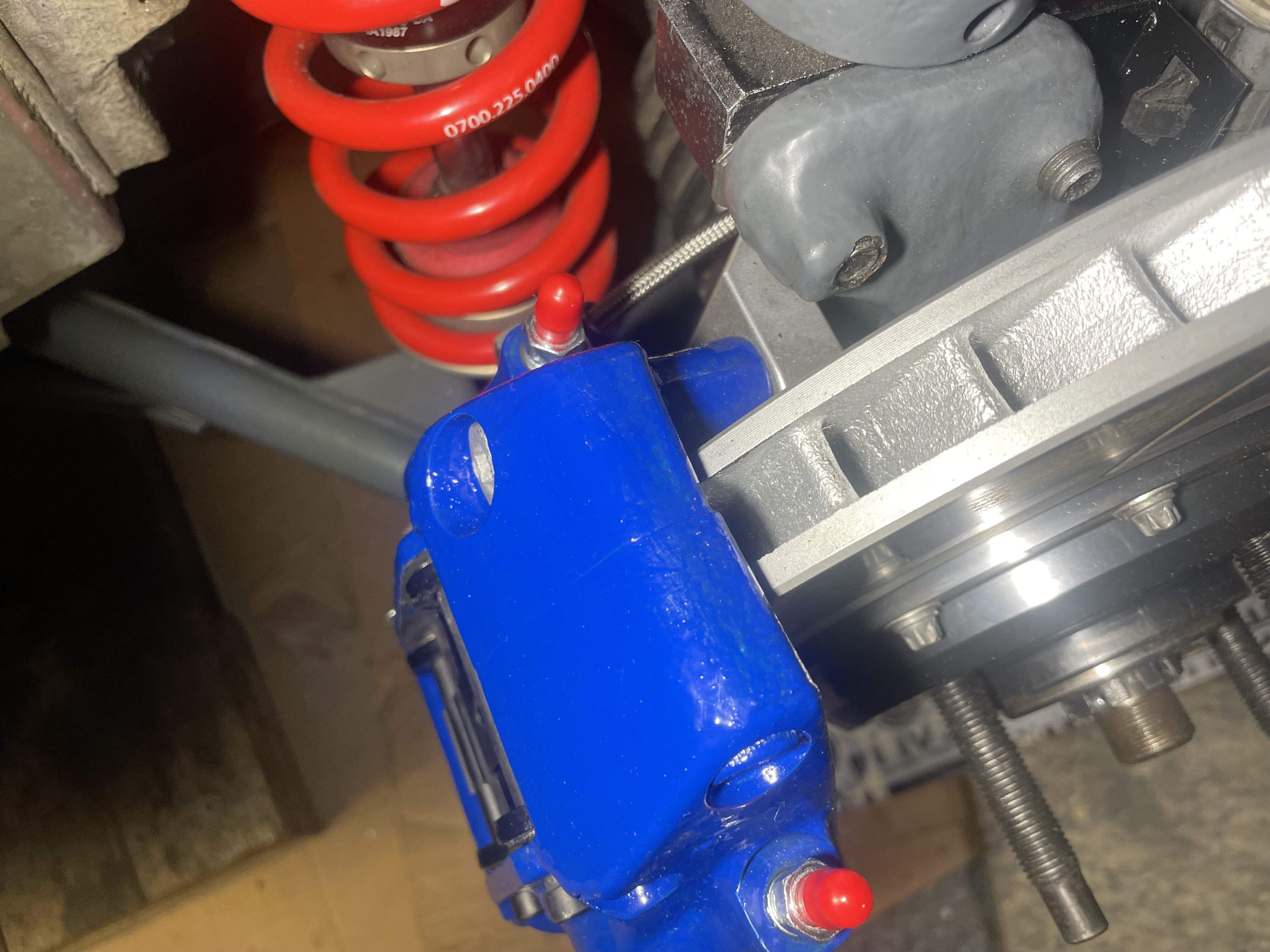

Andy wright Posted April 10 Author Posted April 10 Rear caliper instal hit a slight bump in the road . Because I have gone to side feed, I needed to use a banjo feed to the caliper . And are the banjo bolts I have long enough? Of course they are not. The little #@£#@ards . 5mm longer ones ordered. I did manage to make up a brake hose and speed sensor support bracket and I have one hose made up , but now need to wait for the bolts. Quote
Andy wright Posted April 11 Author Posted April 11 Well, they are on the car, connected up , bled and ready for a road test. Balance bar adjusted to 55 front, 45 rear to start with and the pedal feels really firm . But the road will be the judge. Then it’s just a matter of getting ready of the boat anchors that masquerade as handbrake Calipers. IMG_9769.mov Quote

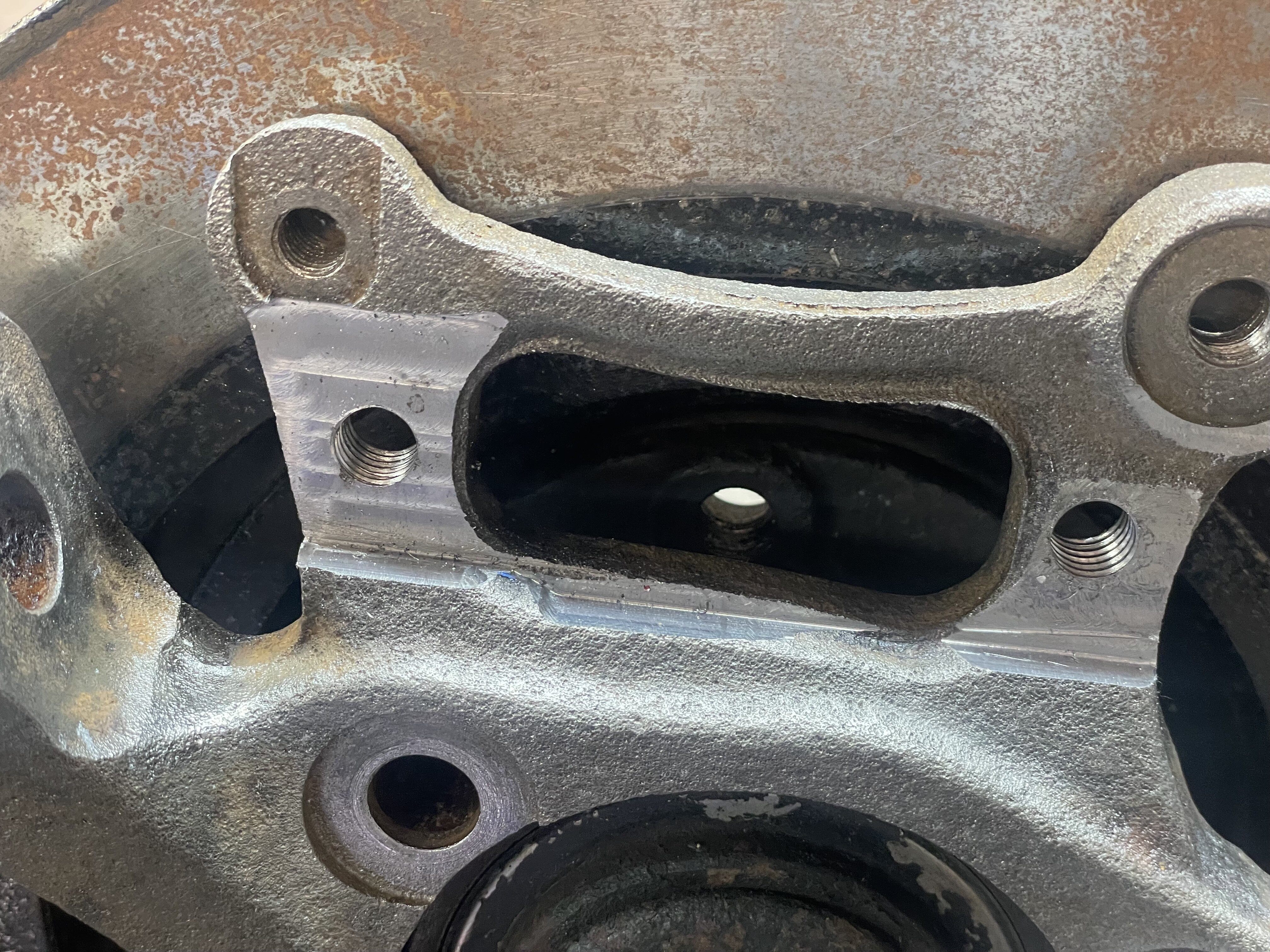

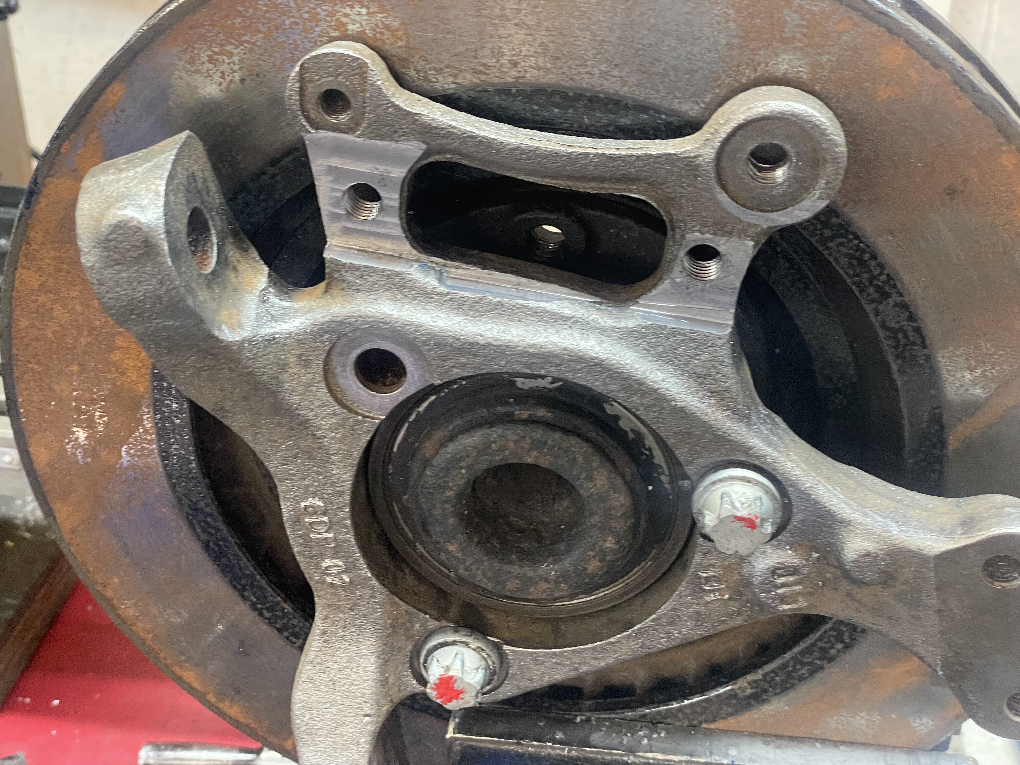

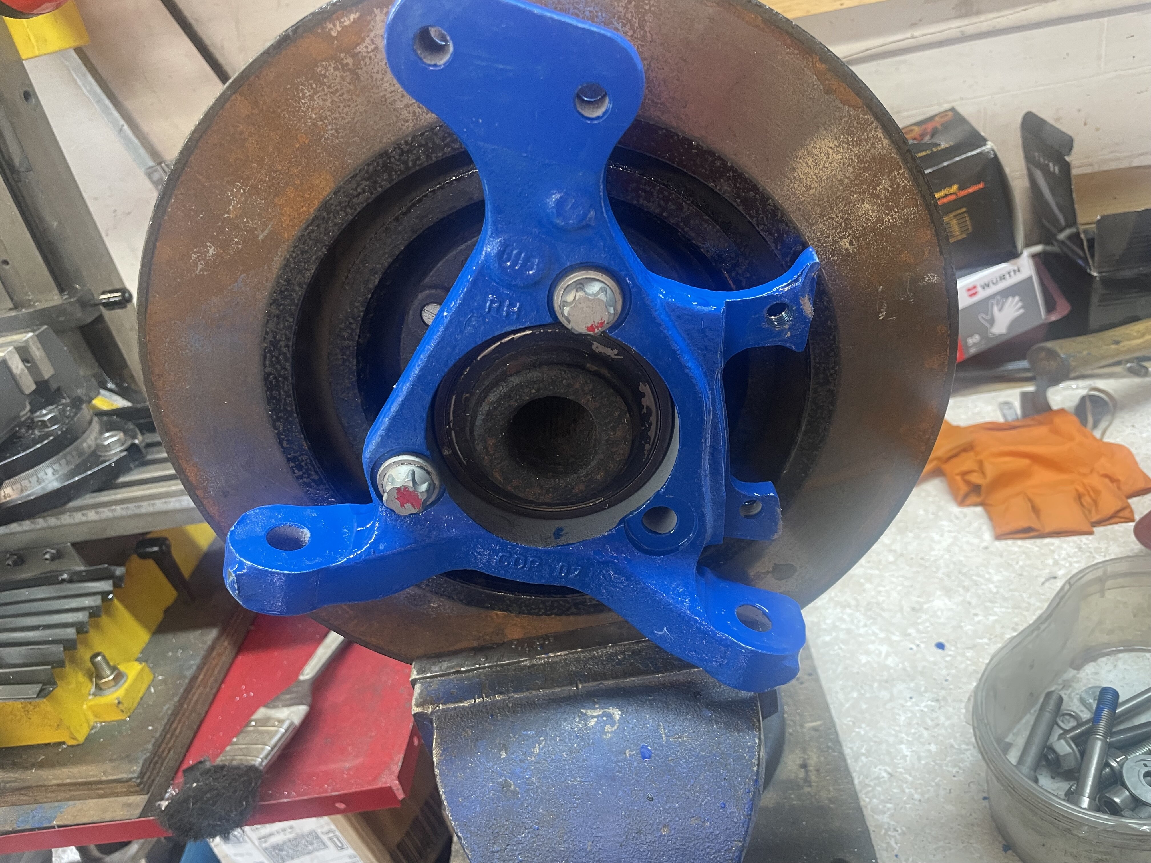

Andy wright Posted May 31 Author Posted May 31 well. It’s been a while. Handbrake has progressed. Now have a Hispec electric spot handbrake Calipers. Fitting them required the purchase of a spare set of hubs, more than a few moments at my milling machine and even some rattle can paint. But they work . Extremely well. And it has allowed me to have the two pots on the rear. Quote
