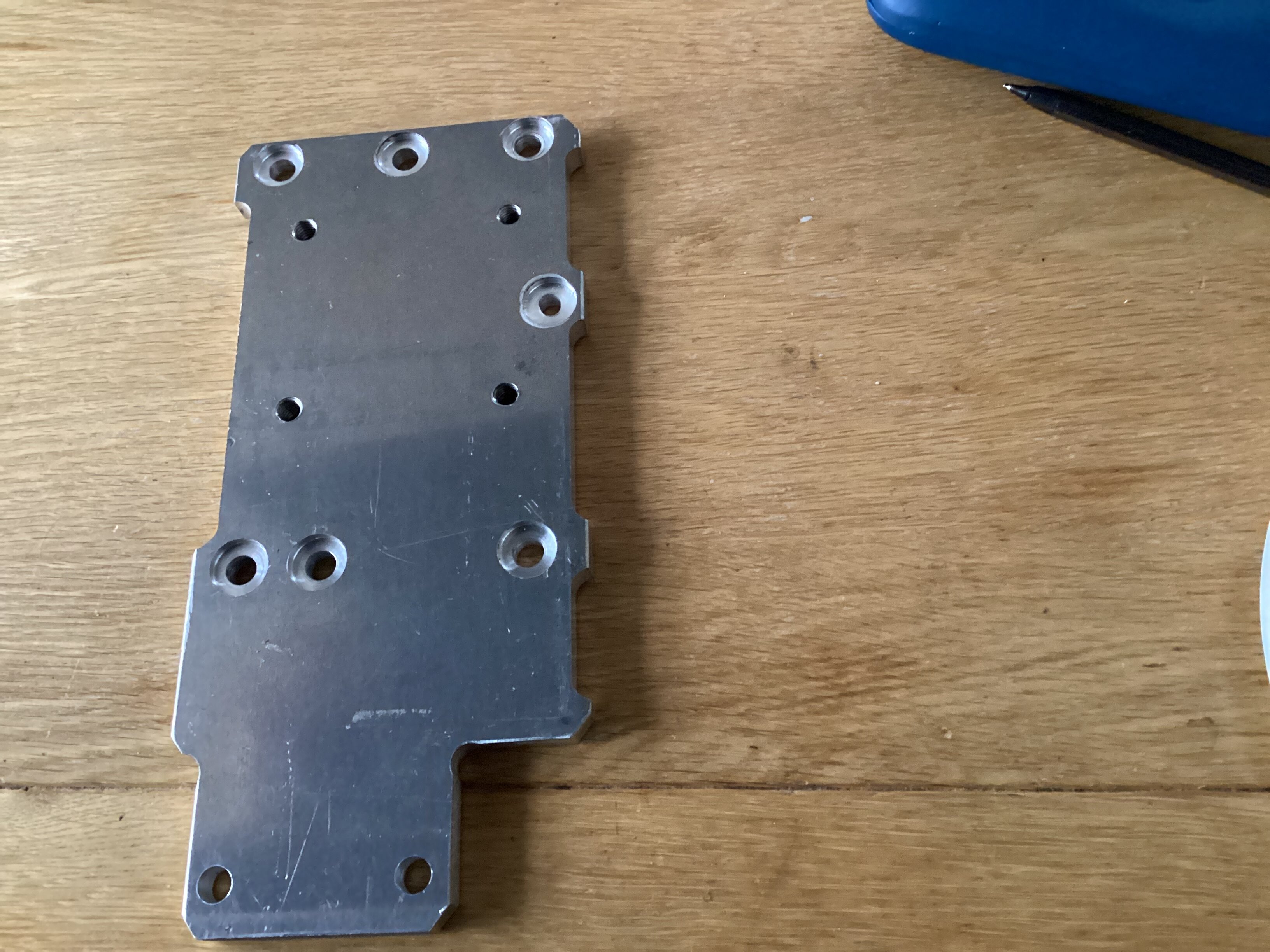

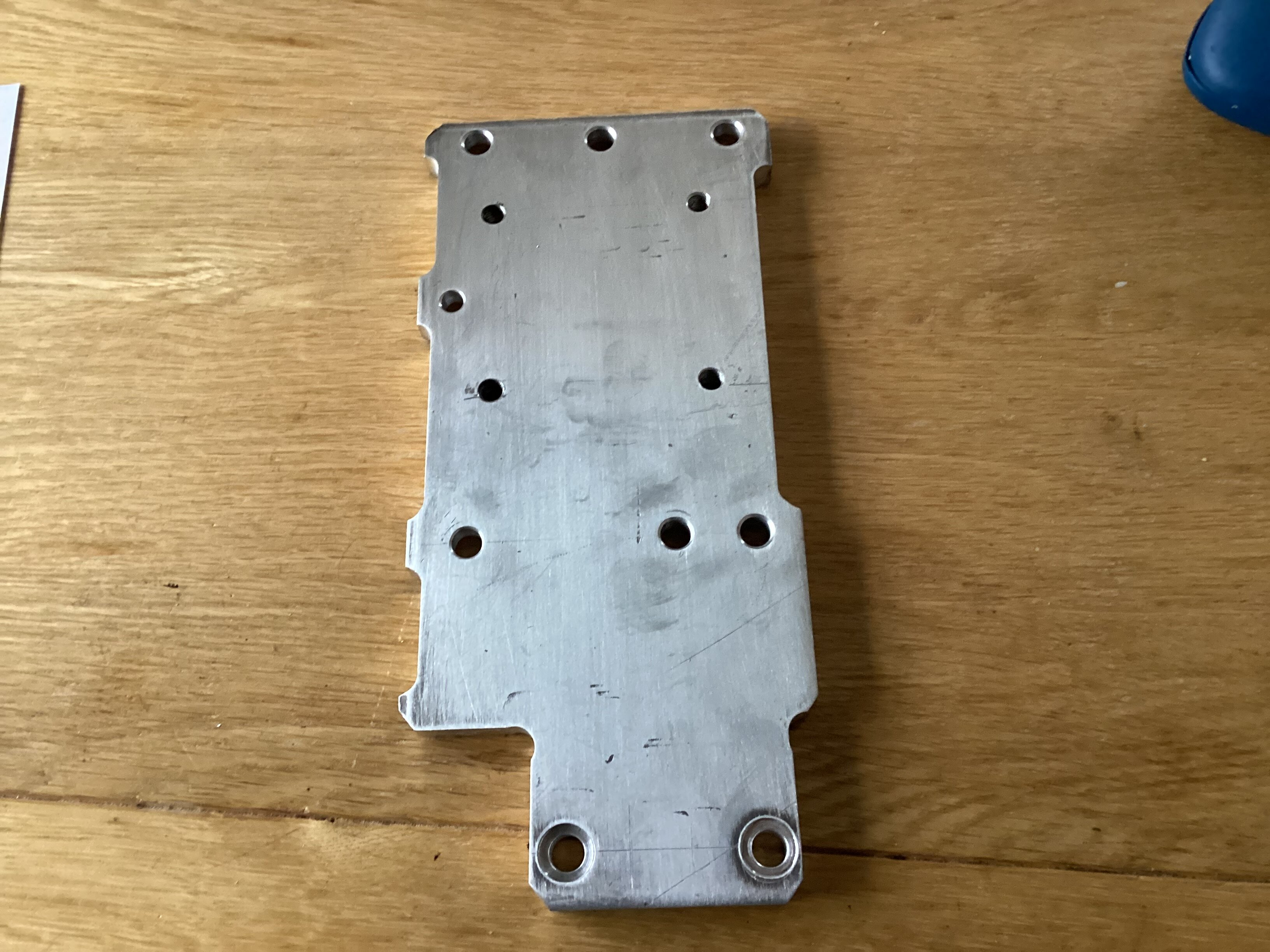

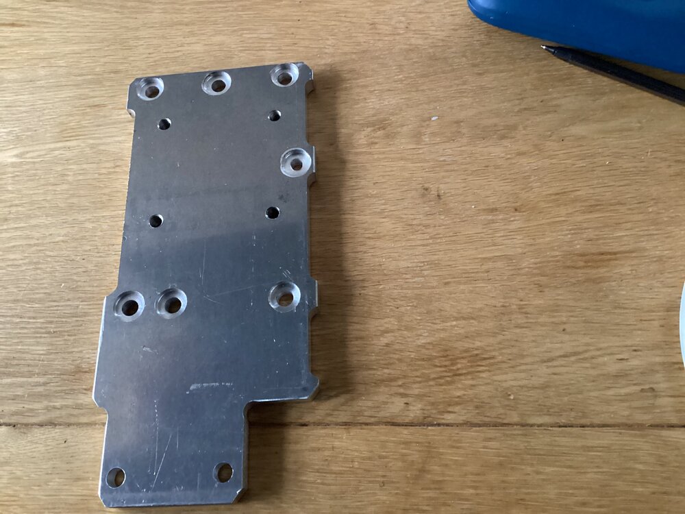

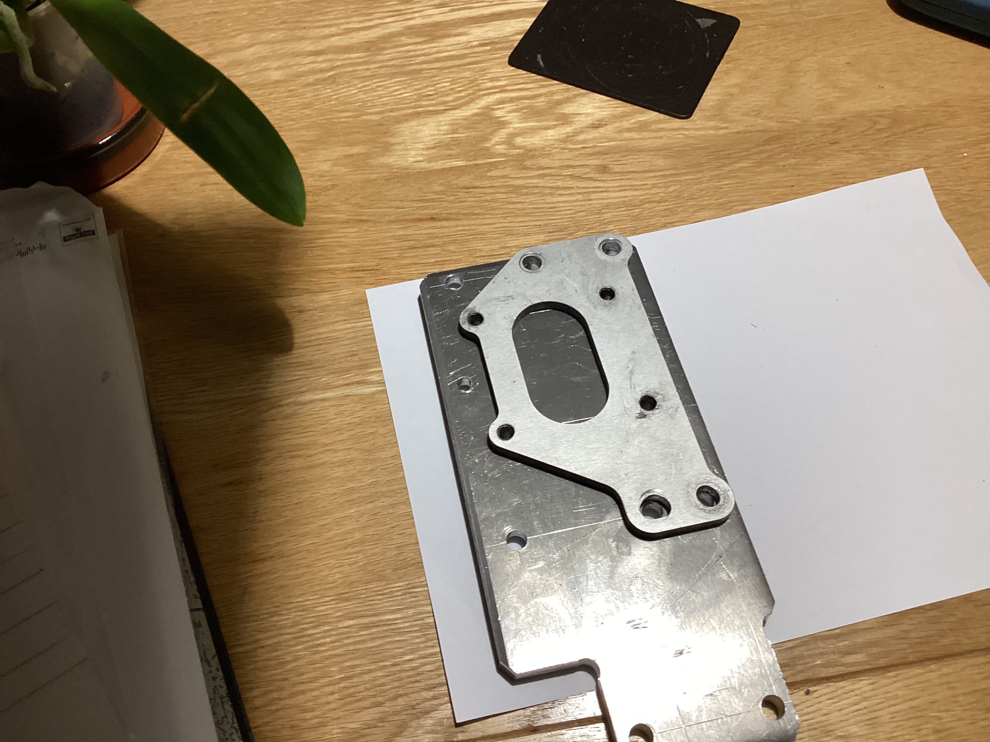

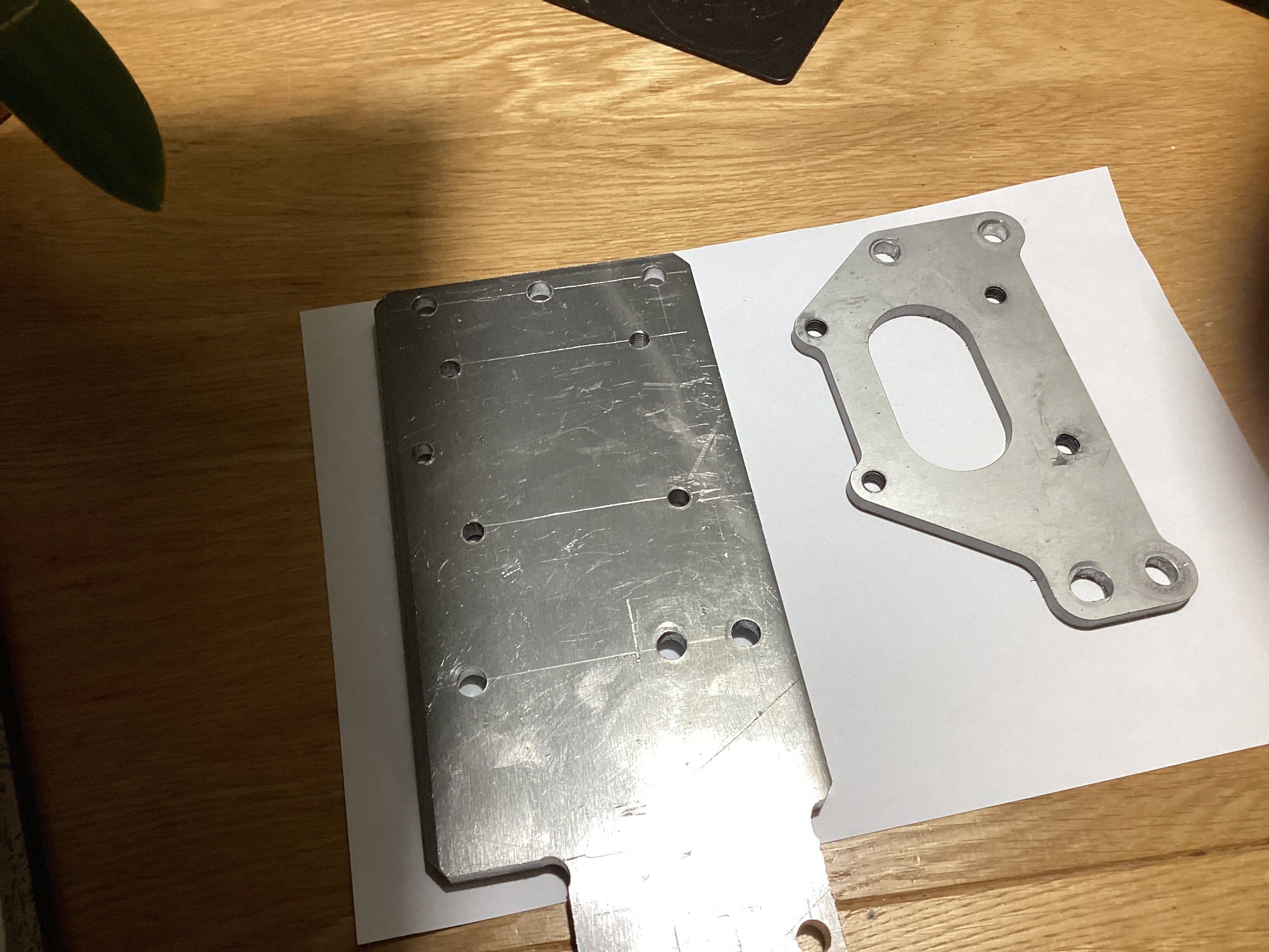

Metal,has arrived so tomorrow I can get in with making a new  baseplate for the HPE shifter . Oh and the engine got a new air filter for good behaviour . ( The old one I had not looked at in the 14 months  of my ownership as the car had been serviced just before I bought it. The one I removed looked as if it had been in place for a decade.

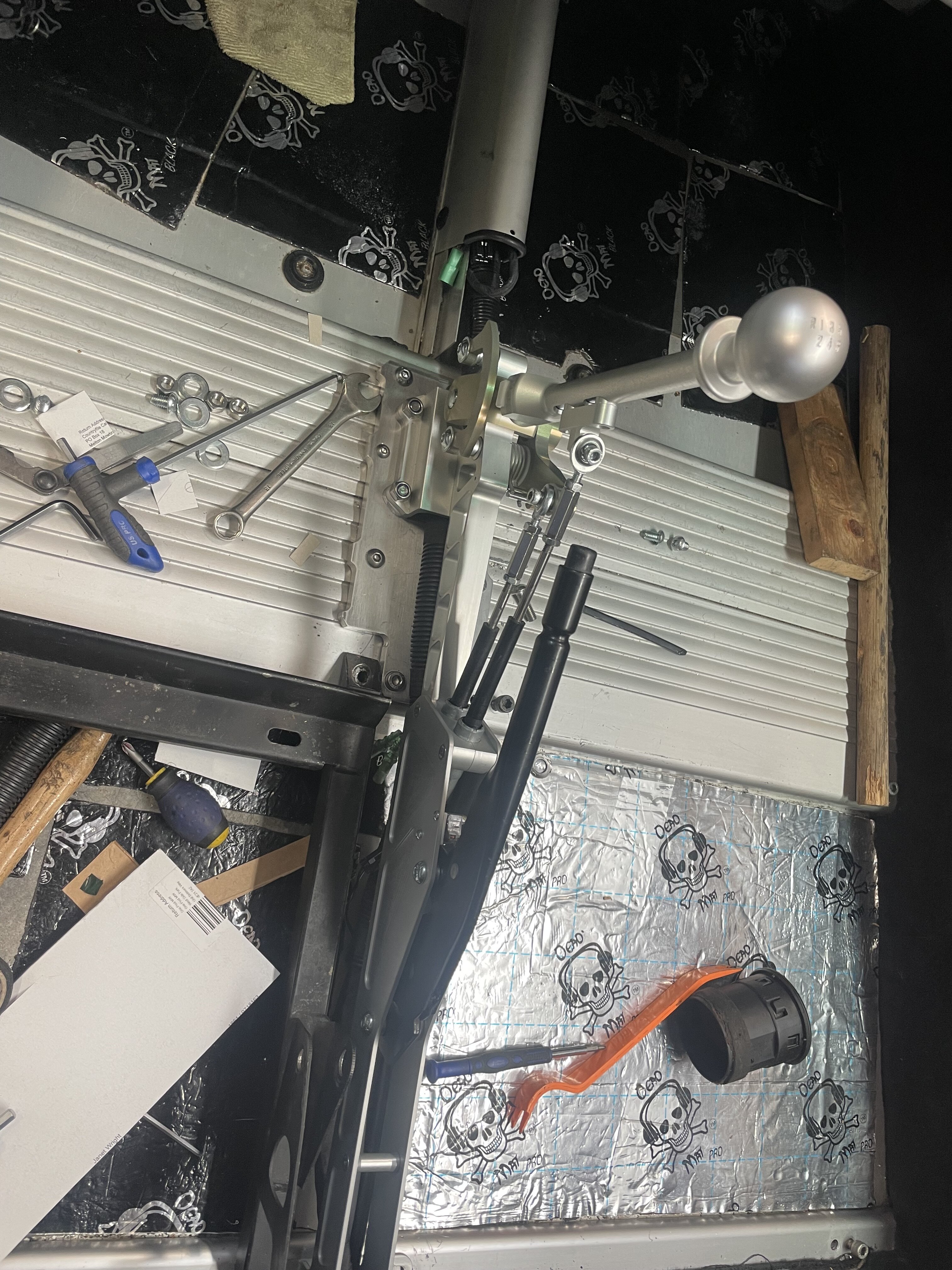

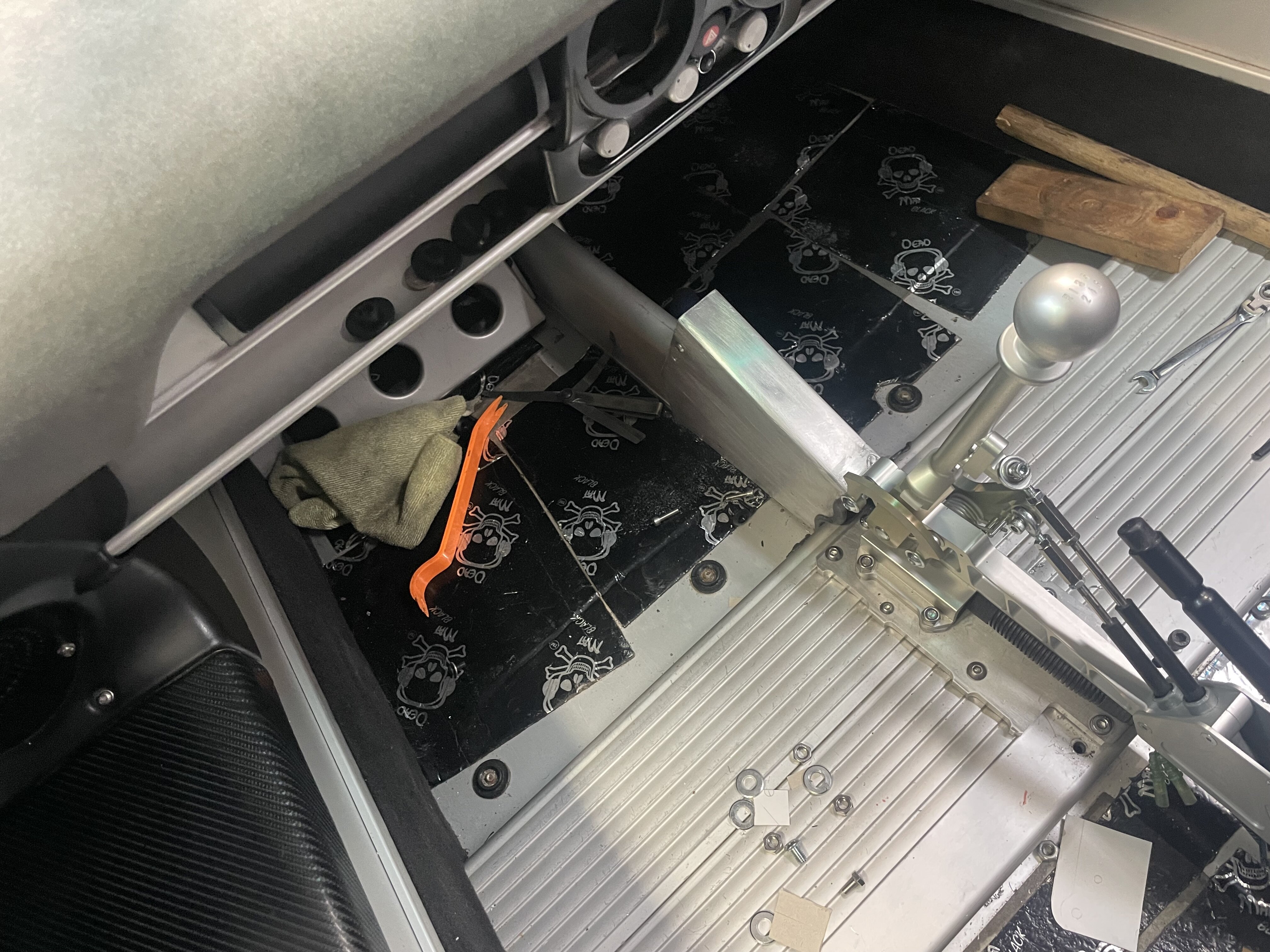

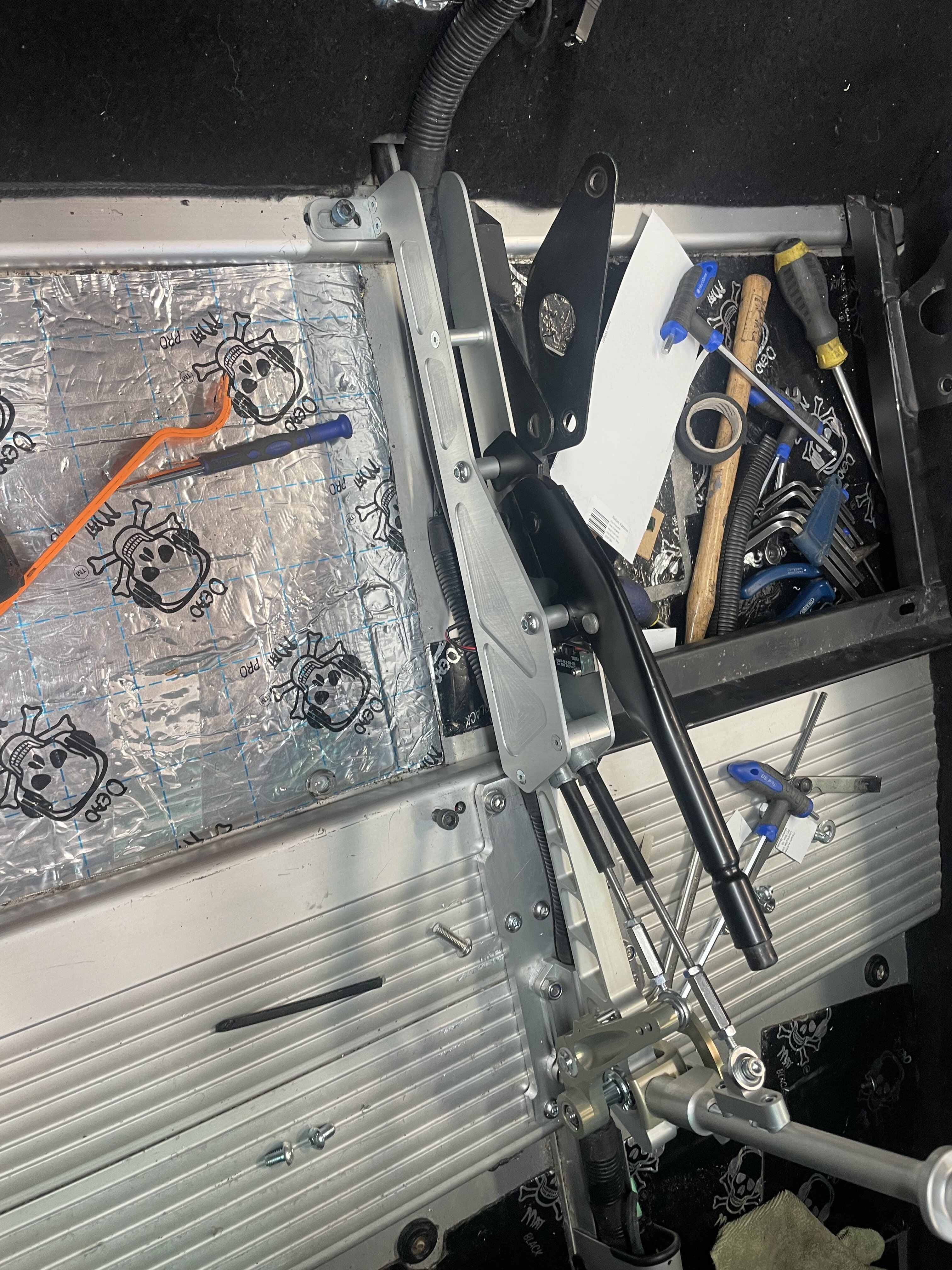

Just about finished and it works . Bonus . I will add a few more photos once the whole thing is properly bolted down . Very tempted not to try to replace the tunnel cover but just make a small switch panel to fit in front of the gearstick to bridge the gap between the gearstick and the ‘u’ shaped footwell cover .

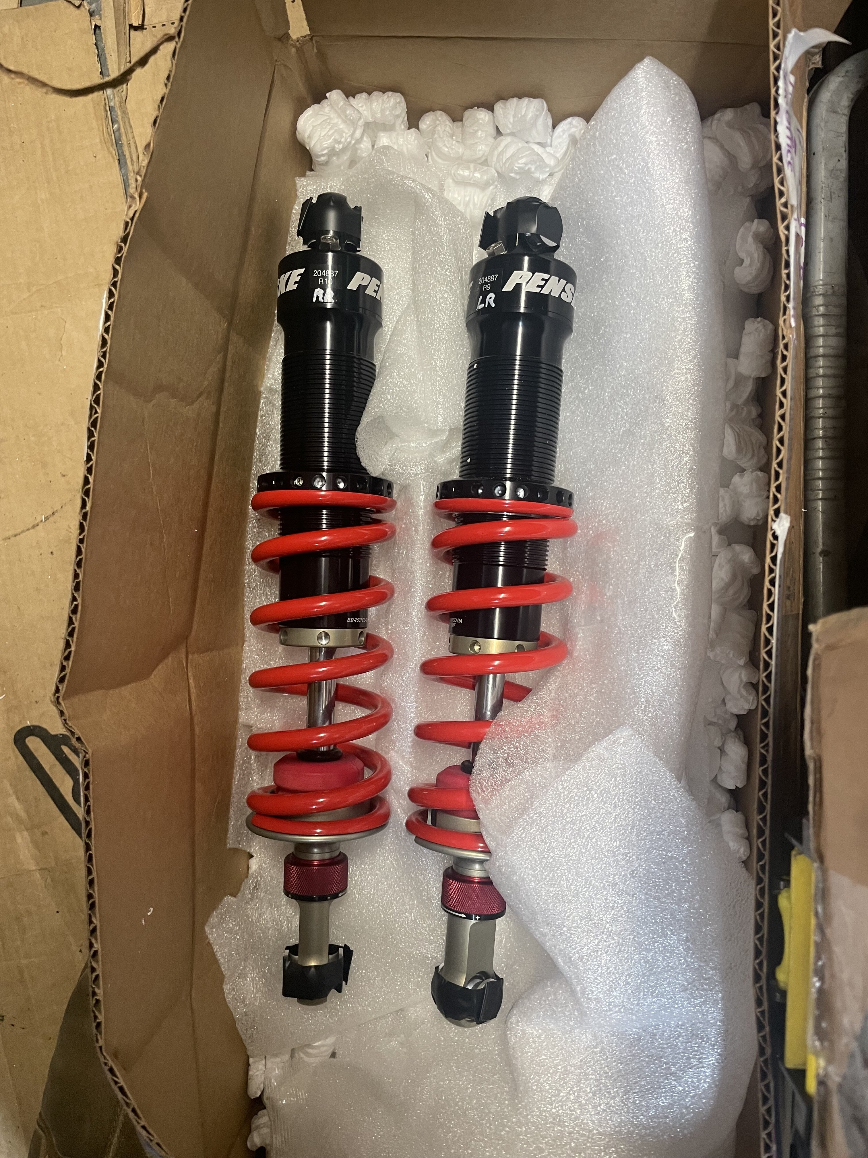

And today my new dampers arrived. Penske one way adjustable . Supplied by Blackwatch Racing. Bespoke valving and springs ( 300lb/in front and 400lb/in rear so wheel frequencies are still below 2.0Hz . I will report on what they are like once they are on the car and the car is back on the road .

And now my HPE shifter is well and truly nailed down, I made a switch panel to bridge the rather untidy gap between the shifter and the forward tunnel. Just the switch to add and that’s another job ticked off. I managed to fit the replacement front upper damper mounting brackets ( new ones come with the dampers and are needed as the damper body is wider than the standard Bilsteins ) Lotus didn’t make that job easy .

Red springs!  Now you're giving me ideas, I think they'd look good on a grey car.
On a more serious note, do you know what ride height you're going to end up with?  Or are aiming for?  Custom brackets at the front, but you're on your own at the rear?  Seems to be the standard approach, it is a bit of a pain on the S1 where there are two different rear brackets about 10mm different.
