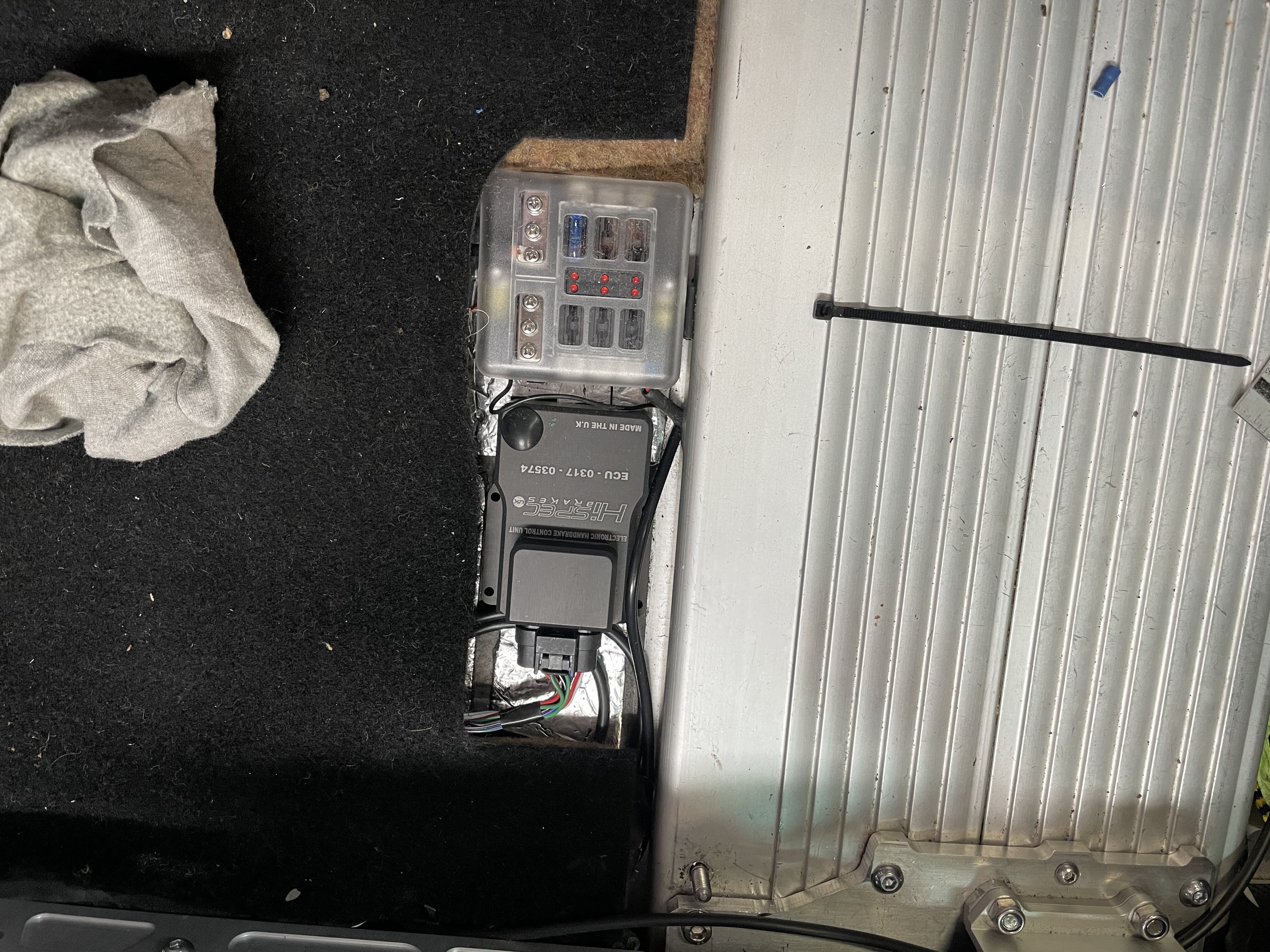

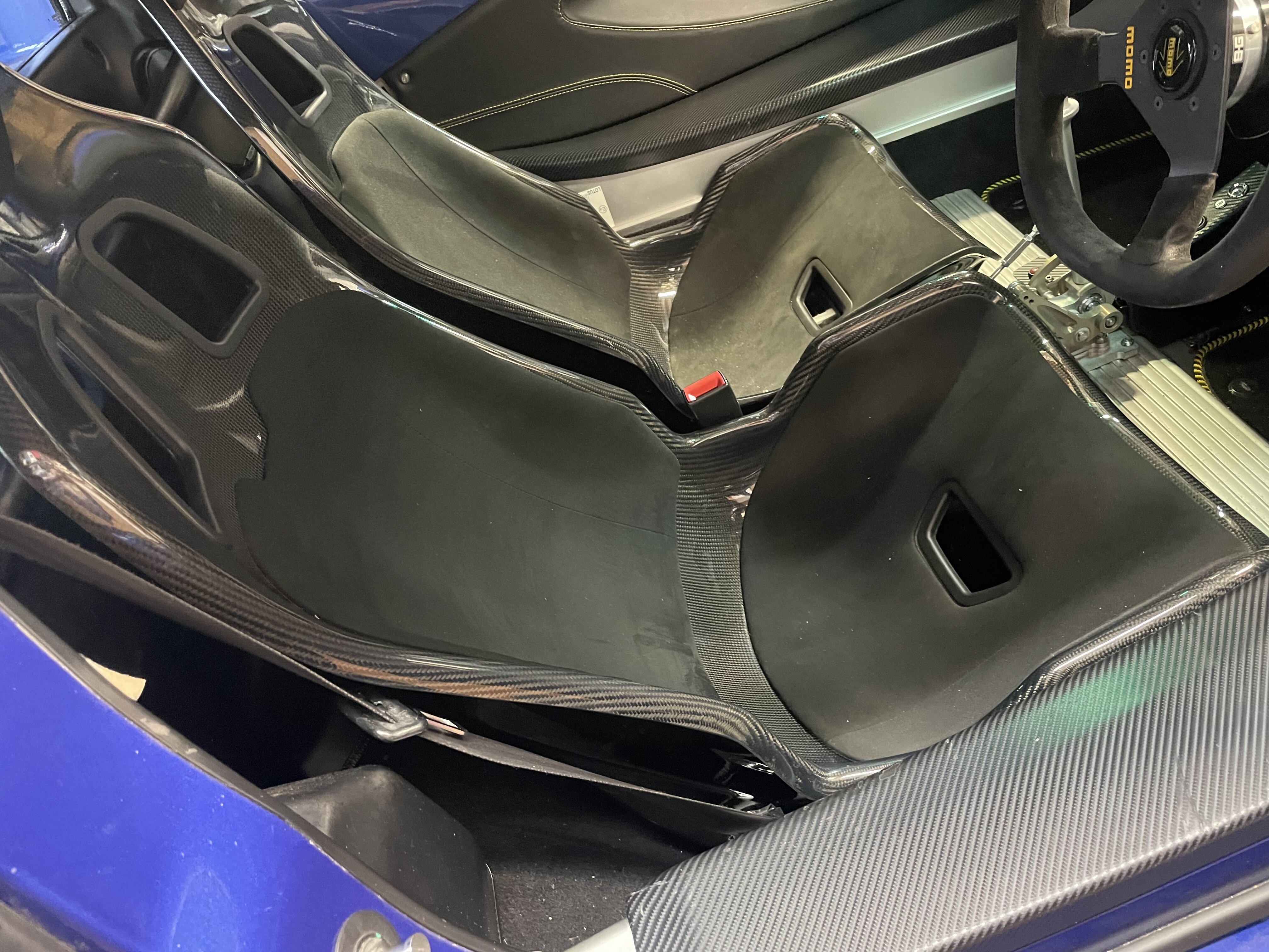

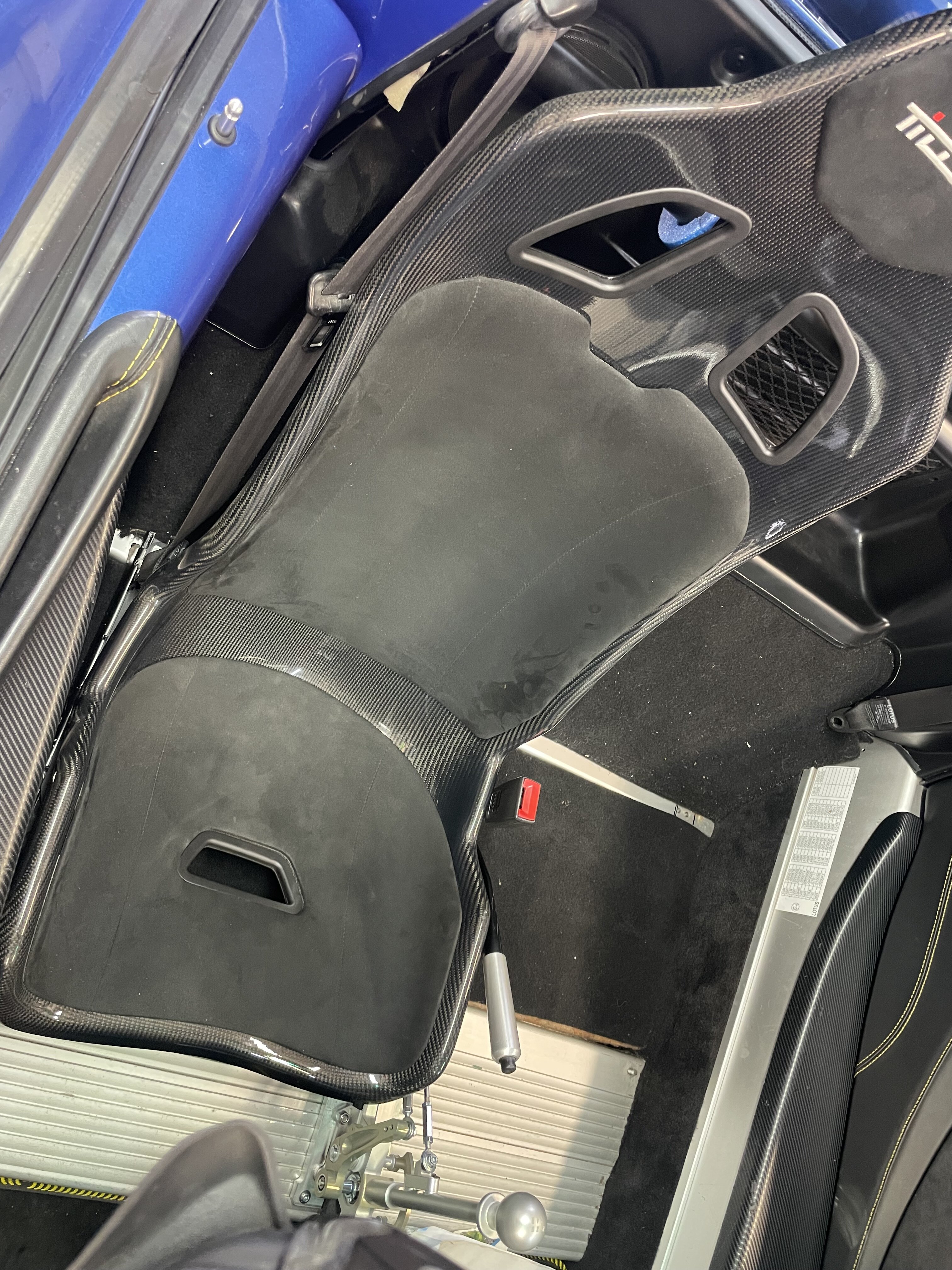

Andy wright Posted May 31 Author Posted May 31 Oh. Also seem to have bumped into a pair of Tillet seats so they are also installed .The last image is of the handbrake ECU and a fuse box. The cable routing from the ecu to the Calipers follows almost exactly the route taken by the handbrake cable , so that bit at least worked well. I think there are easier ways of installing a separate handbrake caliper , and I have certainly not saved much weight overall as the o.e Brembo with pads was about 3.8Kg,The combination of the front two pot and its adaptor, the electric caliper and its bracket comes in at almost exactly the same . Ideally one would live without a handbrake but the MOT tester may have a view on that option . Quote
Lithopsian Posted June 12 Posted June 12 Notoriously difficult to shave much weight off the rear brakes, and lots of people have tried. The Brembos are big, quite complicated, lumps of iron, but they do everything in one package. Of course if you're putting 2-pots on anyway, then the Brembos really are an overweight over-complicated lump of iron Well done for getting to a decent spot caliper setup, probably more work than I could have managed. Quote
Andy wright Posted June 12 Author Posted June 12 Thank you . The electric spot caliper is very good. That’s the upside. And it enabled me to dispense with the handbrake lever . Fitting the Tillets and keeping the edges on made the lever access difficult. That problem could have been overcome but….. The real downside is the amount of effort needed to get the spot caliper to fit the hub. Now I have done it , doing it again would be very much easier . Once on the hub, wiring and the rest of the install is straight forward. . And in use it’s quite nice too , not that it gets that much use . Overall, glad I did it if only because the disabled handbrake caliper developed the very irritating habit of its pads dragging , especially after some heat had been put into the rotor by the two pot caliper The noise was a real pain in the fundament . Quote

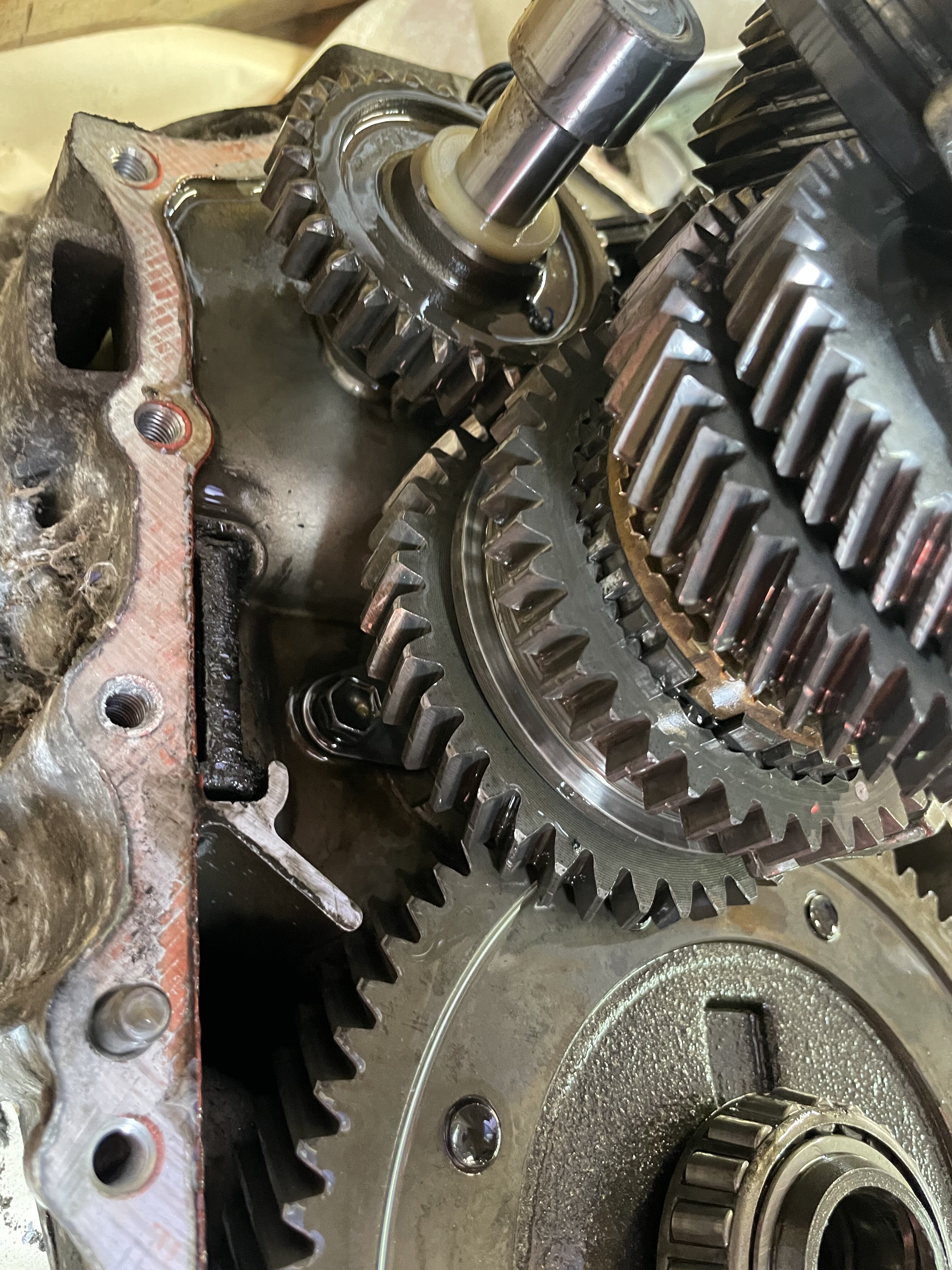

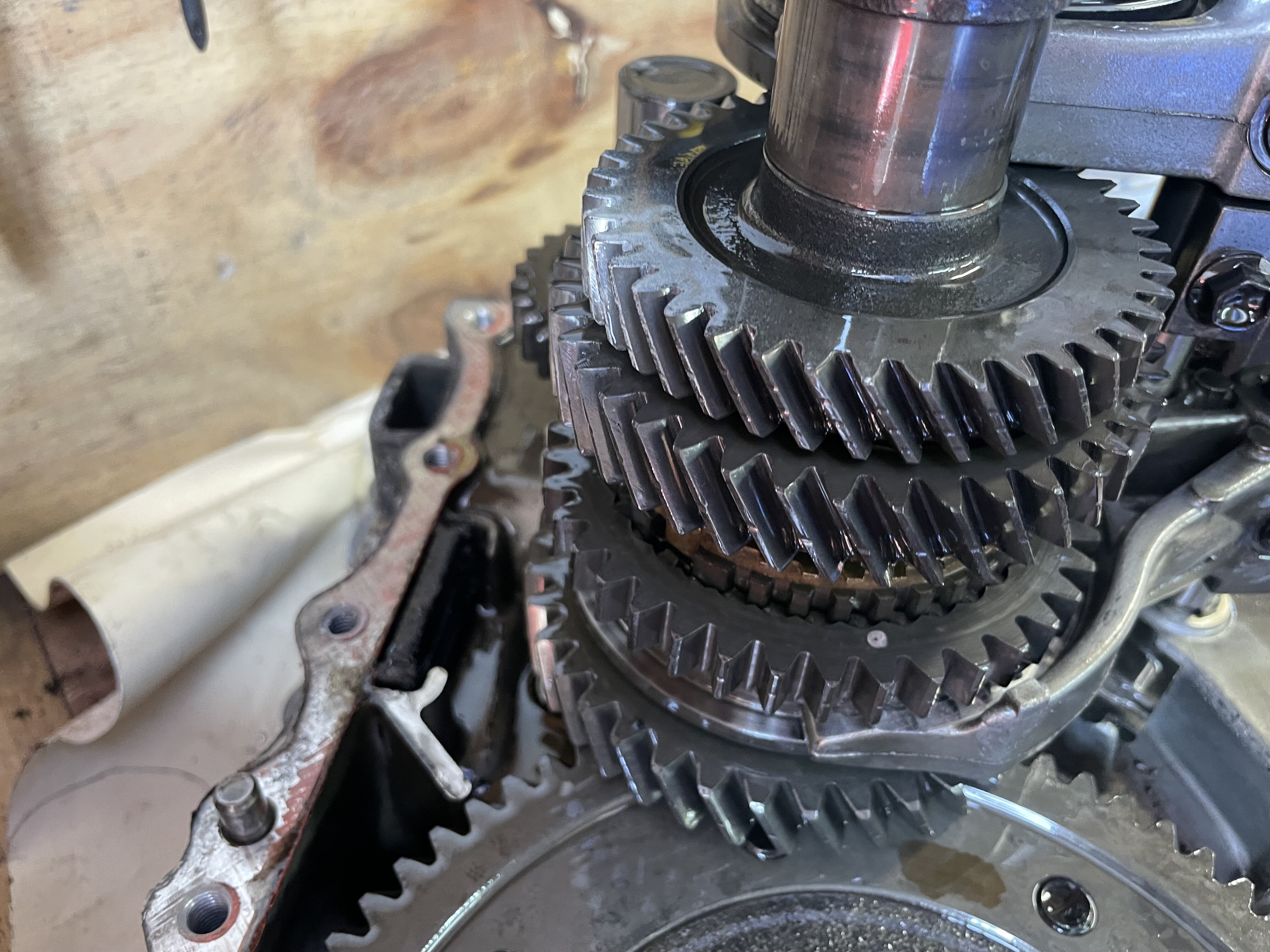

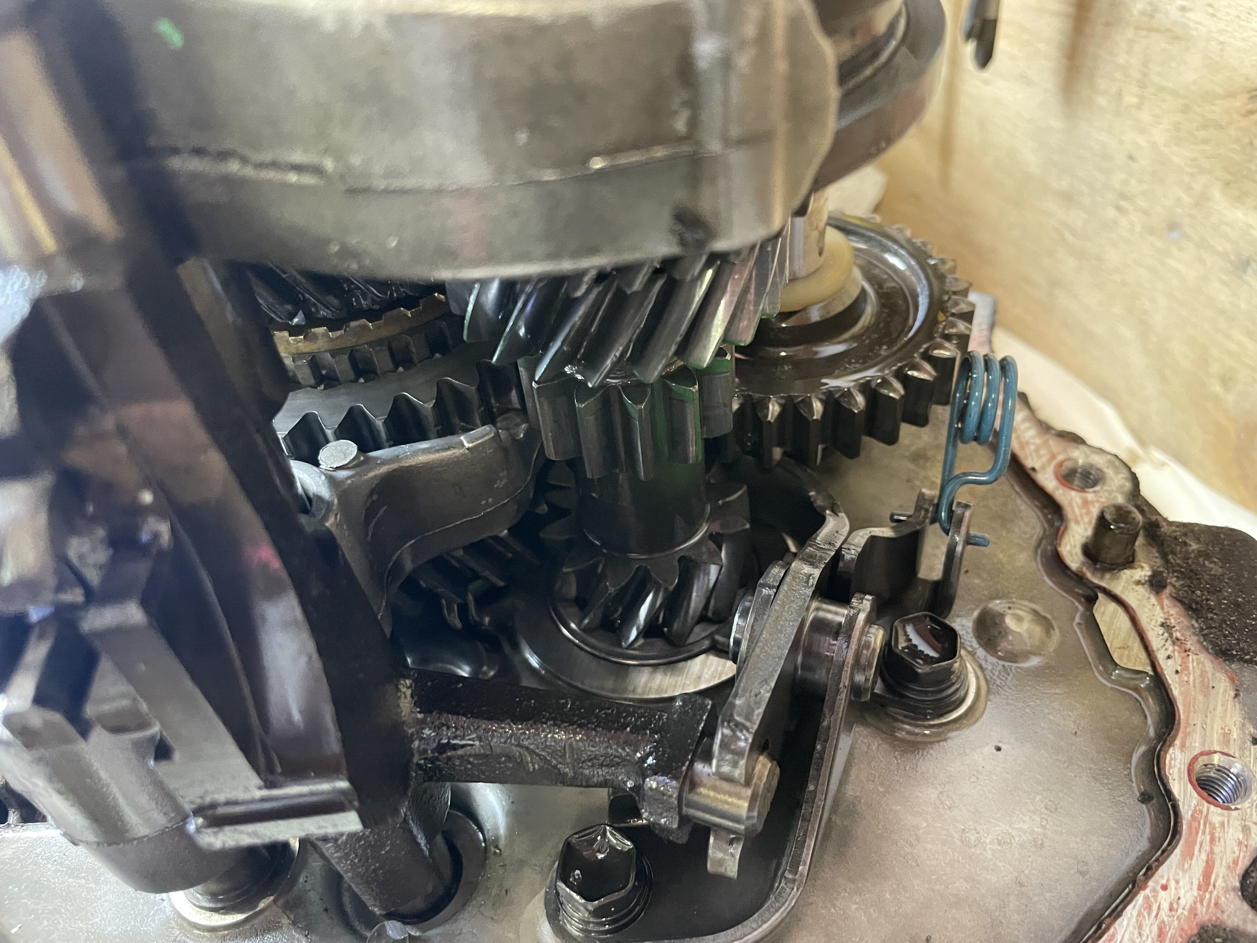

Andy wright Posted June 29 Author Posted June 29 And now I have started yet another chapter in my horror novel. As my avid reader may recall, I have the low rent 1ZZ power unit and its C56 5 speed box. Enter stage right a 6 speed C60 from a 7th gen Celica . These boxes are identical to the Elise C64 except for 6th gear, which is taller in the Celica.Anyway , box now in many parts and shopping list constructed . What is astonishing is the price variation on exactly the same part depending upon its source. And the Toyota dealer is up there in terms of price with DeRoure . Monkey Wrench racing is a brilliant source of information and is better value than the above but places like Megazip and Yoshiparts are significantly cheaper . ( yet to hear from Ben at Silverstone via Pi, another contributor on here ) More to follow . Quote

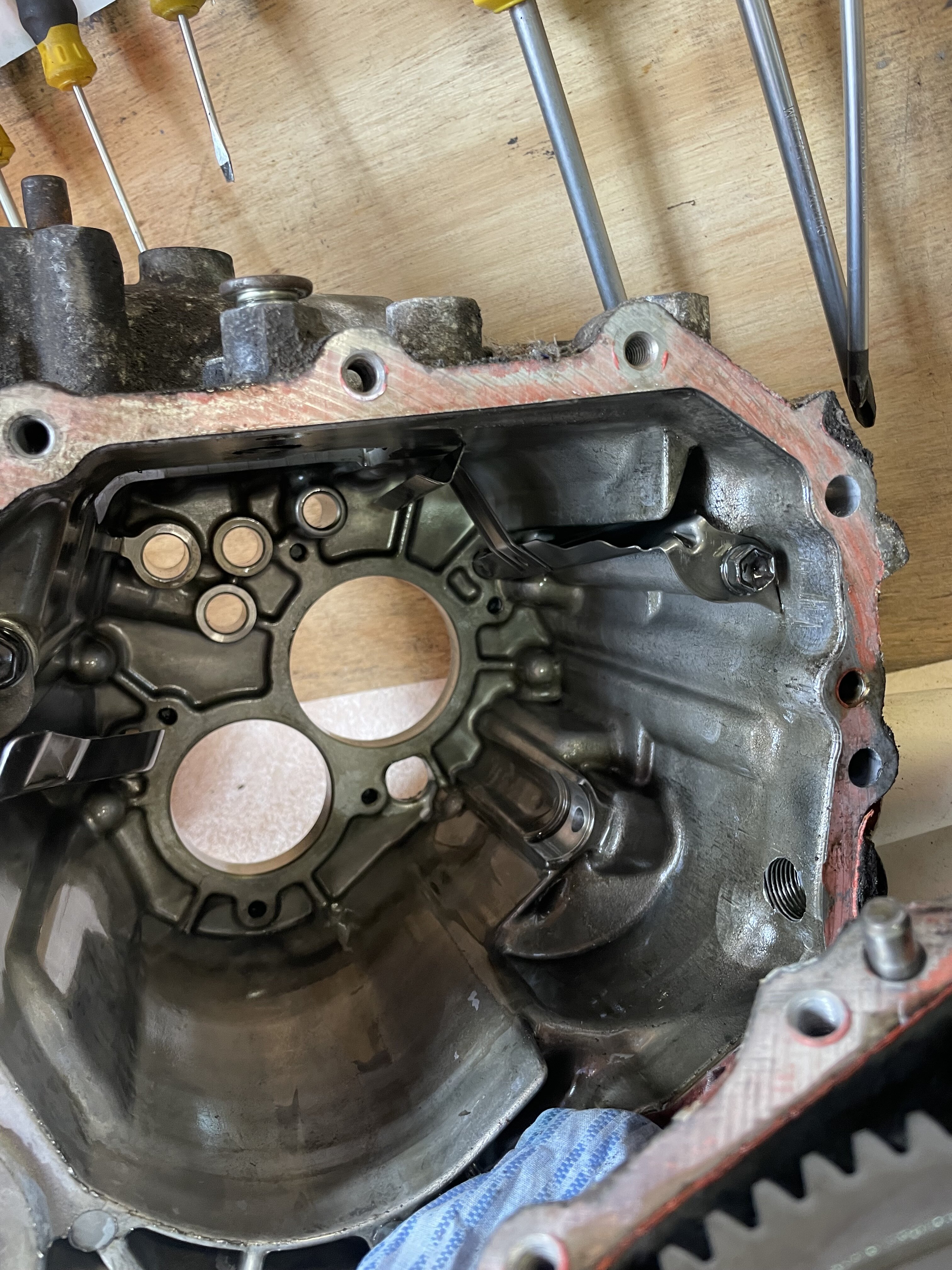

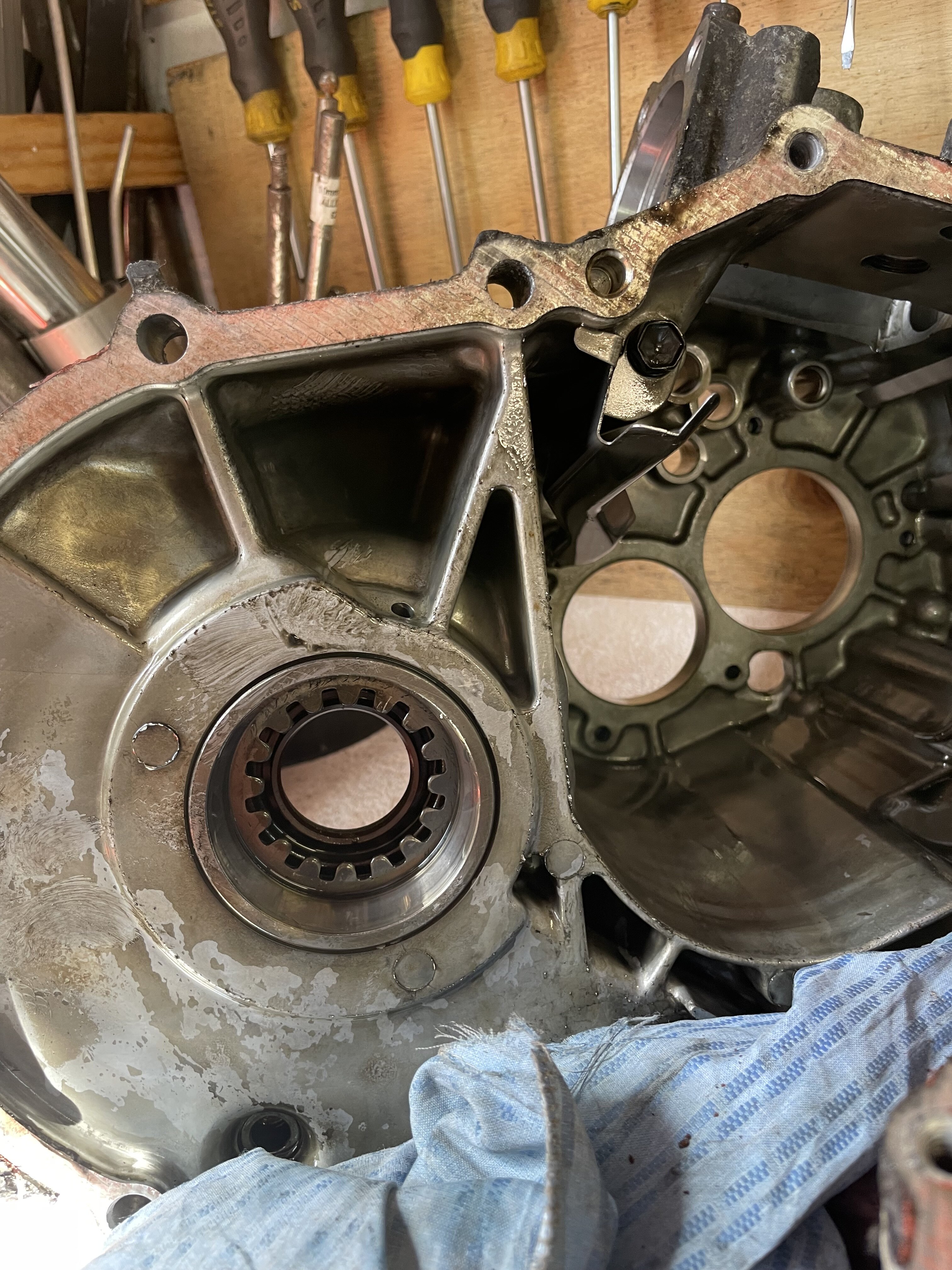

Andy wright Posted June 30 Author Posted June 30 Next vitally interesting step. Removal of the bearings from the front casing . The workshop manual shows them being removed with one of the many special tools that Toyota have available . Plan B Insert casing face down into electric oven . Switch on and turn up to 150c . Allow to cook for 15 mins and then listen for the ‘ clank’ as the bearings fall out and hit the bottom of the oven. Switch off oven , remove casing and bearings and allow to cool before serving . 1 Quote
Andy wright Posted July 1 Author Posted July 1 It was . And to put the new ones in, I will do the reverse: heat the casing and then drop in the bearing . Quote
Andy wright Posted July 1 Author Posted July 1 There is a small addendum to my recipe for bearing removal. Step one in the procedure is to ensure that wife has just left the house. Step 4 includes removal of casing and bearings and turn off oven prior to return of person referred to in step one. 1 Quote

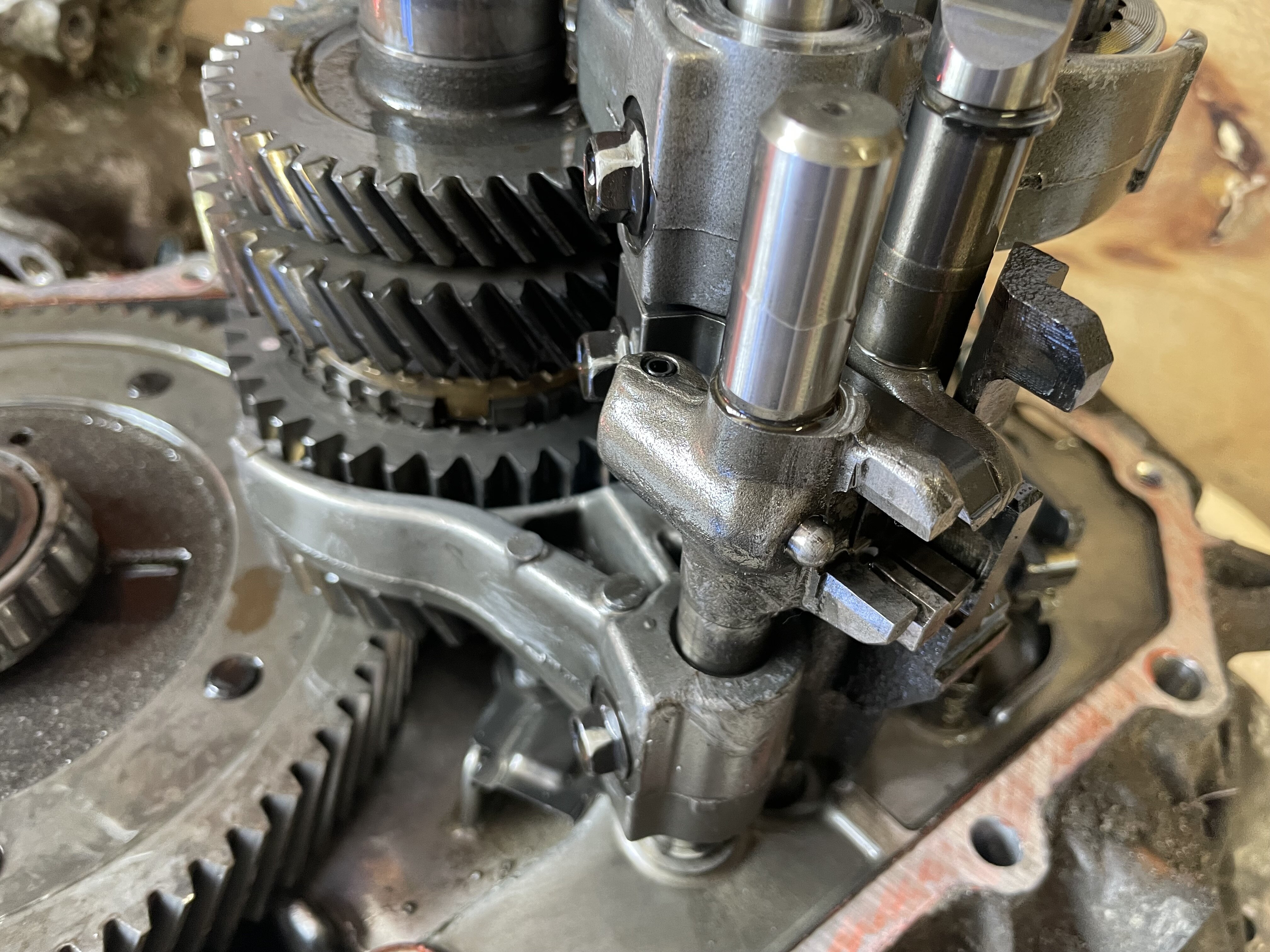

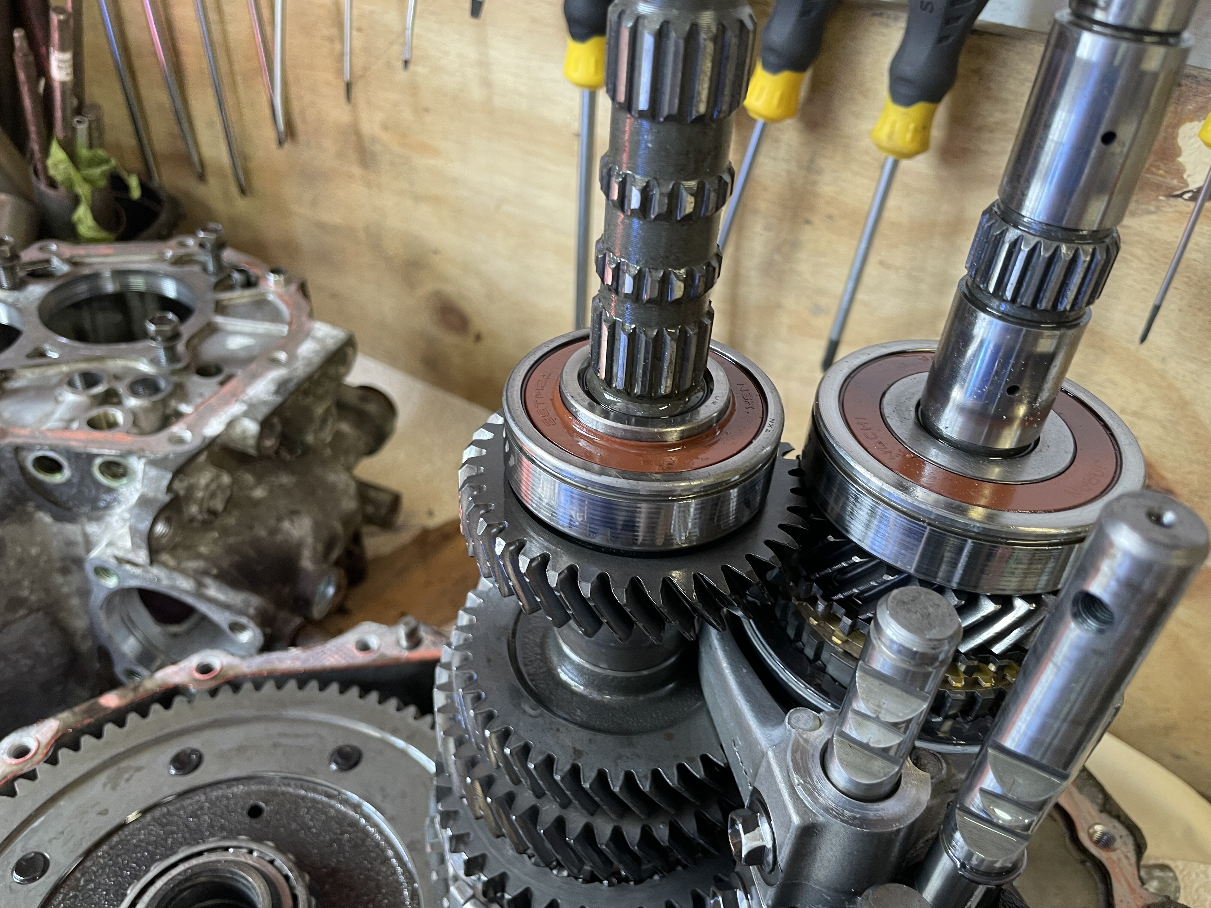

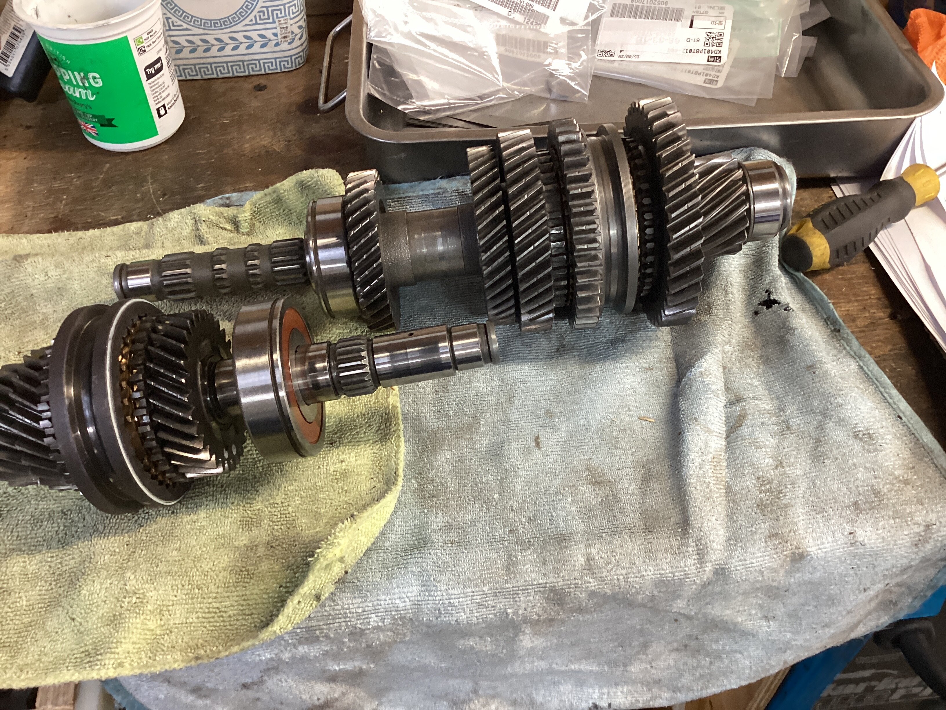

Andy wright Posted 13 hours ago Author Posted 13 hours ago Gearbox parts arrived earlier this week. No important duty and just over one third of the cost of the same items from a U.K. Toyota dealer or Bell and Covil. I have now started to reassemble the input and output shafts with the new bearings and synchro hubs. So far so good …….. Back to the press to get that centre bearing in place, then choose the correct width circlip to get the end float right( Toyota list 6 but at 83 p each I got all 6 even though 5 will remain un used , Quote
Lithopsian Posted 10 hours ago Posted 10 hours ago Looks like fun. I've never played inside a 6-speed box. Quote
