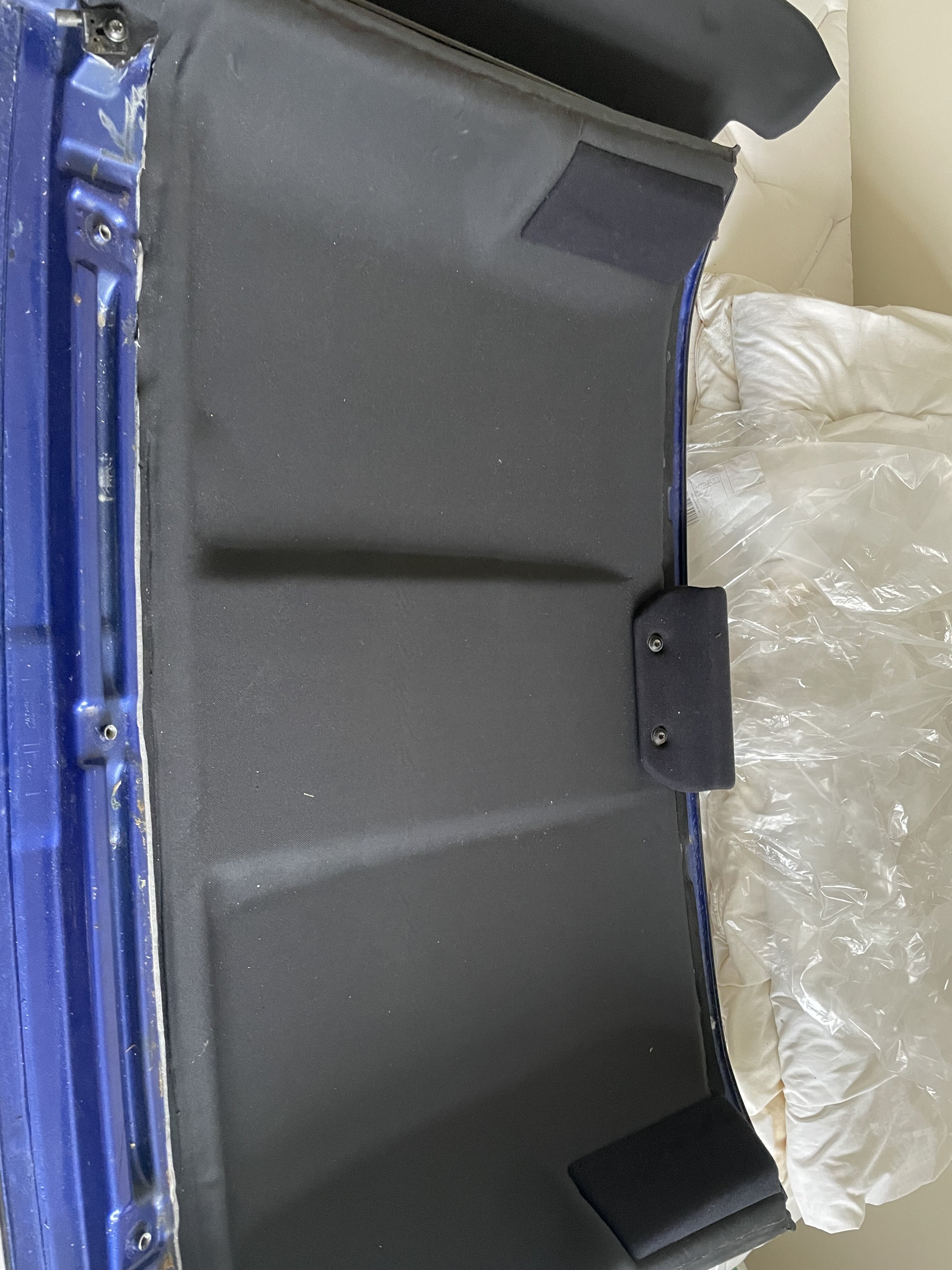

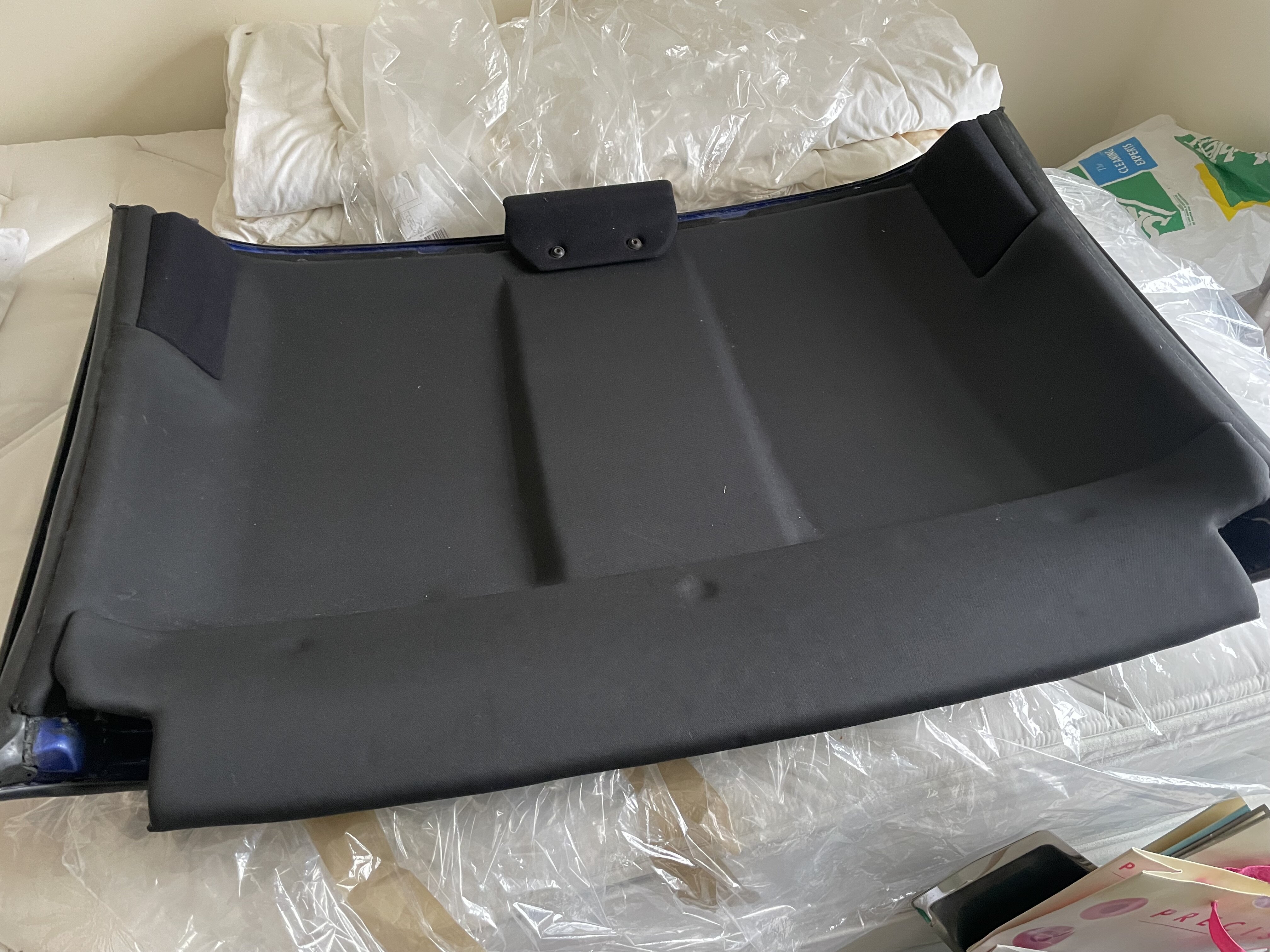

Andy wright Posted February 15, 2025 Author Posted February 15, 2025 Headlining now done.I am not sure that the Bentley upholstery department will be on the phone to me on Monday morning begging me to join their team, but it is better than it was before ( it was falling off so the bar was set pretty low) . I have also reset the camber having been for a 4 wheel alignment and discovered that the camber was not quite where I thought it was( read ‘ a mile off’ ) so the alignment is on hold until I can get a slot next week. Quote
