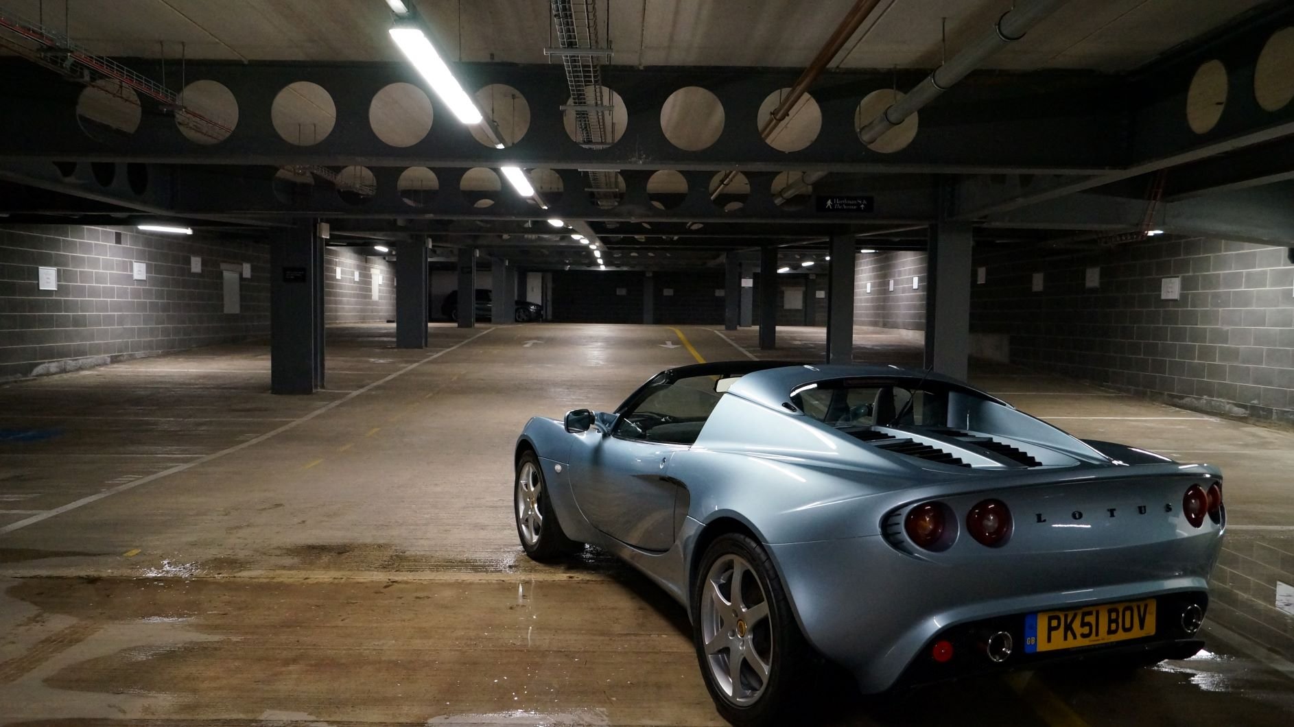

MrWill Posted May 14, 2020 Author Posted May 14, 2020 … I told her I'd be back in Spring. One of the benefits of being part the skeleton crew at work is the opportunity to take the Elise out to see if everything works now it's all back together!... that and parking where the chuff I want in a private underground carpark normally reserved for senior managers and Board members. It's great to be back behind the wheel 😃 but driving to work is never going to be the same as meeting up for a Sunday morning blatt in the Peaks following the dust clouds left by Dunc, Ray, Steve and well, everyone else.... 😏 MrWill
