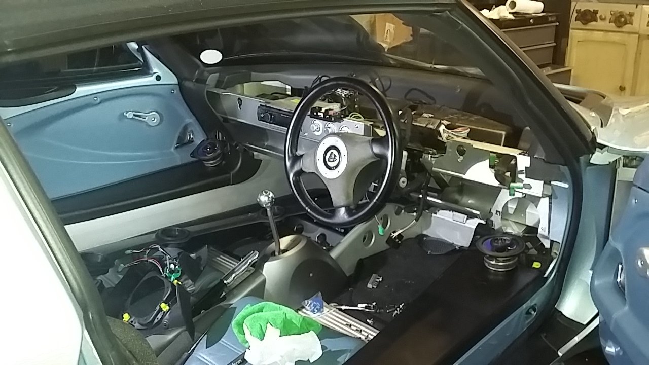

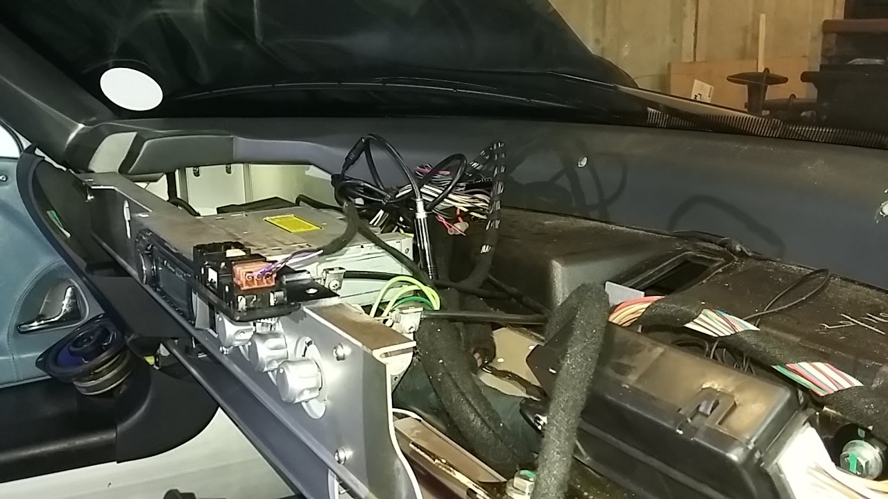

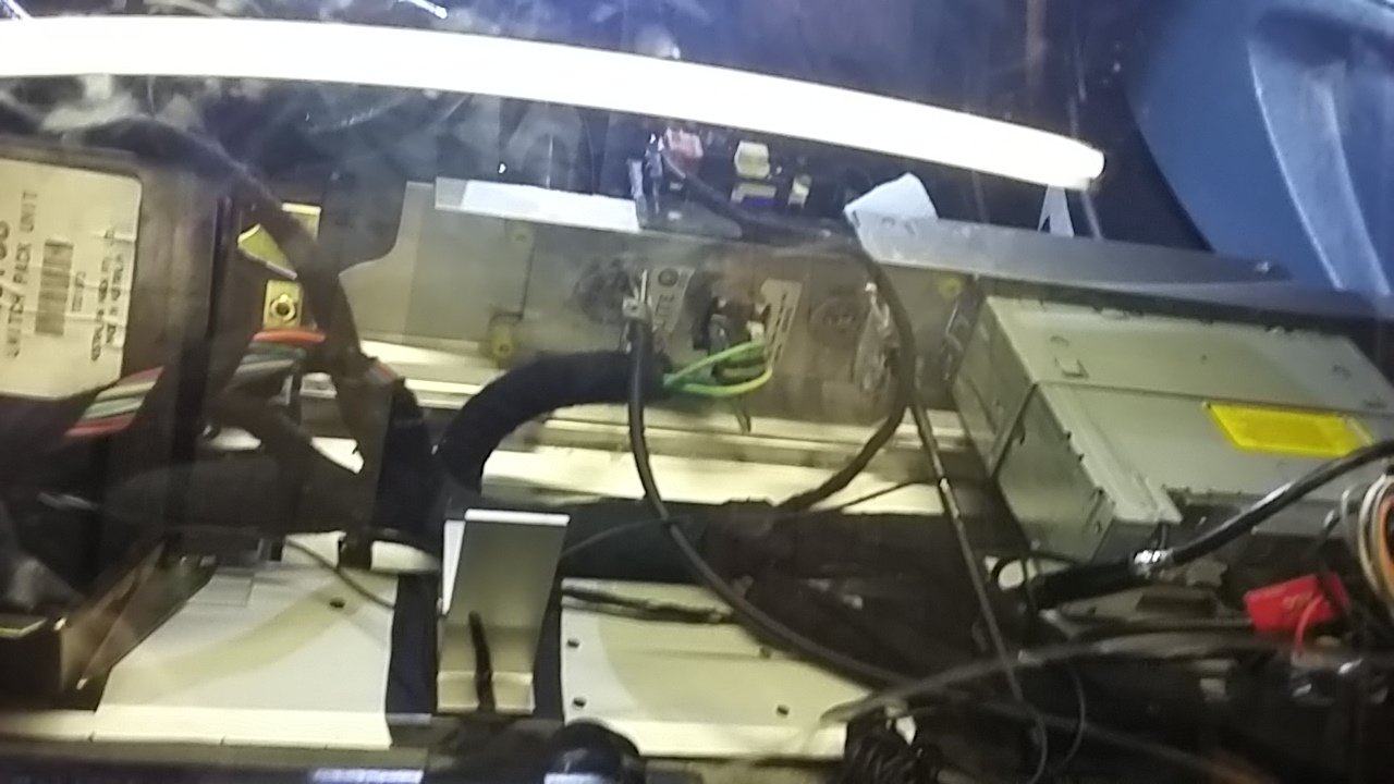

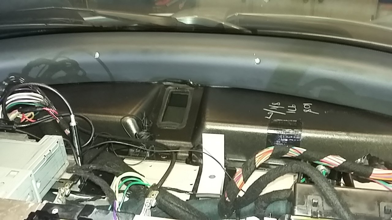

MrWill Posted December 1, 2019 Author Share Posted December 1, 2019 Still trying to sort the Fog light tell tale consrantly on. After having the lights module bench tested (all fine) I sent my stack unit away to 213 performance (ex Stack employees) for testing. Hopefully hear back soon. I did buy a fog lights relay from Elise parts advertised as fitting my car but I'm damned if I can see this in the wiring diagram for the car. Does anone know for certain if the S2 has a separate fog relay? Anyway with lights module and stack unit out, the jobs started to choose themselves: I decided I would take the dash out get it and the steering wheel boss recovered - then tidy up the wiring and clean / protect / lubricate everything else. No one will see it..but I'll know it's pristine under there. Some of the dashboard removal guides out yhere are helpful but could do with a few more details here and there, which I may record and provide in the tech section when I put it all back together. Link to comment Share on other sites More sharing options...
Lithopsian Posted January 1, 2020 Share Posted January 1, 2020 I just noticed that nobody replied to this. Maybe you fixed the fog light tell-tale already? On late S1s, the fog module acts as a sort of latching relay so that the rear fog light automatically goes out and stays out once the headlamps are switched off. More of a pain than a help since the switch stays pressed in and the fog light can only be turned back on by pressing it twice. Early S1s didn't have a module at all, just came on and went off directly from the switch so long as the headlamps were also on. The telltale is on the switch itself. I thought all S2s had a switch pack and no fog module, but maybe some early S2s might still have had the module? Any module would be located right behind the switches, and I think you'd have found it. I think I can see the switch pack in your photos, small black box with loads of wiring from one side. The wiring to the instrument telltale is straight from the same wire that powers the foglamp itself, not much to go wrong. There shouldn't be any voltage on it unless the foglamp is on. Did you ever check if the foglamp was also permanently on? If not then it seems like a fault inside the instrument cluster rather than the switch or lamp wiring. Link to comment Share on other sites More sharing options...
