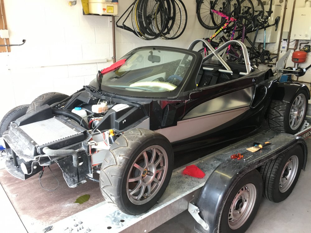

I have just acquired a lotus 340r which has been in storage for at least 15 years. The current mileage is only 1,160 miles.
I have replaced the dead battery with a red top racing one, so at least in future it can be removed without taking the bodywork off the car....
I'm not sure how far to go with replacing parts to recommission the car. so advise is appreciated:
So far I will definitely replace the following:
brake fluid
engine oil
coolant
radiator pipes (as they are difficult to reach with body on)
cam belt
alternator belt
wiper blade
Will check and replace if necessary:
brake pads
brake discs
spark plugs
ht leads
tyres
suspension bushes
Not sure if the car was subject to any recalls etc, as the car hasn't even had its first service!
Let me know if i've missed anything.......
Steve.

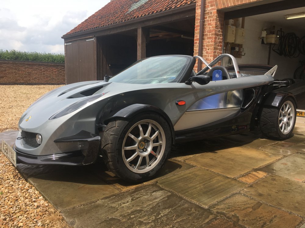

Thanks Dr H. Your car looked fantastic!! Love the wheels.
The silver soft touch lacquer is terrible, there has also been some rubbing from transporting it back to the UK due to the blue cover. I think its all gone soft due to being stored in a hot garage.
I notice your car had a split in the bodywork. I guess so the front section could be taken off independently. Was this a standard factory fitment or a mod?

Cutting the body allowed the removal of the rear in about 15 mins and made working on the engine dead easy. It would also allow the front to come off without having to mess about unbolting and tipping the roll bar forward etc. But now I'd probably not do it if you're bothered about originality and value. Having said that I only decided to do mine as it is reversible. Easy to glass it back together and repaint it tbh.
