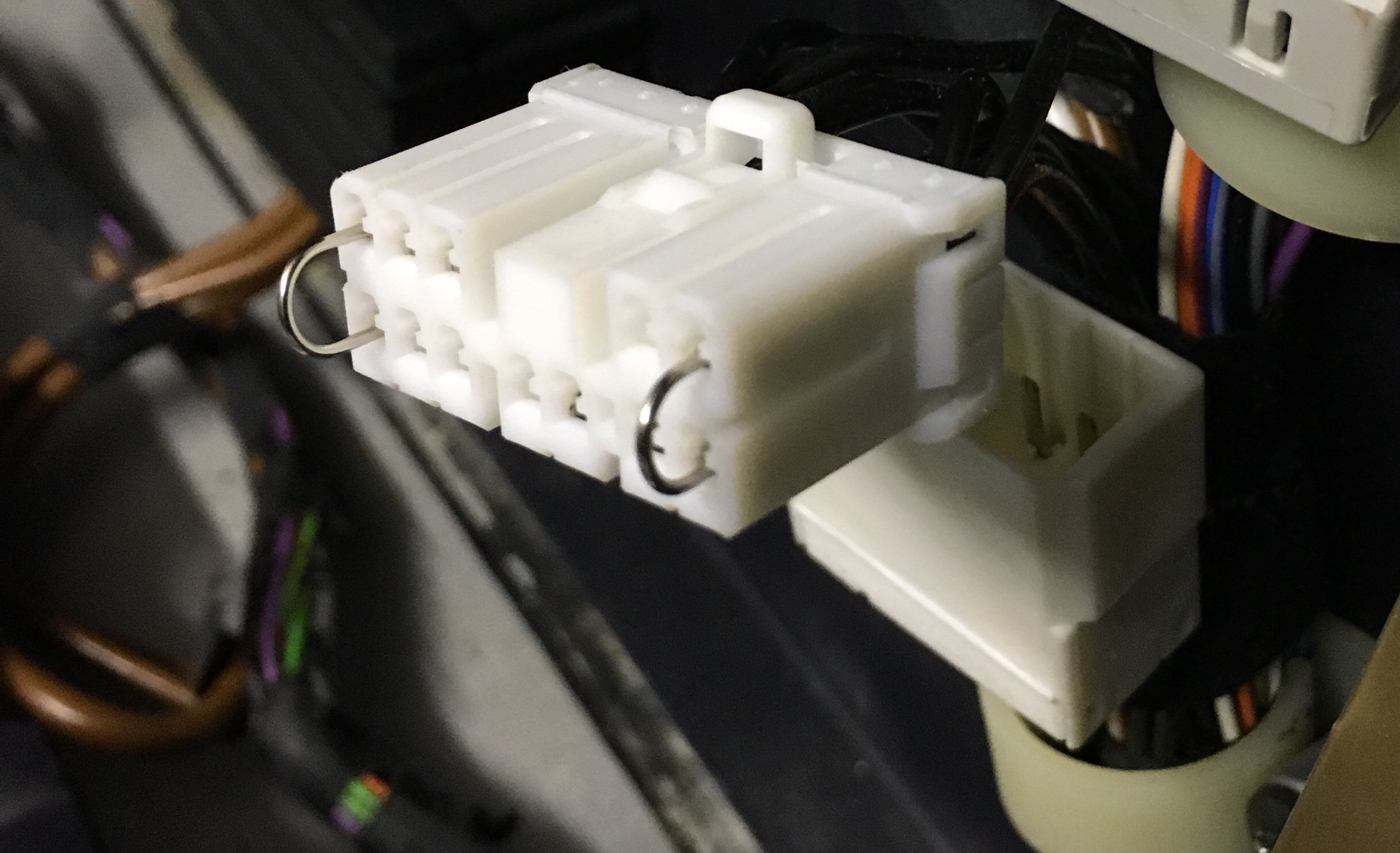

Elisesport190 Posted July 20, 2018 Author Posted July 20, 2018 tried the paper clip trick in the immobiliser plug but still no joy.
Martin R Posted July 20, 2018 Posted July 20, 2018 Doubt its the imobilliser then. Check for spark and then fuel and if there is compression it should make a noise hopefully.
