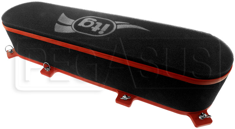

The I had to check how an air filter might fit. Ultimately I'll be having an airbox sorted (Lister Bell are working on one) but to get the car started and mapped etc I need a filter. Because this a custom setup I need to find something off the shelf that is suitable. The setup is quite long, longer than a 4 pot, but shorter than a straight 6 so it's a bit difficult.
Best option seemed to be an ITG JC100/100. Looks like this:
So mocked up a base plates and a 'filter' using a sheet of MDF I had lying around. Baseplate:
Mock up of 100mm deep flat top filter:
Issue is that it might not clear the rear clam when it's fitted. I can't be sure but it's going to be tight:
Absolute minimum gap between air trumpet mouth and inside of filter is 25mm, 40mm is preferred. The JC100 filter comes in a 65 internal height (which gives the 25 clearance I need) but it's not ideal. The 100mm version has an external height of 125 and that's what I've mocked up.
The best solution would be a sausage shaped version of the filter (which they do) with a 80mm internal height (which they don't do). Quick call to ITG and they will make a custom height 80mm version for me, will take 2-3weeks. More shit loads of money spent!
Ho hum......

Oh, and I've just realised that my custom order ITG filter probably won;t fit wall.gif. I looked at the external dimension (width) and it was fine. Didn't realise you lost about 40mm on the internal! Might be able to bodge it to fit but not looking good. Over £200 down the drain.........

Looks like the ITG really isn't going to fit so having another re-think. Hatched a plan to use a K&N like this:
Will need to make a base plate and top plate but I think it's doable. This particular filter is good for over 400hp so plenty for my needs. Will be fine for getting it started and mapping etc.

K&N air filter arrived. Looks like it will work well. Might foul the bodywork when it's fitted but will be fine for getting it all started and running. Have designed a base and cap and am having it laser cut from aluminium. Hopefully will be done next week and I can get it all bolted together.
