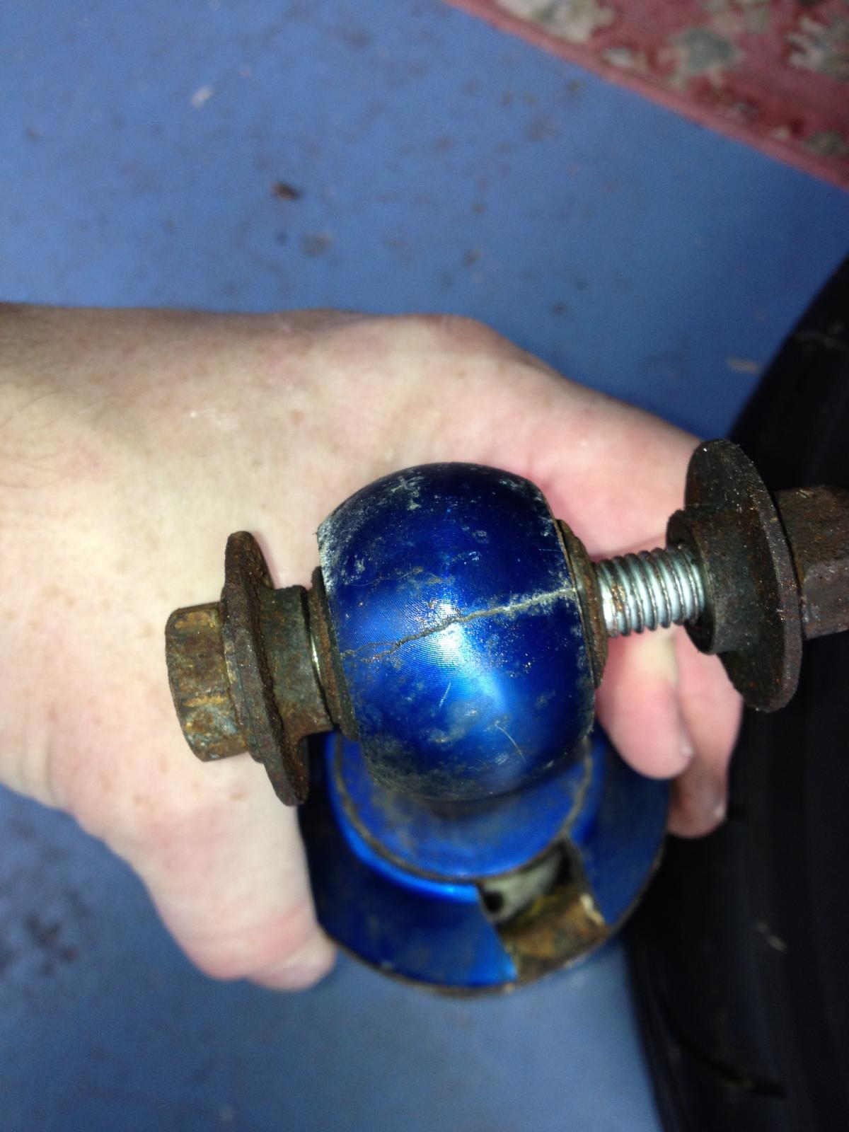

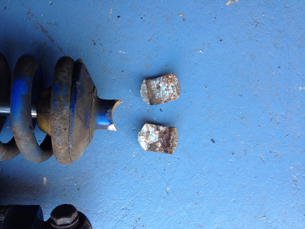

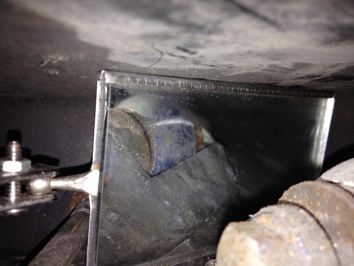

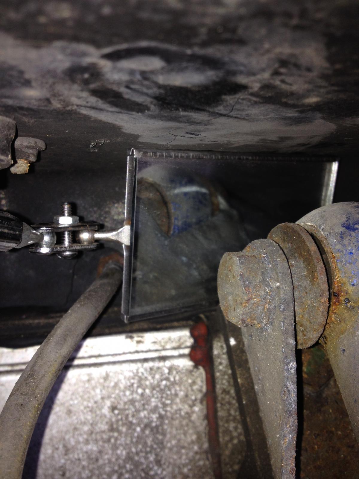

I think Jody has an image of it on the car, but you can see the top eye end of the rear nearside damper has come away from the rest of the body. This meant that the damper wasn't actually attached at the upper end and was only sitting against the upper mounting by the weight of the car alone. The location was also assisted by the wheel speed sensor resting against the suspension spring. It doesn't bear thinking about this failure, had it happened at speed on the road etc. I think I turned white at the discovery...

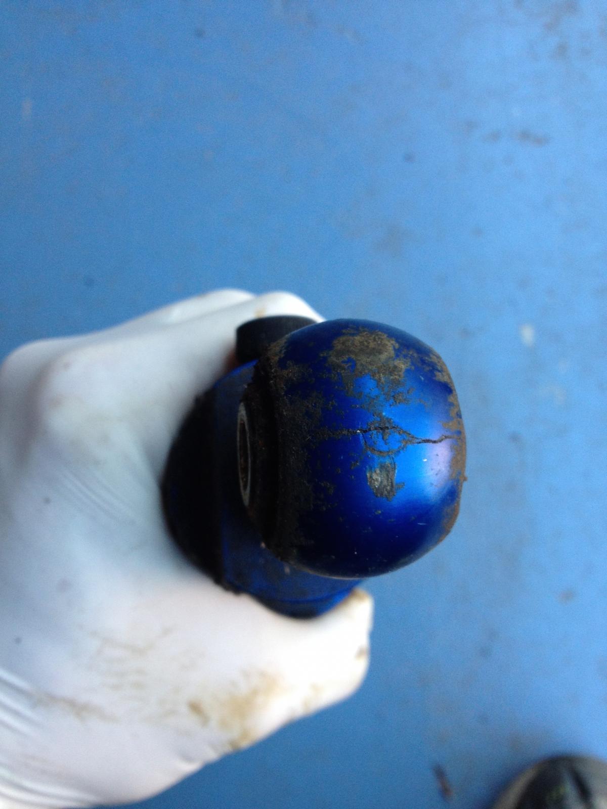

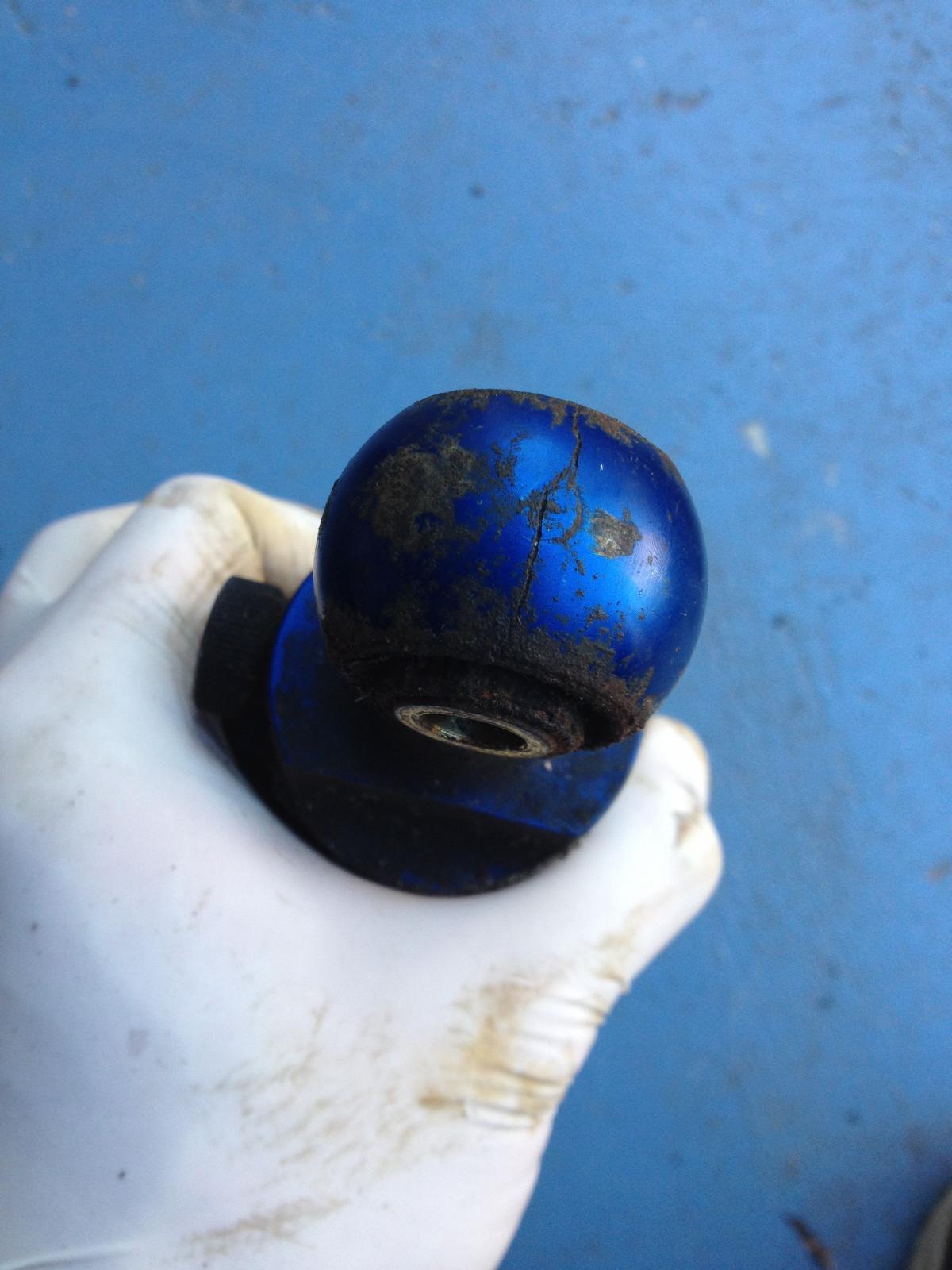

This prompted me to carry investigation and what I discovered was, ahem, shocking...post-4214-0-23689000-1429007286_thumb.jpg

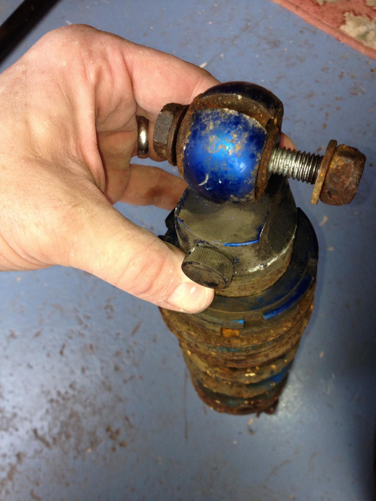

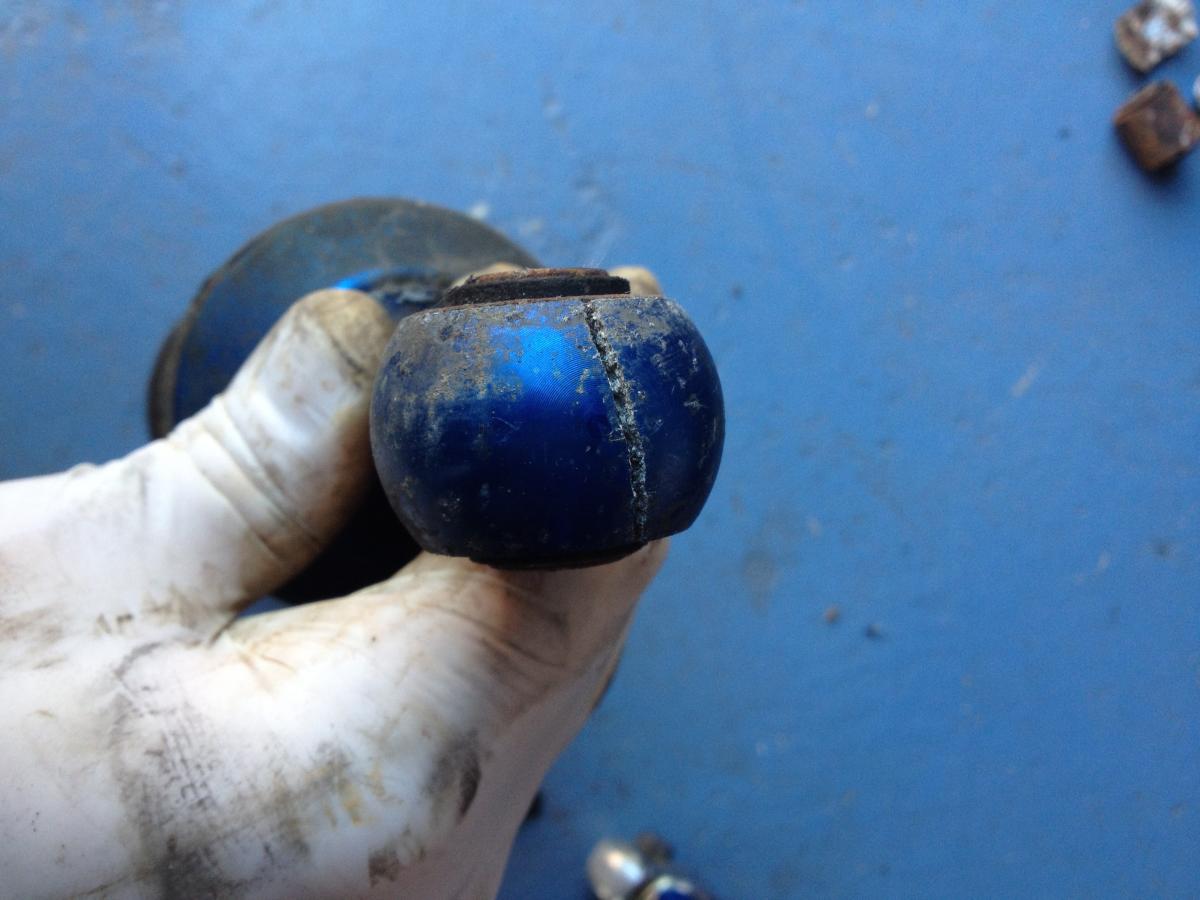

To put it into words, 7 of the 8 eye ends where the shocks attach to the car were cracked and split! It REALLY doesn't bear thinking about the possible consequences, but I urge you to check your damper attachments if you have GAZ fitted.

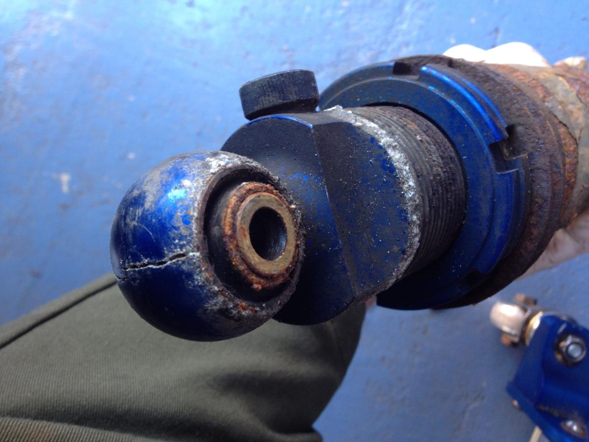

I've been in touch with Gaz and they asked me to return the assemblies. They emails back to say that the dampers were 8 years old and beyond repair (obviously), and this had happen due to corrosion. They have offered me a discounted replacement set, but I'm not sure that's good enough. I'm clearly without suspension at the moment (and I'm slowly now undertaking a full refresh), and have had to cancel my trip to Lotus in the Peak (I'm gutted about that), cancel insurance, sorned the car etc. It'll be a long while before I can afford the replacement parts (being a full time dad doesn't pay well) and I'm already missing my car!
I feel this isn't my fault despite me servicing the car myself (no maintenance requirements for the damper fittings), and I bought the car with the suspension already fitted.
Given that other cars may be fitted with similar suspension should Gaz be doing a recall? Is there something I could do from a legal perspective, or is it just a case of rotten luck?

You are very very lucky that these did not give way while driving.
I wouldn't like to think what could have happened.
Looking at the photo's i am surprised they have lasted this long. They seem a very poor design.
Posted
My thought would be it shouldn't matter on the age, such a severe failure due to "corrosion" shouldn't happen.
Posted
So has the steel sleeve of the bush rusted and therefore increased in size breaking the aluminium ring? That's a bit worrying!
However, it would seem to me that the fact you didn't purchase them originally. Gaz, (depending on the size of the discount) seem to be acting quite fairly...

Blimey Kurt - the Gods were looking after you - that is very worrying and you are absolutely right to alert others!!
The basic mounting design just doesn't appear right to me for fitment to a high performance car - the only available movement appears one directional around the mounting bolt whereas Koni LSS and Nitron have rose jointed mountings (rather than rubber mountings which will degrade over time) which allow forthe slight multi-directional movement which assists in the dissipation of the suspension loadings which on an Exige/Elise can be quite substantial especially on trackdays with sticky tyres.
Will be interesting to hear what Gaz say?

I run Gaz Gold Pros and as part of my winter engine upgrade I've also refreshed all the suspension and found the dampers in great condition apart from the rusty springs, Will be checking more frequently now.
FYI - My damper bush's are Aluminium

Simon, Gaz have said all they're going to I think. That is they're 8 years old, their design has moved on and here's the offer (half price Gaz Golds). It's not a bad offer, but I'm starting a refresh and this incident is making me loose faith in their product. I did buy a set for my Elise many moons ago, but it may be worth saving for a set of basic Nitrons.
Reg, yes that seems to be the size of it.
Overall I realise I'm very, very lucky, and just think that this could happen to anyone in the same boat, with potentially fatal consequences. Honestly it doesn't bear thinking about.
