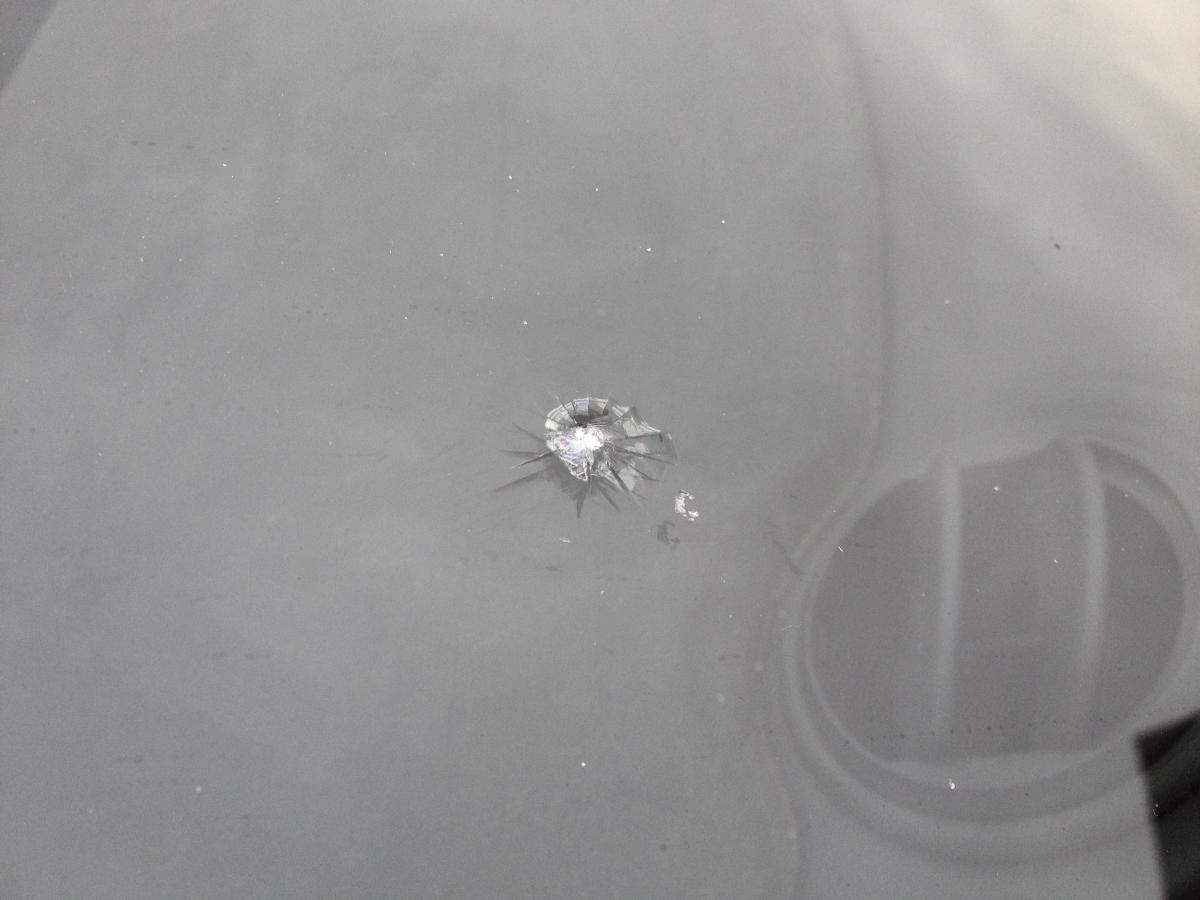

smithpaulg Posted December 21, 2012 Posted December 21, 2012 Had the day off so thought I would go for a ride as I havent had time to use my car much recently due to work and family commitments! Anyway, 10 mins in I got hit on the windscreen by a rather large stone, right in my eye-line (needless to say I ducked!). Have booked it in for a windscreen replacement by Autoglass next week. I have started to read several tales of woe on Seloc, but I though it much better to post on MLOC to get some sensible responses. Can anybody tell me what i should watch out for when they do the work ? Is it really a clam off job ? All advise appreciated ! Thanks Paul
Harmy2010 Posted December 21, 2012 Posted December 21, 2012 I have no idea how to replace it, but thats looks like a good job that stone did!! hopefully its an easy job and you dont have to much problems with it.
Martin R Posted December 21, 2012 Posted December 21, 2012 They would not do mine at my House. I had to take it to the depot in Aston. They did not remove the front clam. They also did a first class job. They said they had to get their best man on it
smithpaulg Posted December 21, 2012 Author Posted December 21, 2012 Have now spoken to them. It has to go in to their shop and is a four hour job. It is one of the hardest replacements they have on the books and requires their best-man as Martin says !! Lets hope his speech is a good one

jonnyfox Posted December 21, 2012 Posted December 21, 2012 Mine was done in my garage, a great job. No clam off required but messy as f***k. When you think it costs £60 excess, that's a whole lot of windscreen and bonded bits, quite good vfm!

jhall89 Posted December 23, 2012 Posted December 23, 2012 Local Dealer in Brum sends his to Autoglass Centre in Aston and charges a premium! Had my S1 done there and they do a great job - yes its 4hrs as clam has to be released and tilted forward and then there is curing time before driving. They had a nice selection of Lambos + Ferraris in there too so drool!

pa28pilot Posted January 6, 2013 Posted January 6, 2013 It's probably repairable - but for a truly good repair, you must ensure that the damage is sealed against moisture as soon as the damage occcurs. Good selotape is really good in this regard as it seals-out water, is transparent, and the wipers will still cover the windscreen with minimal problems. Always keep a small roll in your car! As mentioned in a another thread, try GlasWeld (www.glaswelduk.com). Repairs are inexpensive and generally very effective. I had a really bad "stike" (worse than yours) about two years ago. The repair completed by the local agent is almost invisible (and then only visible if the sun catches it "just right". A similar ding on another windscreen is completely invisible. The best advice that I ever received (many years ago) was that a windscreen replacement should be considered a last-resort fix. Modern windscreens have to be cut out - and all surfaces re-prepared and properly primed. Leaks and other body/trim damage is always possible, so avoiding the replacement will avoid major hastle. If done properly, the resin-repair is as strong as the original laminate.
