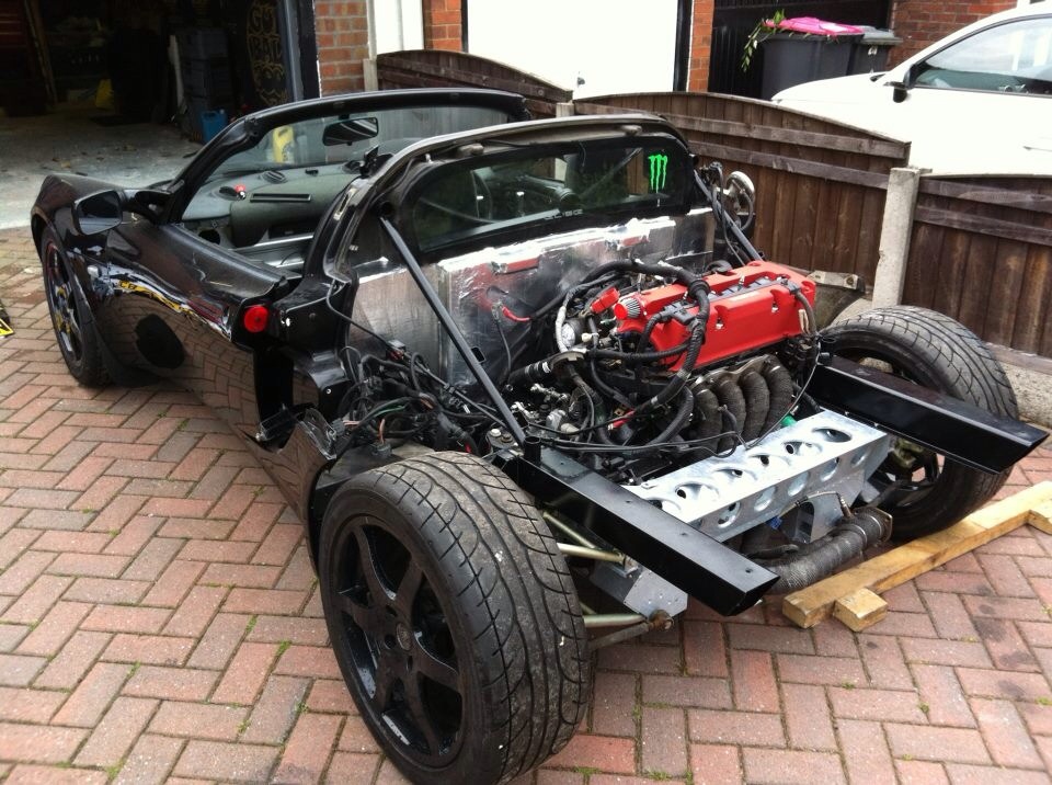

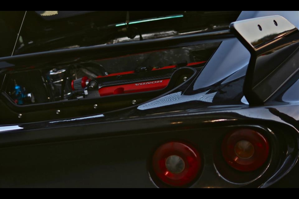

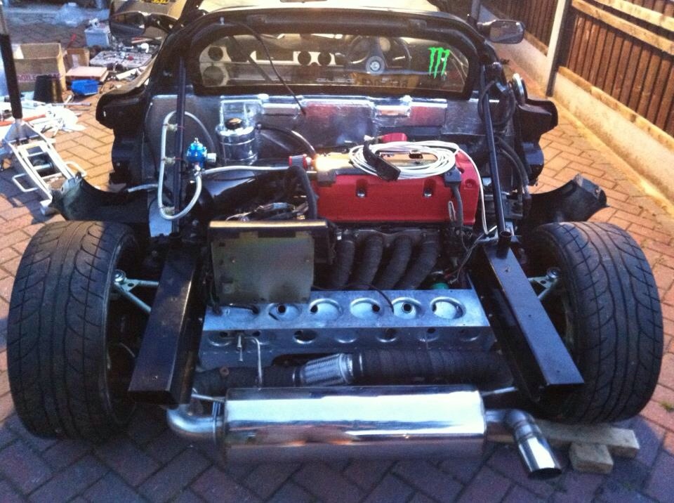

DJWilma Posted October 8, 2013 Author Posted October 8, 2013 Its taken me a little too long but thanks Nearly finished it off today. Still needs some flatting and polishing and grills adding. I am missing the front undertray so cant fit the splitter which is a shame. 111S Stickers to go on to but just so excited I couldnt help but put photos up its booked in with Sportomotive on thursday for a Geo, going to go for 340r setup at 120mm front so I can go over speed bumps had a little play on the way home and a nice man and his Pillion on a motorbike Aprillia Rv4 assisted with the how quick is it test......on low 11psi setting it was close thing.....so I would say its quick enough
DJWilma Posted October 24, 2013 Author Posted October 24, 2013 Woo hoo it has electricity !Dont know for how long but it managed to get to the local track for a quick blast up the straight, did a 3rd and 4th gear on low 11psi boostYou can hear the exhaust manifold blowing and its a little laggy, also ECU light is linked up to the DTA and comes on when its time to shift http://youtu.be/Jckt3hODYFk

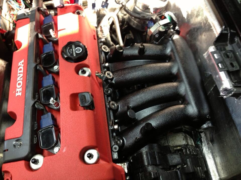

CAMotorsport Posted November 13, 2013 Posted November 13, 2013 MSC are pricey for there honda k20 conversions, but are an amazing bit of kit with a few little extras, I charge £10,500 supplied & fitted as a turn key conversion using a mix of MSC parts & STARK parts and the output of the last conversion was 248bhp at the flywheel, this is achieved just with a simple inlet manifold change.
DJWilma Posted November 16, 2013 Author Posted November 16, 2013 So for another 10k I can have nearly half ad much power and a third torque ! T series conversion was about half that
CAMotorsport Posted November 18, 2013 Posted November 18, 2013 I have no experience with the T series, is it a reliable engine? I understand the conversion would be cheaper and you would get more power I'm also currently trial fitting a impreza engine into an S1 which could be interesting?
danwebster Posted November 18, 2013 Posted November 18, 2013 248bhp at the flywheel, this is achieved just with a simple inlet manifold change. Thats some f****g manifold!!
