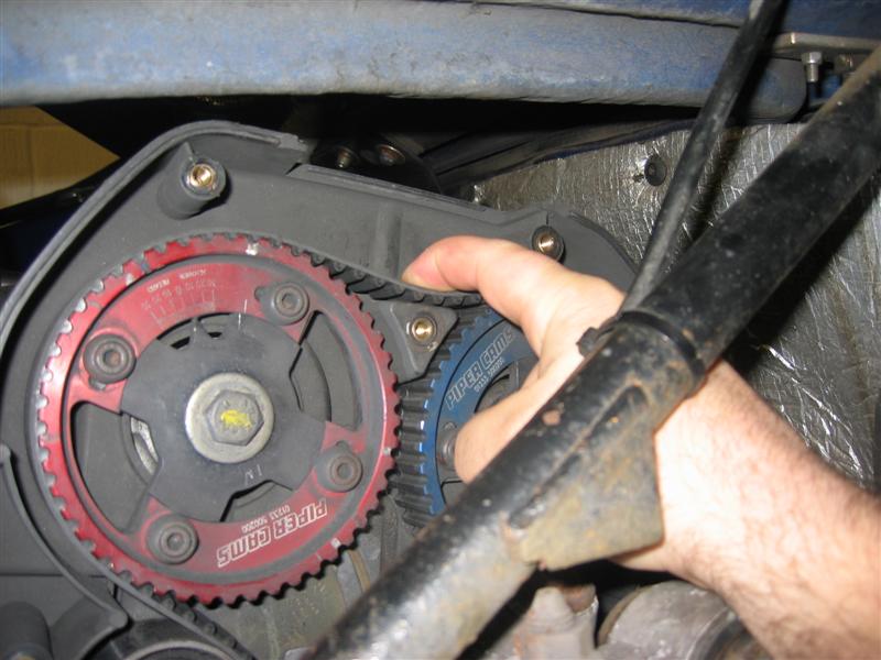

dobbo Posted March 31, 2011 Author Posted March 31, 2011 Cheers Martin, but with two little ones I simply don't have the time at the moment. I'd love to actually do it myself but I have no idea how bad it is inside yet. The pistons go up and down but the cams don't move, and there was a tinkling noise just before the engine died. When I turn the crank, I can hear the belt teeth rubbing the crank pulley. I don't think the belt's snapped as I can't remove it, and it doesn't seem to have stripped the teeth like it did last time - I think the tensioner has slipped. I might be lucky, then again I might not. I was driving harder this time. On the plus side, I still have all the undamaged valves from last time, so I might be able to cobble together a full set of non-bent ones and fingers crossed the pistons / crank aren't damaged. Spark plugs look fine, so I don't think anything has broken off (valve head) and got mashed up in there.
Martin R Posted March 31, 2011 Posted March 31, 2011 Bugger, i presume you have checked the crank pulley is not loose ? If not it does sound like its lost the tension somehow.

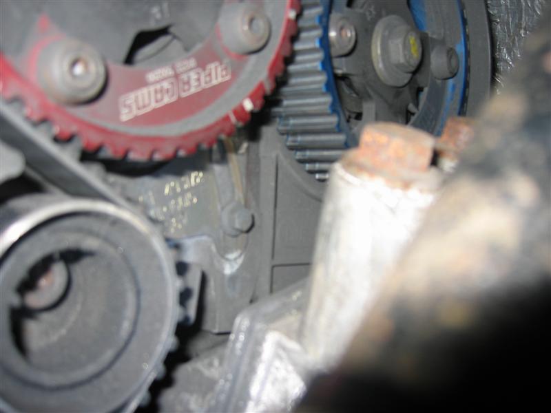

dobbo Posted March 31, 2011 Author Posted March 31, 2011 Given that I could hear the pulley rubbing the teeth, I think the pulley is probably tight. Couple of photos showing slack in belt ... and clean witness mark under tensioner back-plate
Martin R Posted April 1, 2011 Posted April 1, 2011 Chris, hard to tell from the pic but the tensioner looks virtually at full adjustment to me ( ie tight setting ) Time to check the bottom crank pulley bolt etc. I would first get a small rod in each spark plug hole and get it to 90 DBTDC. That is when all the pistons are half way in the bores.
dobbo Posted April 1, 2011 Author Posted April 1, 2011 Right then - borrowed a video probe and had a look in tonight. There's been valve / piston contact on at least 3 cylinders (enough to dent the piston crown), which is bad news The exhaust cam won't budge - I take that to mean that a valve with a bent stem has been jammed into the head, which is bad news Inlet cam seems fine Belt has stripped 18 teeth and the leading edge of most remaining teeth seems to be starting to part company from the belt (both pretty much the same as last time) So I guess this means a bunch of new valves (luckily I still have the old ones and most of them were OK. Fingers crossed I can get a full set out of the old ones and these ones), valve guides, pistons. Well, it needed stripping to investigate the oil burning issue, so labour wise it's near enough the same, but there's some parts there that I wasn't planning on.

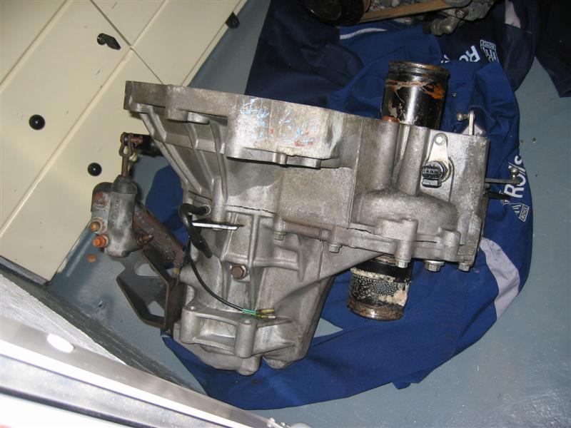

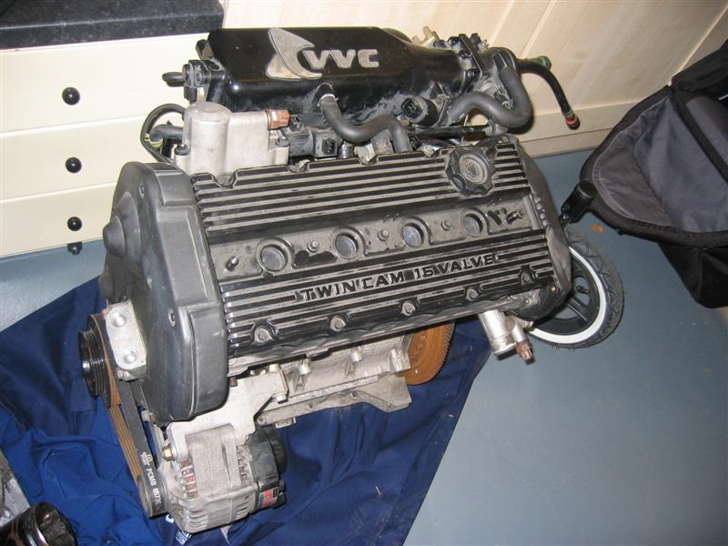

dobbo Posted May 6, 2011 Author Posted May 6, 2011 Oooh, look what's now in my garage.... S160 VVC and CR box. With my Jenvey TBs, EP big-bore exhaust, Emerald, 285H cams, verniers, a little porting and a re-map, it should be good for 180-190 according to DVA. Coupled to the CR box (and a few nice bits and bobs from my engine) it'll be as quick as my current one. I might lose a bit of top-end speed, but my current one pulled 140 in 4th, so I'm not really worried about that ! (actually, it'll be a lot quicker than my current one, given that it's dead )
dobbo Posted May 6, 2011 Author Posted May 6, 2011 I sooooo want to get back in the seat and drive it !
