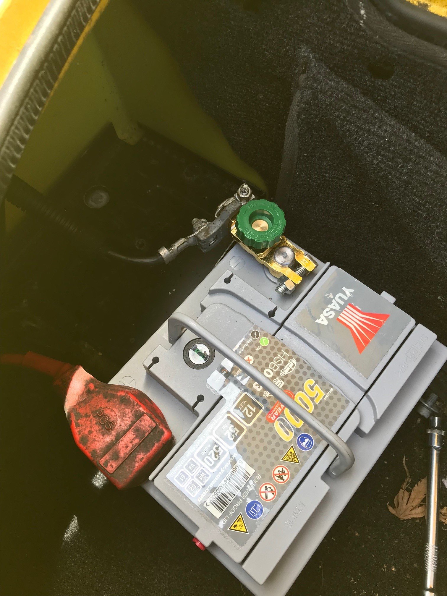

Saturday was a big day for Leeloo as the addition of a fresh battery, sparks and new fuel meant that I was going to see if she'd start!
I will be changing the cambelt and waterpump shortly, but I wanted to make sure I had a known working base, before I started to take it apart.

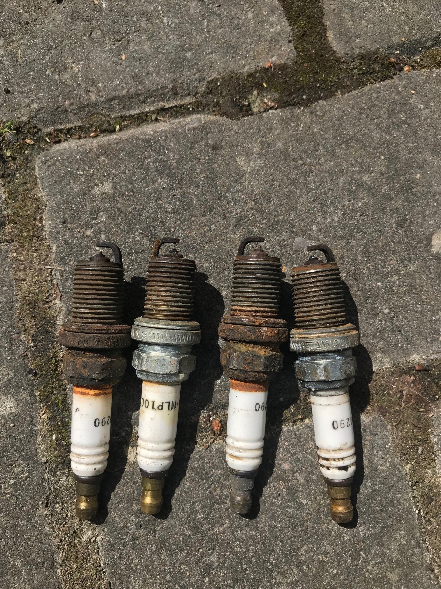

Old sparks out:
You can tell which were under the coil packs and which were just under the rubber plug leads...

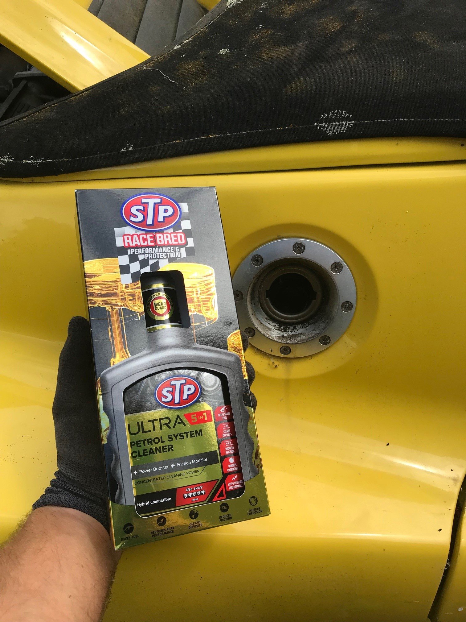

New Fuel in along with some Octane booster in case any old fuel was left in the tank, this one had some injector cleaner in it too...
New battery hooked up - As a project car I didn't want the battery connected long term, so I've added a quick disconnect switch to the negative terminal.
And guess what....
She fired up on first crank!!!! I couldn't believe it, I'm not ashamed to say there was a happy tear or two at that moment!

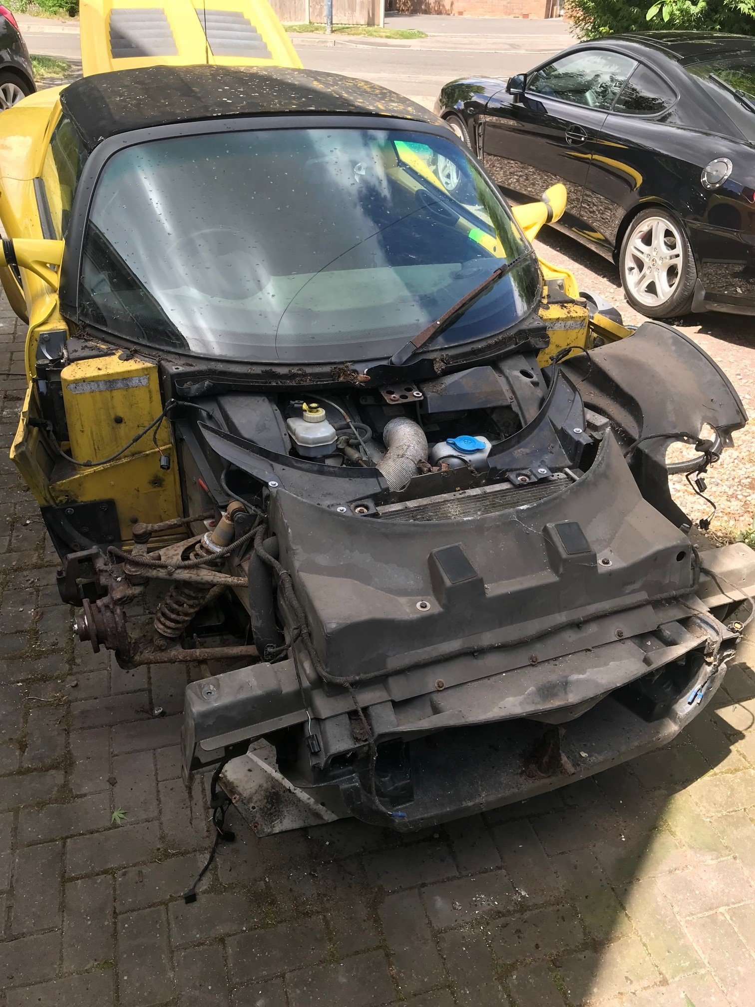

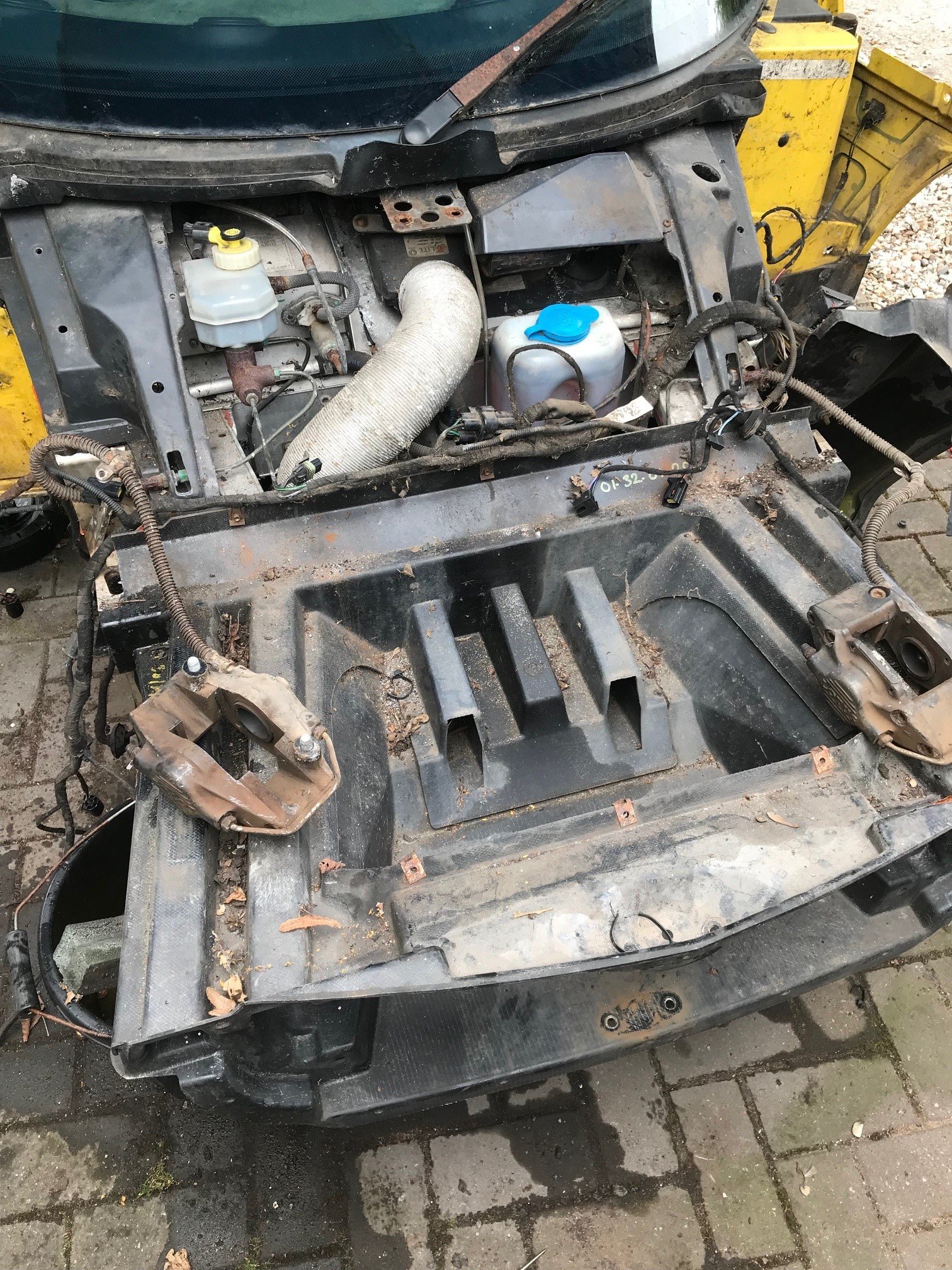

Next up was front clam removal, first time doing it so I drew a cardboard bolt map:
Everytime i removed a bolt, it got pushed through the cardboard in the place it came from (first bolt is already in)

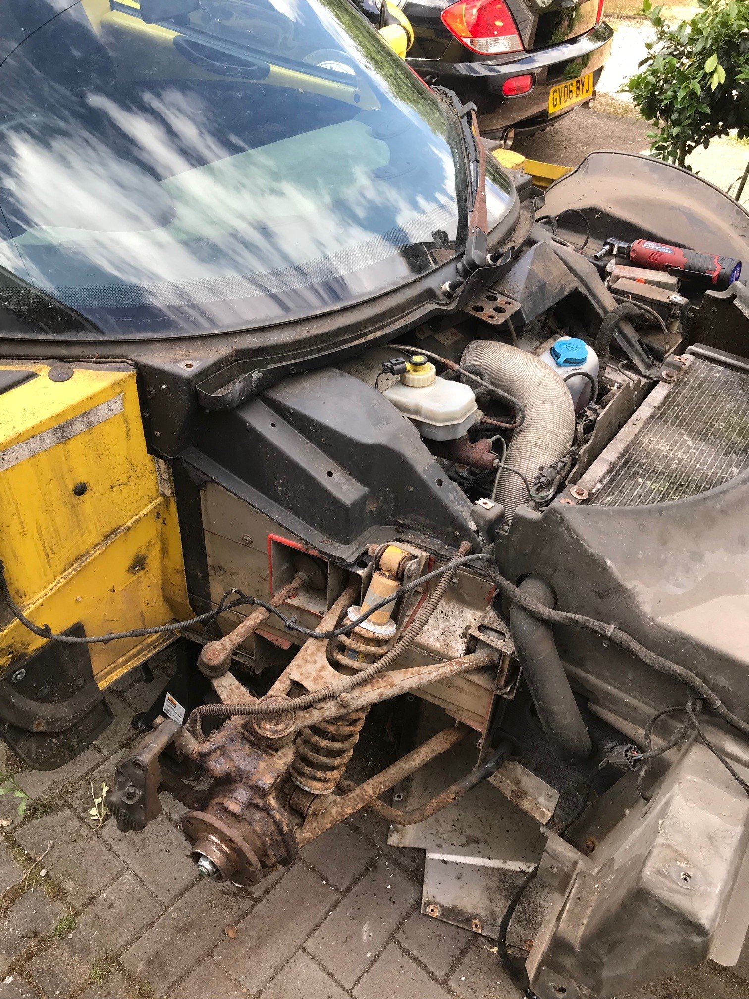

After that the clam did come off, although it was very tight over the radiator shroud -

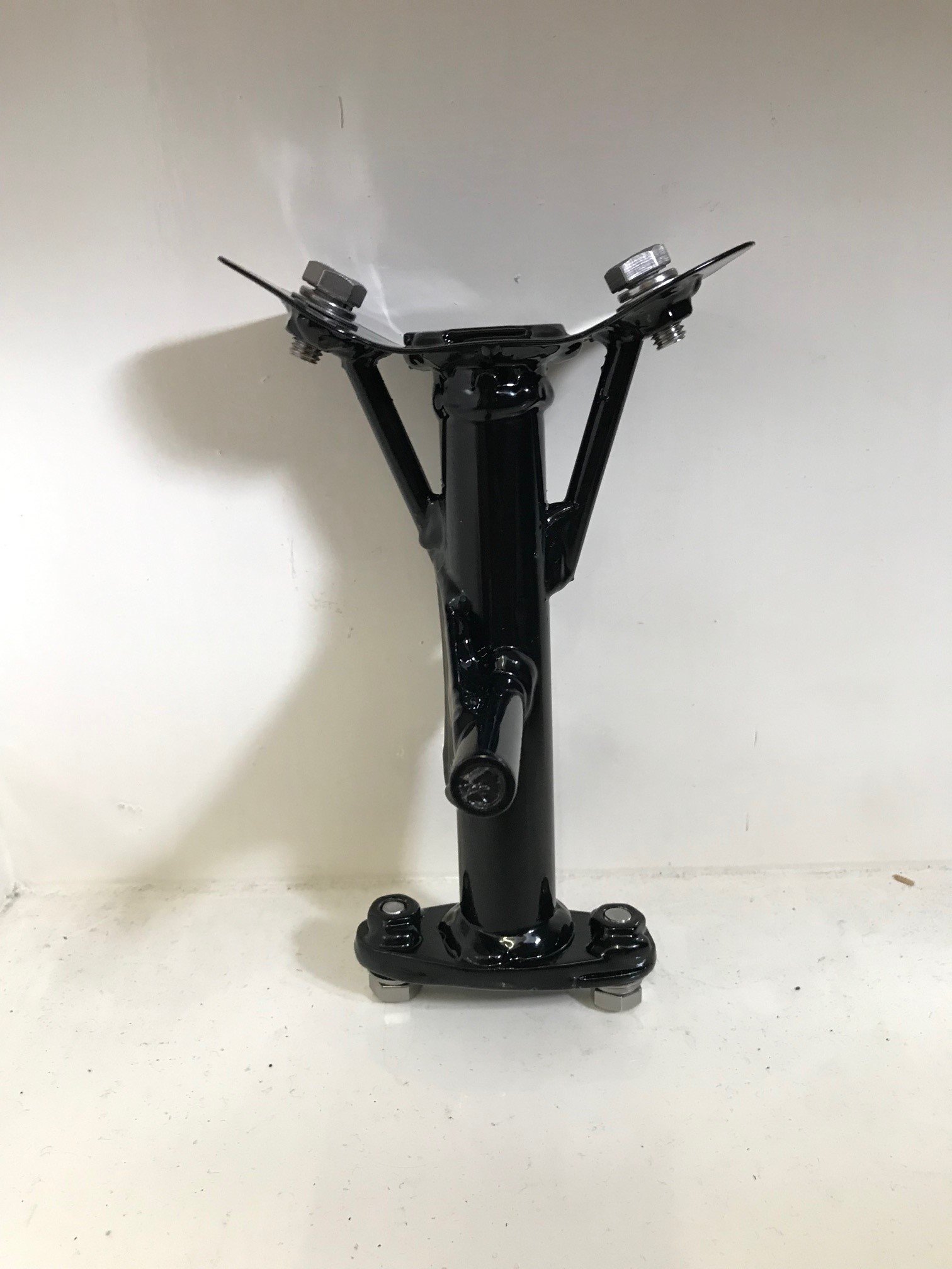

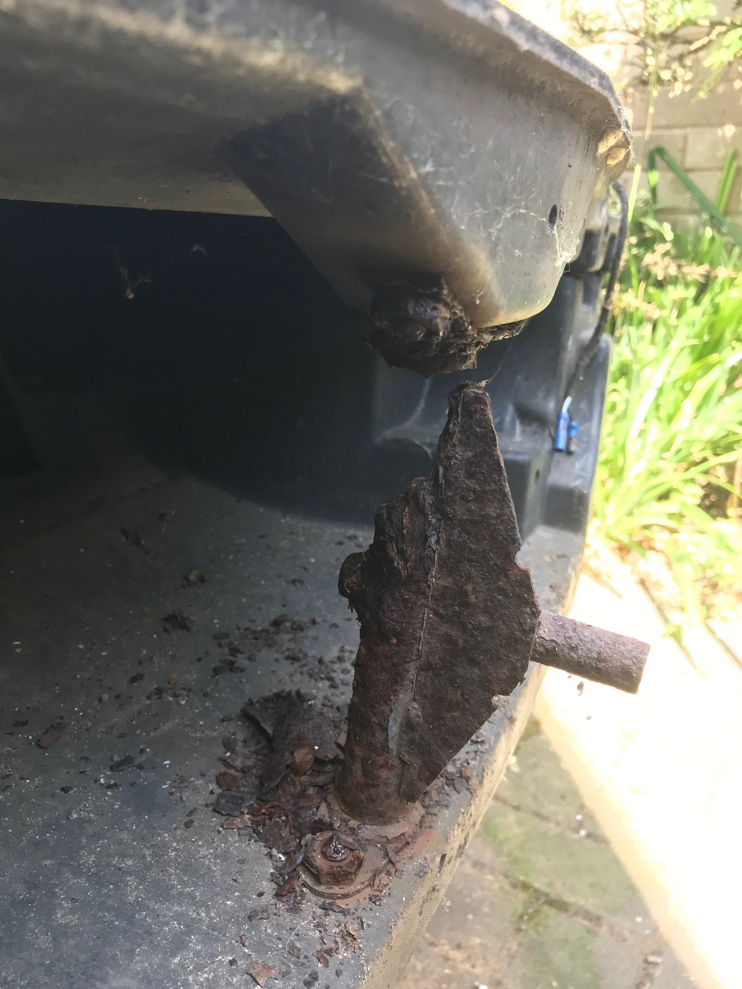

As expected, the tow post was toast!
Sprayed the front suspension joints with plusgas ready for the full dissemble this week, I also removed the bolts to the shroud so I can inspect the rad and blower housing-

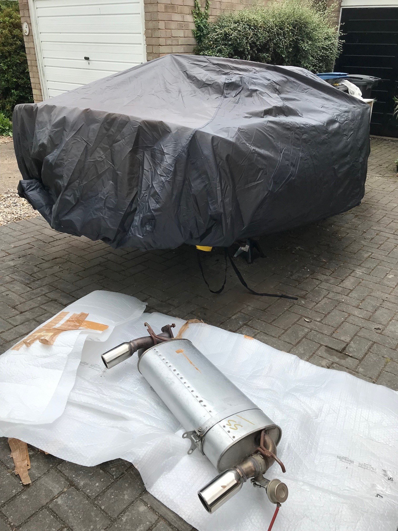

Sunday morning I managed to grab a barely used 111s Exhaust from a chap locally - this has the vacuum valve on the OS pipe, I'll see if thats something I can add in via a T-junction or if its better just left open the entire time.

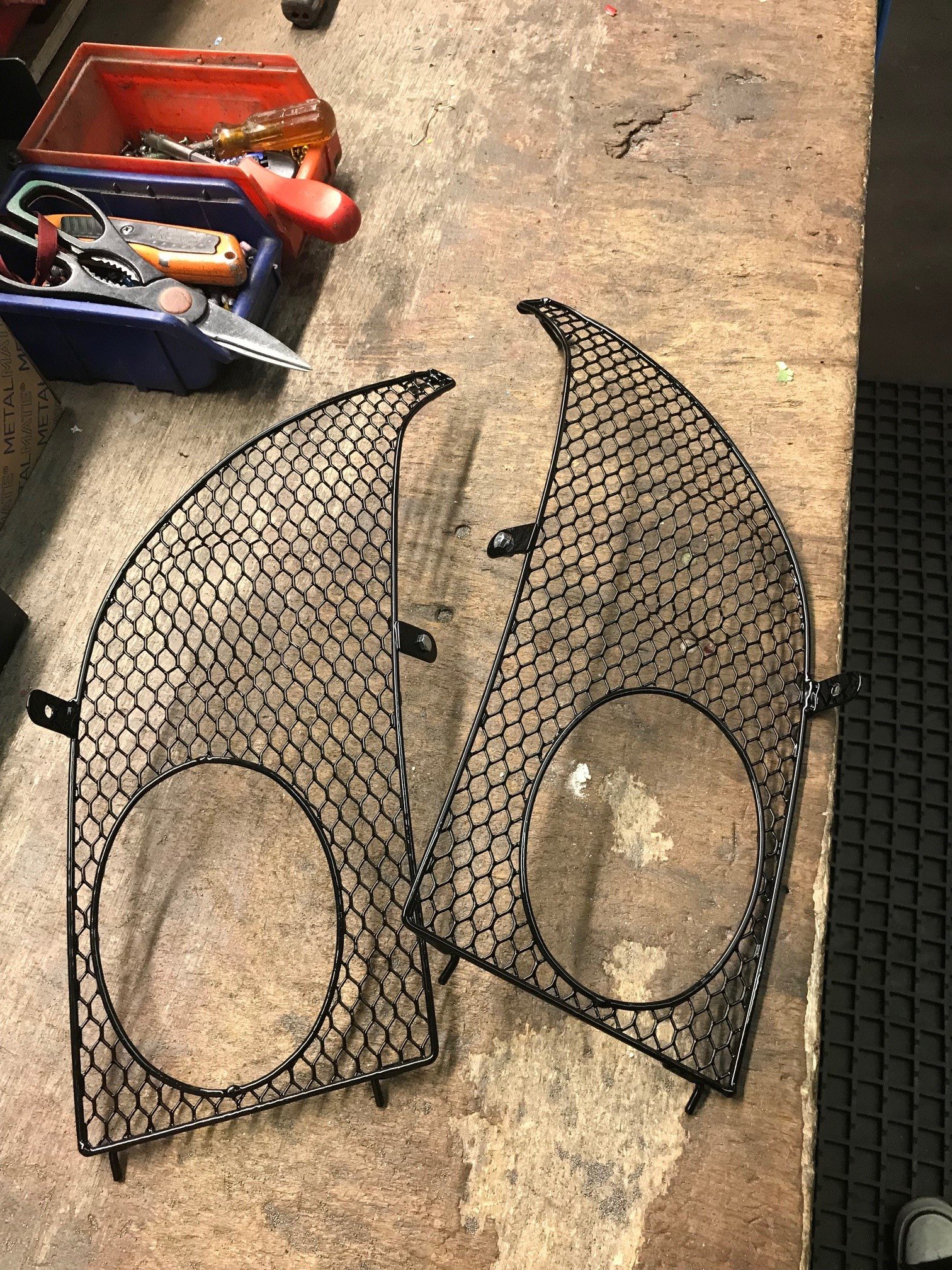

Finally a little update from this morning, those mesh grills that were horribly rusty when I removed them two weeks ago, they've had a double coating of gloss black and lacquer, they look amazing now!

I've got one of the chaps in the works making me a new tow post, update when he's made it!

To start with... its amazing what a couple of beers will get you with the welders in my work:
Two lots of measurement checks, drill and pin in position and then weld to finish. double layer powdercoated in gloss black and lacquered.

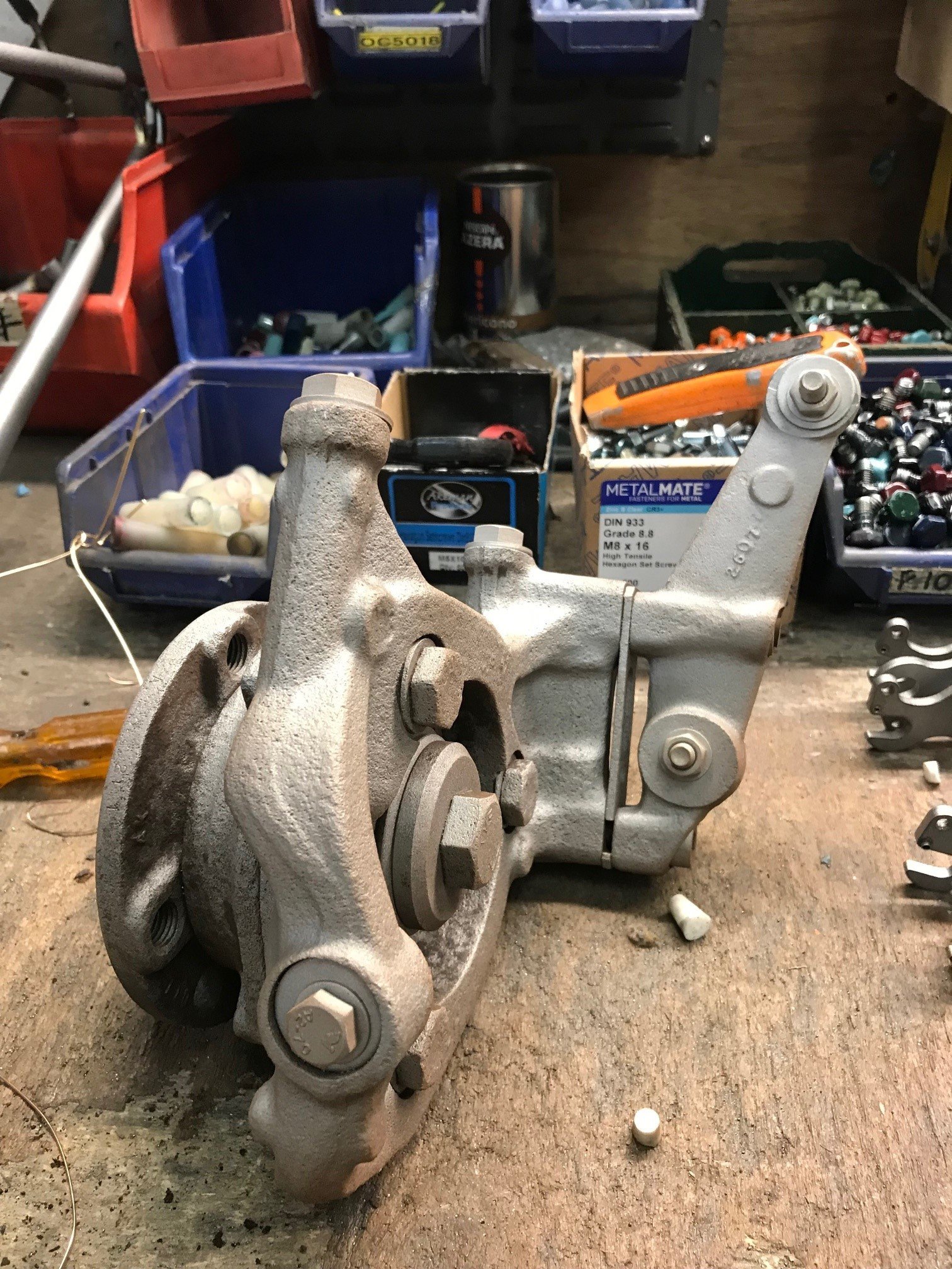

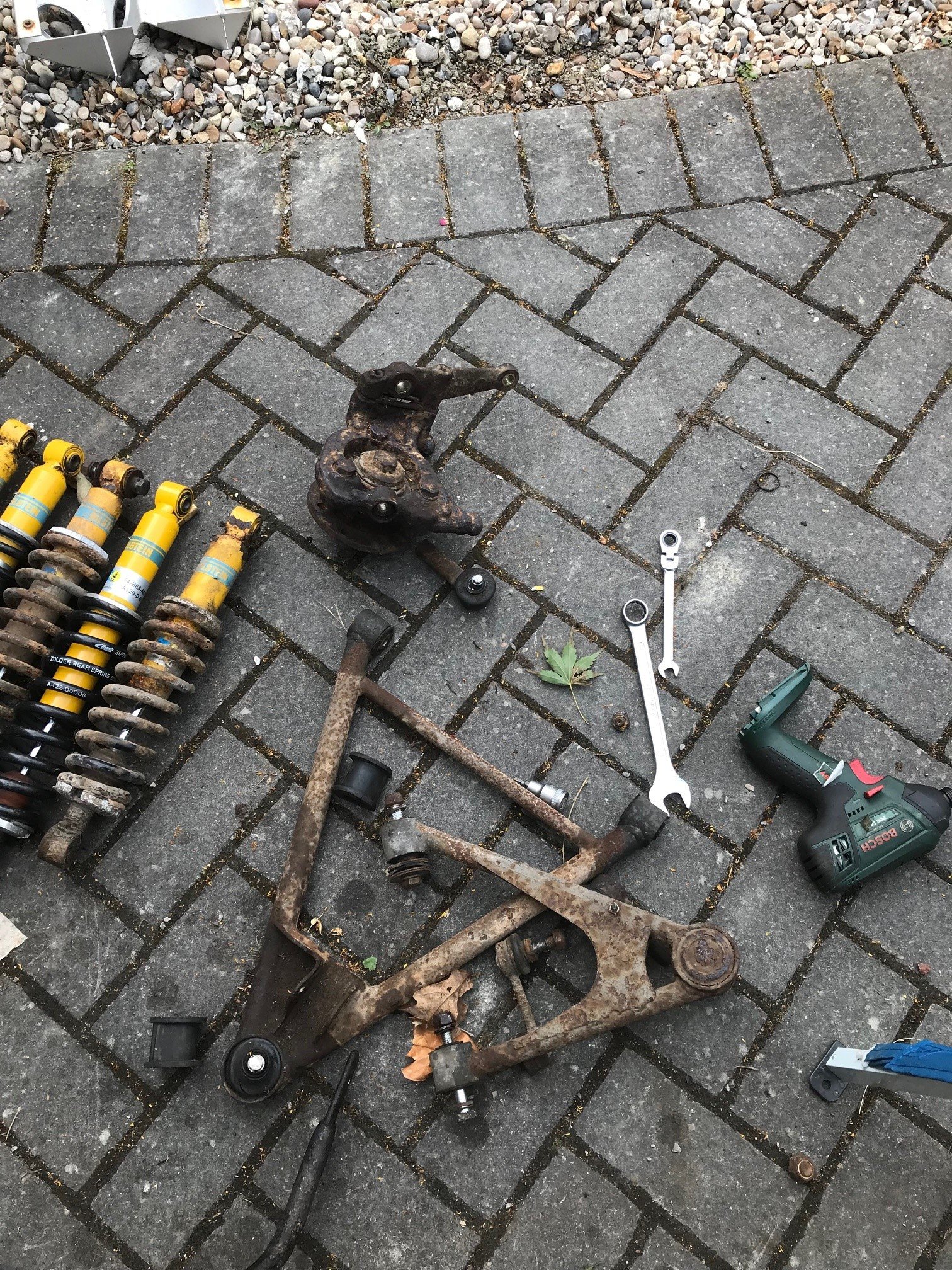

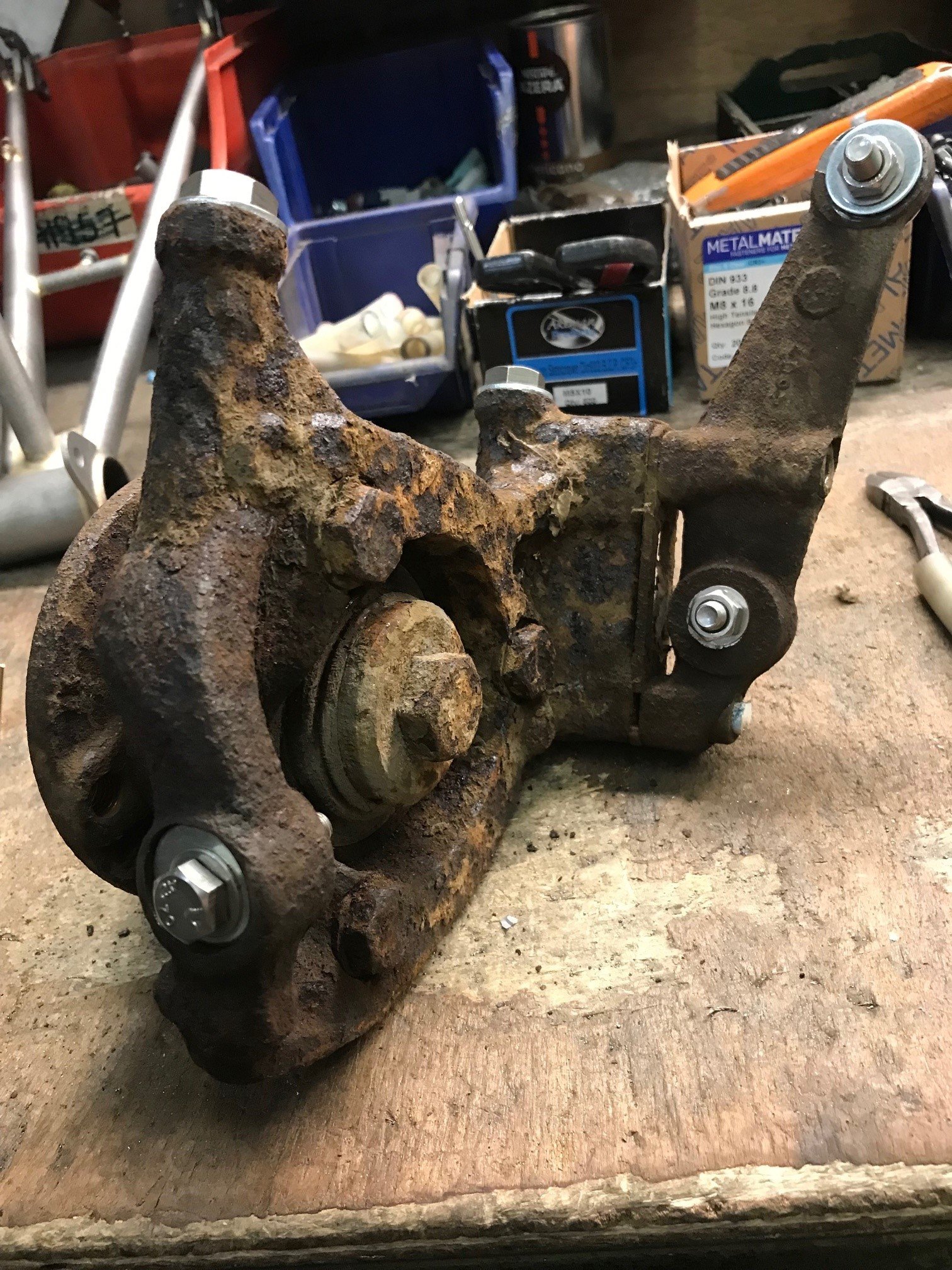

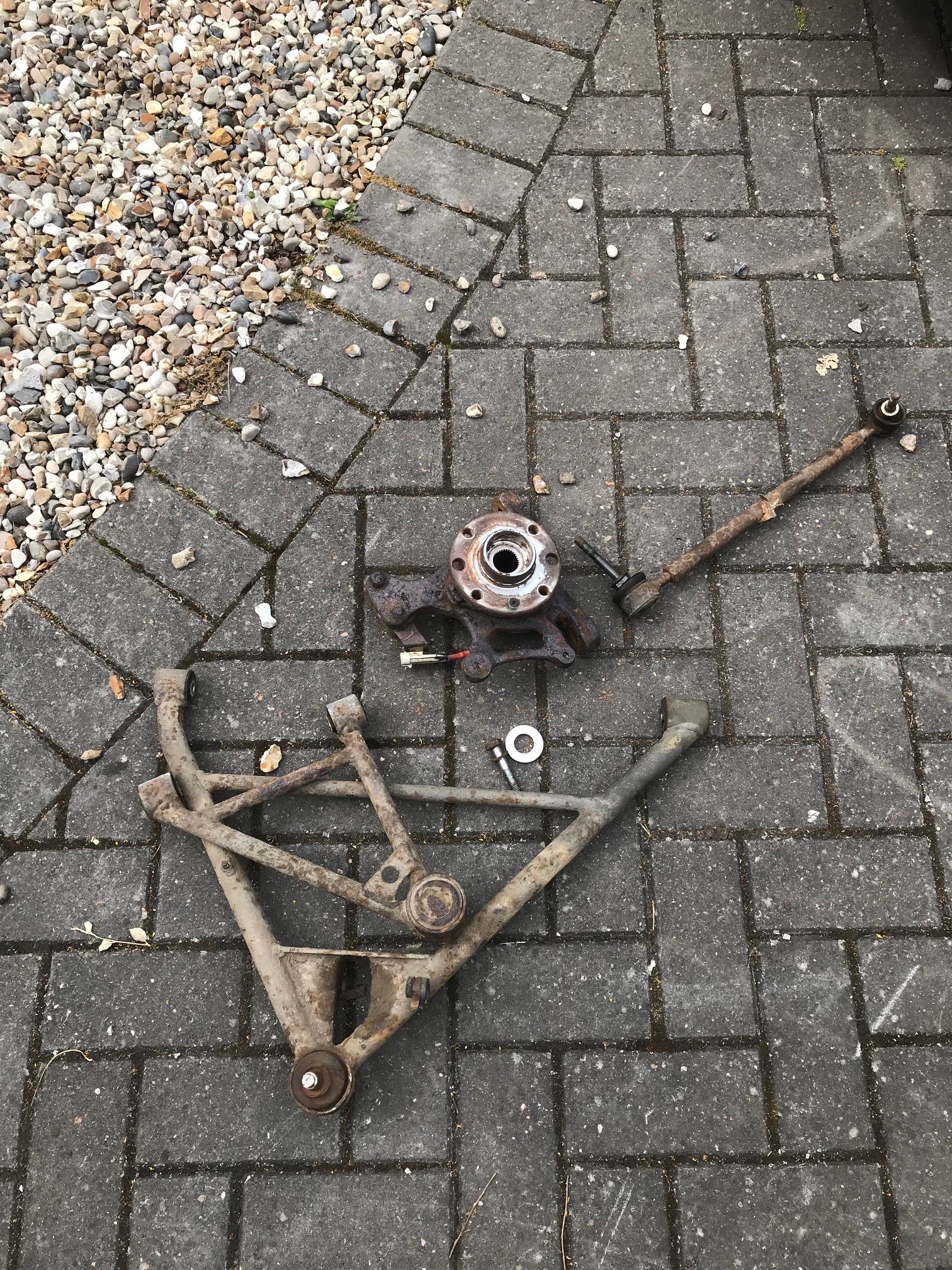

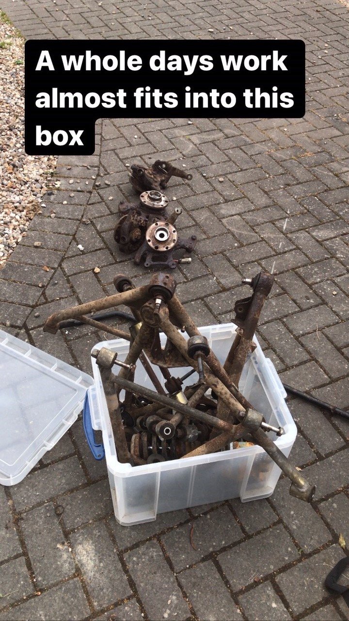

Last Friday did indeed see all the suspension come off LeeLoo -
The sticking points were the nuts on the ball joints, they got half way up the thread and stopped dead, as they're being replaced they were cut off with the angle grinder.
The passenger side lower wishbone nut was also a pain due to access, my S2 has the footrest bolted in from below, 3 bolts came out, the fourth spun the rivnut, the head got cut off enough to pull through and then I could get a socket on the bolt head for the wishbone.
These have been shotblasted and are off for passivating and then back to me for powdercoating.
I've also done the same with the hubs:rust.thumb.jpg.a7bf19a99127cb9957f5c1af9a265736.jpg
Don't worry, the bearings were left in to mask the mating surface against the shot blast, they're not staying!

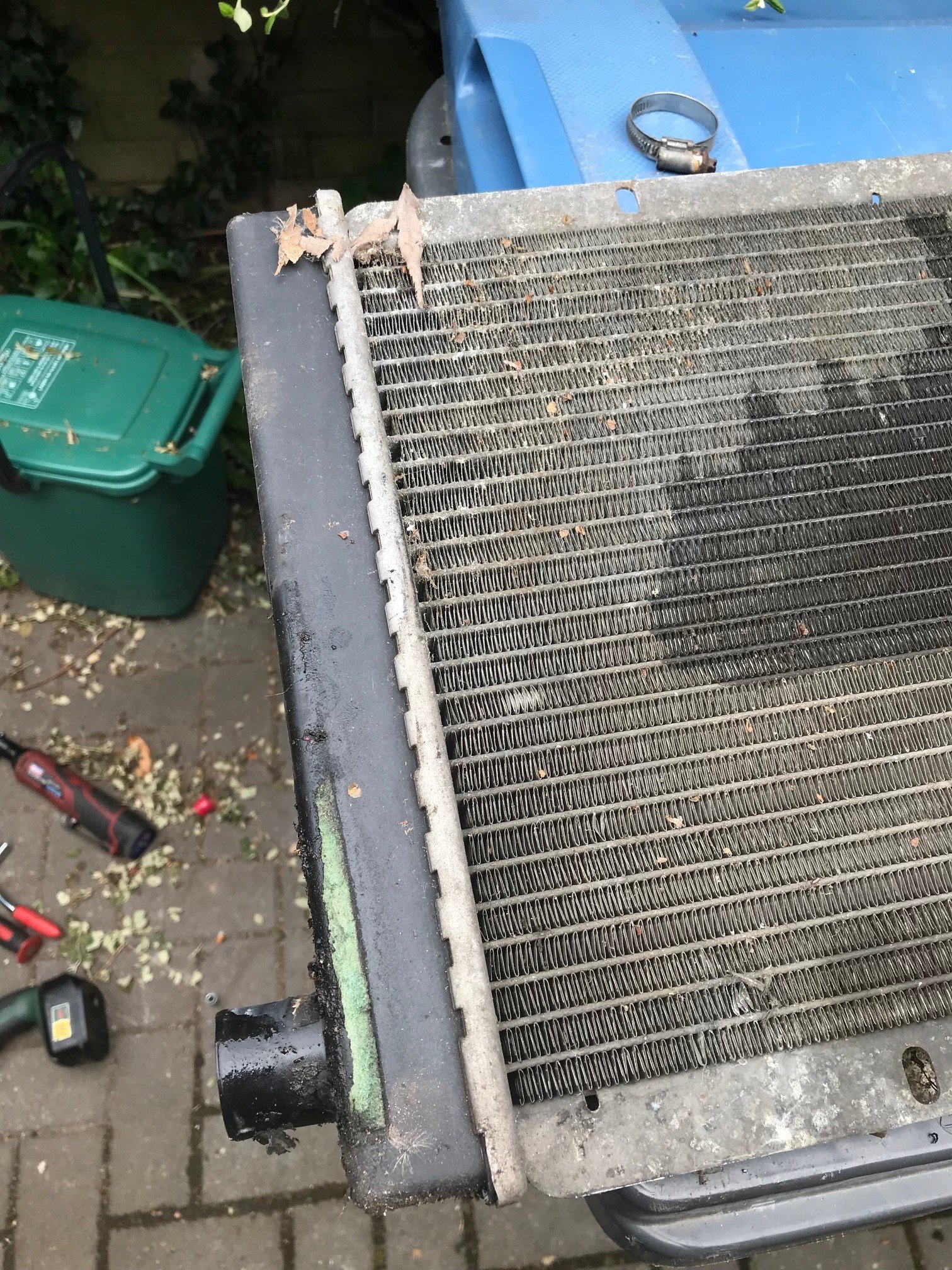

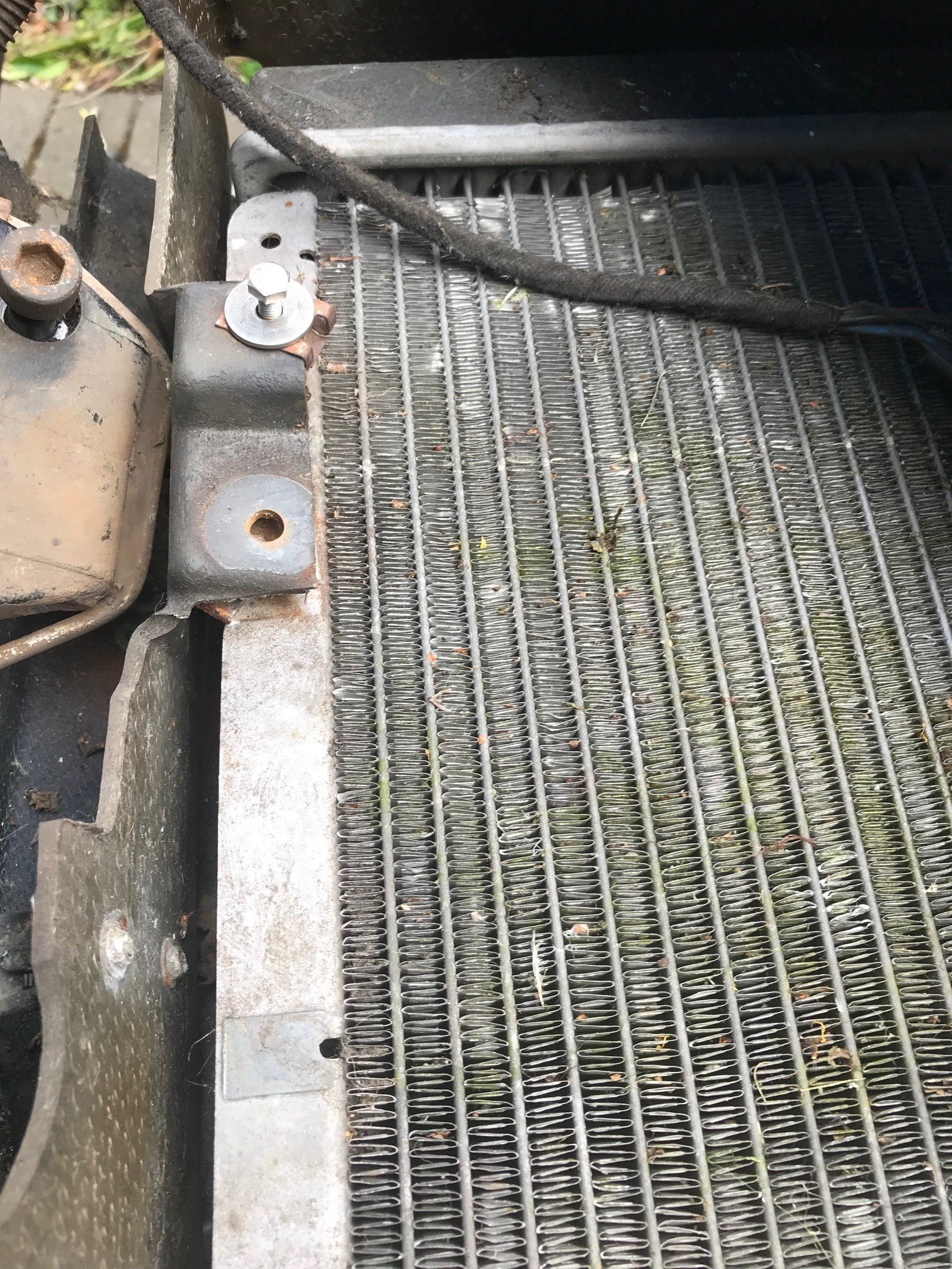

After suspension I removed the rad, I;ve never removed a radiator without covering some part of myself in coolant and depsite how careful I was, this time was no different.
on the mounts one bolt came out of its spire nut...
The other didn't
The radiator itself looked ok! no sign of leaks at the crimps, but it's going to be replaced anyway.rad4.thumb.jpg.7c2ea9913000b43f1ba5e11b63ab281d.jpg
Lots to clean in the front crash box!

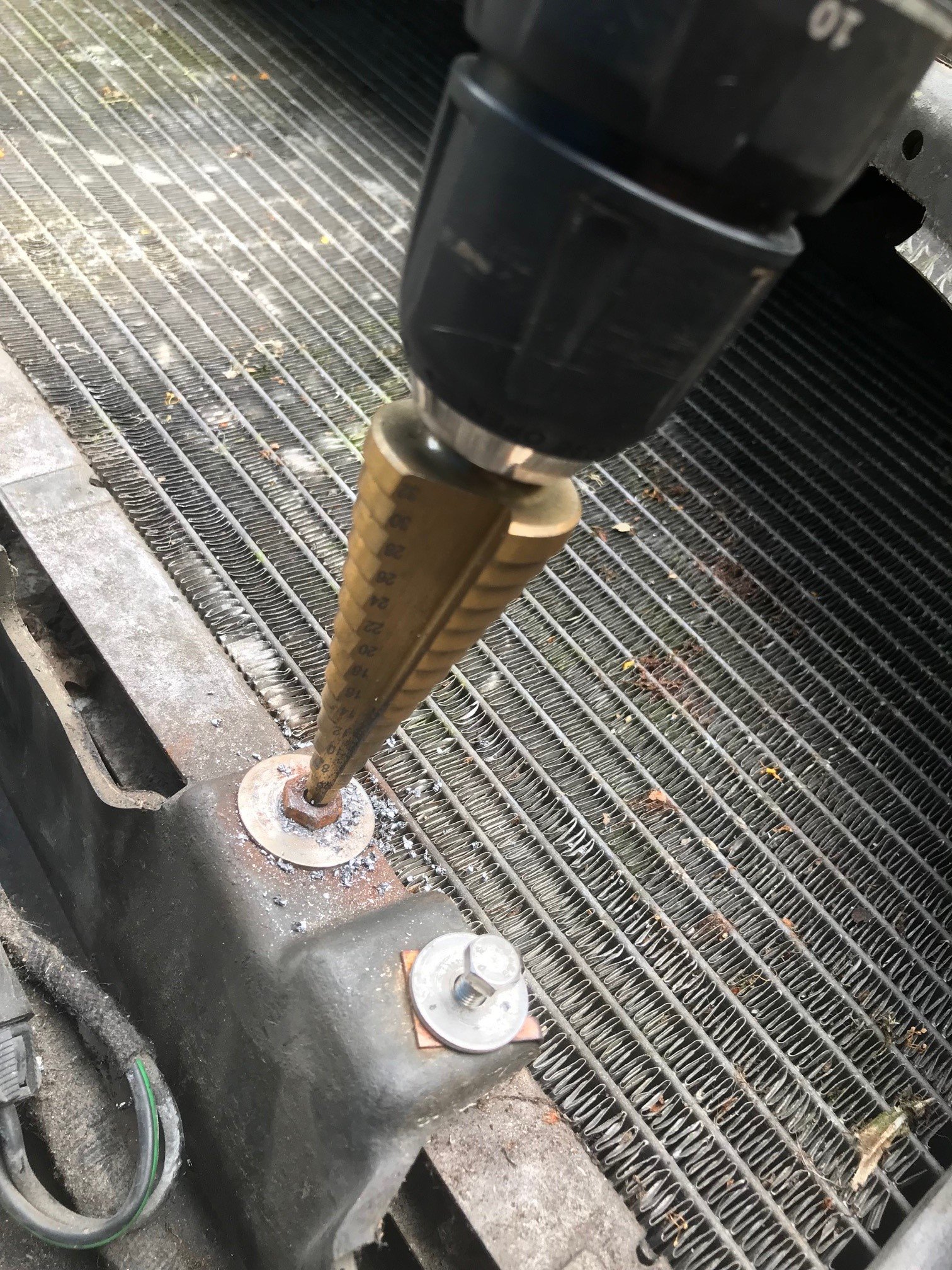

A question: Fan looks ok, for the new rad do I re-use the rusty mounting points? if so just drill out the rivets and rivet onto the new rad? (giving a blast and powder first probably)

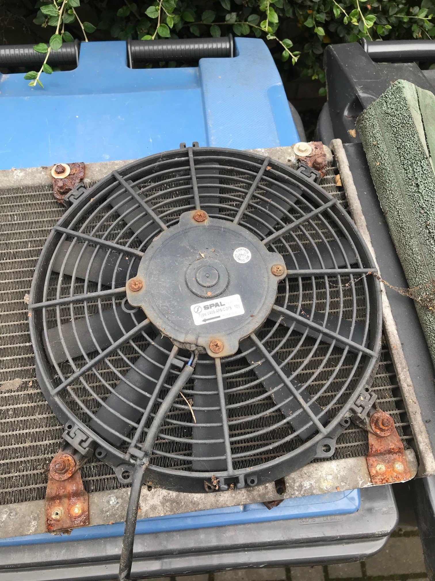

Just drilled the rivets off the fan mounts ready for the new radiator…
fan is entirely seized, guess it’s new fan time!
Posted
I was going to suggest that replacing the radiator with an old fan was probably just asking to have to take the clam off a year later.  The fan rarely runs, is exposed to rain, and in a very sheltered position that stays wet.  They are very prone to seizing.    At least you found out now :)
