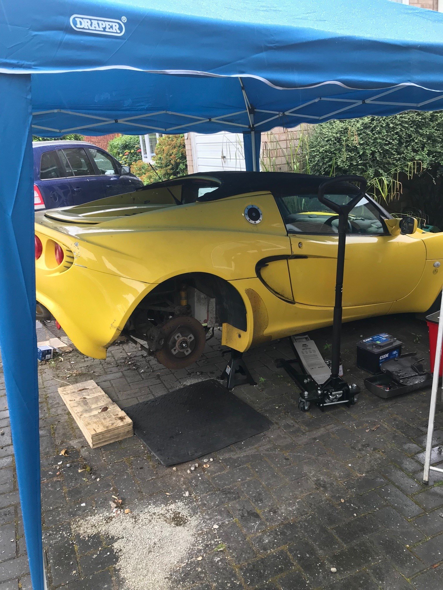

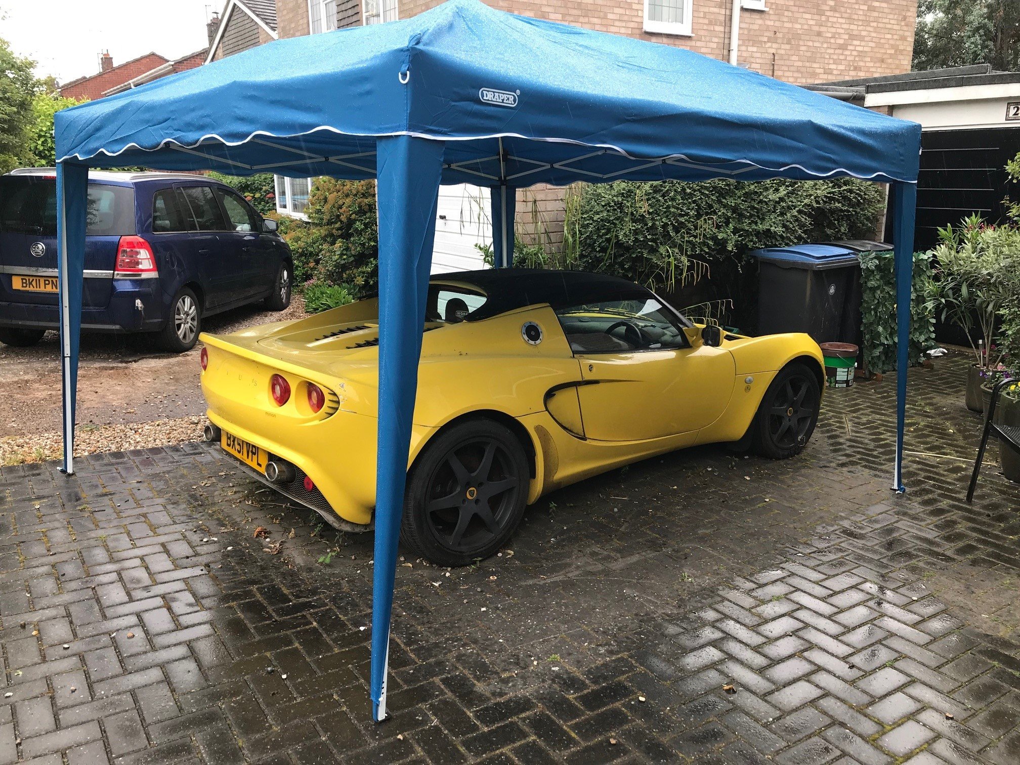

Time to get her up on stands, my first time jacking up an Elise and learning about diffuser and tray removal to access jacking points! unfortunately for me it was raining... time to get the EZ-Up out!elise2.thumb.jpg.5285791fb909959138e81d451c208bbe.jpg
For a bit of background, I'm 30 years old, self (read youtube) taught for mechanics (so I really don't know what i'm doing!) and I'm working on the car on my own!

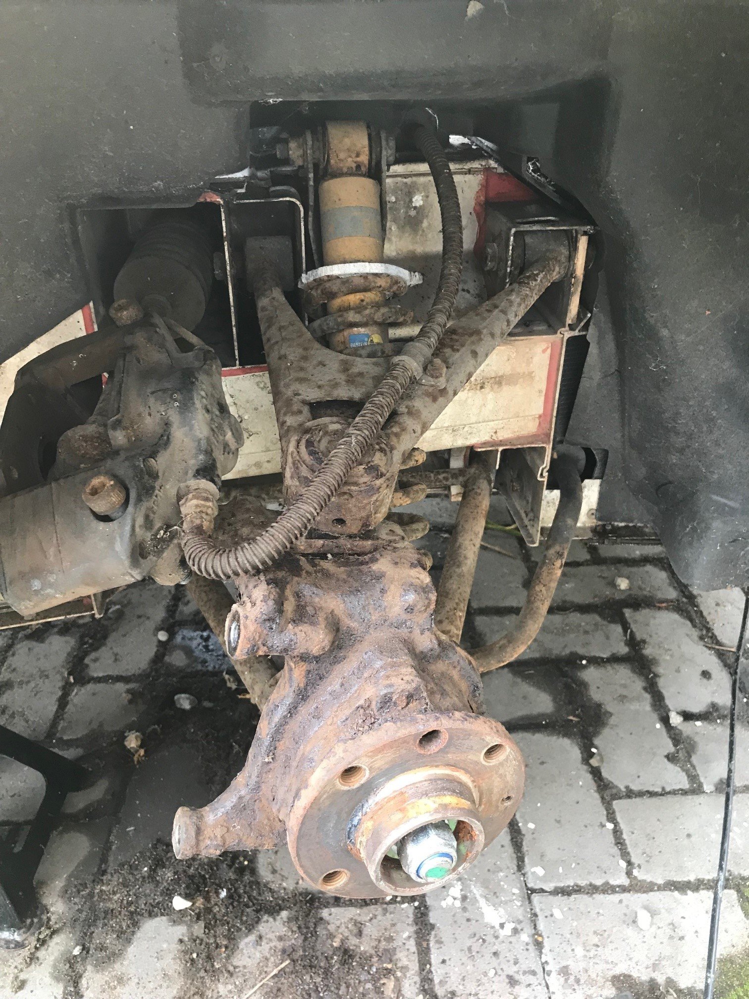

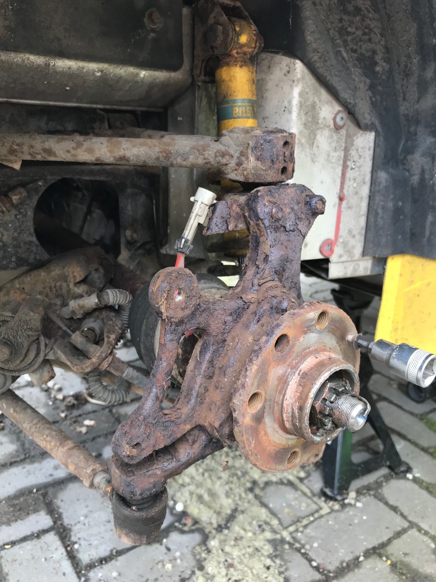

With Leeloo up on stands I thought i'd start at the back end...elise3.thumb.jpg.b926554077cb7213bd390f01d88a1ea7.jpg
Lots of rust, spiders and whatever else got caught up in this area over 7 years. Shocks have definitely gone beyond usability, however the wishbones are all nice and straight with surface corrosion being the main issue. I'm lucky to work in a company that has its own shotblast and powdercoat facilities, so I will be able to do these myself, of course new bushes and ball joints will be needed at that stage.
The Rotors have also gone, so will be replaced, the car was not sat with the hand brake on luckily so the caliper does move, however I will be sending them off for a rebuild.
Not photographed but I removed the cam cover and inspected the belt the whole way round whilst hand cranking the engine via the crankbolt, the belt looks in good enough shape to try and start the car at some point, however it will be replaced along with the waterpump (as I have these parts in the garage already).

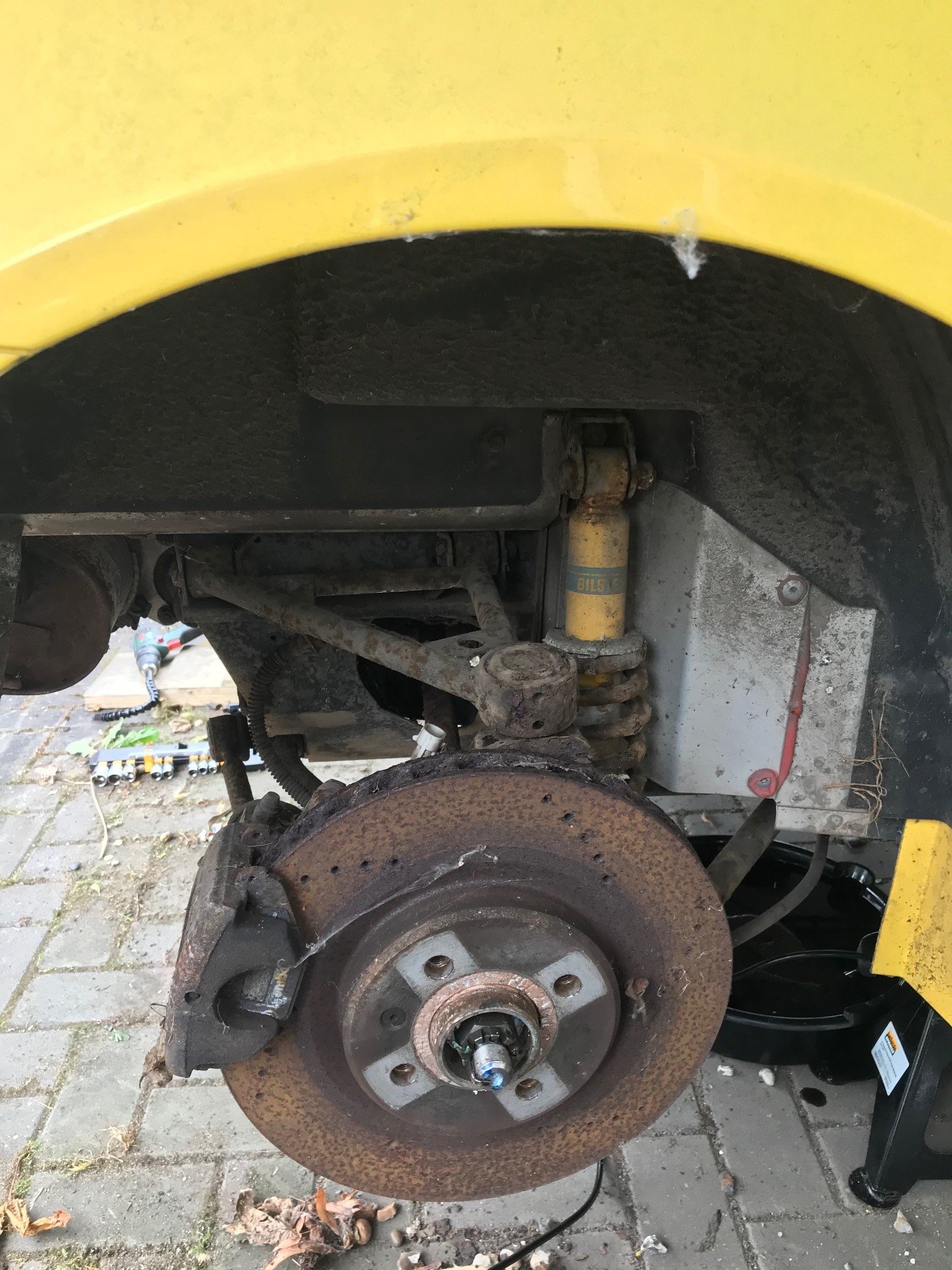

I thought I'd carry on towards the front to see what the situation is like up there: much the same, plenty of rust, however the front brake calipers are in far better condition and will benefit from a good clean and regrease.
The front suspension is much the same story as the rear, shocks gone but wishbones serviceable.

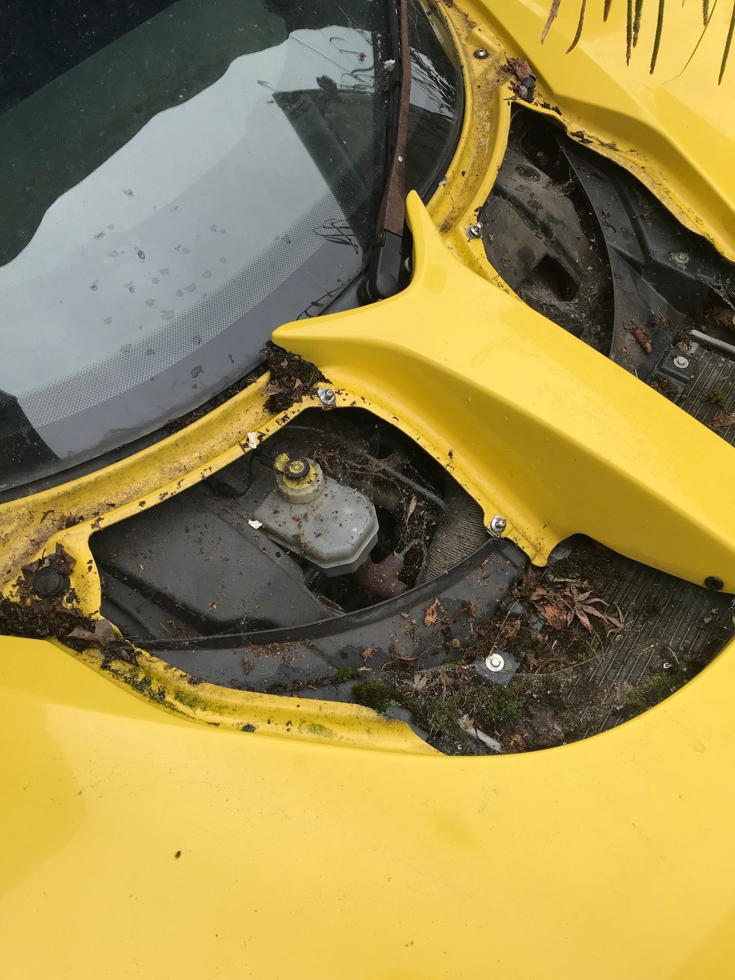

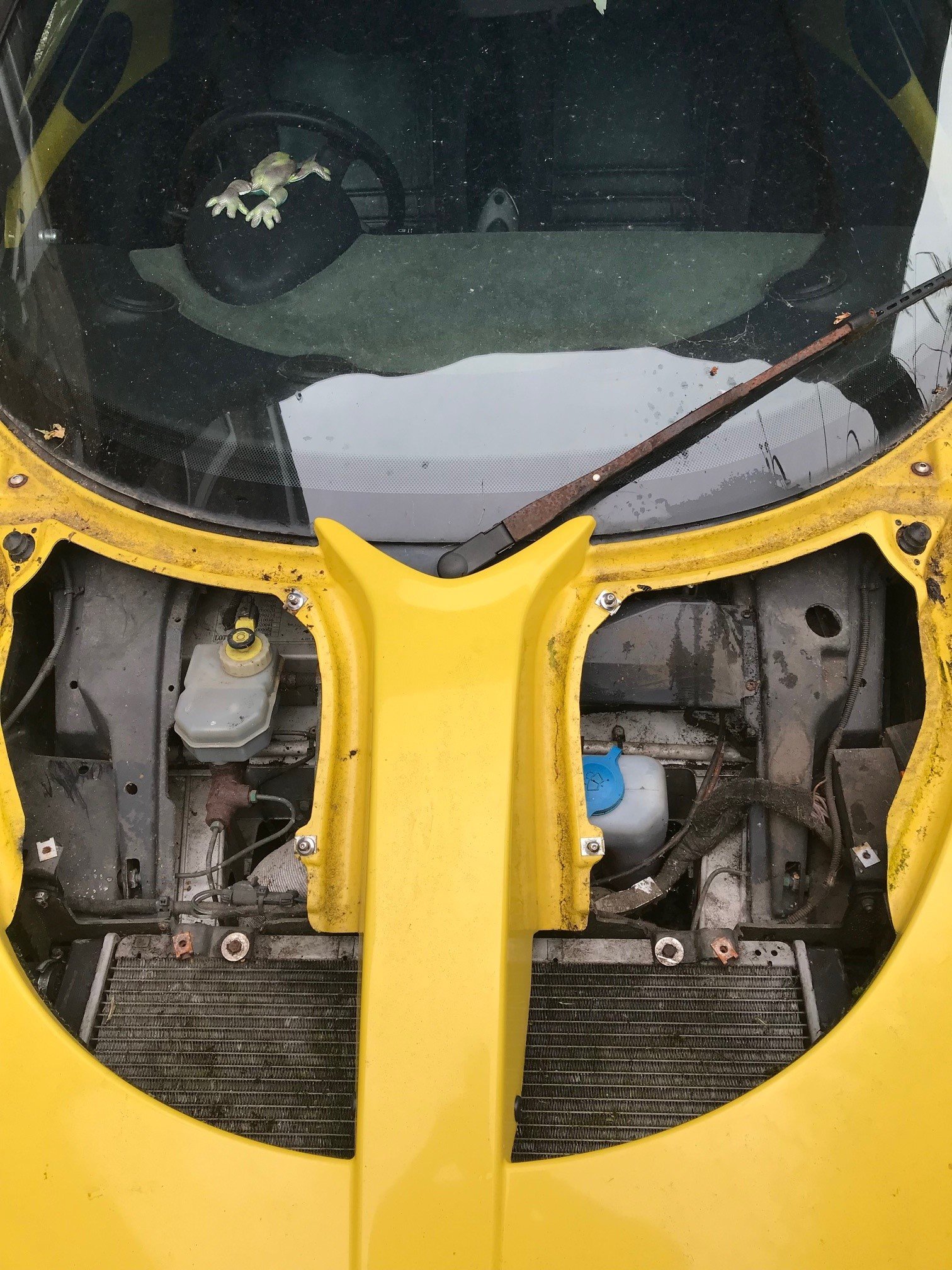

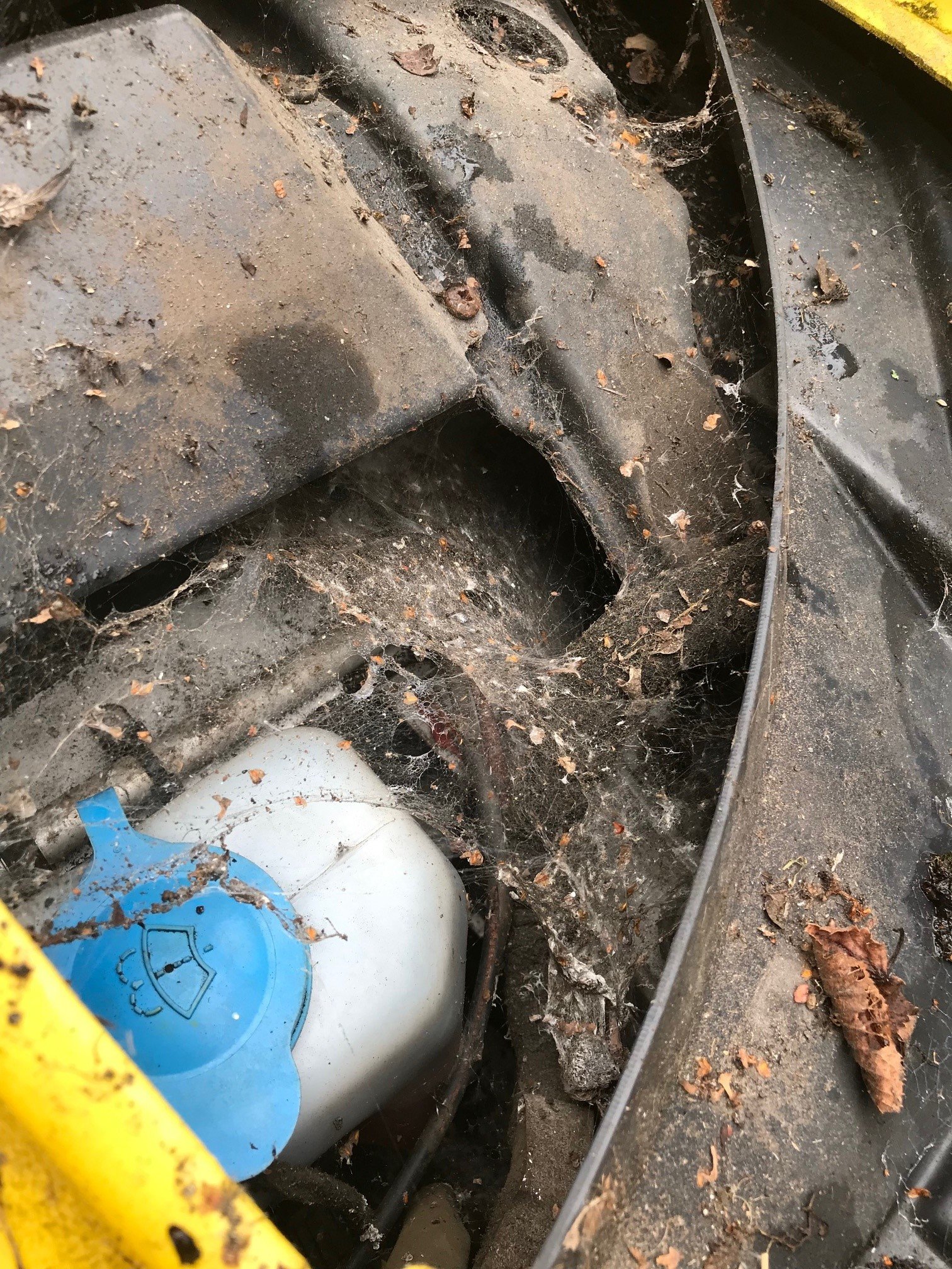

At this point i'm getting sick of all the cobwebs and dirt so out comes the shop vac, pretty lucky really as I had a look under the front panel at this point...
elise4.thumb.jpg.73bae35fa27facd90878478b6d610cf4.jpgelise10.thumb.jpg.da56b92f93ba07e5b84cde1ae7b01ca3.jpg
one thorough vac later -

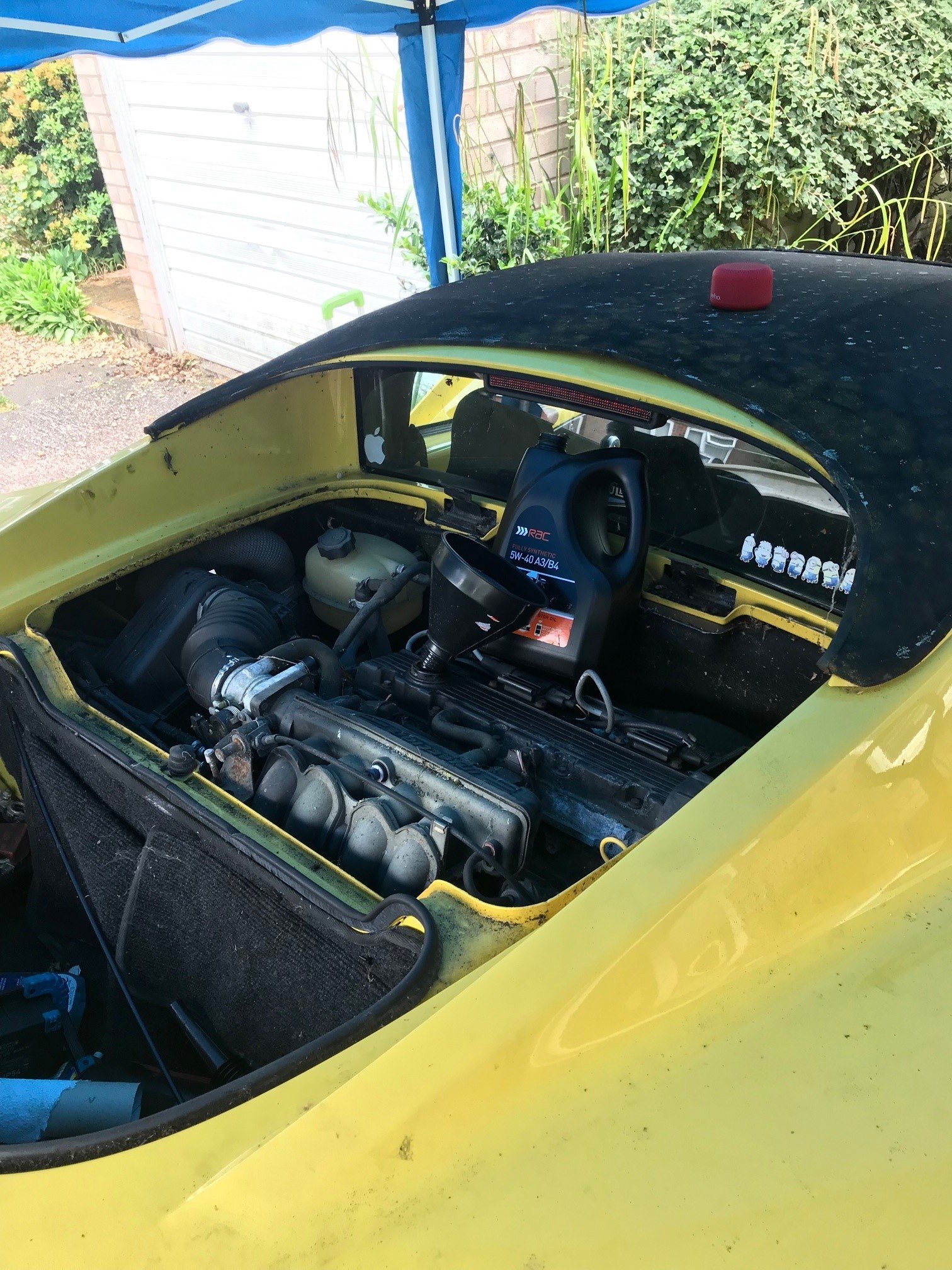

Next I dropped the old oil and filter off, added cheap fully synth and cheap filter. The car won't be properly run on these but I'm adverse to using oil flush, so I thought I'd get the first 50 miles done with cheap stuff and then do an immediate change to Shell oil and the OEM filter.
I couldn't get the funnel to sit properly, so I took the bootlid off...

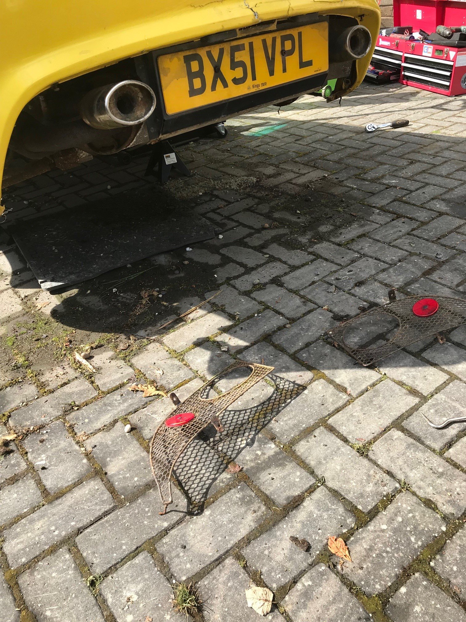

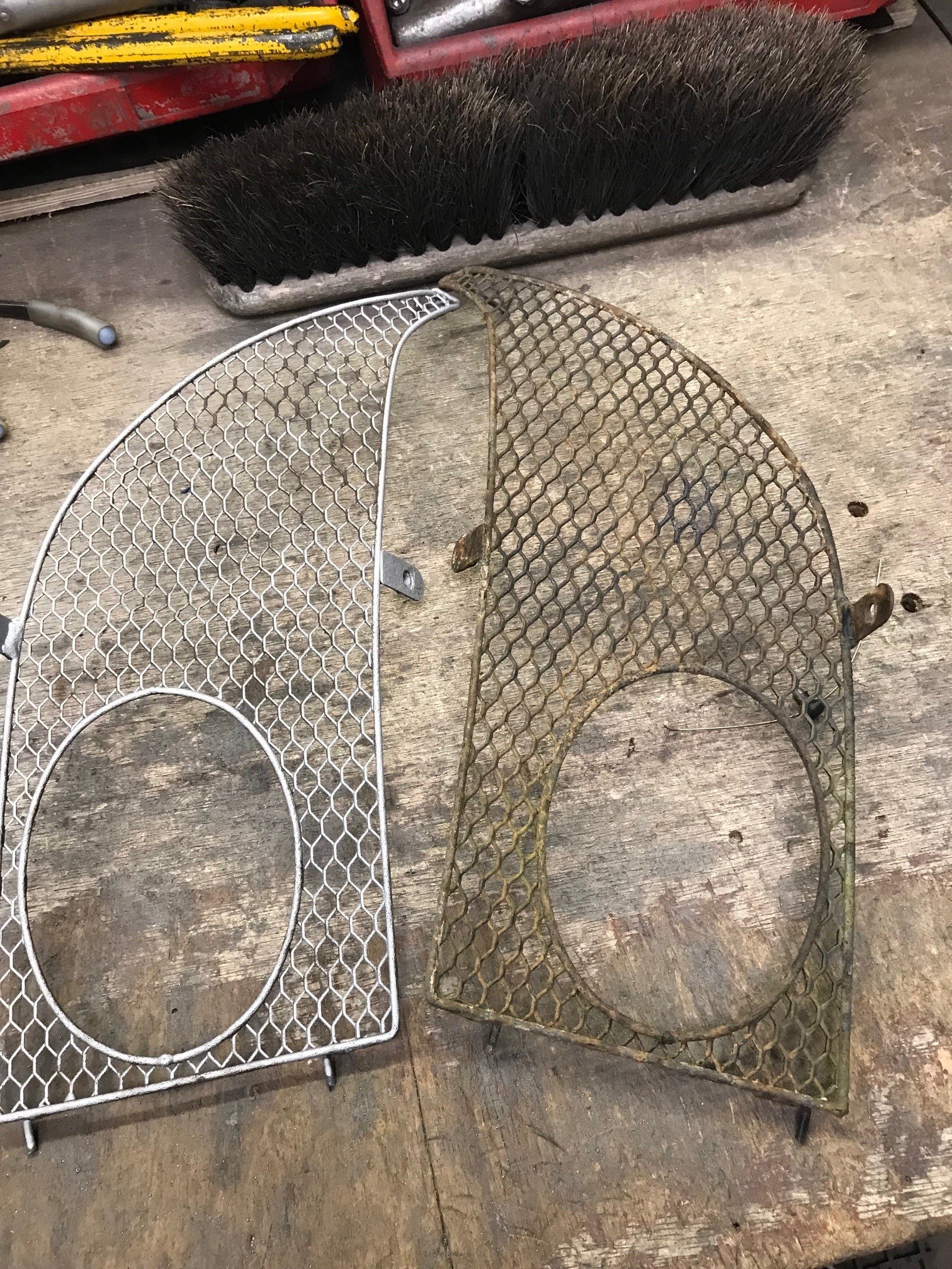

I started by removing the badly rusted exhaust grills to be sorted at work
Next I set about the suspension, I wasn;t ready to remove all of it just yet, but I wanted that task to be as painless as possbile, so I went around each section and cracked every nut and bolt loose and left them in placeelise12.thumb.jpg.4e2231ddfd9d56f888b2dcf3d278467e.jpg
Removing the axle nut without a handbrake was interesting!
Loosening all the nuts took a lot longer than expected due to the bent tab washers and the inaccessible toe link nut on the OSR!

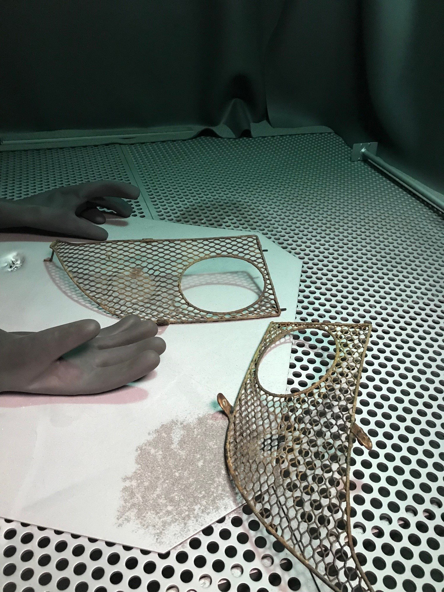

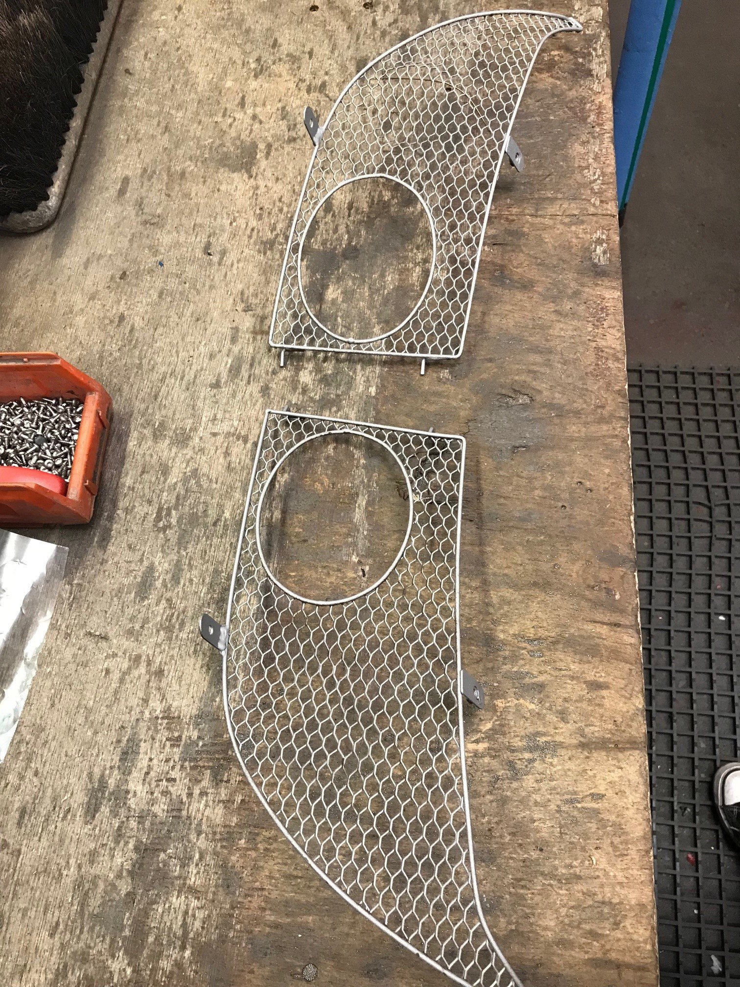

those mesh grills? well they went into the shotblast cabinet on Monday morning, I turned the blast pressure down low and did them by hand... much better!shot1.thumb.jpg.eb51d7ab117af9e51602da6447632839.jpg
I'm just waiting for Black to be used in the guns and they'll be coated black with a lacquer
