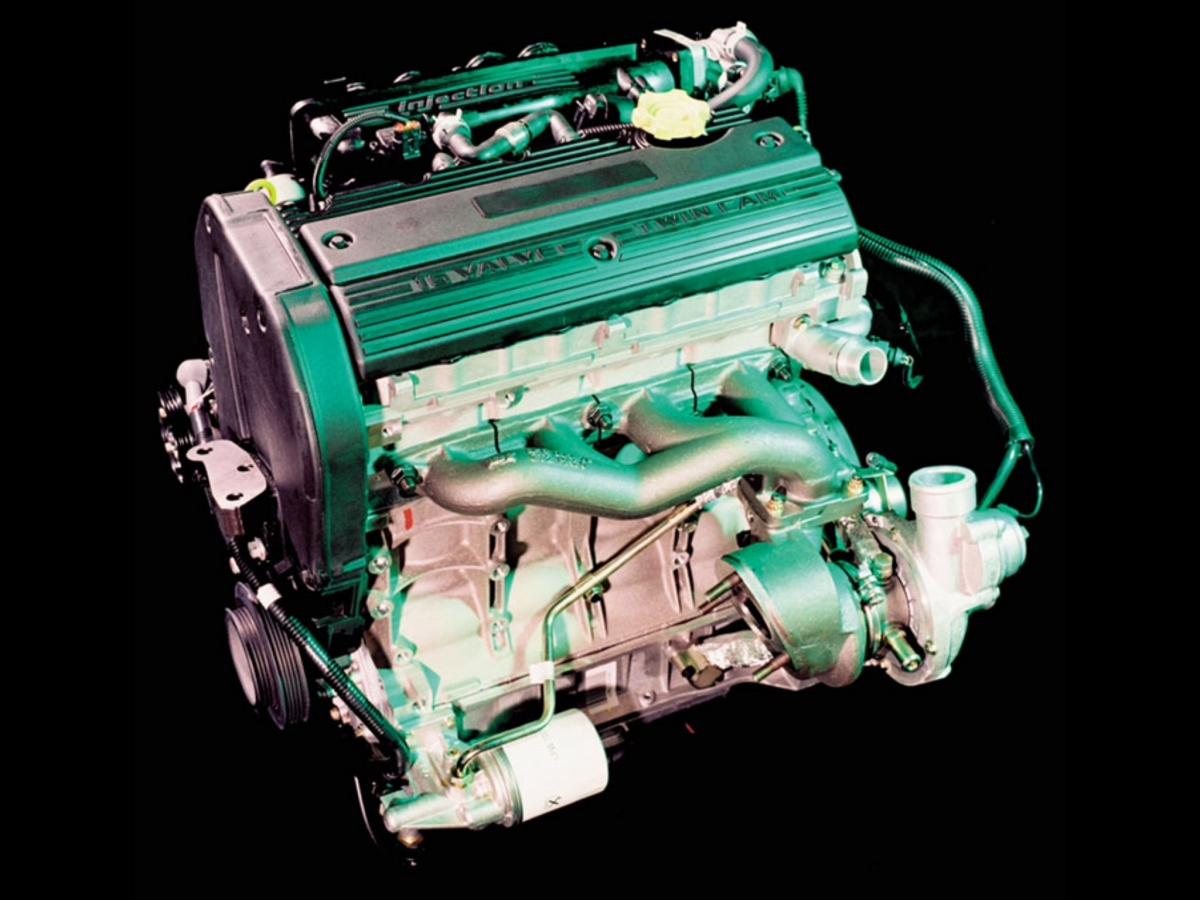

Marcus Posted March 17, 2015 Share Posted March 17, 2015 Hi all, I've been considering multiple engine swaps recently and have stumbled upon the information that for a small period the mg ZT and rover 75 used a low boost turbo k series engine (see attached image). I know several people have done t series transplants for big power but no one seems to have tried a k series turbo transplant. The standard motor only has 160bhp but a t25 turbo bolts straight onto the standard manifold and with some minor tweaking should be close to 190-200bhp. I know this is achievable with an NA engine, but this will be a fairly low stress setup with a nice amount of torque. My main concern at this point it - why has no one done this before? Link to comment Share on other sites More sharing options...
