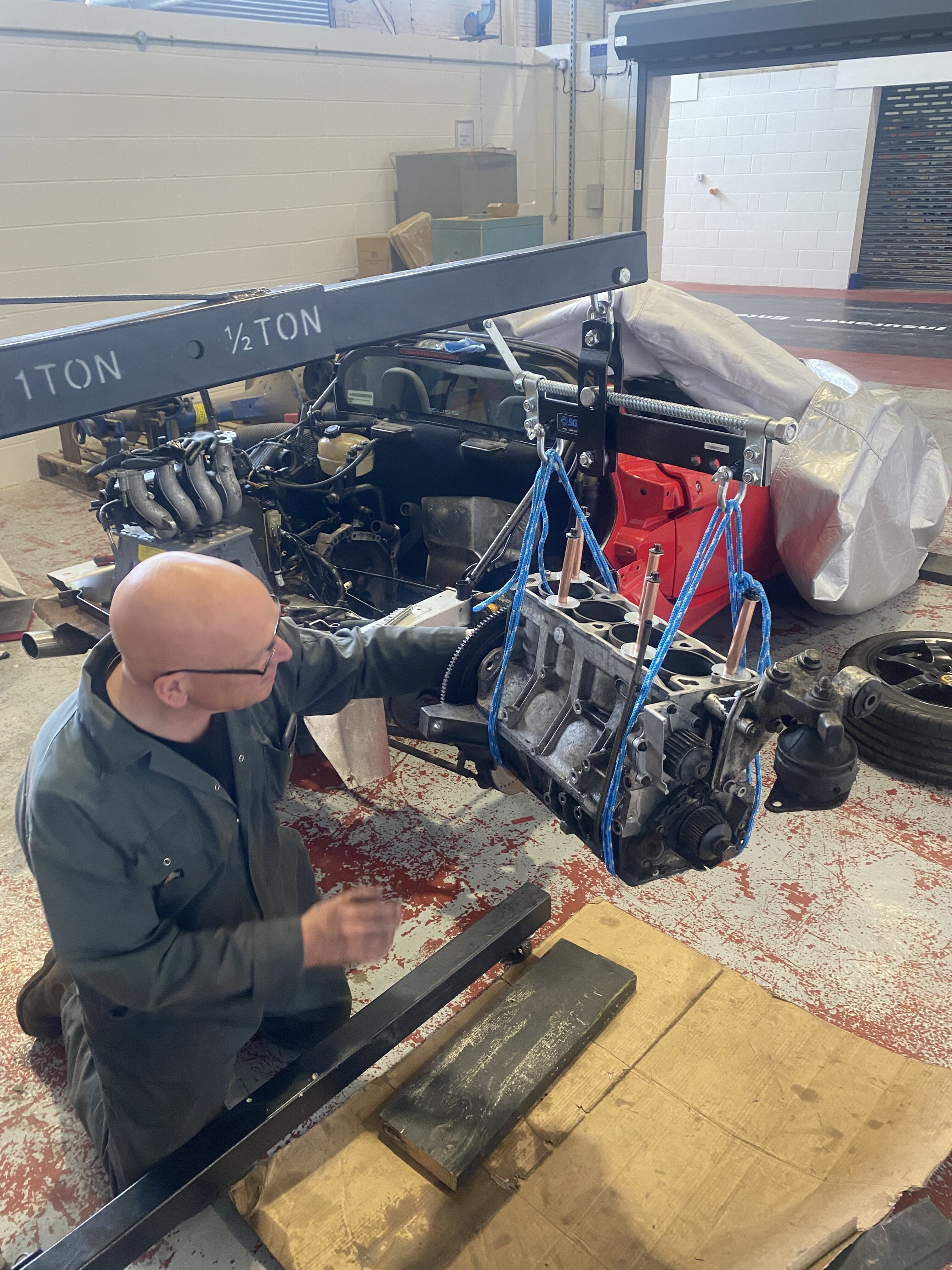

If you have repeat failure of head gasket it’s not likely to be fixed by a multi layer steel head gasket or good workmanship. It could be that the liners have sunk below the deck of the block. They are meant to stand proud of the deck to help create a good seal between cylinder and gasket.
Ultimately the failsafe solution is new liners/bottom end rebuild, updated oil rail (not essential apparently, I did it anyway) higher torque head bolts and head saver shim to preserve the cyl head. Alternatively keep changing head gasket every 5000 miles.

George I'm sure all of that will make it bomb proof but mine has been just fine without a bottom end rebuild and Gav at Unit 4 has done dozens without further failures. As you say, liner heights need to be in tolerance and Gav always has the head skimmed to be sure it's nice and flat. If the head isn't weakened or damaged it's fine to simply refit with a MLS gasket and new oem stretch bolts.
I wouldn't want to frighten people in to thinking a blown head gasket will always require a full bottom end rebuild and new liners at a cost of about three grand.

No scare mongering here, just a reality for some.
Yes head skimming is usually always done as you can’t risk it being an aluminium head, but can’t be skimmed endlessly, they have a limit. Worth remembering after every skim the compression ratio will increase and the cam timing will be retarded circa 1 degree every mm taken off.
In fairness, it seems the blocks themselves weren’t perfect from Rover hence why liner shims were manufactured to help lift them. But if you’re getting into liner shims we just thought it would be better to do the whole thing.
I’d genuinely love to know the longevity of mine (I’ll find out one day) compared to slapping MLS and forgetting about it. Would have saved us many weekends work 😂
