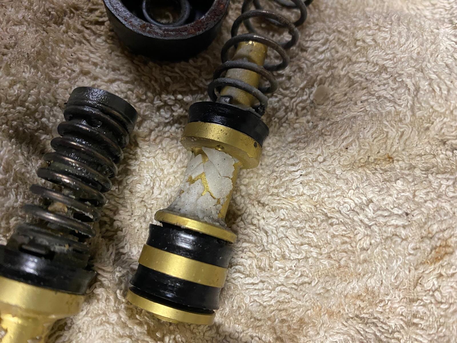

Hopefully you’ve now sorted the bonnet cable and master cylinder?! A mate had the same, just before your problem, on his S1 160. He’s swapped the master cylinder for new, but stripped the old one out of interest and found this…! God knows what the white stuff is but it certainly shouldn’t be there and wouldn’t have helped free-piston-return!!
Posted
Yes all sorted thanks Phil. The bonnet cable had become detached near the lock rather than broken and the master cyllinder has freed up with increased use. I wonder if that white stuff is some old grease that's crystallized? Seems to be traces of it on the coils of the left spring aswell 🤔
