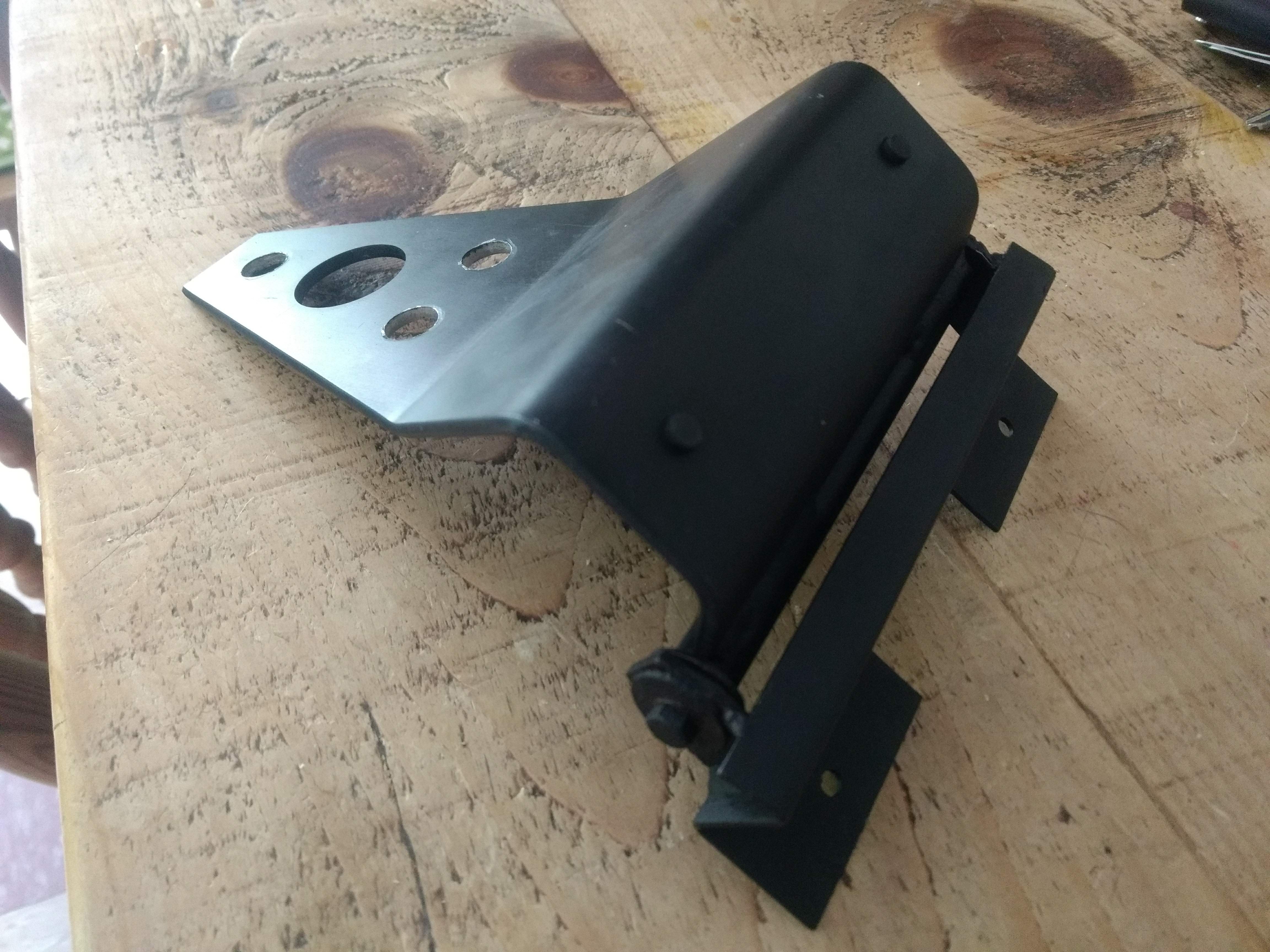

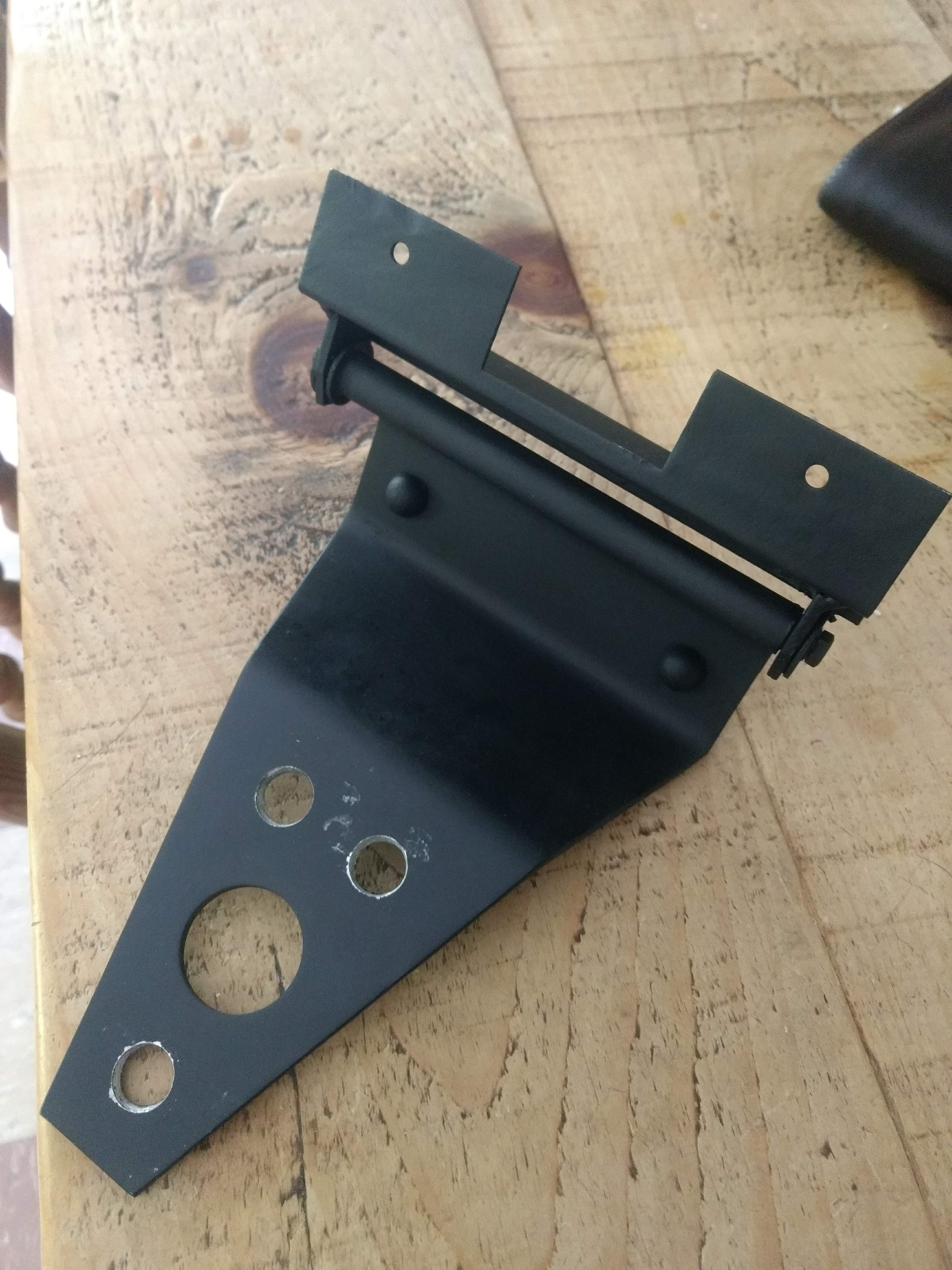

gingerbloke Posted May 15, 2019 Author Posted May 15, 2019 Stripped, cleaned, back together and moving freely. Thanks guys. I wish I'd taken a 'before' photo now......
