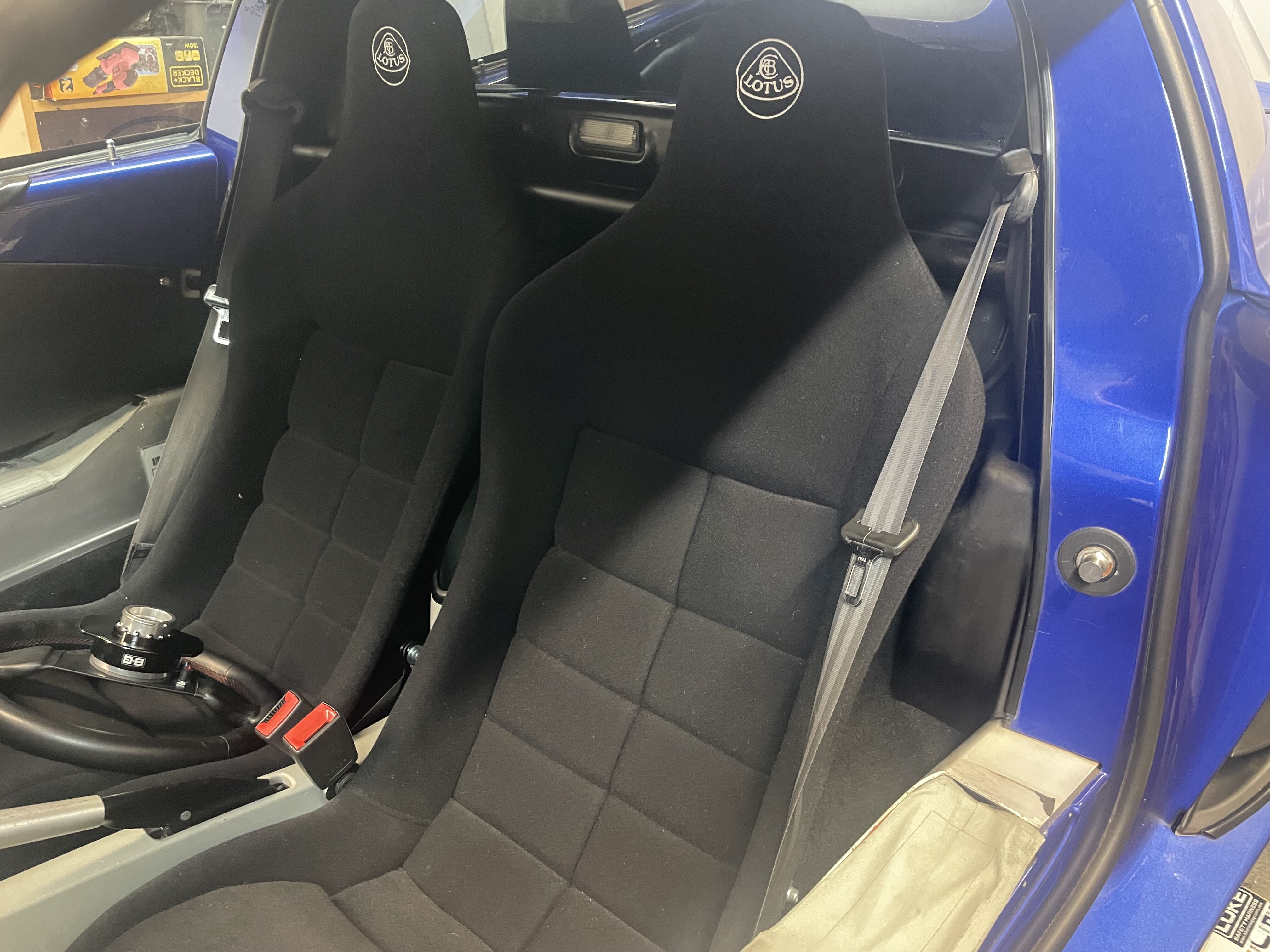

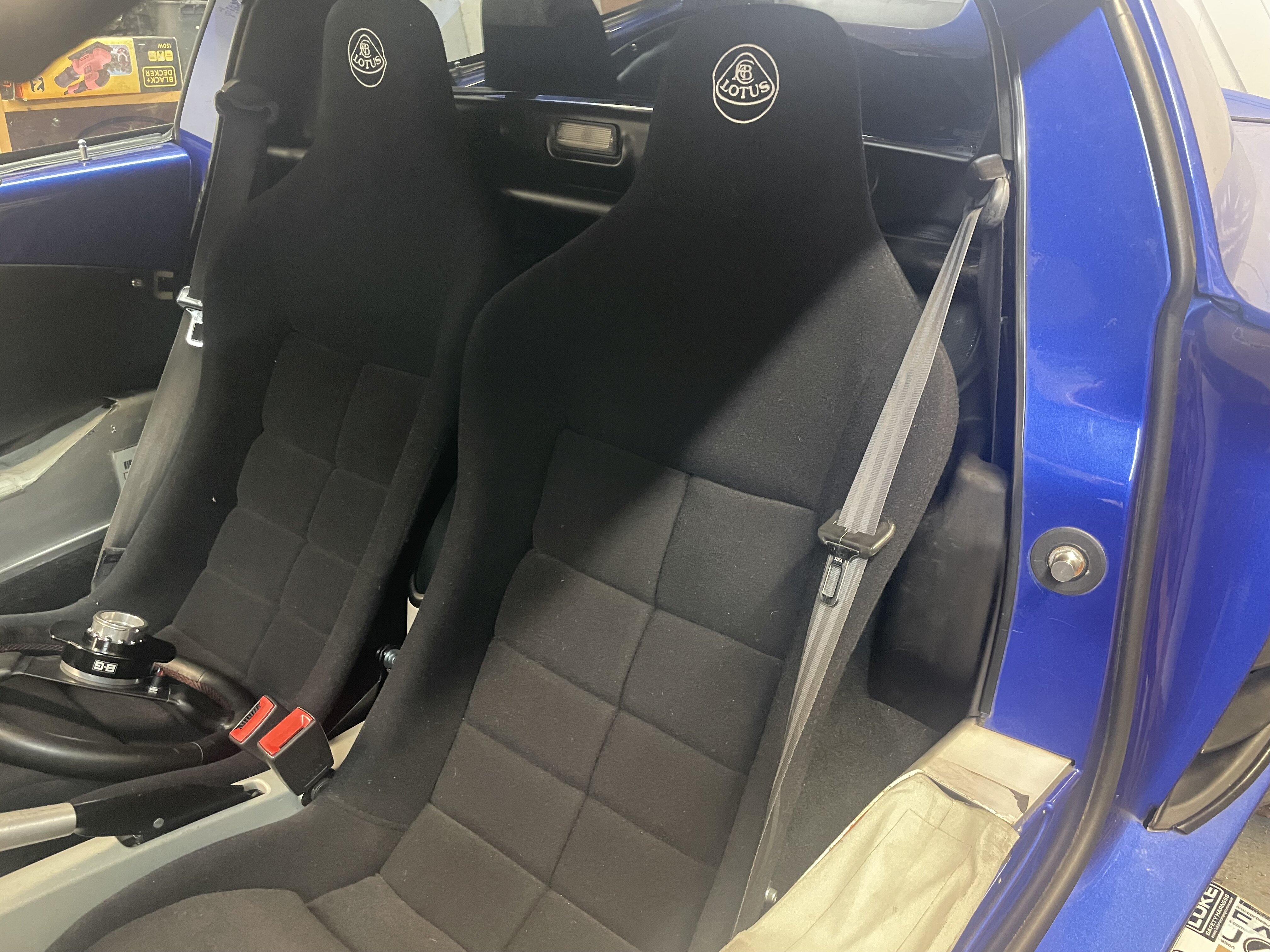

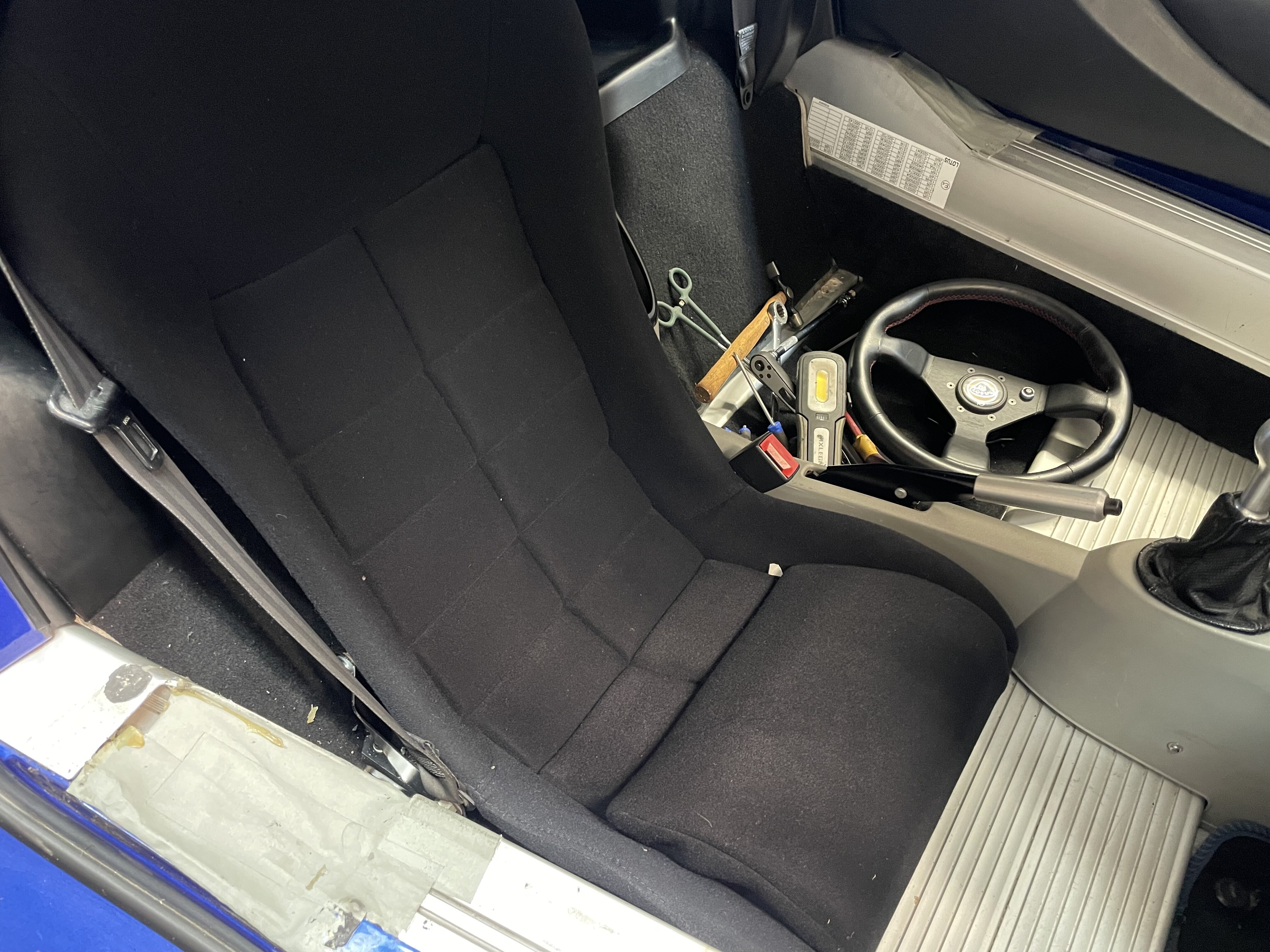

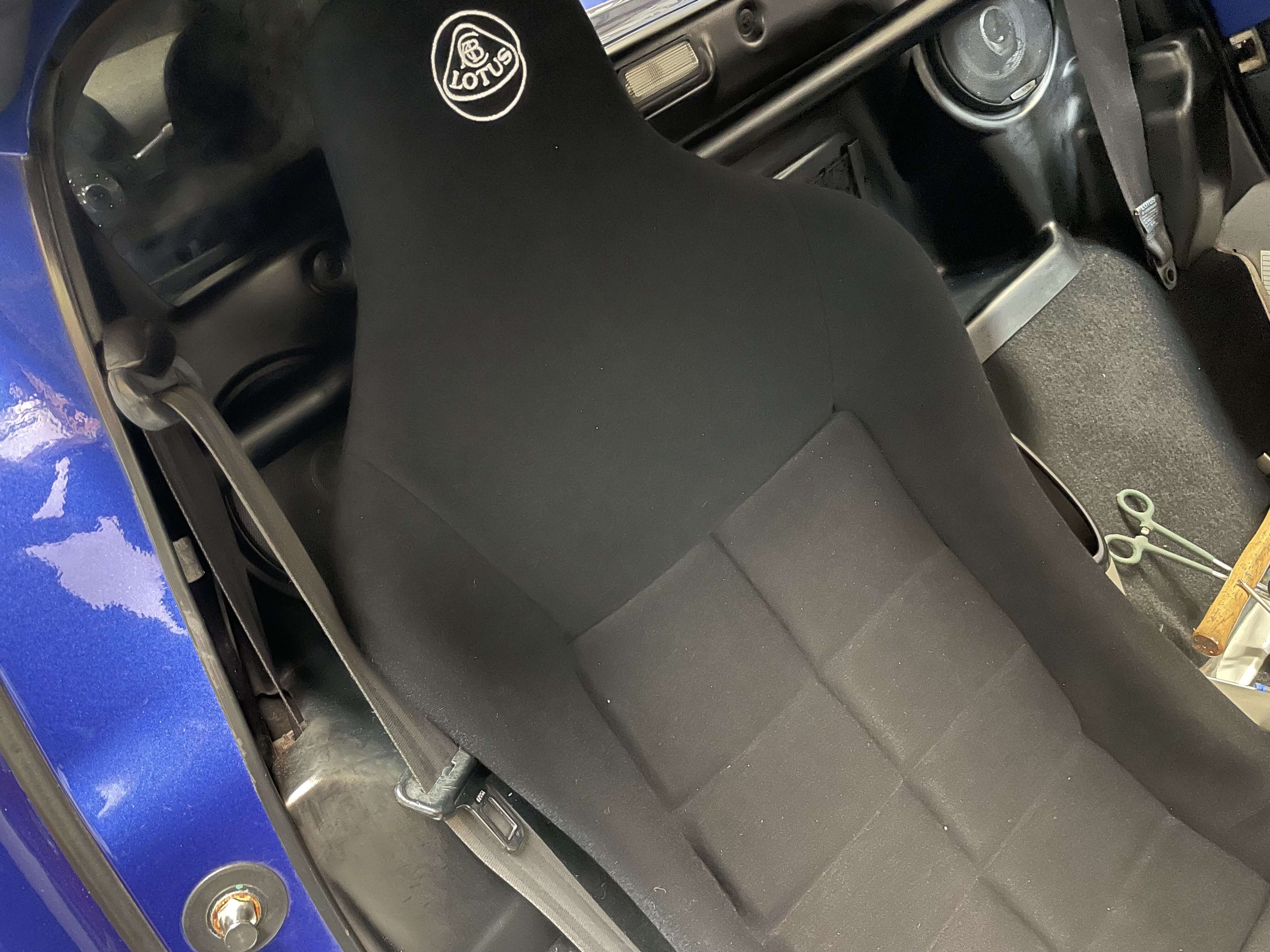

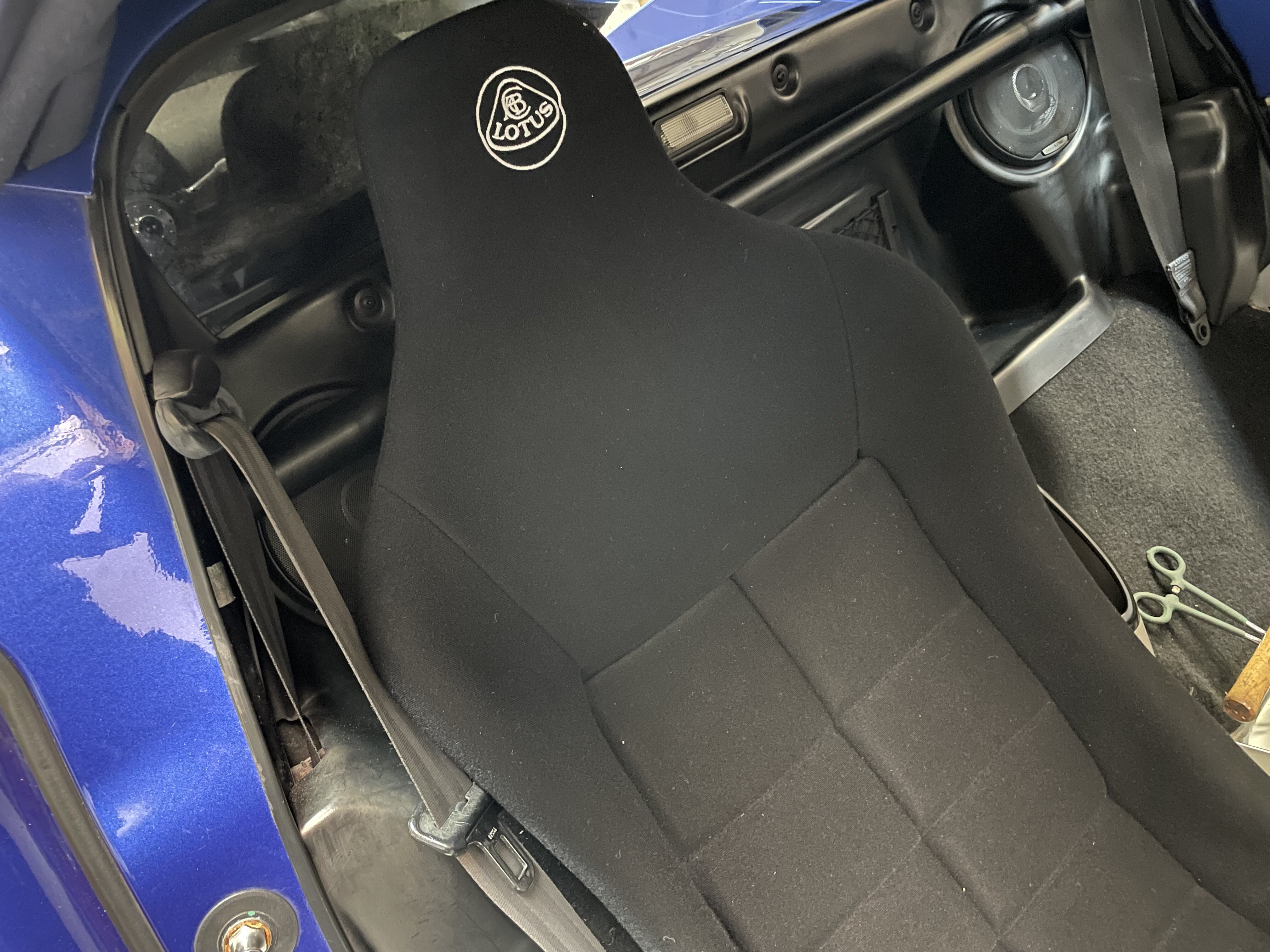

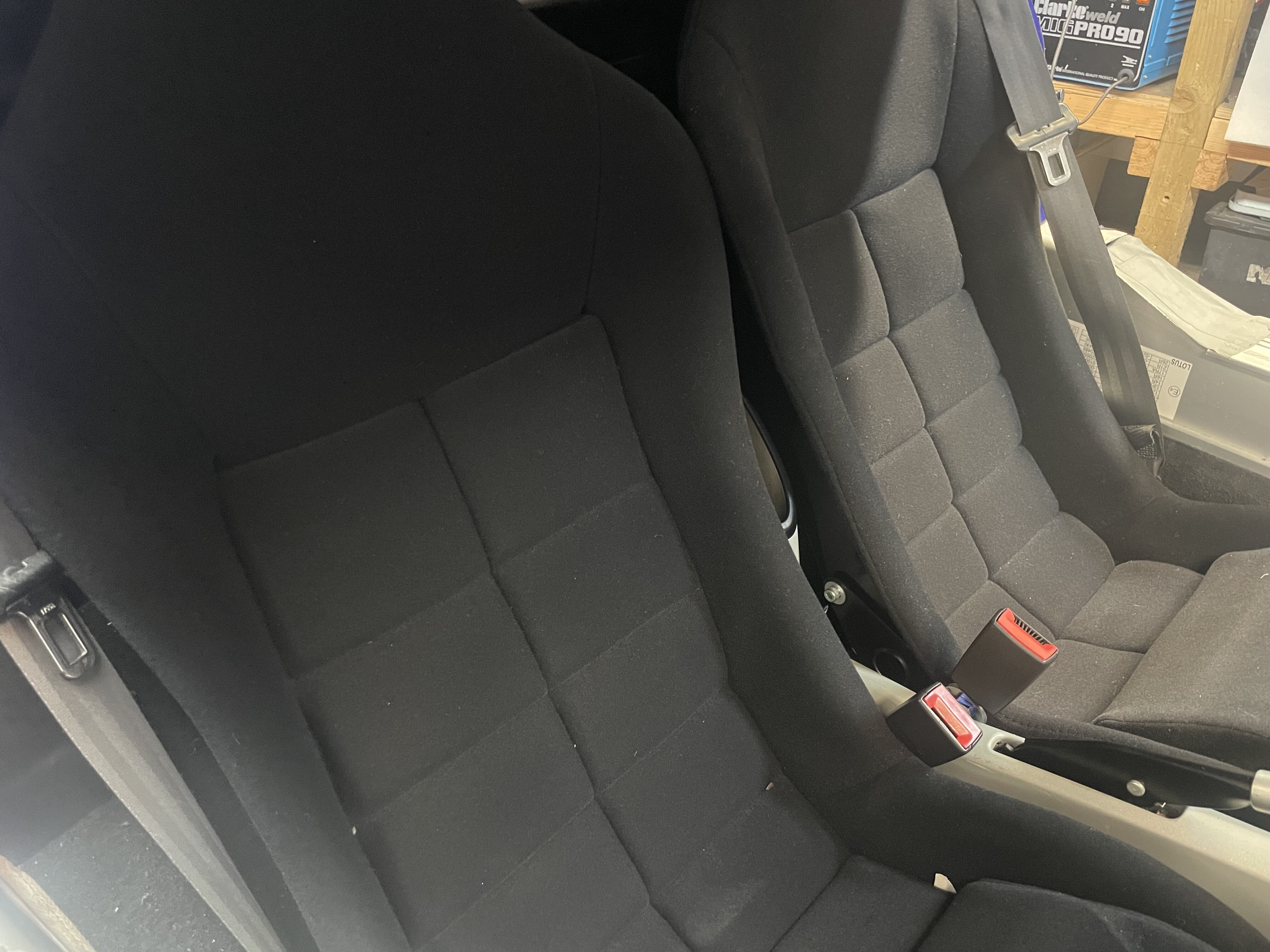

Slight delay on the seats as they arrived on Monday. Very nice to look at and seem very comfortable. Drivers seat now fitted. I would like to say it was a stroll in the park. It wasn’t. There are mounting holes on the seat. Ditto on the subframe. But not quite in the same places . The result was 4 hours or so of making spacers, enlarging holes on the seat frame and generally getting slightly irritated. However, the drivers seat in now in place . The rear brackets on the drivers subframe are bolted to the runners, so there is a bit of wriggle room. What compounds the problem is the inner seat belt receptacle . The seat is a touch wider than the o.e one with the result that the fouls the tunnel.If it was on a stalk 50mm long the problem would go away. It isn’t so it hasn’t. However, the passenger side is more of a headache as it is a welded one  piece frame. Same problem with the hole misalignment but the real problem is bolting it back in place. As it stands at the moment, the mounting holes onto the floor just won’t line up because the inner seat belt receptacle won’t,let it. I will sleep on this one. IMG_7018.thumb.jpeg.02aac6505750bb2b7201f0387fbcdb1b.jpegIMG_7019.thumb.jpeg.5e74b2f0ff8fea67b4bb37a37c91713e.jpegIMG_7020.thumb.jpeg.690db4aa04413bf482f3a389c81489c0.jpeg
Posted
And now with both fitted. Just the sill covers to re-do and the interior is about right. The passenger seat belt ‘stalk ‘ was a real fight. I ended up making a small extension so that the receptacle just cleared the tunnel. That then allowed the subframe to line up with the captive nuts in the floor. IMG_7031.thumb.jpeg.12454d24fa818e9af8587d3886cc7b9c.jpegIMG_7030.thumb.jpeg.6ee63f1d3ee386bd6a4b145b634c19ab.jpegIMG_7029.thumb.jpeg.51f3294d0904f58ce643ab9bac427618.jpeg
