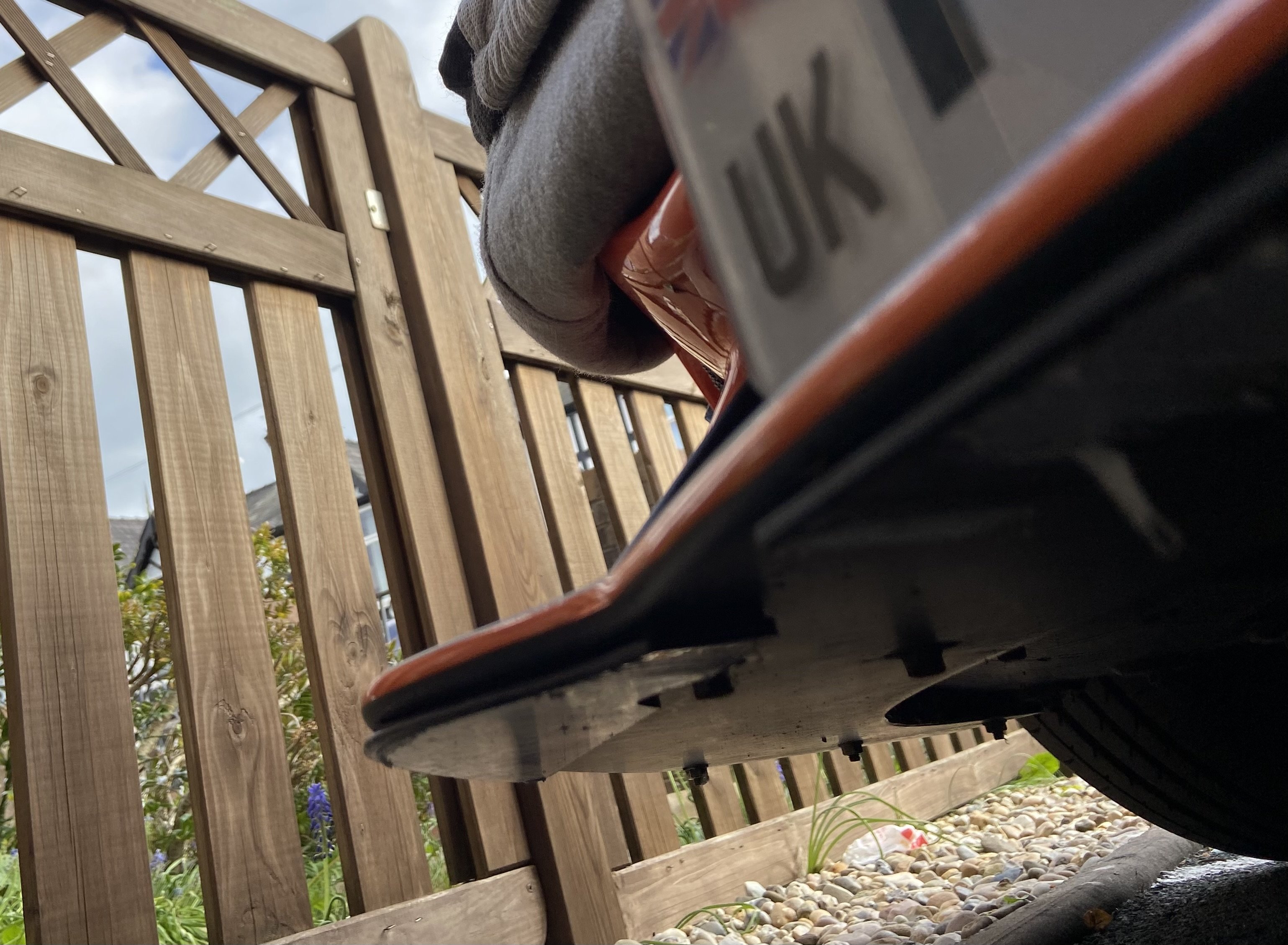

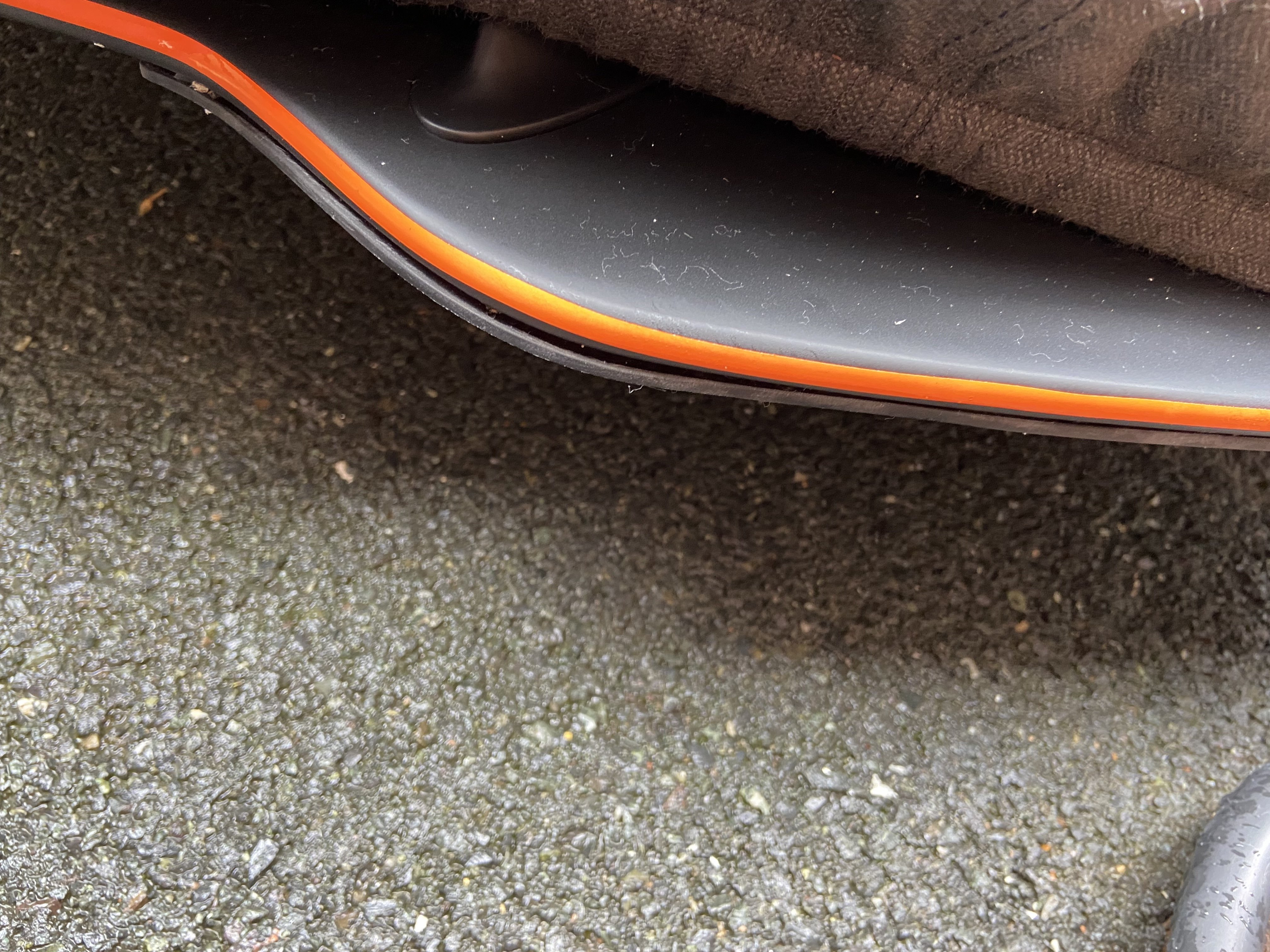

IMG_1526.thumb.jpeg.93eebde378669dfe97b1744d48e28b23.jpegApologies for the crappy pic but this is my diy solution, 3mm polycarbonate and 3M trim tape. I just traced the shape of the spoiler front ears then shaped the polycarbonate to match. They're set back by a couple of mm so you can't see them unless you're looking from underneath. I doubt it will save any catastrophic impact but it does a good job protecting against road scrapes.
On the down side it effectively lowers the front buy a few mm, but on the up side, it works, plus they're cheap and easy to replace 👍

Thanks for the responses gents! It is very much appreciated 🙌
 Do like the solution you have there Johnathan. Think I'll have to order some 3M stuff this weekend and give it a go
